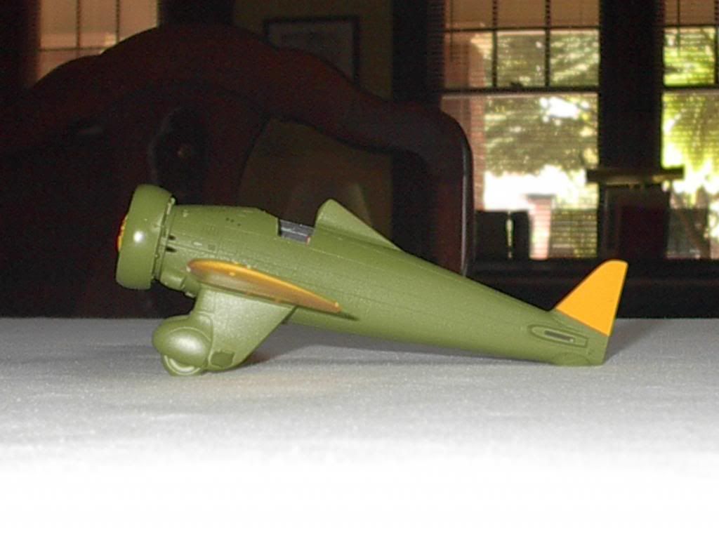

I've about got this little bird in the showcase.

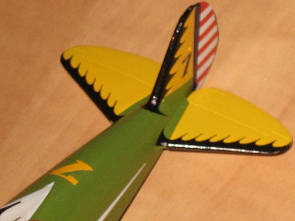

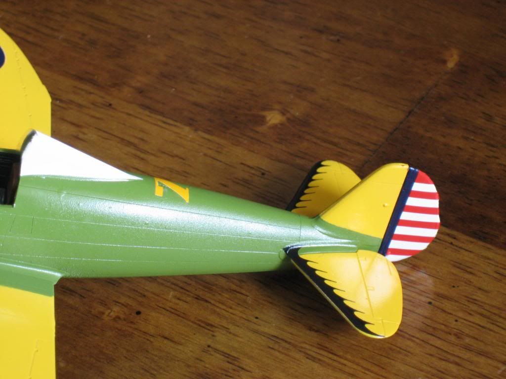

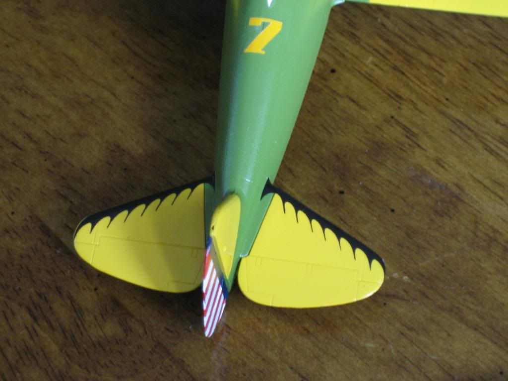

To answer your question about the decals, I've not have any problems with then as of yet.
The scallops on the tail plane gave me a fit staying in position as they would slide around, and I'd have to re-position them. This was mainly due to me getting them too wet, and gravity doing it's thing. After I got the in place and propped the model at an angle where they would not move all went well.

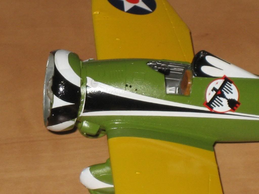

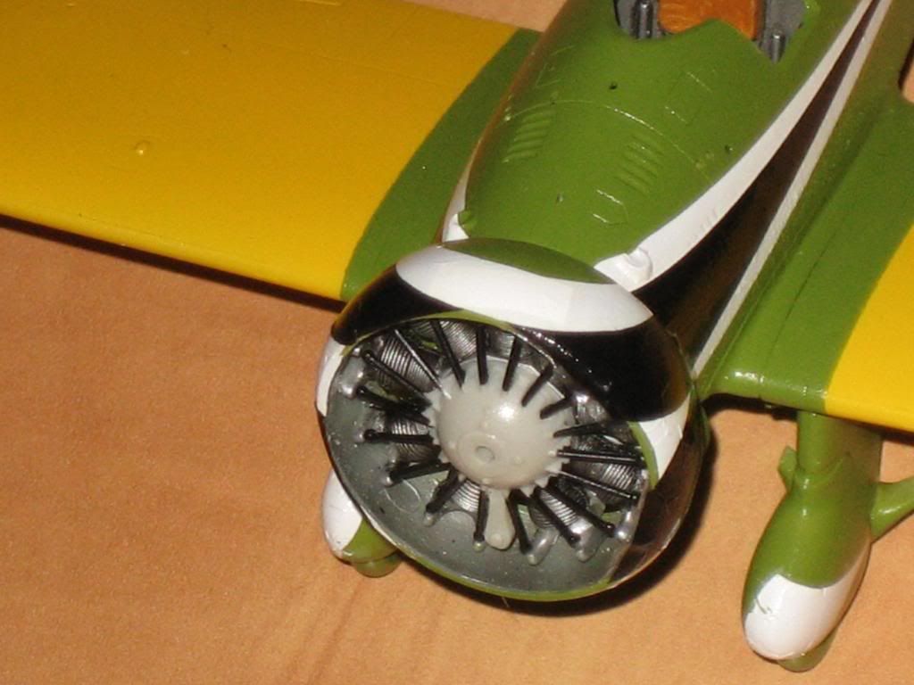

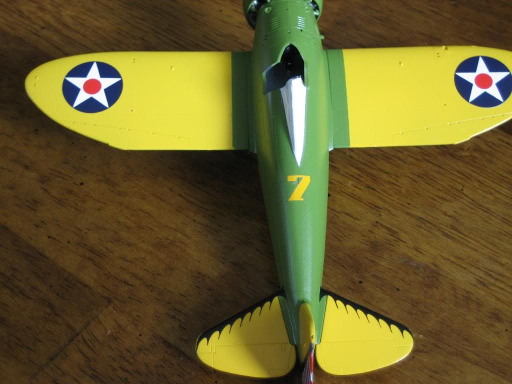

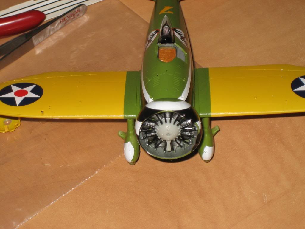

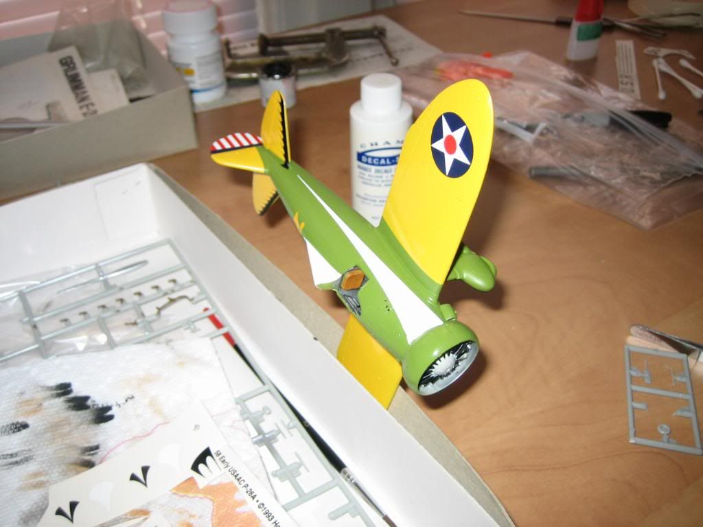

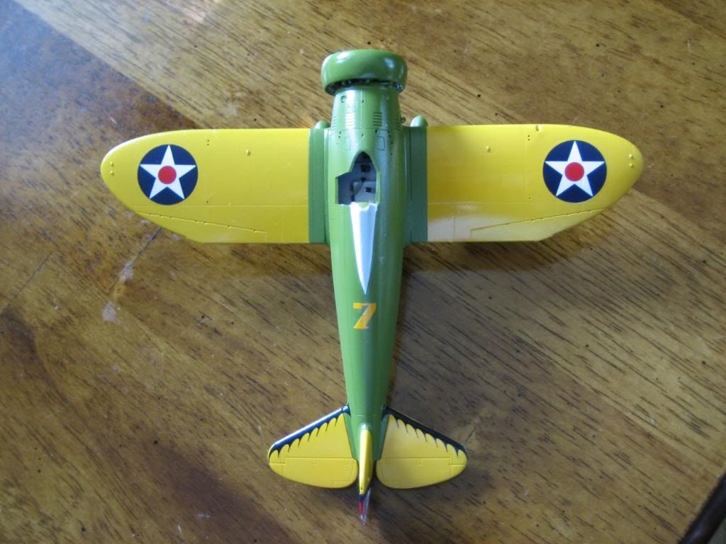

Here's a few pics of the last round of decals. The white flashes on the headrest are still wet so they will look a little funny. There is a heavy coat of CHAMPS on them so they will dry-out and look fine.
All comment and abuse welcome! :woohoo:
Damn fine job! what will you do with the leading edge where the decals don't wrap around? I always have a hard time matching up the paint color with the decal in those cases.
Well Moon ..... I had thought about using a paint pen and a very steady hand to paint in the area around the leading edge. The decal is gloss black so I'd use a gloss black pen, and after a coat of Future I hope it will blend together.

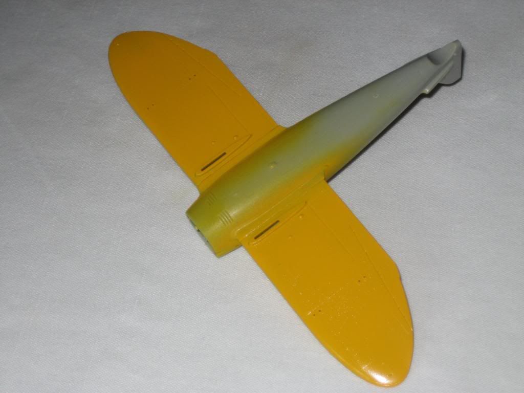

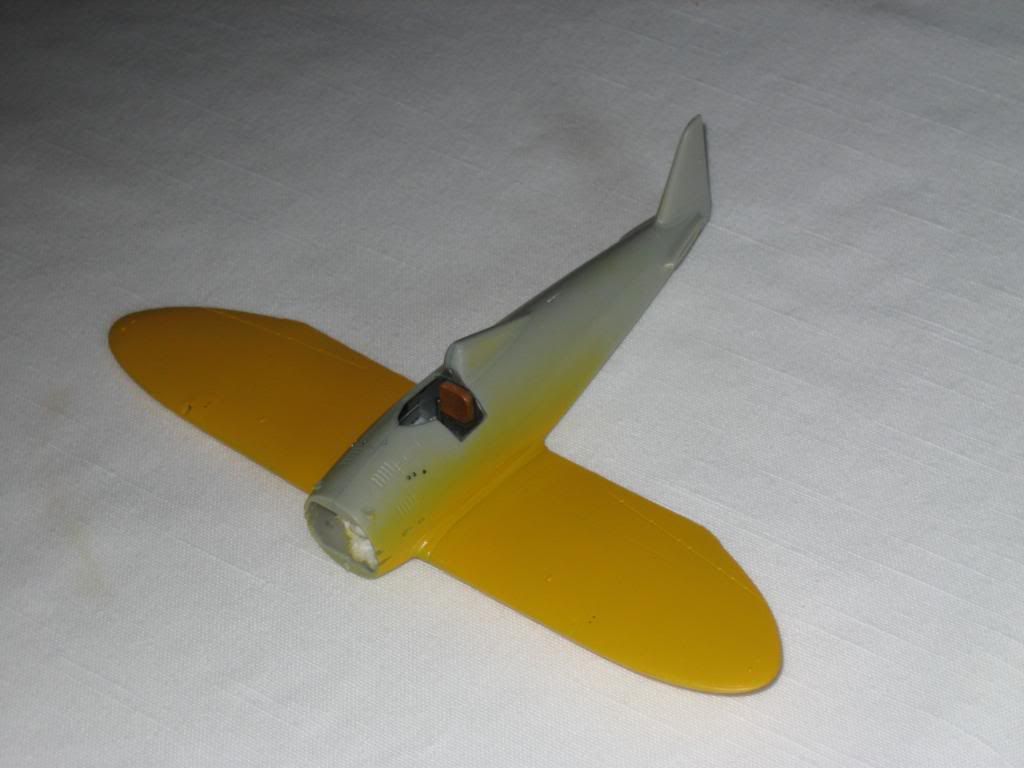

Tom..... The kit has pretty much fallen together. Not a shake and bake, but no real problem areas either. The one and only down side for me was a couple of broken pieces, the rudder pedals support is very fragile and broke as I cut it from the sprue, and the center 'mast' that supports the outer wing guy wires. Same problem there, extremely fine piece of brittle styrene. I would have replaced it with wire or something stiffer anyway.
Now if you have old eyes like I do, you will find reading the number tags on the sprues challenging! But we all know the fix for that..... don't get old!

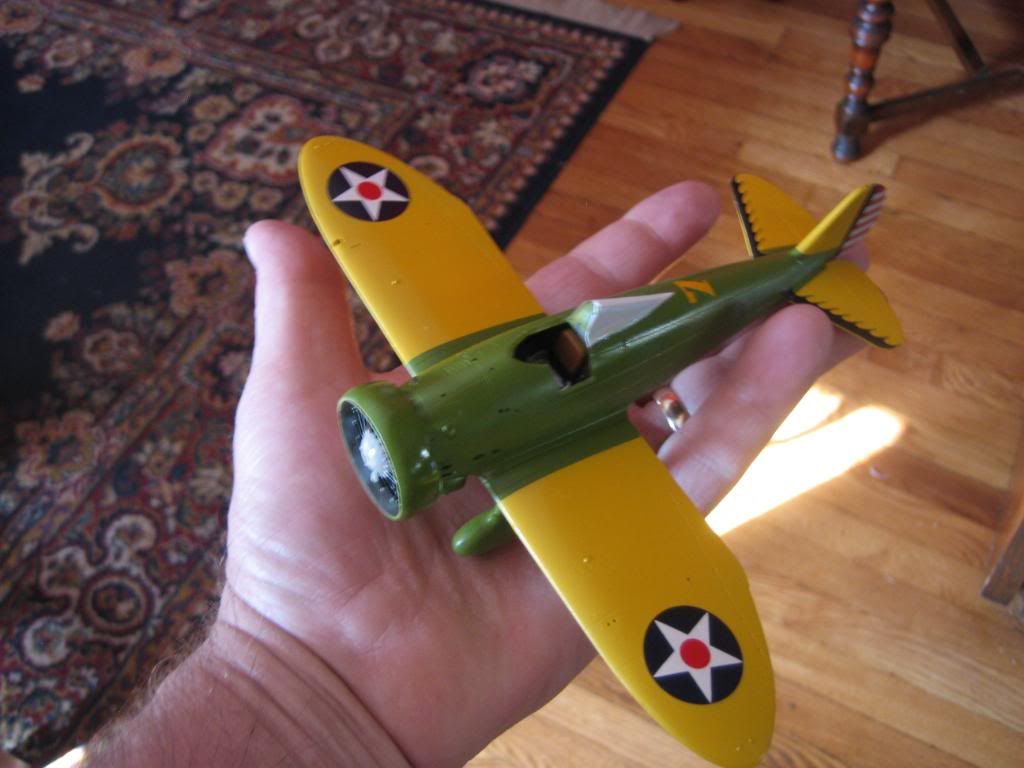

Last pic for today
That's good to hear, the boxing I have has the yellow wings and blue fuselage....excellant job on this beauty!

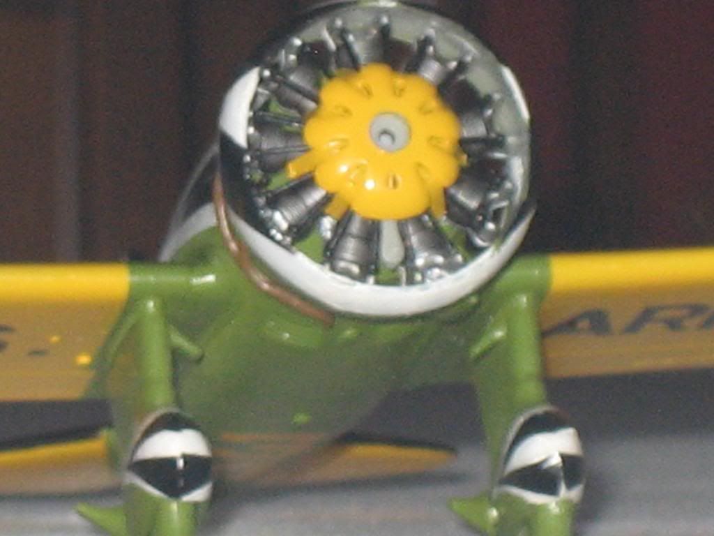

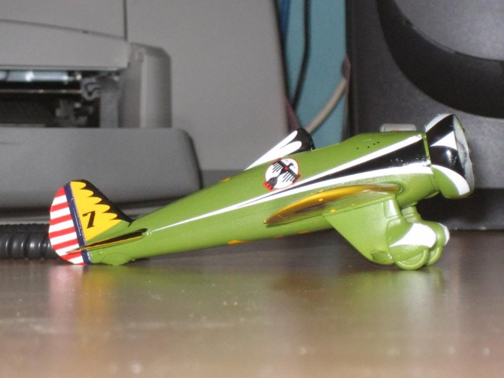

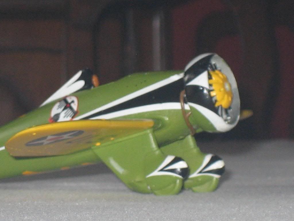

Here some pics of what I've got after a week of battling some very stubborn decals. I still have a lot of clean up to do, but it's starting to show some promise.
The color is great, the black and white swoops are nicely done. Just to know - are they decals? To control delicate long decals like that takes lots of patience and a steady hand.
OH yeah, they are decals, some were really good, and some were really a bear to work with. Especially the ones on the cowl and wheel spats.
Oh how I wish I had patience and steady hands.....Thank you for the very kind reply.
