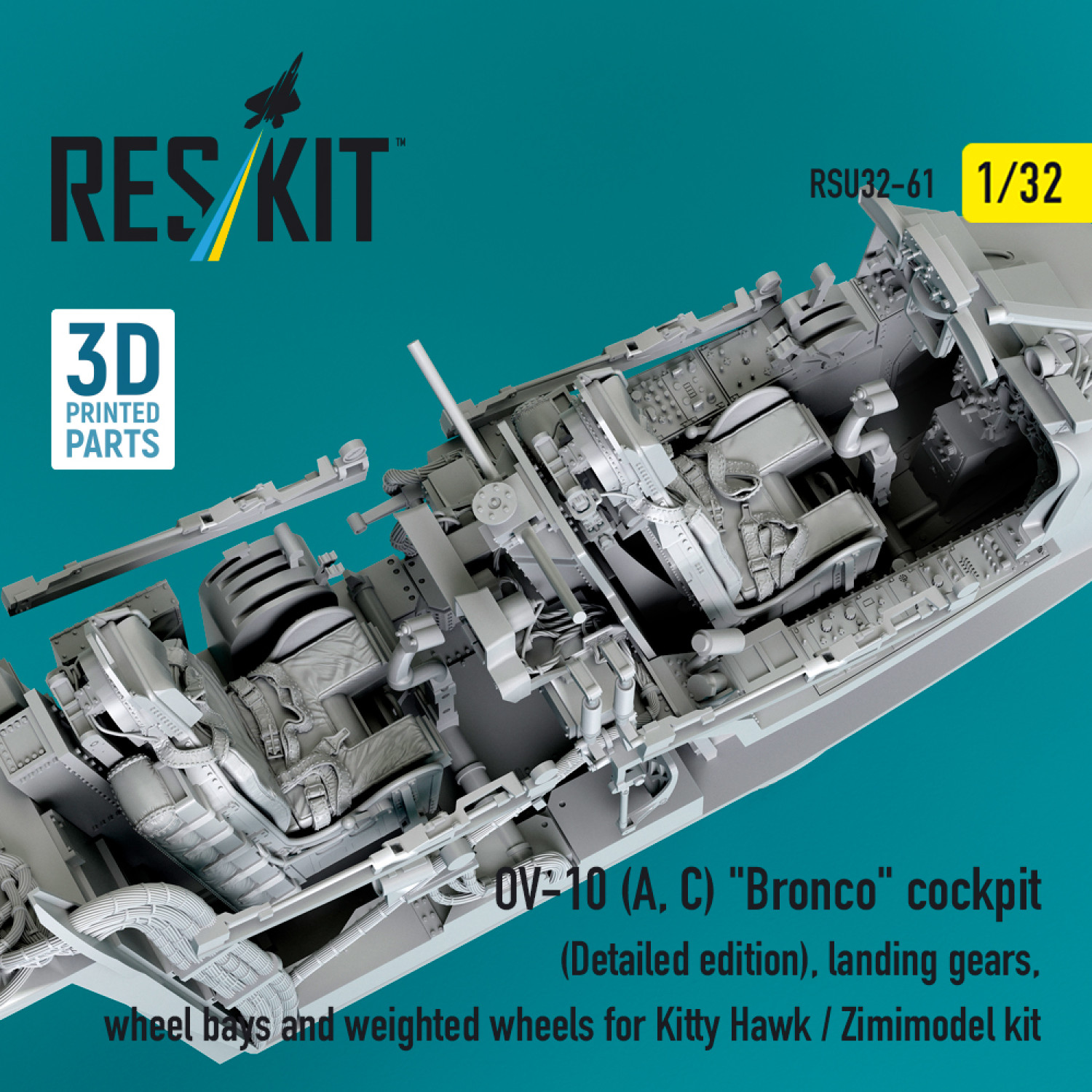

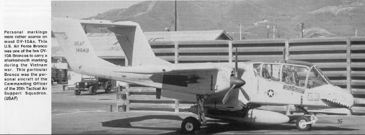

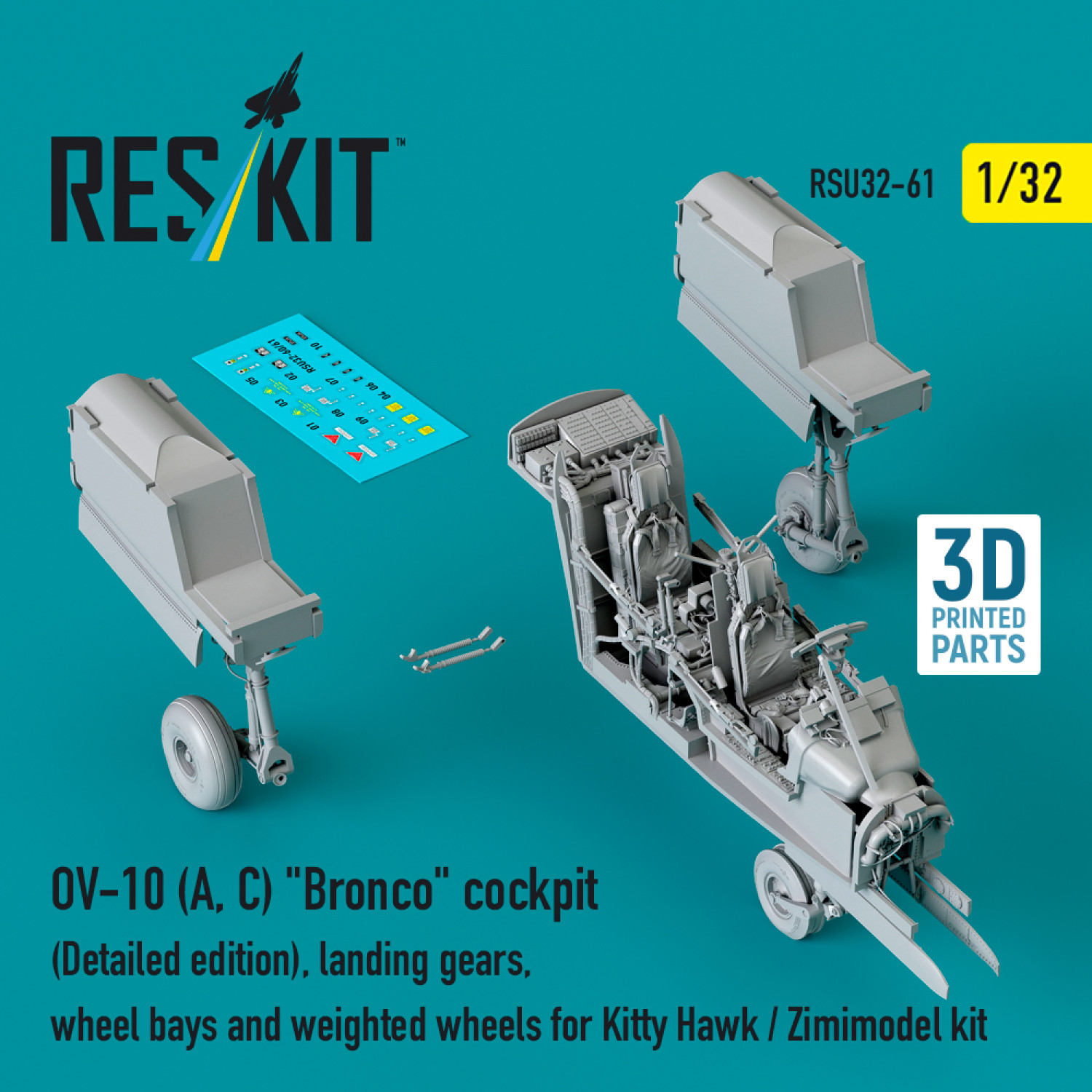

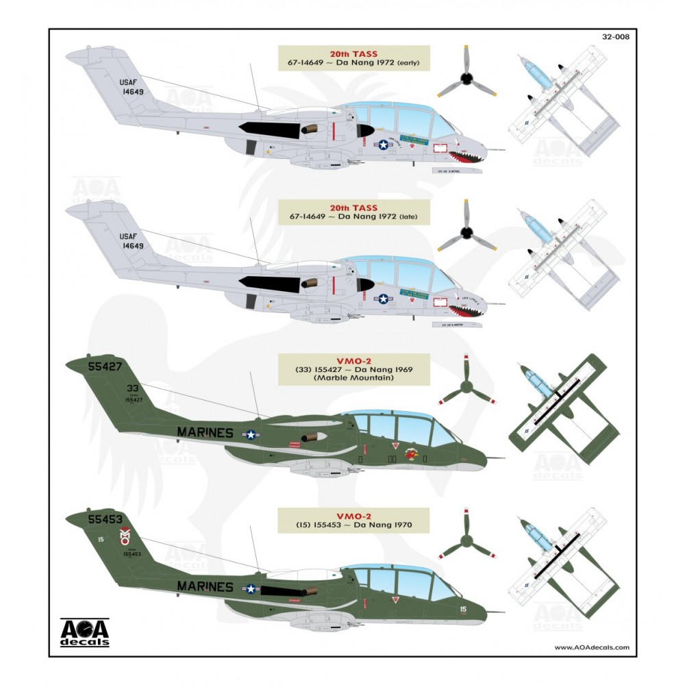

This is just a place holder. When my Bf 109 K4 is done I will be building a shark mouth. So this is just a teaser until then. Wait till you see the goodies that are going into it.

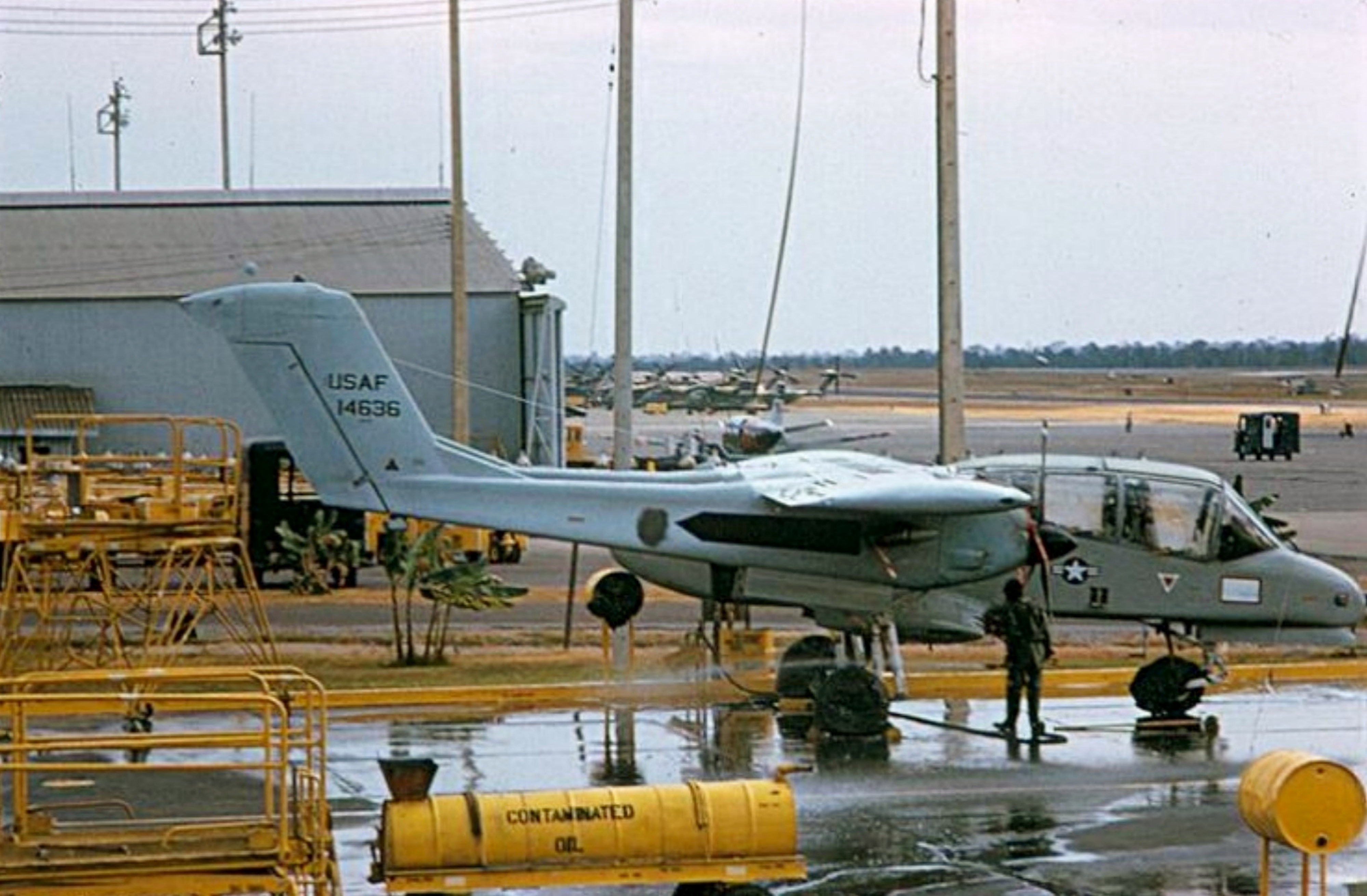

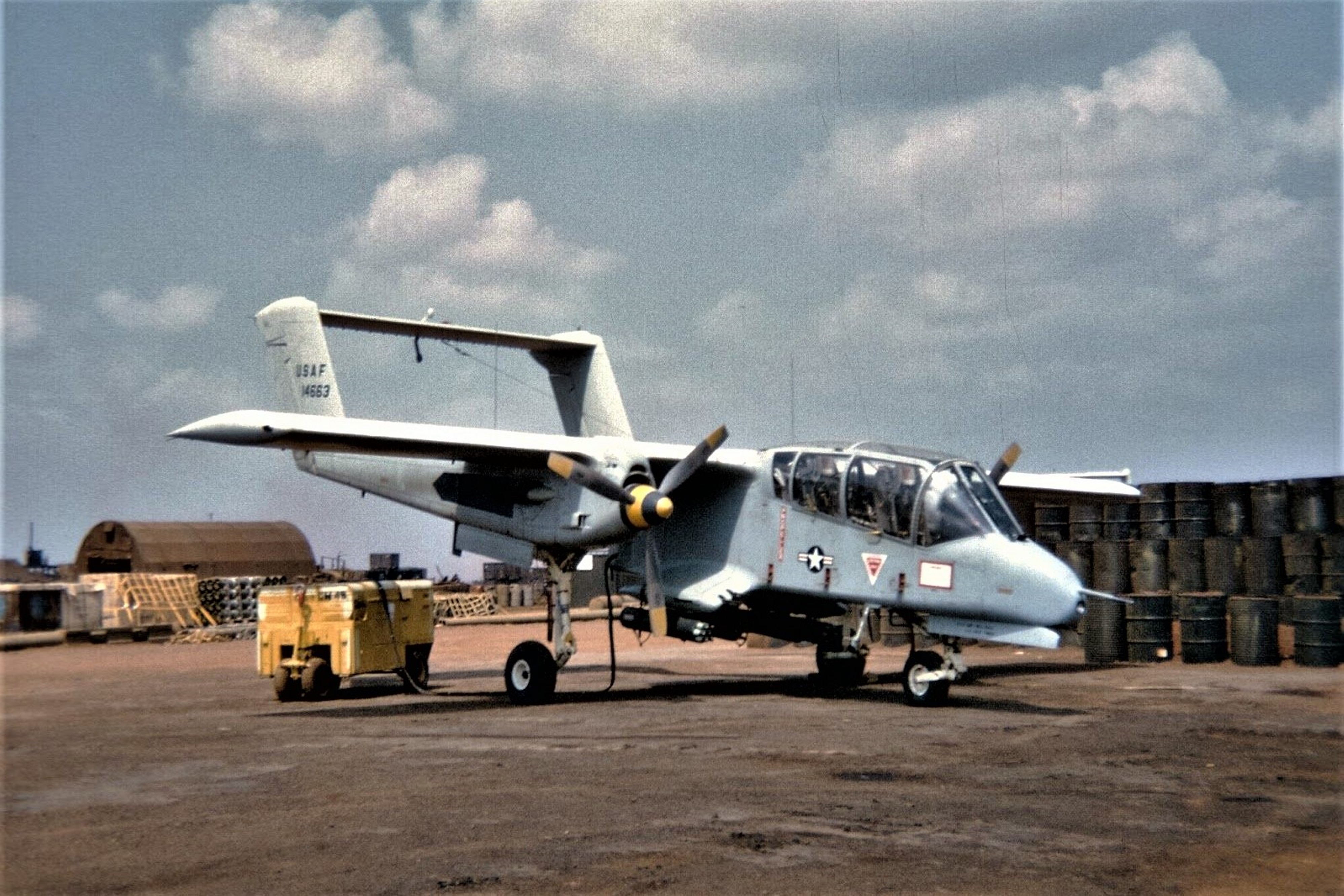

What do you need? Walk around photographs? Manual excerpts? Ask! It has a sharkmouth so it needs to be done!

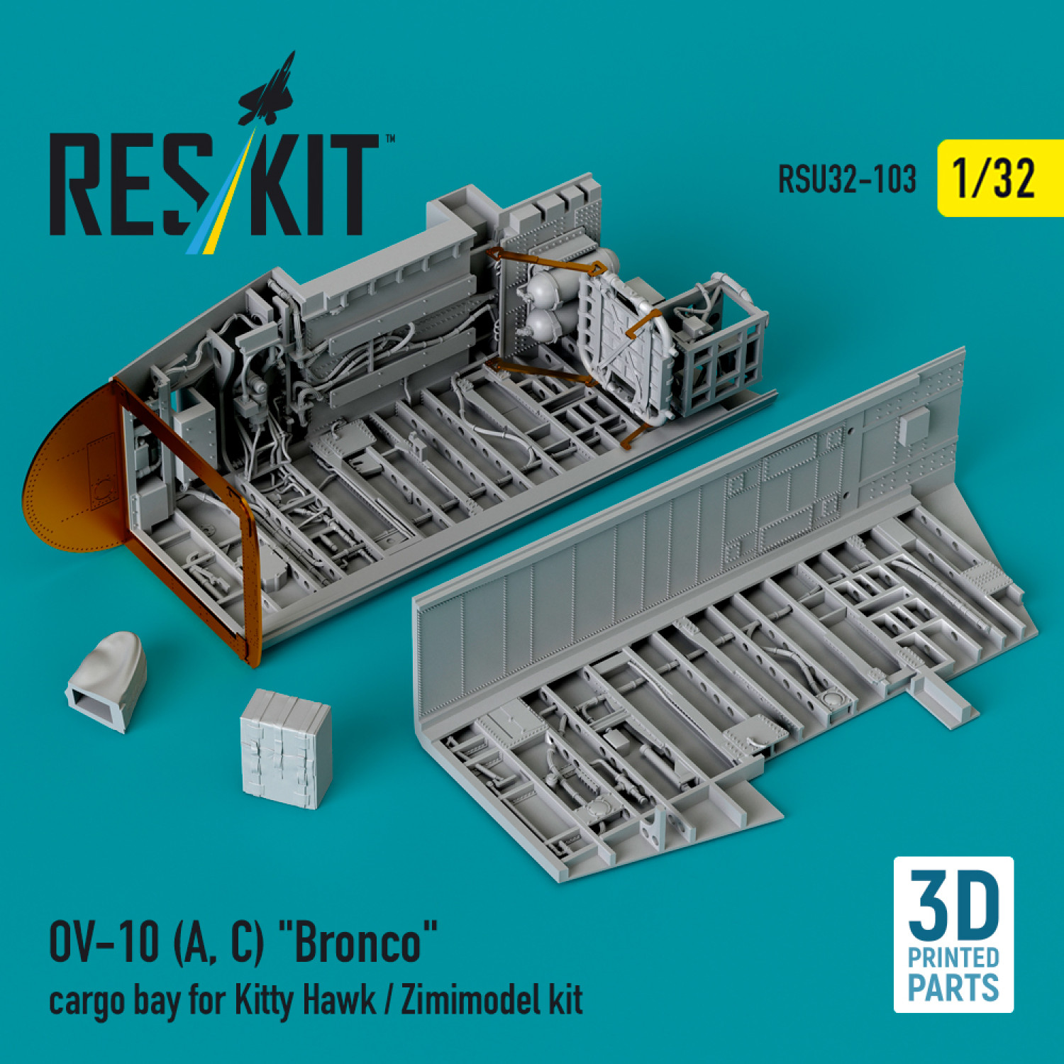

Maybe you can answer a question for me. How the heck did the paratroopers get out. It seems the rear door would be held closed by the air flow and from a walkaround video I saw, the pilot said the guys didnt really like jumping blind so the pilots had to do a zoom so they just slid out. Did they take the rear door off before flight?
James
The Marines seem to be the only users to use the paradrop capability (brave/crazy or some combination). The OV-10's could carry 4 x self-loading combat equipped cargo units (6 if the rear cockpit seat and fittings were removed) and the rear cargo door removed. In the D model Flight Manual there are seatbelt attachment points along the floor/sidewall and they could be installed as/when required. It also had a paratroop signal/warning panel on the upper left side of the door. There is an ICS panel farther forward near the cargo barrier but I'm not sure if it was used with paratroops or just with passengers that were remaining aboard for the whole flight. The seatbelts also may only have been used for regular passengers.
From what I've read, in the early models they snuggled in nice and tight with the first "jumper" sitting with his legs over the edge of the cargo bay with a strap across the bay holding him in. If they were using static lines they were hooked up before take-off. When they reached the DZ the pilot pitched up, the first man released the strap and they slid out as the aircraft climbed, somehow maintaining separation and not getting tangled.
There was a design study done for a transport version with an enlarged fuselage capable of carrying 4,500 lbs of cargo or 8-12 troops but it never left the drawing board.

I would imagine the intercom would be for when they did a medivac. 2 Stretchers and a medic could be carried. Found my answer to the paratroops. Back door removed. Marines and army did jumps from it. Not the most comfortable ride I would think.
I guess resupply could be carried out. Probably small arms ammo and LAWs etc.
