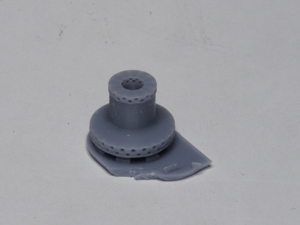

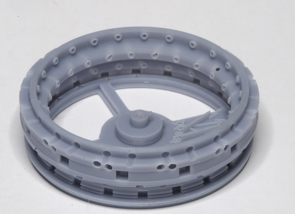

Anyway the bits arrived in under 24 hours and i think we are in with a chance here,

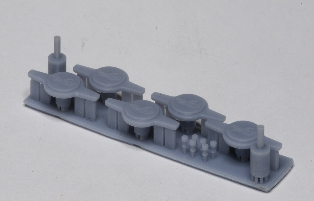

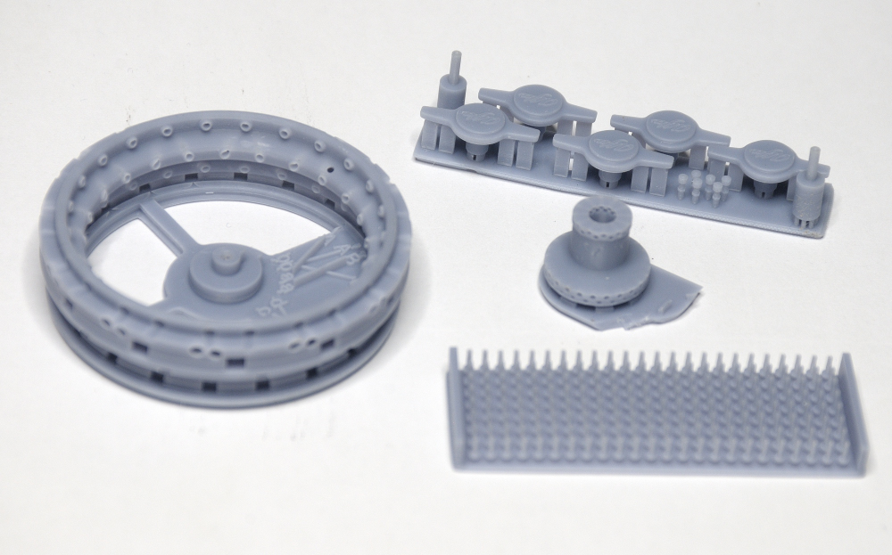

This is the basic set , rim ,hub , Spinner and valves along with out of focus spoke nipples
obviously you get 5 wheels etc

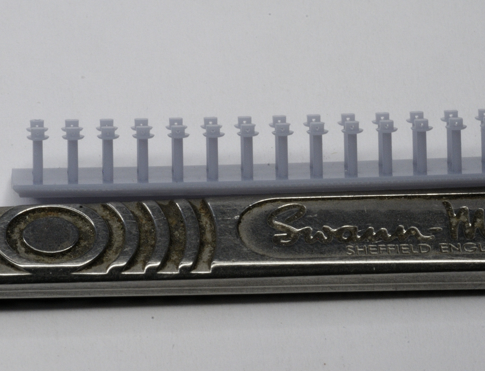

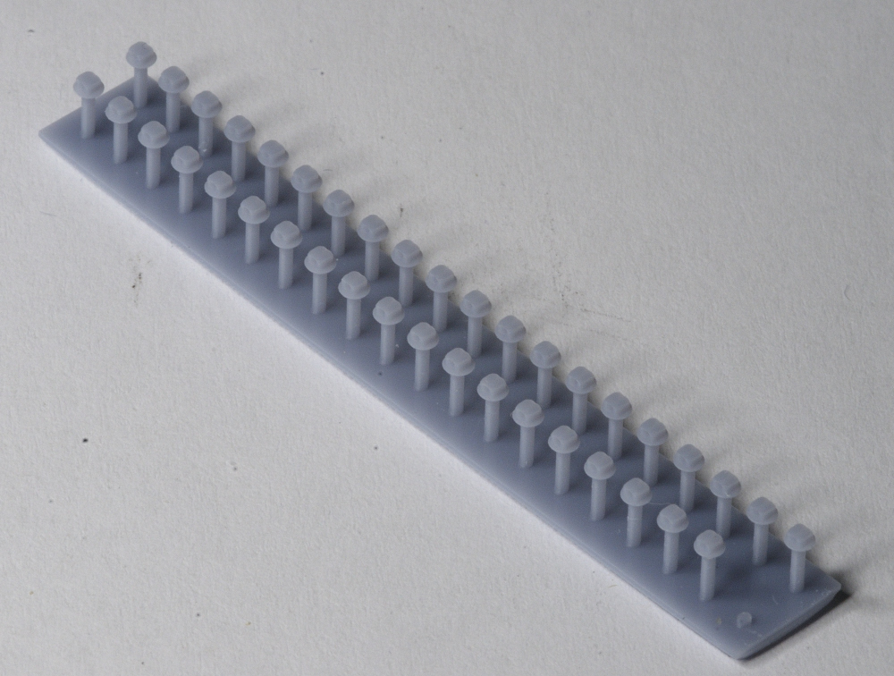

and these are the lockwire bolts with correct square heads drilled through

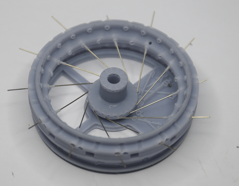

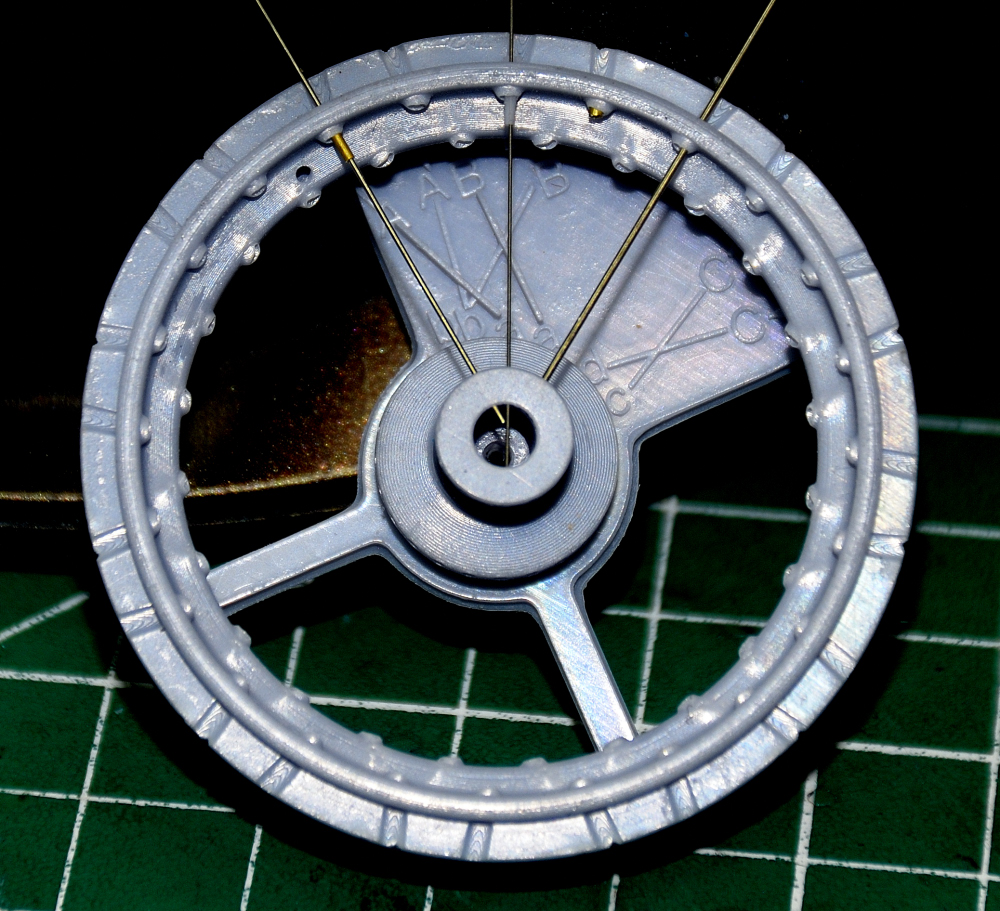

Rather bizarrely the whole lot comes with a roll of .15mm wire for the spokes which is way to small, i rang the guy up and he said thats all he could get and it should be .3mm really

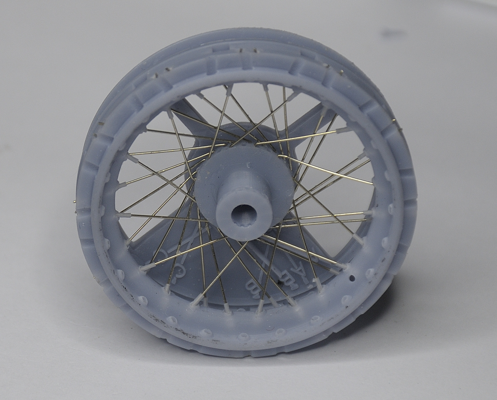

Well i think it should be 0.4 mm to give a true 5mm spoke however the rims and nipples are drilled .3 so i will order some .3mm Nickel silver rod... which will be about .4mm once its painted though i might not paint them, not sure yet
Its a novel design with the frame on the rim designed to hold the hub in position till its laced up . not seen it done like this before, it might be a problem if you want to paint the rims first before you cut the jig off the back...

OK so at the moment i think these are my options...
clockwise
0.3mm nickel silver spoke with 0.6mm bras nipple home made
0.15mm spoke with 3D printed nipple Kit supplied
0.45mm spoke with no nipple home made
To me the 0.3mm is the best bet, 0.3mm x12 (scale) is 3.6mm spoke but dia seems to vary with the number of spokes and these wheels are unusual as they have 3 rows or 72 spokes a wheel.
Only ref i can find is a austin 7 of the same year as the alpha with 5mm spokes but half as many....
i suppose it comes down to what looks right but it seems a bit pointless swapping inaccurate kits wheels for equally inaccurate after market wheels.

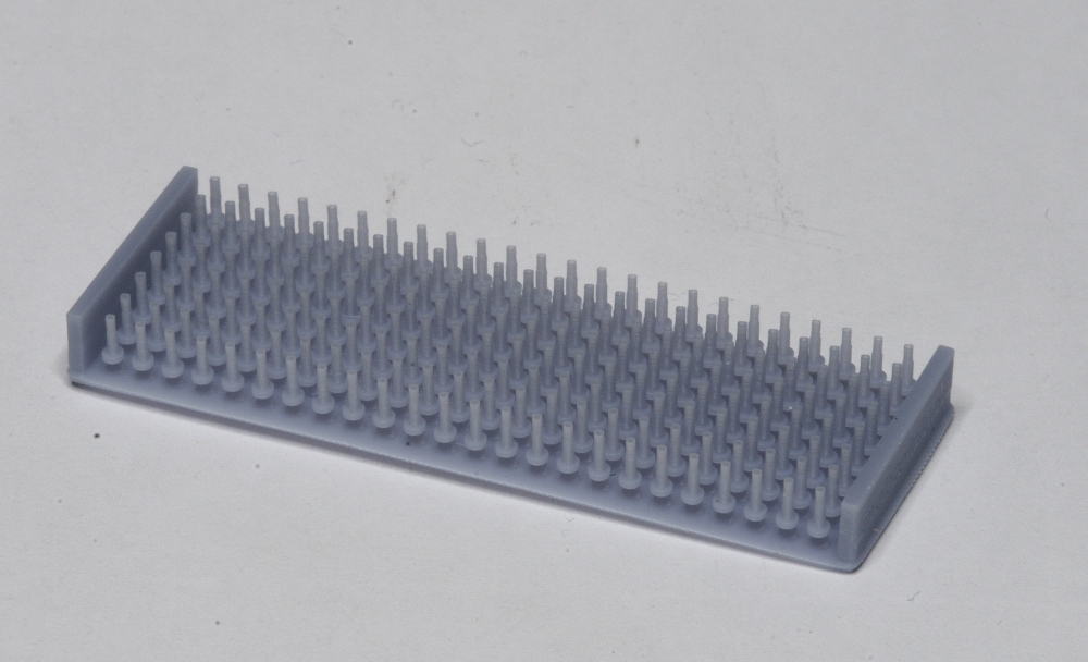

Agree option A looks about right, down side is 5 wheels , 70 spokes = 350 bits of brass tube for the nipples :)
I would have got 3mm through the 3D printed nipples but half of them dont have a hole right through and i cant hold them to drill them, even lightly holding between fingers crushes them so a drill bit just tears them up.
Also the spokes are not straight so i need to make some kind of jig to form them......i hope this is worth the bother lol
