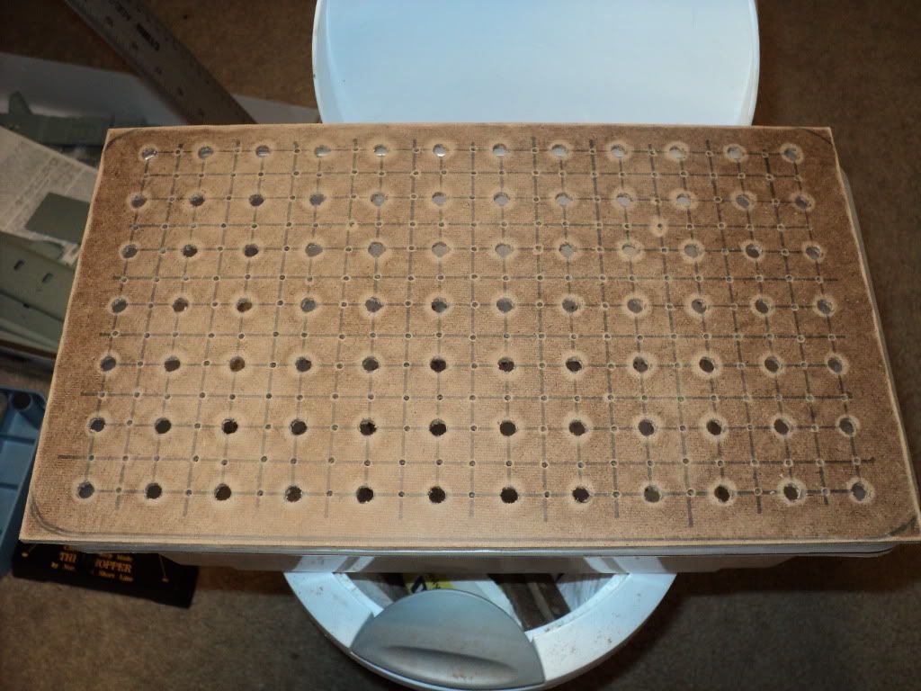

I've tried a few of the pegboard/drilled hole types with shop vacs and they'll never produce vacuum in the timeframe to get good results. I bought plans and the wire for a heating element from a company that used to make small table setups. It's a big project to build and it the end, probably not to good for small stuff. I also have an industrial vacuum pump for resin, so I'm ahead of the game in that sense, but this little baby really seems ideal for $100 and making small parts.

The best surface to have on the form is NOT a smooth glossy surface. The plastic will stick to it and air will be trapped. A surface that has been lightly sanded with very fine grit sandpaper works best. This helps the air to flow out from under the soft plastic and if fine enough grit was used, wont affect the surface appearance on clear parts. :D
