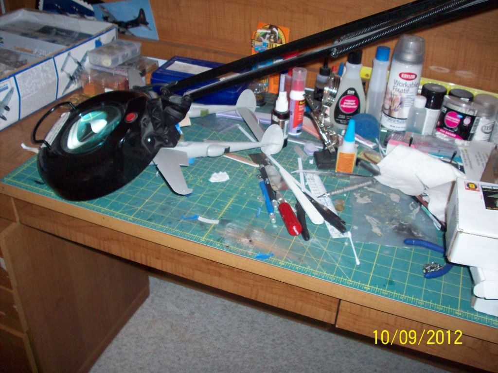

Woke up to THIS today ! OH Horror of Horrors !! Gently moved the light and found that everything is OK, Thank God !!!.Need advice on a new lamp, one with a METAL base..................Harv :blink
Whoa! You are a lucky fella indeed, Harv! I bought this at Woodcraft on one of our little excursions with Moon Pup and Phantom II.
http://www.woodcraft.com/product/2083691/34181/80-led-magnifying-lamp-75-x-62-glass-175x.aspx
The optics are great, the LED takes some getting used to. Ask MP for is 2 cents. :mpup
In thinking about it, maybe you should buy a Lotto ticket while you're at it. Damn, that WAS lucky! I dropped a resin piece in a carpeted room yesterday and it landed on the only hard thing in there. Cracked it, of course! :pinch: Good luck in your search. (y)

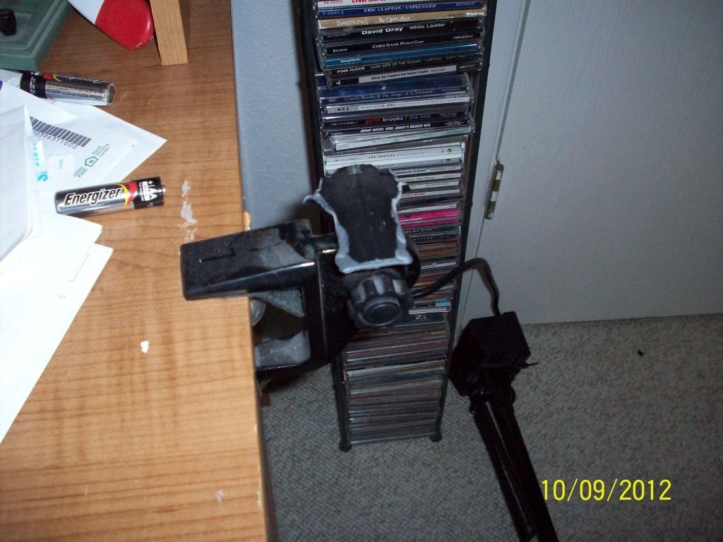

Here's how I did mine up using a cheap lamp, since I worked in an auto shop all I did was take some scrap rod and weld it to the end of an old GM caliper slider and welded the sleeve to a flat plate. I did it so that if I needed to I could change the lamp but so far it's lasted around 15 years so all is good (y)
Now that's a Mount!
Harv, feel your pain, glad the Lightening is OK.

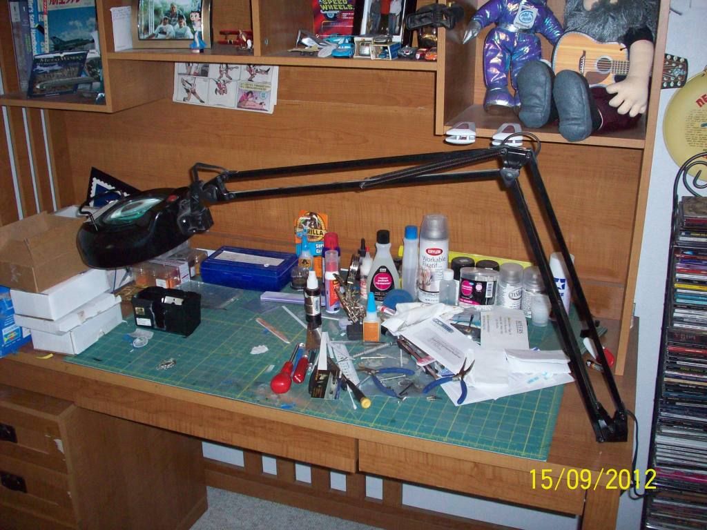

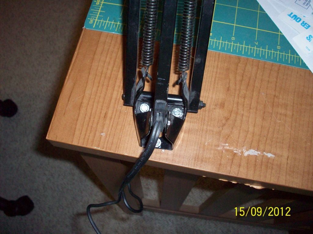

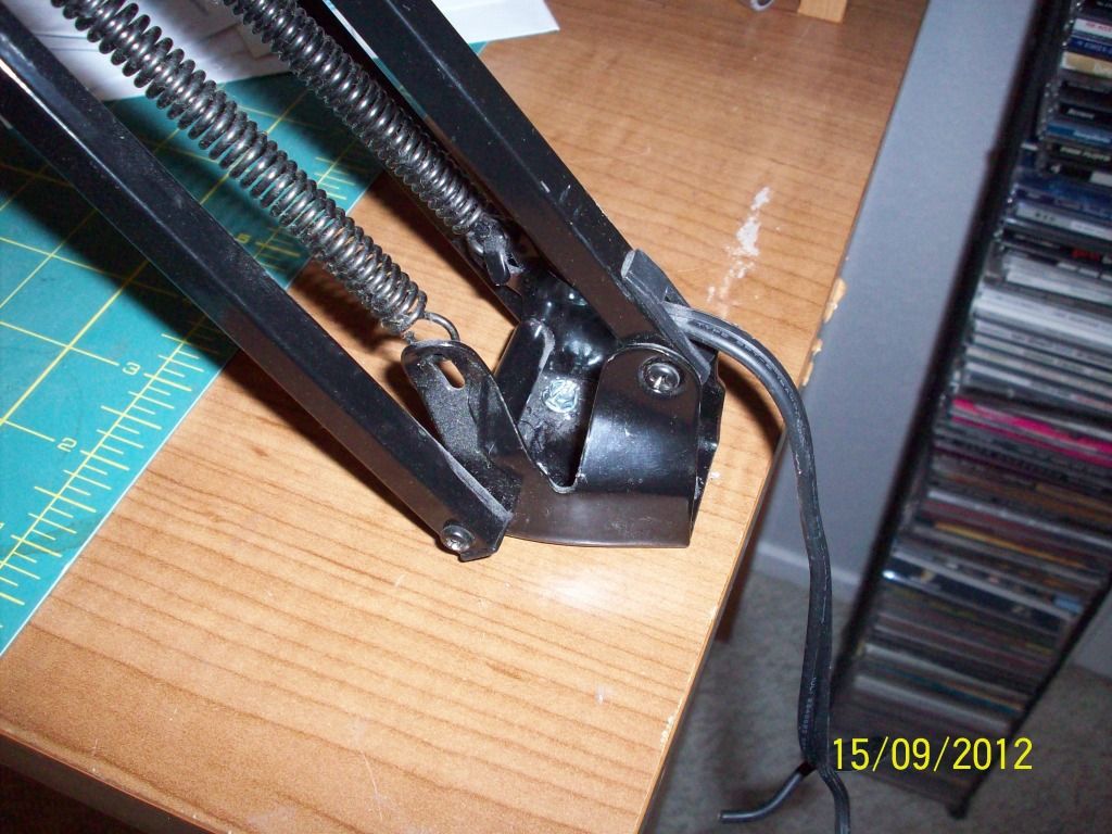

Thanks for all of your thoughts., and ideas. Its fixed and it didn't cost me anything ! Removed screws that held assembly to plastic box it outlets in it. Then took some sheet metal screws and anchored that part directly to table. It won't swivel, but never used it that much. Also never used the two outlets. Just have to connect wires and away we go !!............Harv
