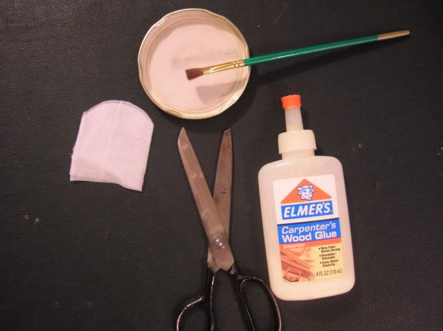

For years I have made my own scale model canvas and tarps from facial tissues. Toilet paper usually proves too porous in appearance for most scales and does not hold up as well as facial tissue when wet. You will need scissors, facial tissue, white glue (I use Elmers), a soft paint brush and a small container of water.

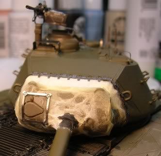

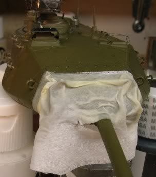

Begin by cutting the facial tissue into the desired shape and size fitting it as required. Once you are satisfied with the shape and size, place it in the desired location. Mixing a small amount of white glue and water together (50/50 mix), apply the mixture gently to the tissue taking care to retain the proper positioning. Only mix as much as you will need for one coat at a time and as I said, apply gently.
Note: I usually mix the second and third coats a little "Stiffer", instead of a 50/50 glue-water mix I generally go 60-65% glue / 40-35% water.

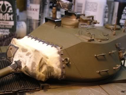

Once the last coat was dry on this M-41, I did a "Pre-fit" the PE items before permanently attaching them.

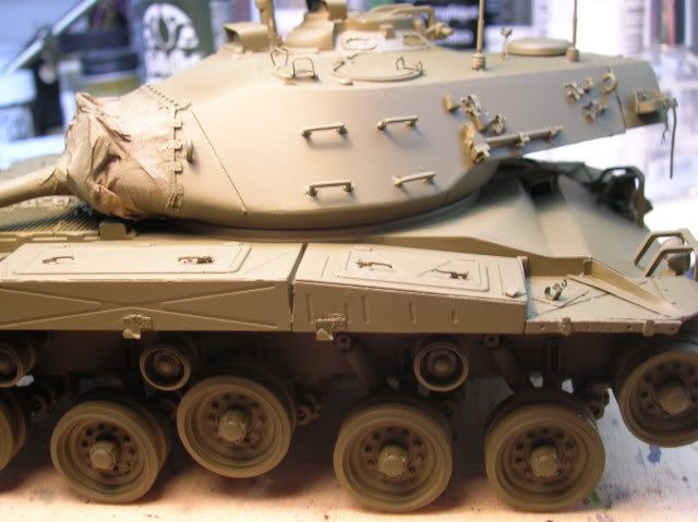

The canvas mantlet cover on this M-41 is now ready for some Khaki paint followed by weathering and shading.
Note: When weathering with washes, if your "Canvas" is not completely cured it may re-hydrate and rip!
