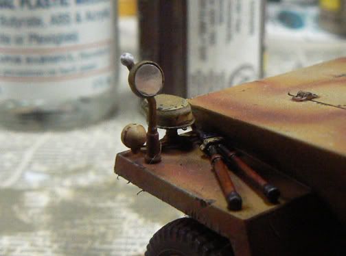

...Then one day while having a snack at the campus cafeteria I notice the wrapping I had just peeled from my chocolate pudding snack.

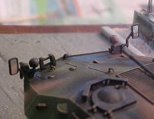

The look of it and the texture are just perfect to simulate mirrors. So I gave it a try and it became my standard technique to simulate mirrors.

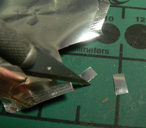

Just simply cut it with a knife and shape it to the desired shape. Then glue it with CA glue. This is useful especially for modern armor.

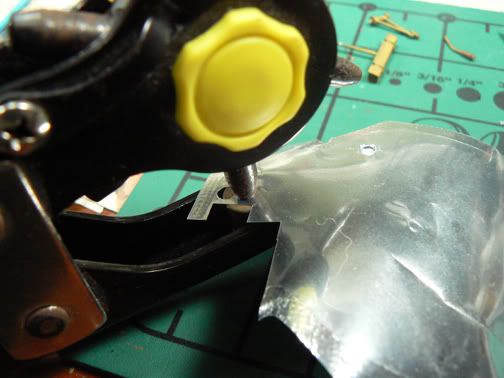

For round mirrors I use a leather puncher (a punch & die don’t work here) and cut a disc from the wrapping.
Then glue it in place.
