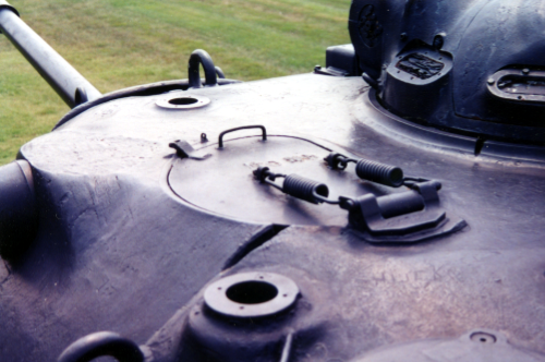

12) Scratch new handle and springs on the loaders hatch
13) Remove the lip around the loaders hatch on the turret

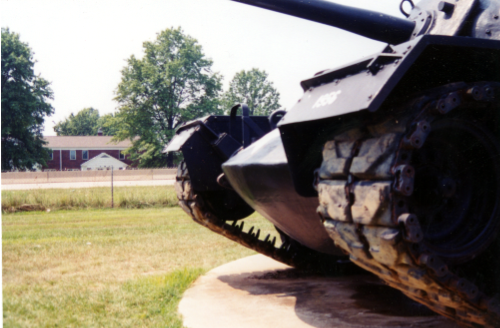

I always have to have lots and lots of pictures to work from.

Front lower hull, is shallow?
M48A2 lower front
Out of the box Tamiya kit lower front
It needs to be built up any way a person wants. I like a big blob of 3M spot putty. Yep lots of sanding, but that is how I figured out how to do it.

Moving to the turret, the lip around the loaders hatch is a little high and should be knocked down.
I file and scrape with a knife. I deepen the water run off grove with a saw. Then recontour the left side of the turret just a little.
I think I messed up a bit on the right side and took to much off.
