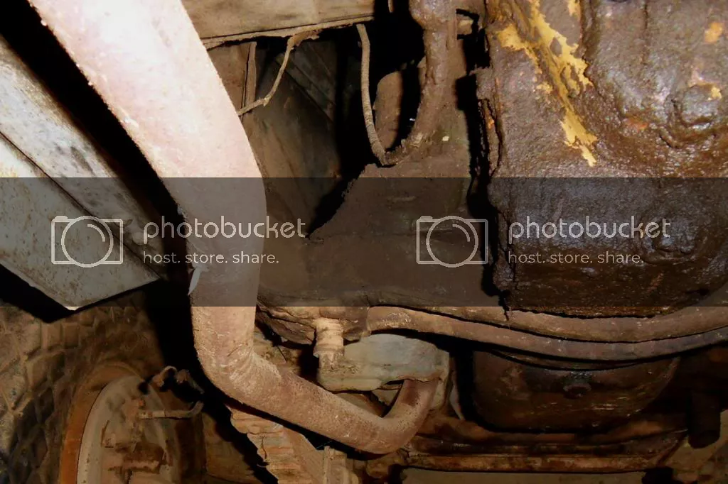

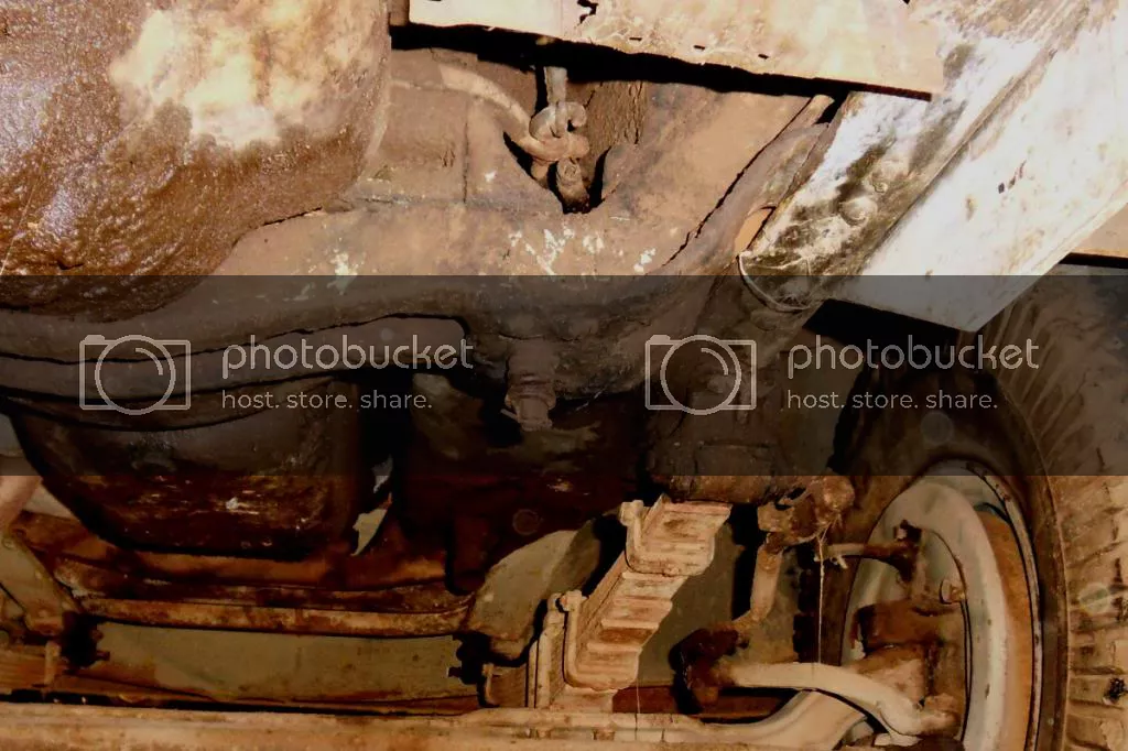

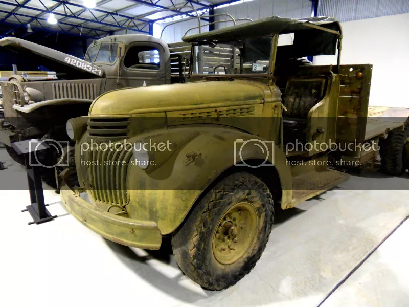

Tamiya's LRDG truck seems to be based on a Canadian Chevy truck ? Strange request but has anyone got a picture of one of these Chevy trucks military or civil with the front wheel off. Looking for pics of suspension, shock drum etc ?
Yea thanks, i did google it but hoped someone your side of the pond might have more luck or know of a variation of that Cab that has the same chassis layout.
Of course if there are no pictures i can make it up and no one will know.............maybe i should have kept that to myself..:)
Ok here is the closist thing I could find, not great but better then nothing.
Reference truck
I these next two the photos are focused on the engine mounts but you catch some of the front axle working
I'm still looking and will post more if I find anything. Nice find Pup!

That's cool. I was always wondering if there were any pics of this same truck in any livery OTHER THAN LRDG. Even civilian. I've been wanting to build another one but they only seem to be kitted in LRDG configuration.

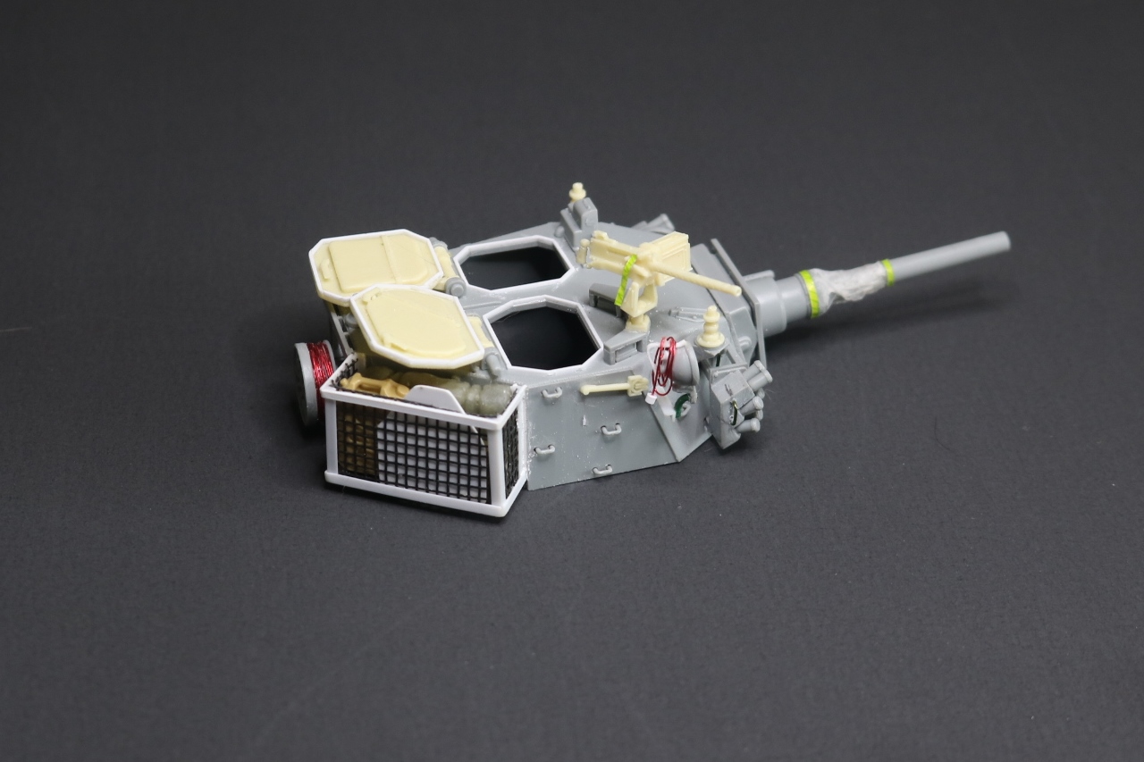

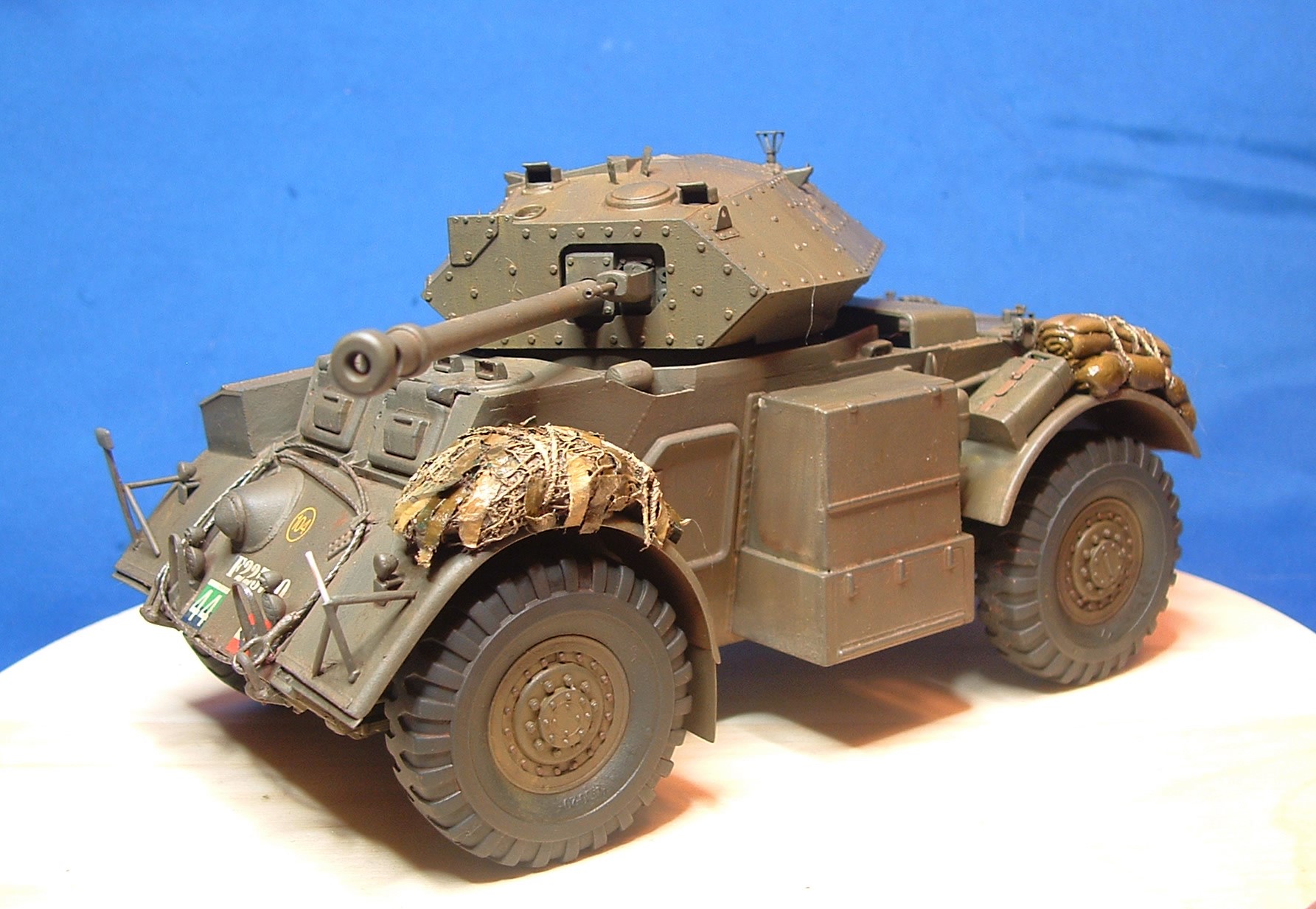

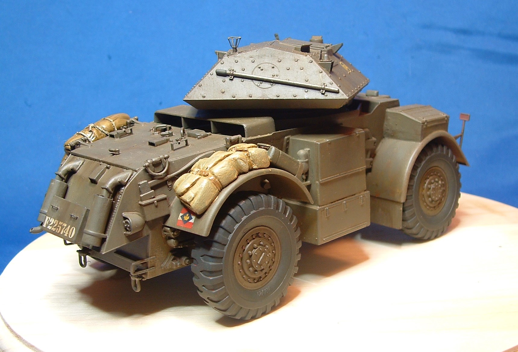

As said, it takes some experimentation to find what works best for you in any given application. In my Saladin build I used 2 part epoxy putty (Apoxie Scuplt in this case) for a large folded tarp/tent in the turret basket. For the dust cover on the 76mm barrel I used a single ply of Kleenex (facial tissue more generically) then held in position and shaped with a 50/50 mix of water and white glue. The bright green straps are the foil from a can of Sanpellegrino Italian soda.
The tarp on the left rear fender is Kleenex again only more plies, folded and soaked with the water/glue mix. The foil straps where applied while the tissue is wet so they can be cinched down and add a few extra folds.
The cam net on the right side was made from rolled up gauze bandage. (Cheese cloth can also be used.) For this one I used some dried oregano crushed up a little, and held in place with the water/glue mix. The foil straps where again positioned while everything was still wet.

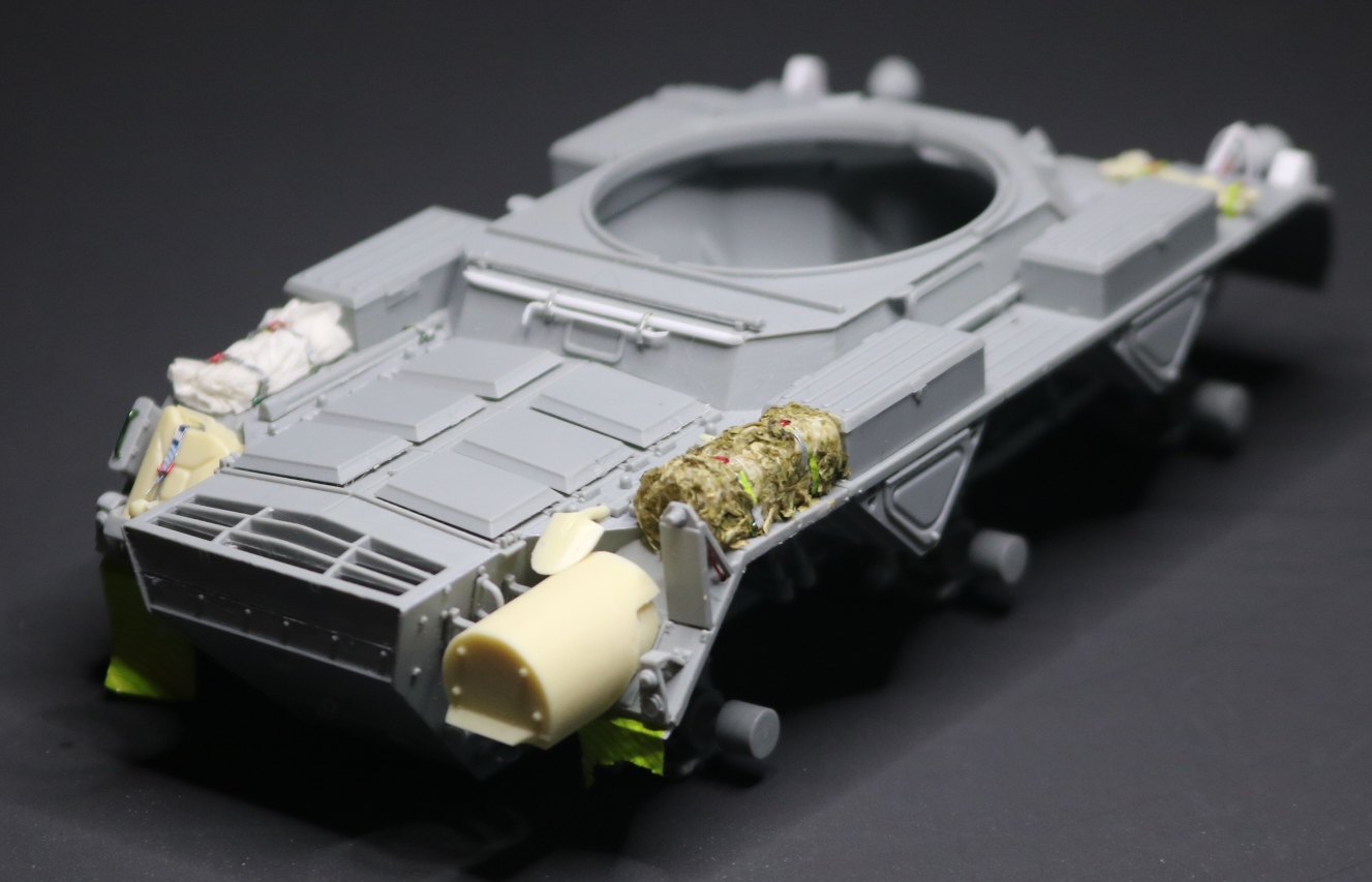

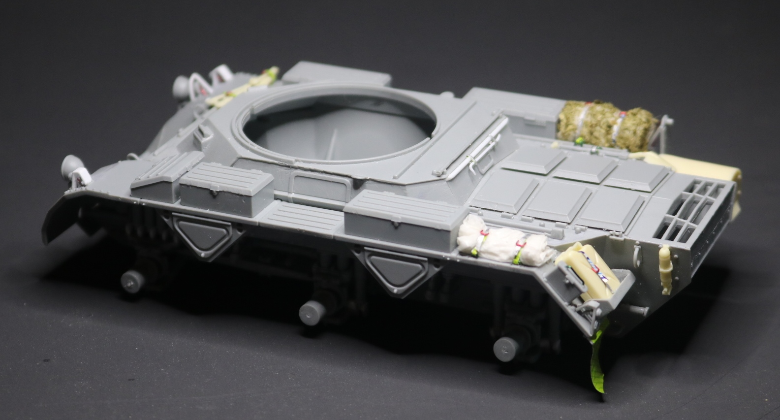

The tarps on my Staghound are epoxy putty and the cam net has thin strips of foil fed thru the net to look like the scrim used on British cam nets in NWE. The tie downs are embroidery thread soaked the water/white glue mix.
