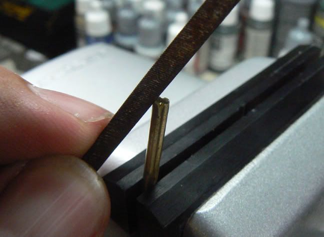

Using a triangular file I made some grooves all along the circumference of the rod.
Here is a close up of how it looks. Now you have your own “flower punch”.

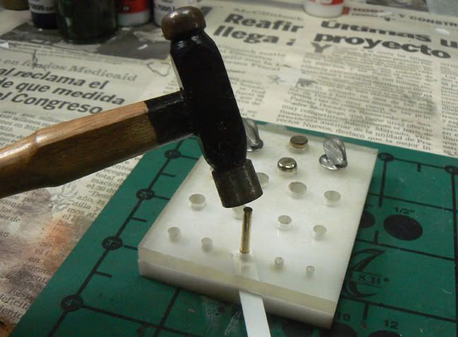

Once this was done I used a punch & die set and some 0.10 mm plastic sheet. Using the brass rod I punched out some flowers.

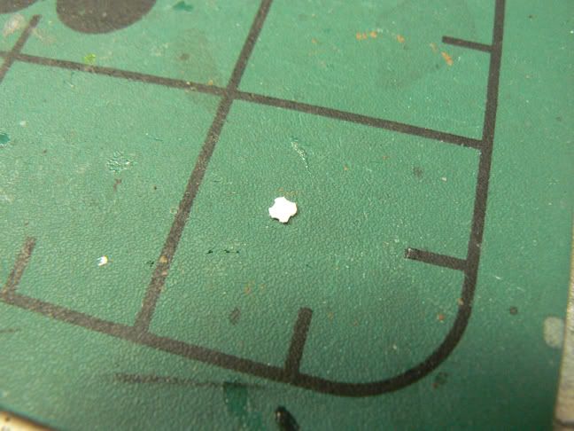

This is how they look.

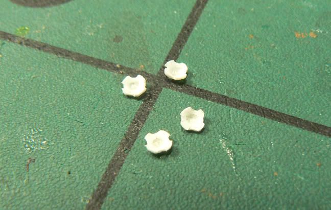

I then used a round file to push the center so they don’t look flat.
Here are some ready to be used.
