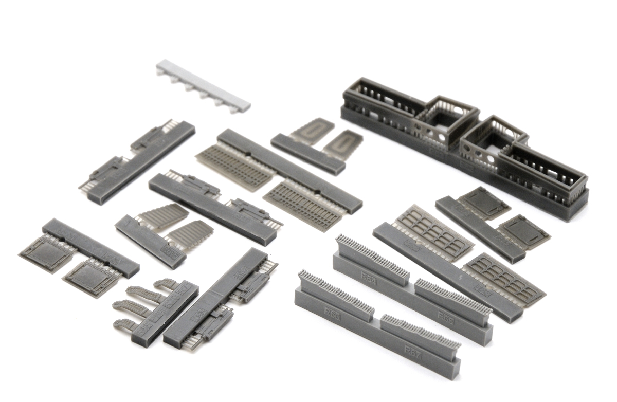

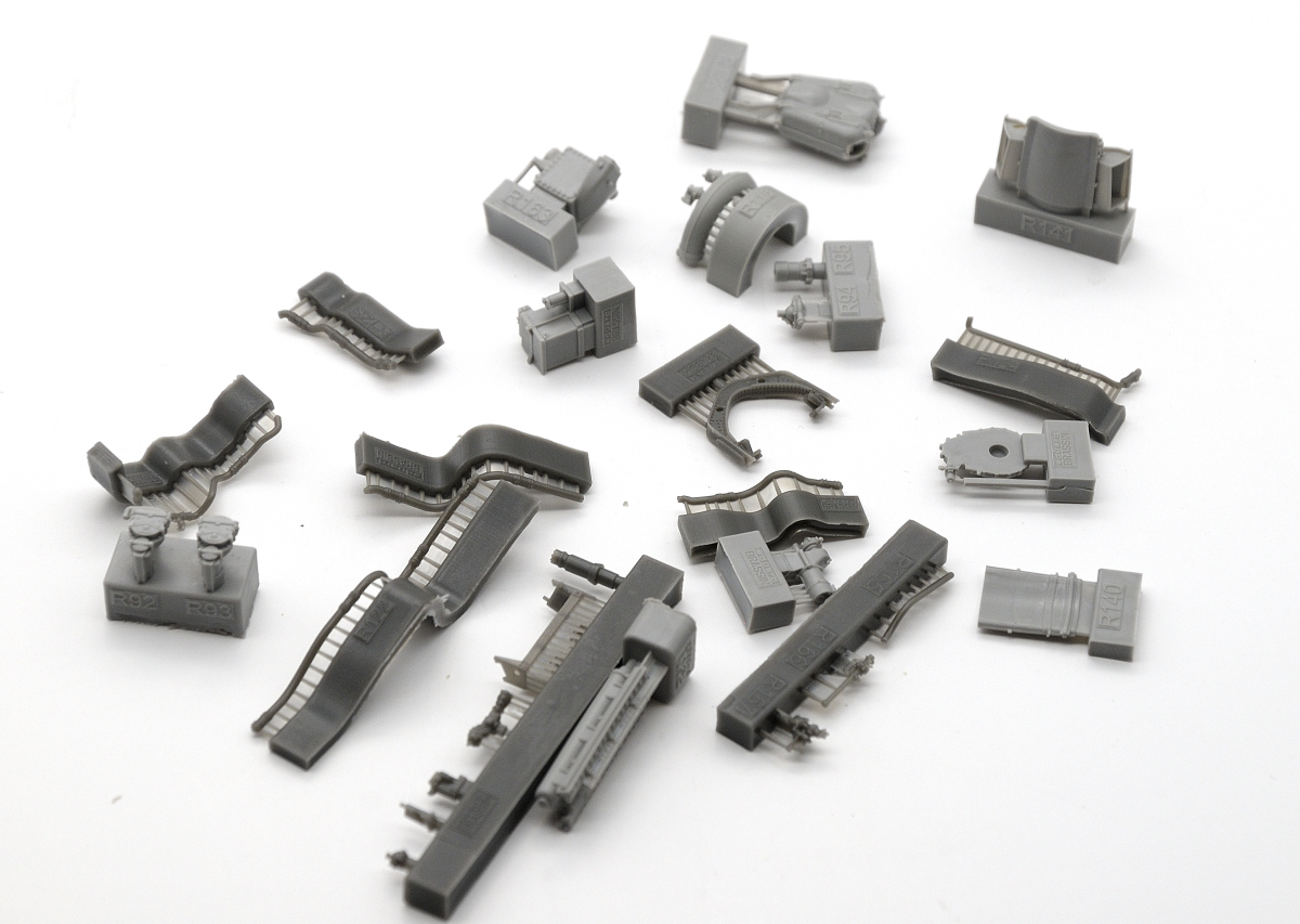

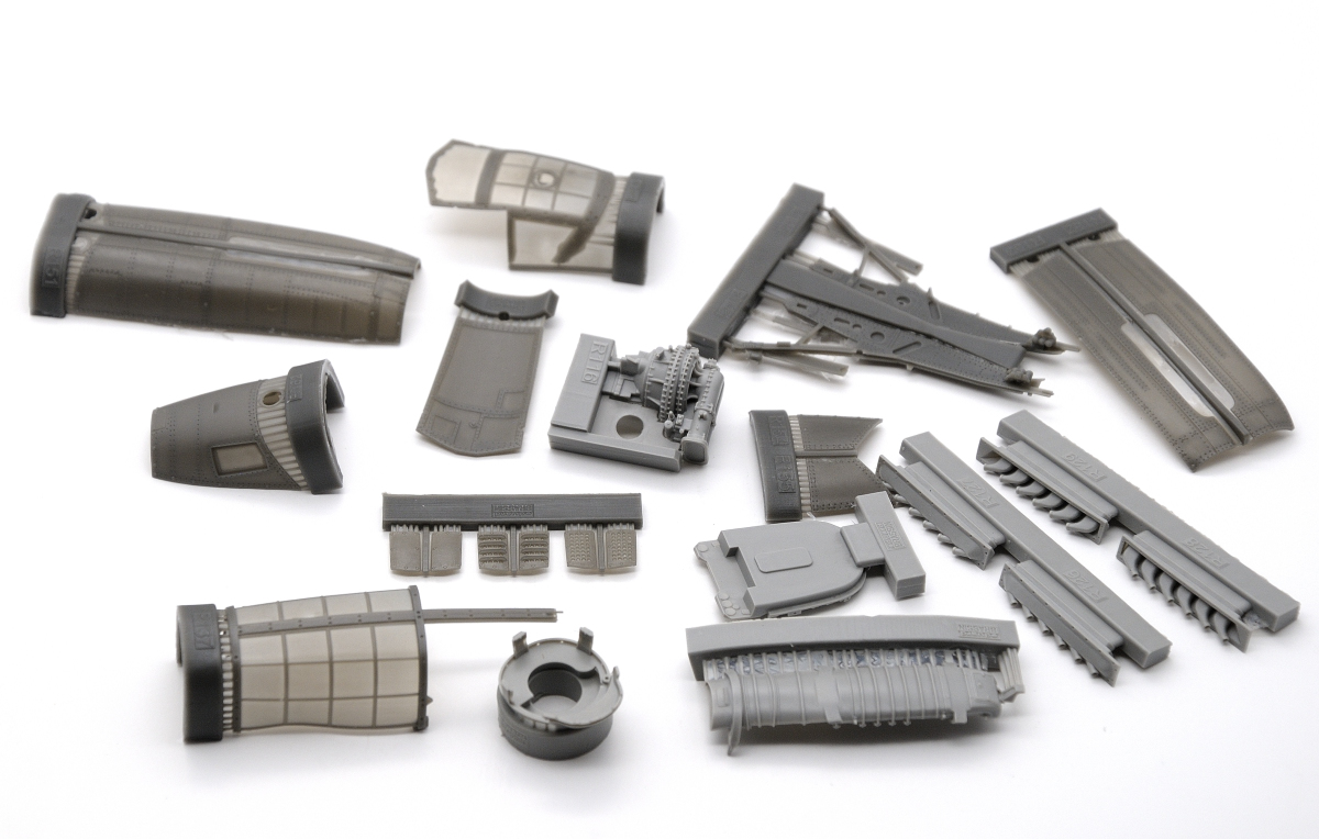

Gun bays and covers

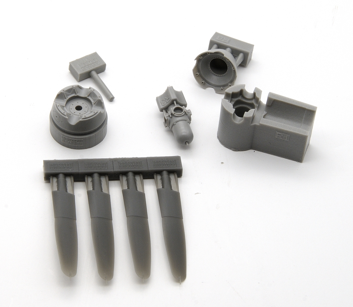

Engine parts
Hamilton Std prop with jig for setting blade angle.

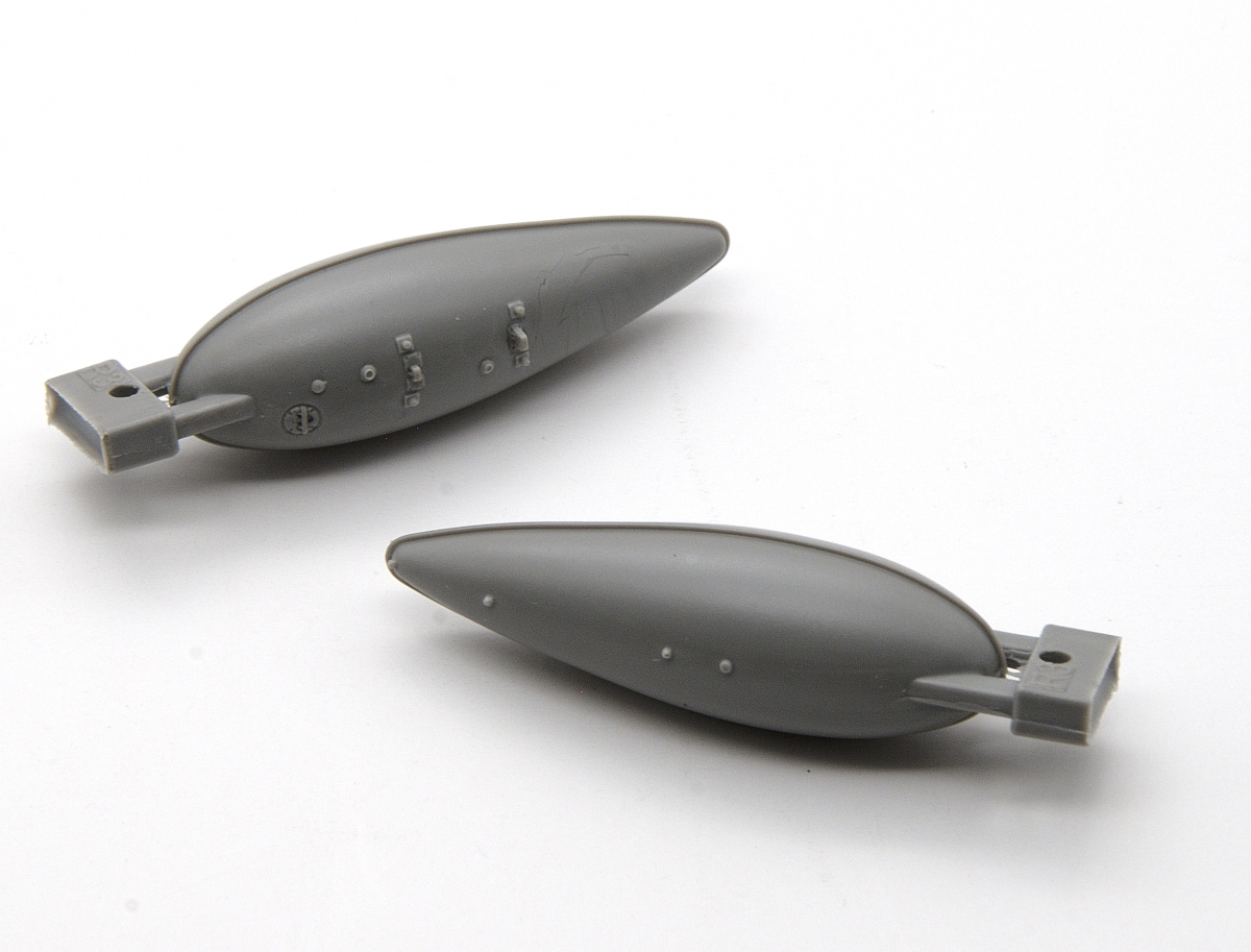

200 Gal Drop tanks ( one piece mouldings)

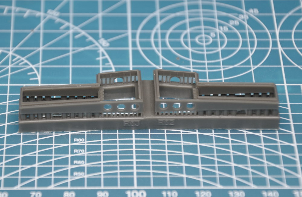

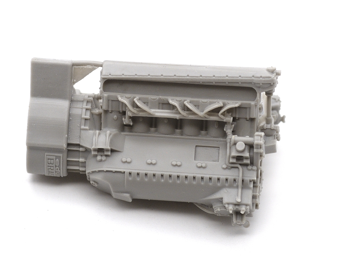

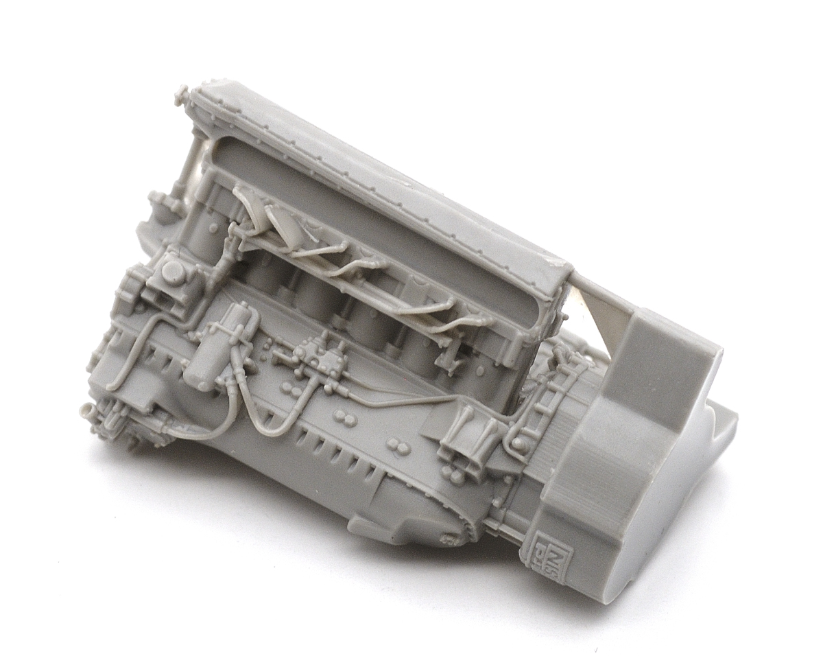

Engine block with its pouring block

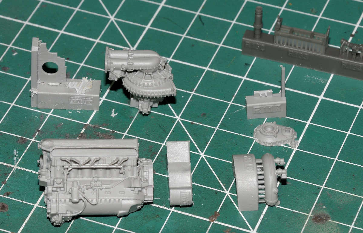

First job with any resin is hours of cleaning up the parts, actually this is easier than the old Aires kits as the attachment points to the blocks is much lighter.
You get the idea, this stuff is mega fragile and even holding these parts firm enough to carve the excess off is a mission... Don't forget this is 1/48..

Looks swell Paddy, I take issue with the ignition wires or fuel injector lines, whatever that is, is the space between the lines and the block thin enough to carve out?

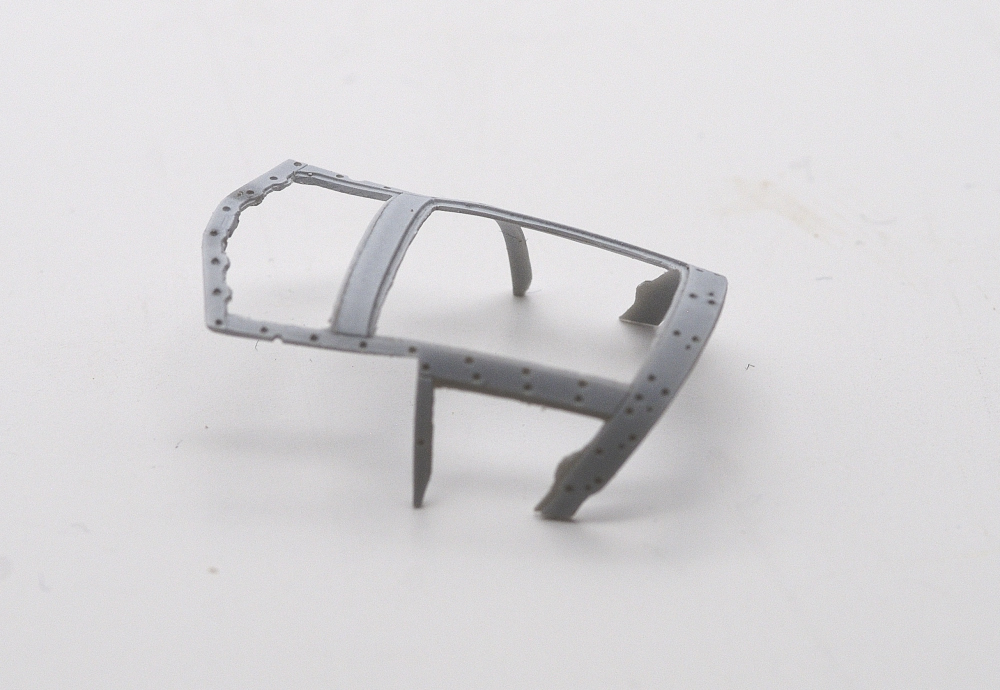

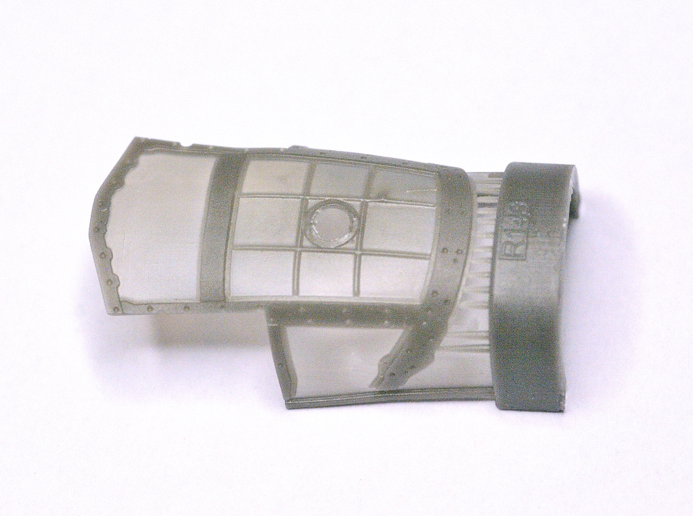

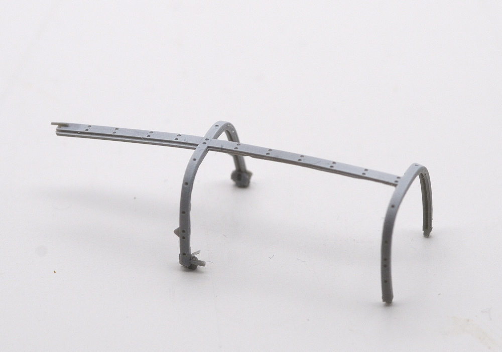

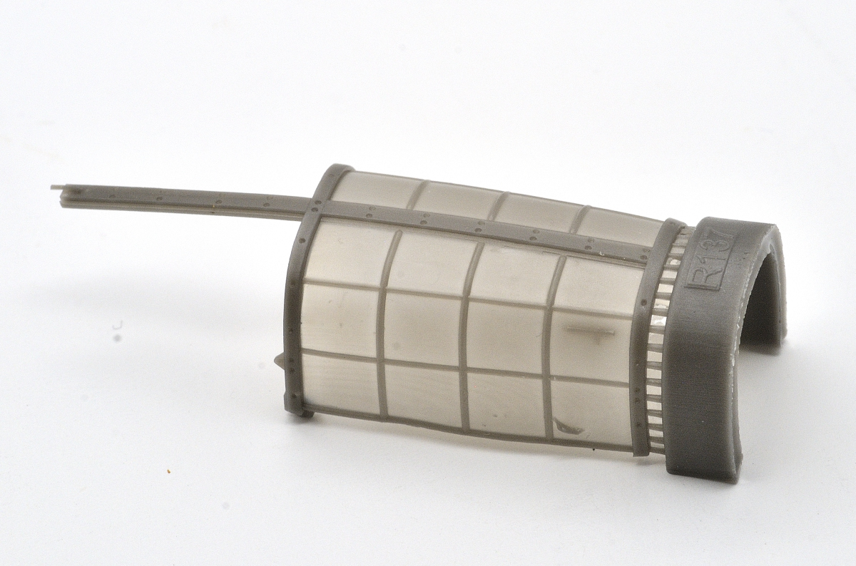

The canopy frame is nice, how's the panels, good and thin?
I must say I'm not too impressed with the mold blocks on the fuel tank They look like they would leave quite a blemish. Otherwise looking forward to watching this build come together.

The panels are wafer thin, almost transparent however the chances of them fitting round the engine is nil .. i think the idea is that they are displayed alongside the model. You are spot on with the ignition leads, absolutely no chance of saving them, i will replace those on top but the ones on the side will never be seen.
Hi James, one of my pet gripes about resin is where they put the blocks but i am sure there is good reason, like wise when they but ejector marks in wheel bays when they could put them on the other side, i suppose the pin has to go on the inside of a curved surface ?

Correct Bob, also once painted black and incased behind the outer framework and engine bearers they are way out of sight, also don't forget the whole engine is just over an inch long...the leads under half inch in total.

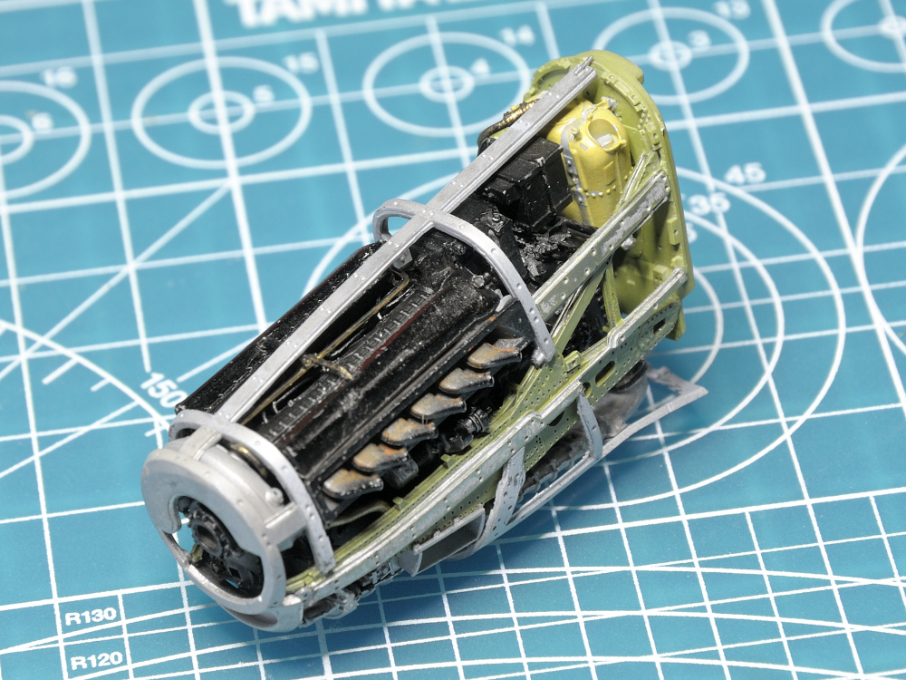

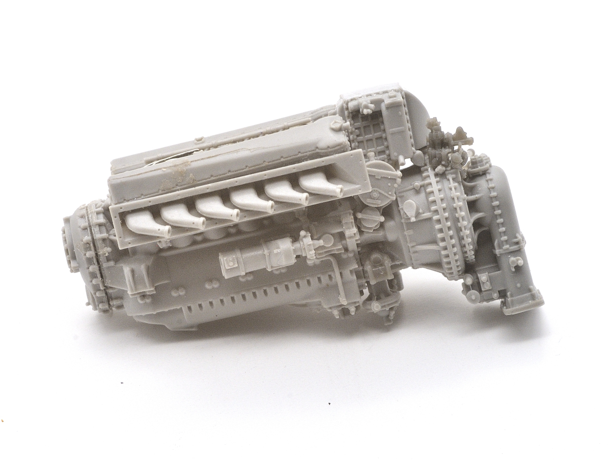

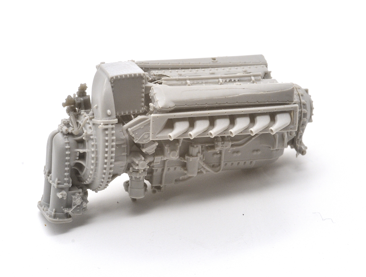

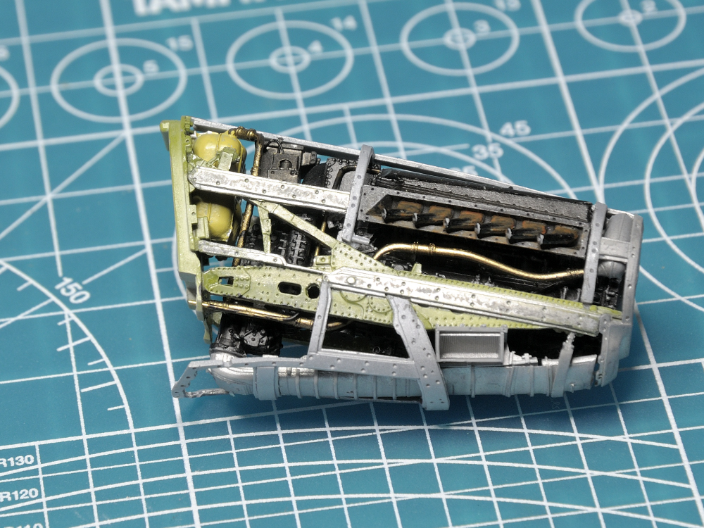

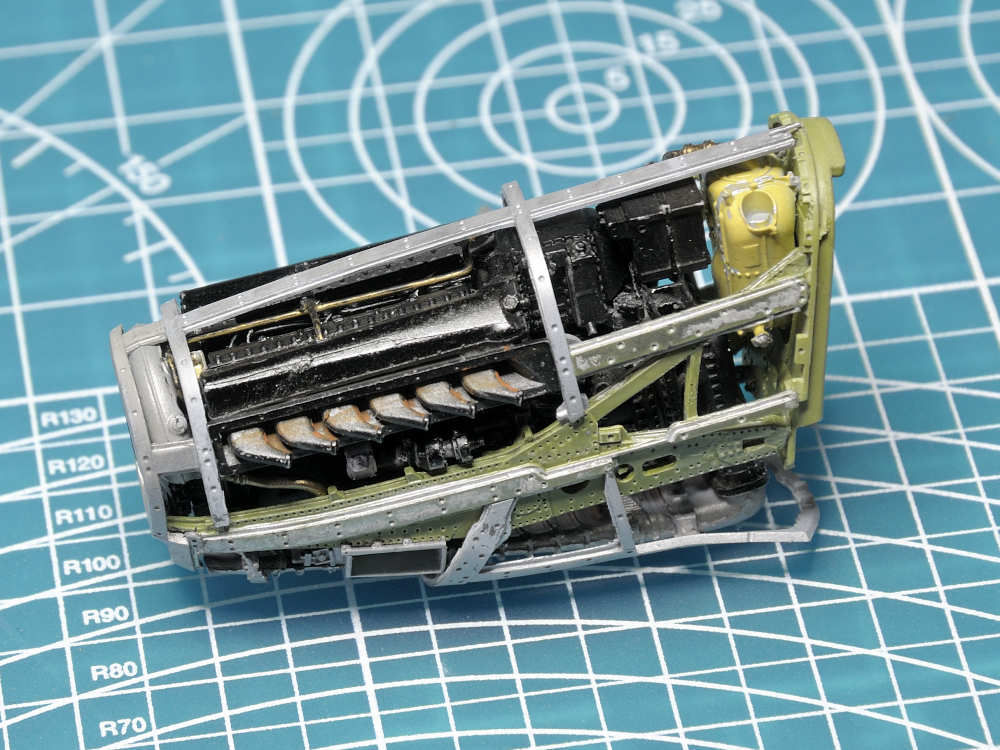

The engine assembles up very well, it consists of approx. 60 parts with the bulkhead and plumbing and including its new outer panels that replace what you need to cut off the original fuselage. Time spent on cleaning up each part will be time saved later when you try and assemble, for example if you don’t get the supercharger parts and carburettor positioned correctly, I doubt you will ever get the engine bearers and outer frame work to fit later, likewise with the positioning of the under engine air intake assembly. If all goes to plan it should look something like this.
I have gone with an interior green bulkhead and engine bearer , chromate tank and silver outer cowling support framework. This seems to be one of many finishes used but does seem to be the more common choice in modern restorations. It may also depend on the overall scheme but again I haven’t decided what to do yet. Normally with a Mustang they are so colourful the finished scheme is an important choice, but I hadn’t really reckoned on the fact I was about to cut the whole front of the model away which removes about 90% of the individual identity of the aircraft. Initially I thought about “Cripes a Mighty” but cut the front off and its basically just a blue rudder ….

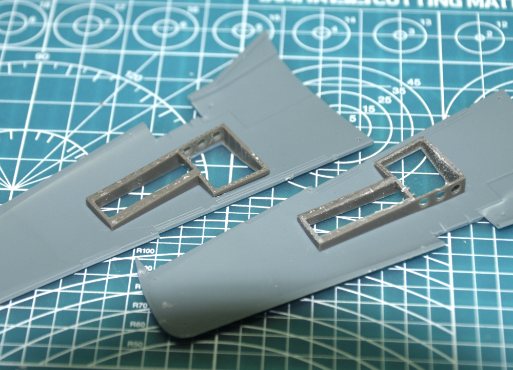

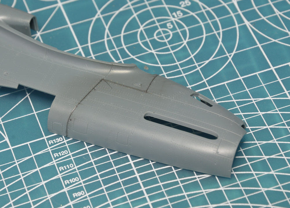

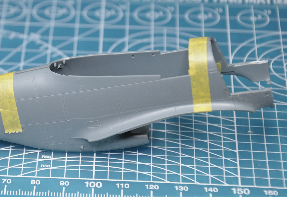

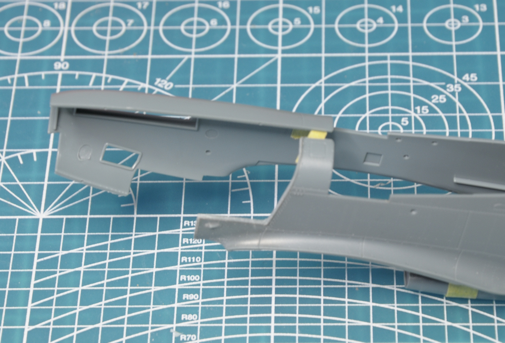

Bit of major surgery last night :)
Its not always the case that panel lines are exactly the same on both sides so while it ok to cut to the lines on one side, always check befor cutting the other side. This Eduard kit is very good.
Make sure you get this right or you have a load of scrap plastic on your hands :) Secret is to cut about 1mm larger than the panel lines then trim down to size using the ready built engine assembly as a guide.

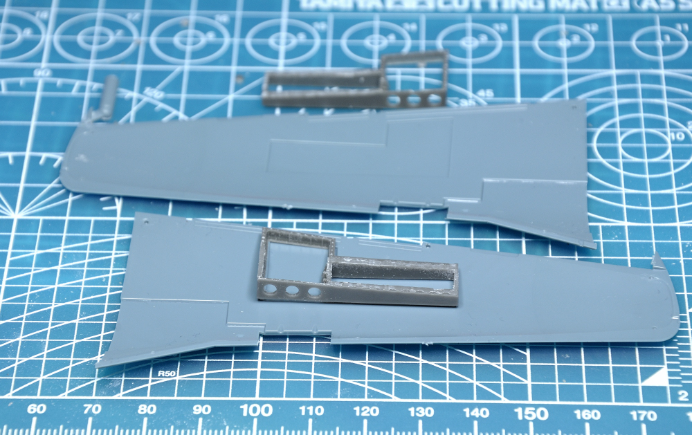

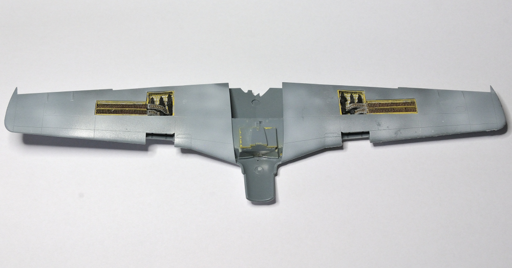

Wing surgery complete...the patient is doing well.
Gun bays, although they look like PE they are still resin
There are guides to cut too and they are pretty close but as with the engine, cut small and open up to fit........you cant put it back. As any chippy will tell you measure twice cut once.
