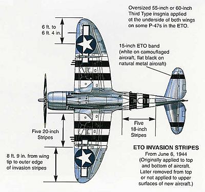

Looking on line it says D-Day markings/stripes were 24 inch wide on twin engine aircraft and 18 inch on single engine .
well 24 inch as 1/48 is easy, thats half inch, however that looks much wider that most pictures of P-38's
I wonder if they went with the 18 inch markings or if the USAF had their own spec ?
Probably one for RichB :)
24" would be a 12.5mm stripe
18" would be a 9.5 mm stripe
I have some 10mm tape :)
positioning on the fuselage was 18 inch forward or the leading edge of the tail plane so stripe width does effect how far up the fuselage the stripes went as they either cover or not quite cover the air scoops.
I thought it was Tactical aircraft vers Strategic aircraft.
I got this I saved from some where.
I can't add a file. Looks like I ran out of disk space.
For those interested this seems to be the official memorandum
Also note the markings were to be washed off with hot water in July, 4-5 weeks later so quite short lived.

As is usual with markings applied by the squadrons themselves, as opposed to on the production line, there was some variation in the location and size of the markings. The ORB entry for No 313 Squadron states "In the evening the aircraft were marked with 15 inch (sic) black and white stripes on the wings and fuselage”. That the stripes applied to their aircraft were actually 15 inch rather than the 18 inch laid down is not known, but it suggests that there might have been some variations in size. Photographs provide ample evidence of variations in the location of the markings. For example, Mustangs from the Polish squadrons typically have the last White band on the fuselage painted over the Sky band, perhaps so thet the aircraft’s individual letter would lie on a black stripe and so be more visible.

That's what I was trying to post earlier.
ha ha thanks Bob so thats different again :) like all these things it seems to be the official was a rough guide :)
