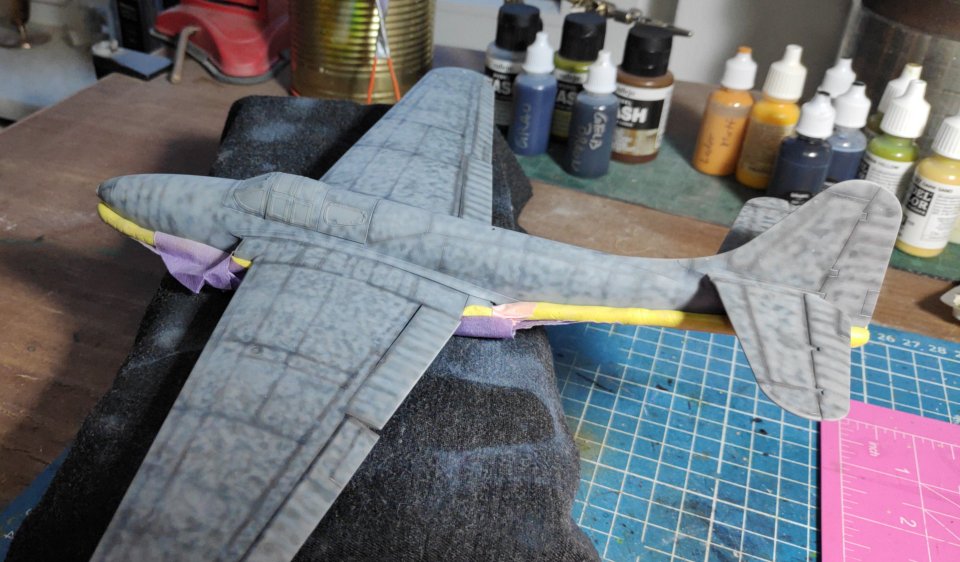

This is when all three grey preshades are applied

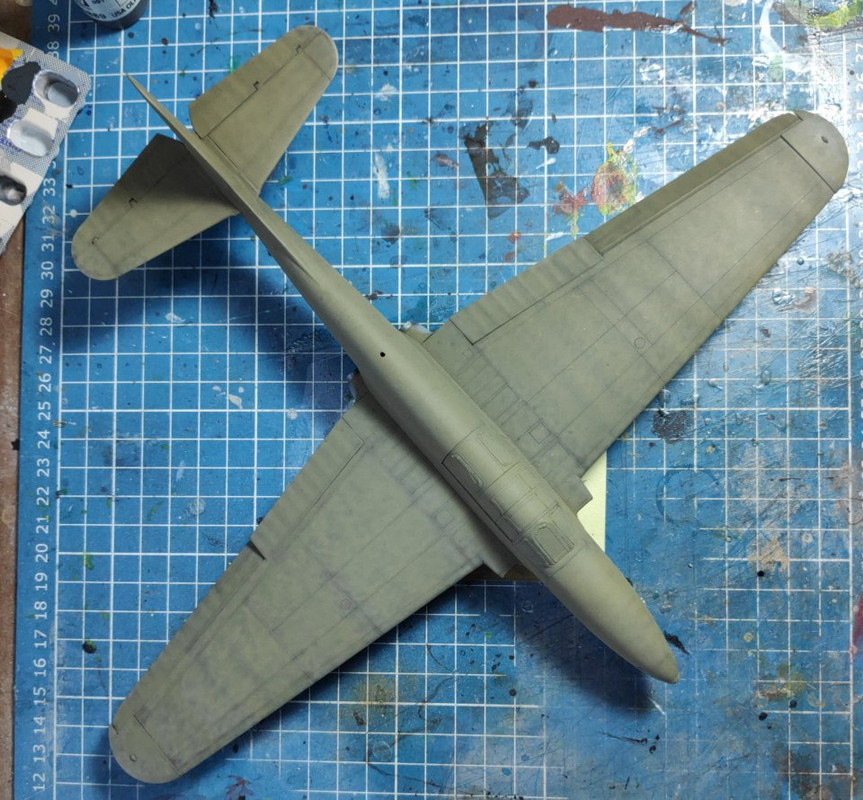

and this after both greens were on
