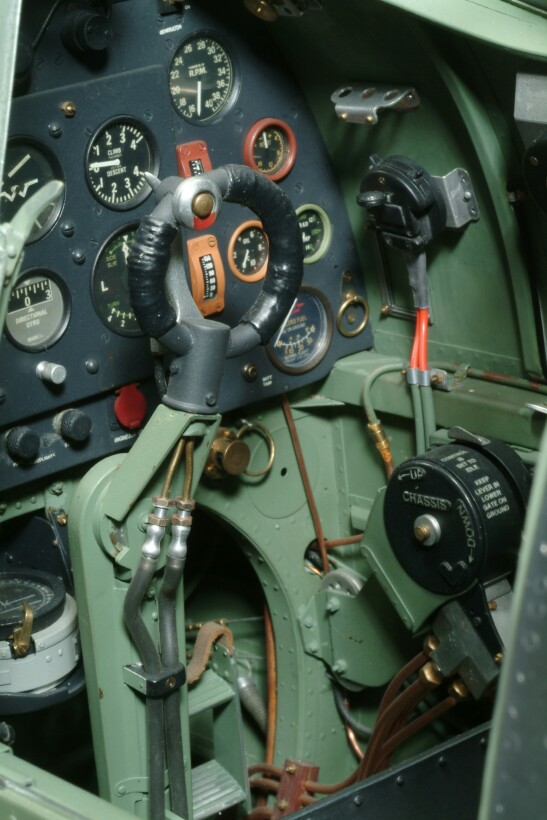

The second model is going well; far better than the first. However, this post is not about that. This post is to show a new reference source I found. This is a photo of a model cockpit!:
Now, yes, it is 1/5 scale and the whole plane is probably bigger than me, but the photo gallery looks great. There is also a Mustang with fantastic photos: https://www.warbirdsinmyworkshop.net/spitfire-mki-gallery
This may already be on here somewhere, but I just found it!

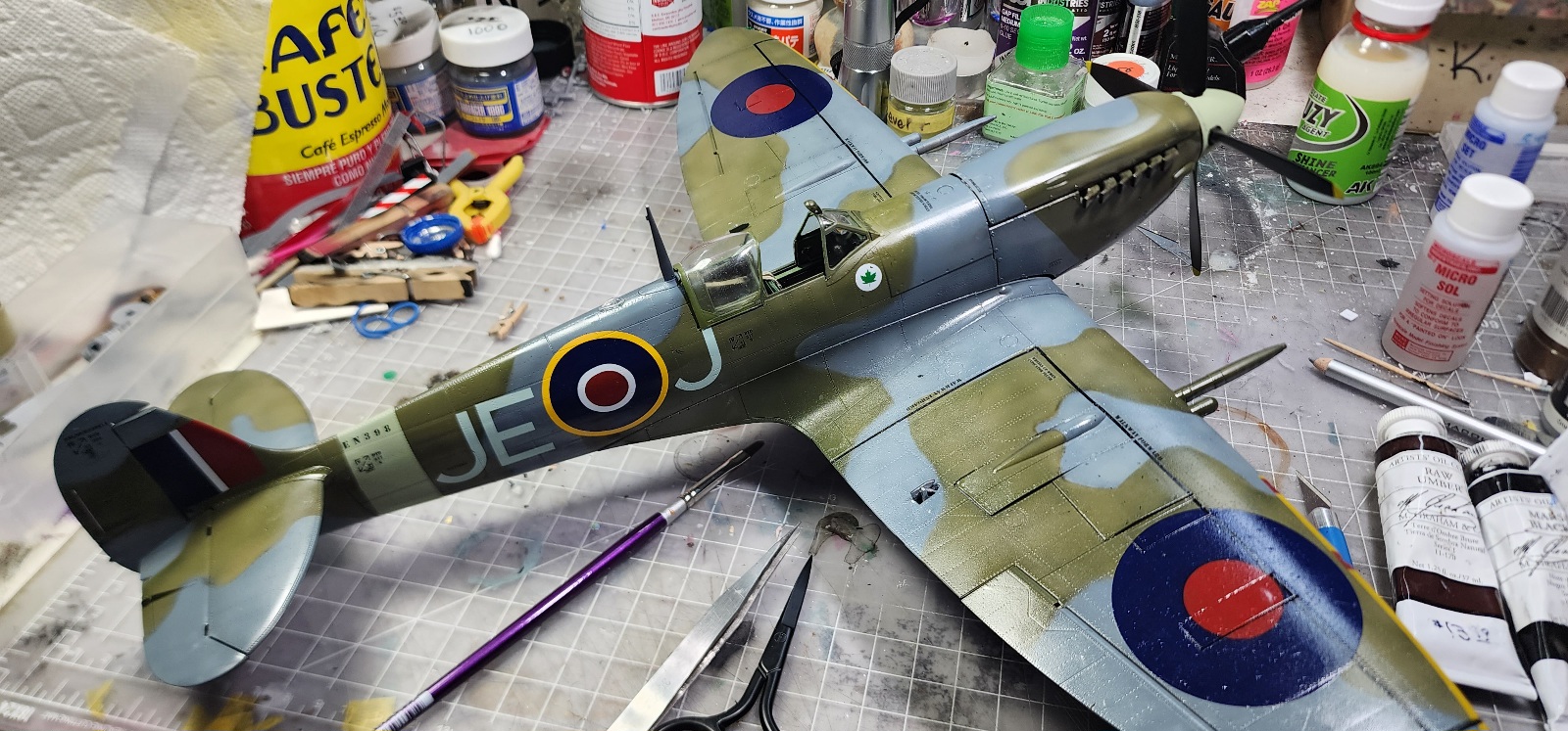

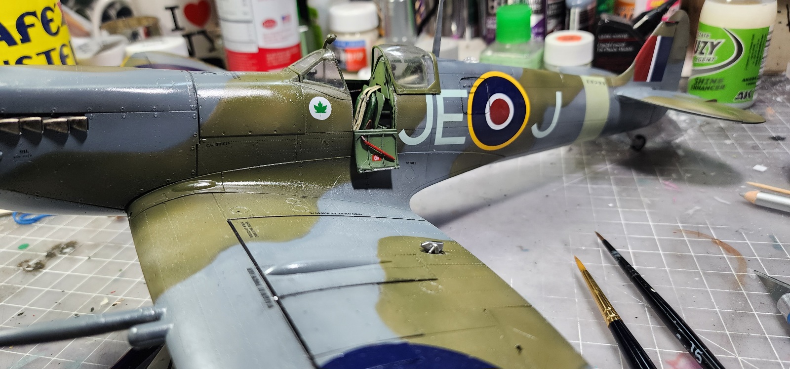

I need some advice. I have my spitfire painted and decals on. I have never used the sludge weathering method with pigment, water, and dish soap, but want to try it. Do I need to seal the surface with a gloss or matte finish or nothing? I don't want to fill in all of the rivet holes with a finish, but I don't want to sludge the decals then not be able to get it off. Do y'all have any idea?
With mine since finding MRP paints which are semi gloss i do the semi gloss paining camo then decal as its a good smooth surface then weather with oils that can be removed/spread/thinned with white spirit without effecting the MRP paint then mat coat

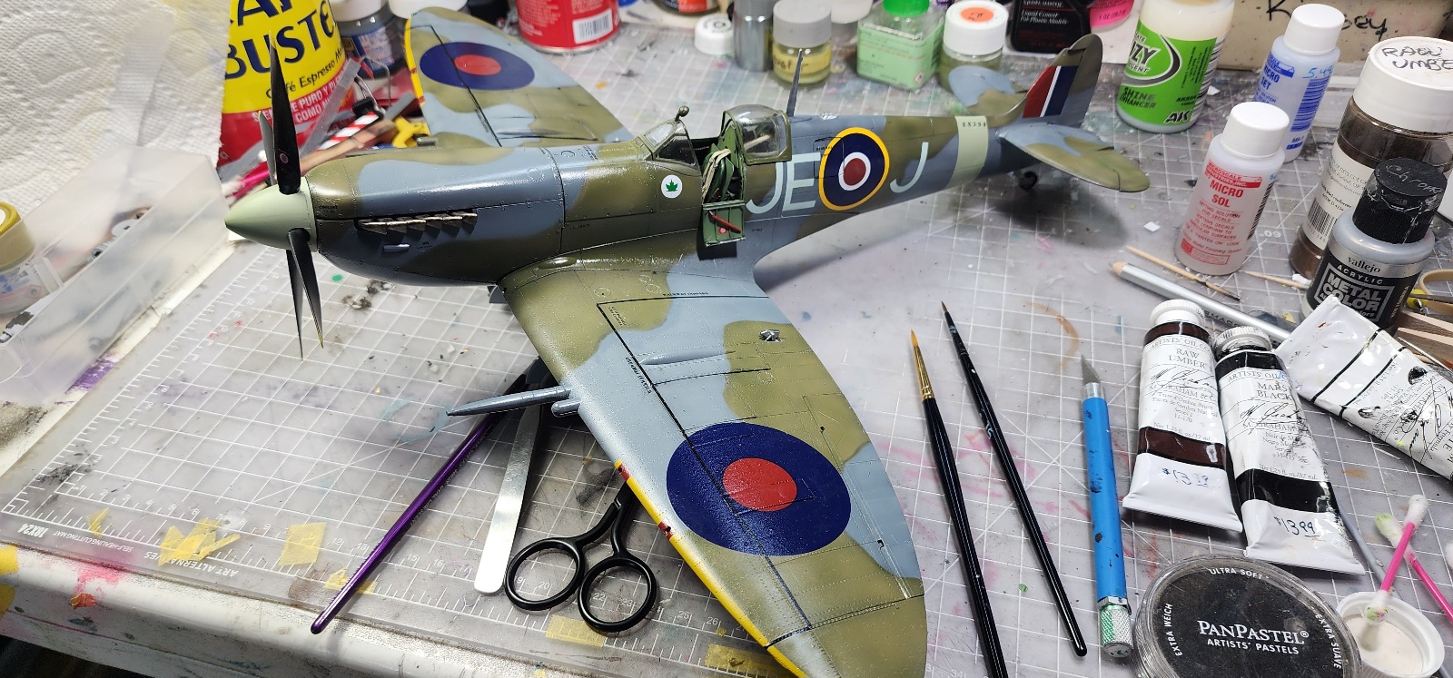

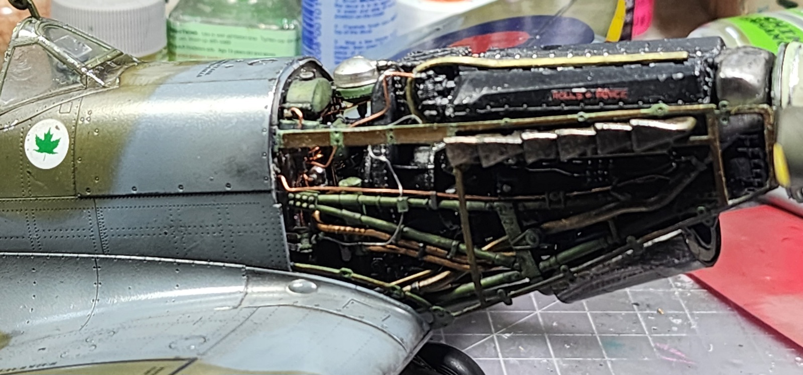

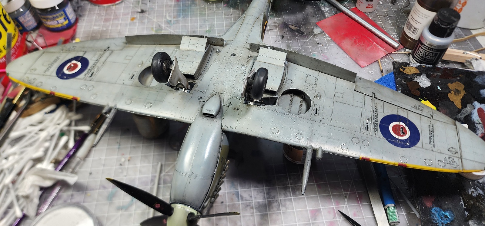

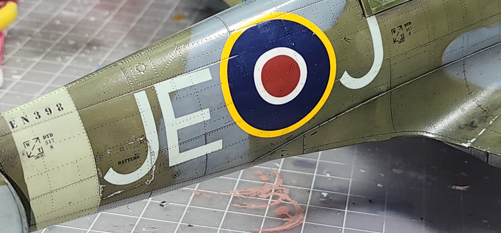

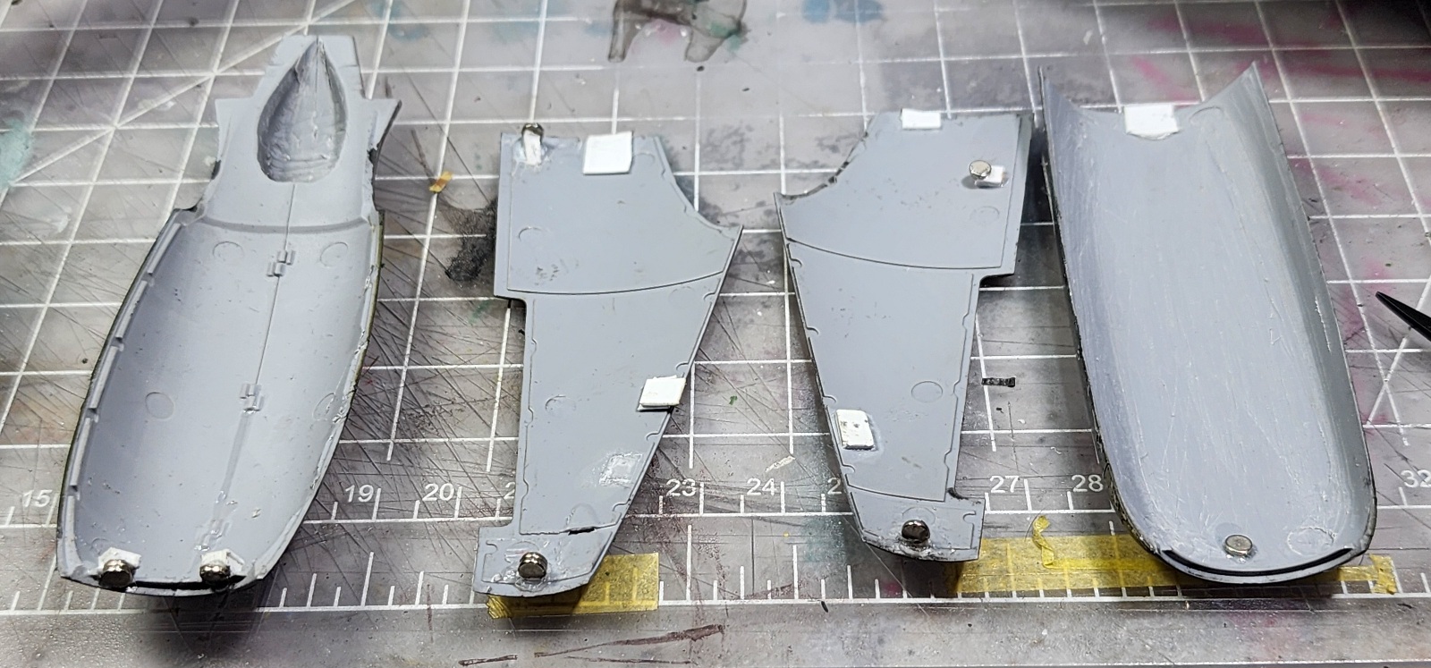

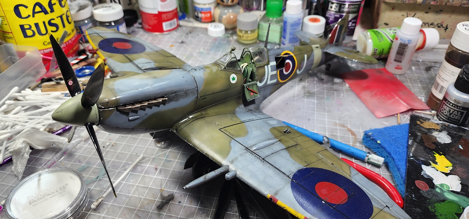

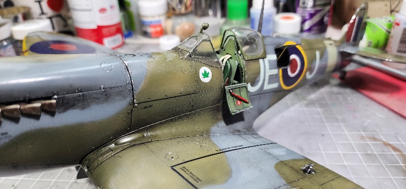

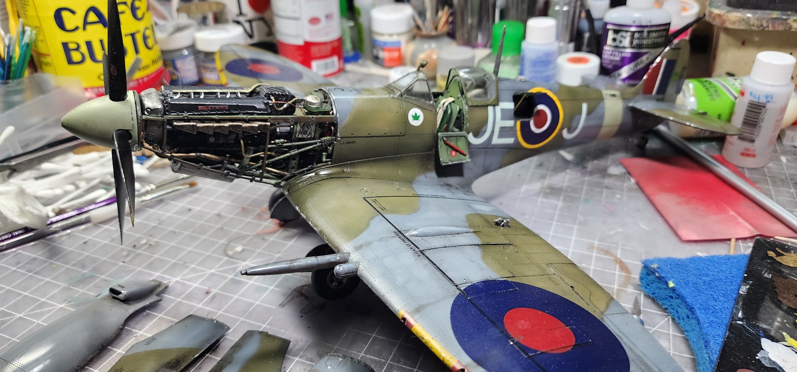

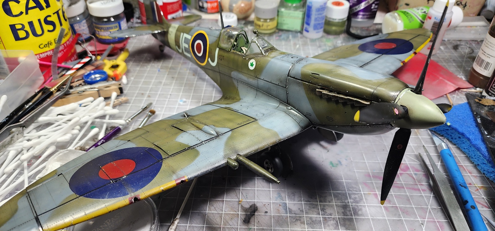

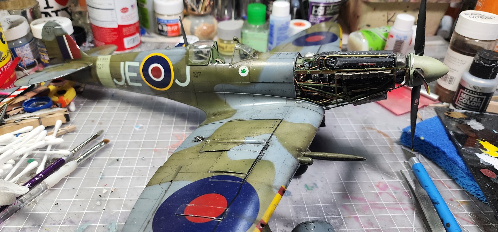

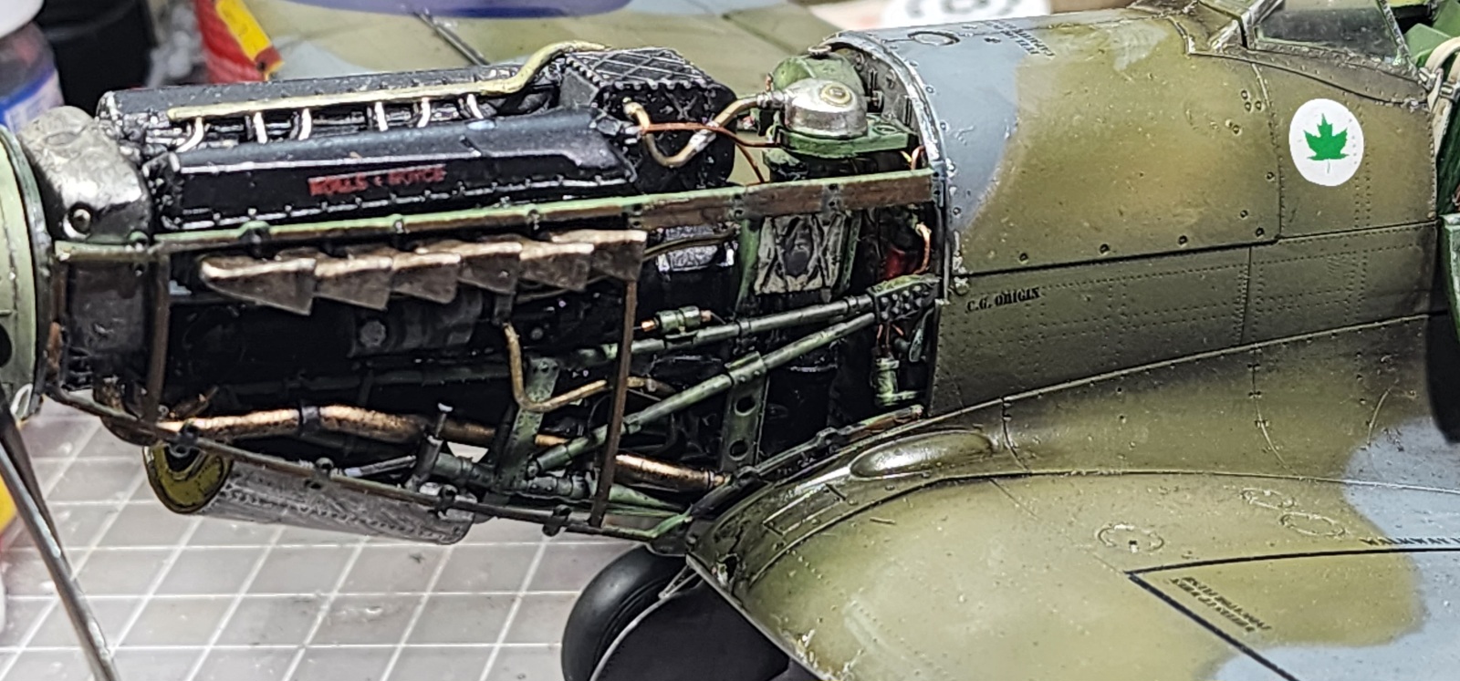

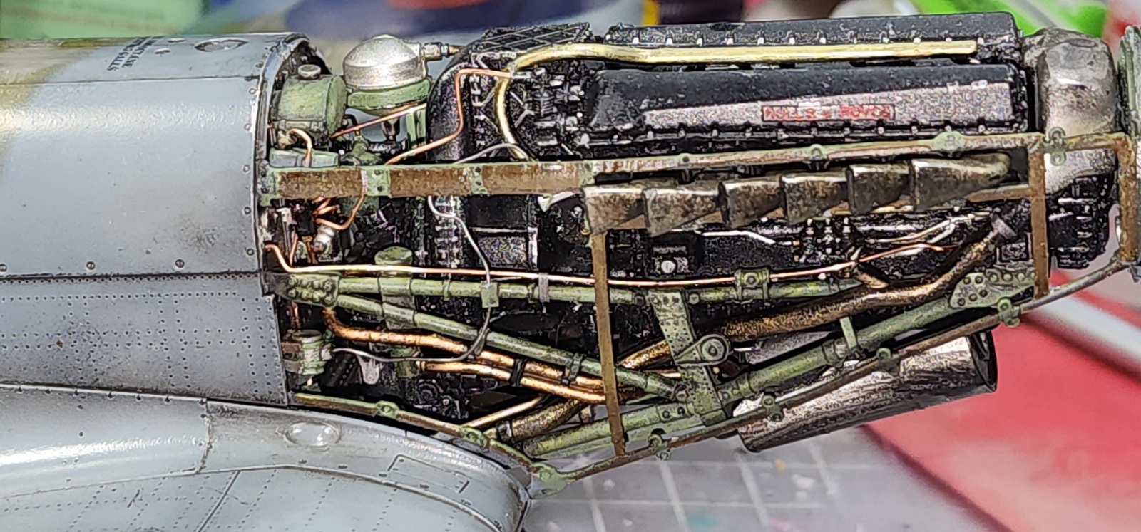

I have the oil weathering done. Now to let it dry a couple of days before putting a matte finish on it. I could never master @paddy 's "card trick" for holding removable panels, so I mixed in some 1/8 X 1/32 earth magnets to supplement. There are some pre-weather and post-weather pics here. "Real" photos will come after the matte finish is on.
