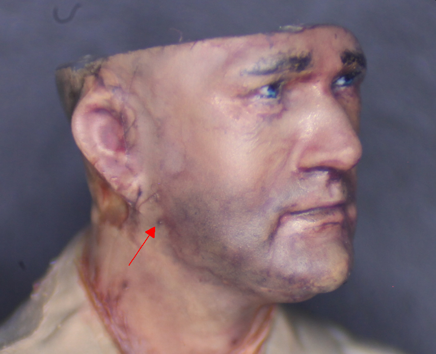

Saul, that's why I did this without primer, when I primed it first, the entire face was covered with those. It may not be visible to the naked eye, but under magnification, the tiniest overspray looked like 80 grit sandpaper. While it may not make a difference with some methods, my way of using super thin paint requires the basecoat to be dead flat and well cured.
