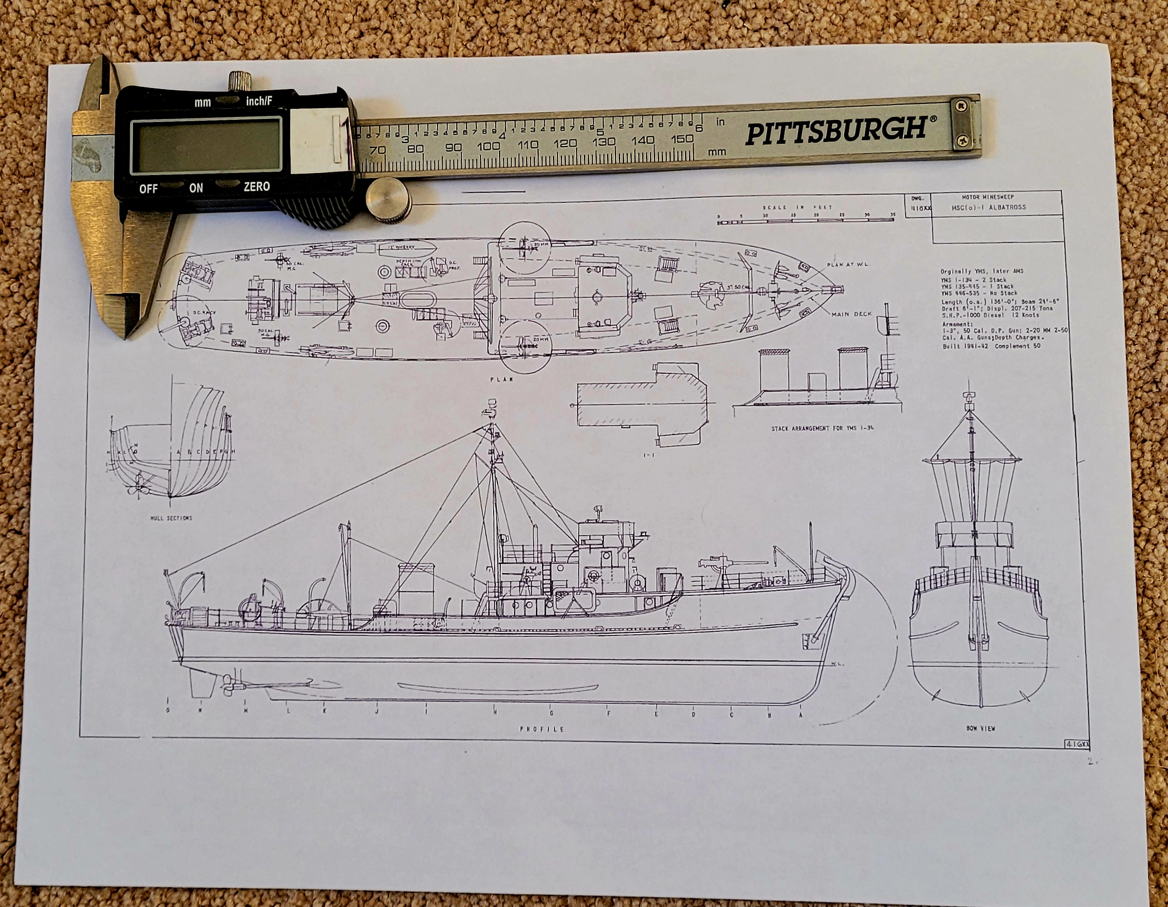

YMS-1 class Minesweeper YMS-328 in the WWII fit. Long before her conversion to The Duke's Wild Goose yacht. The build begins with the original Minesweeper deck plan drawing, a digital caliper and a calculator.

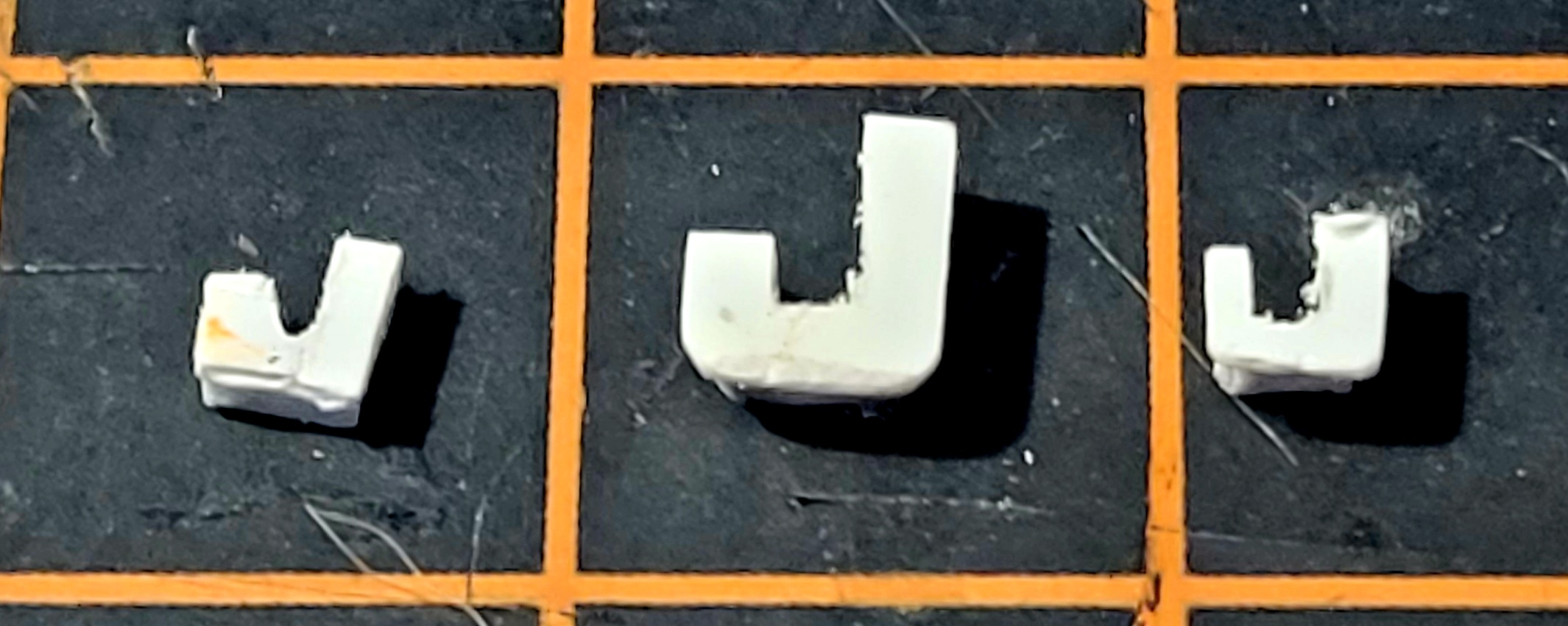

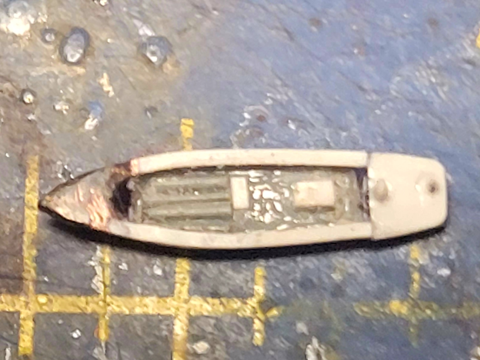

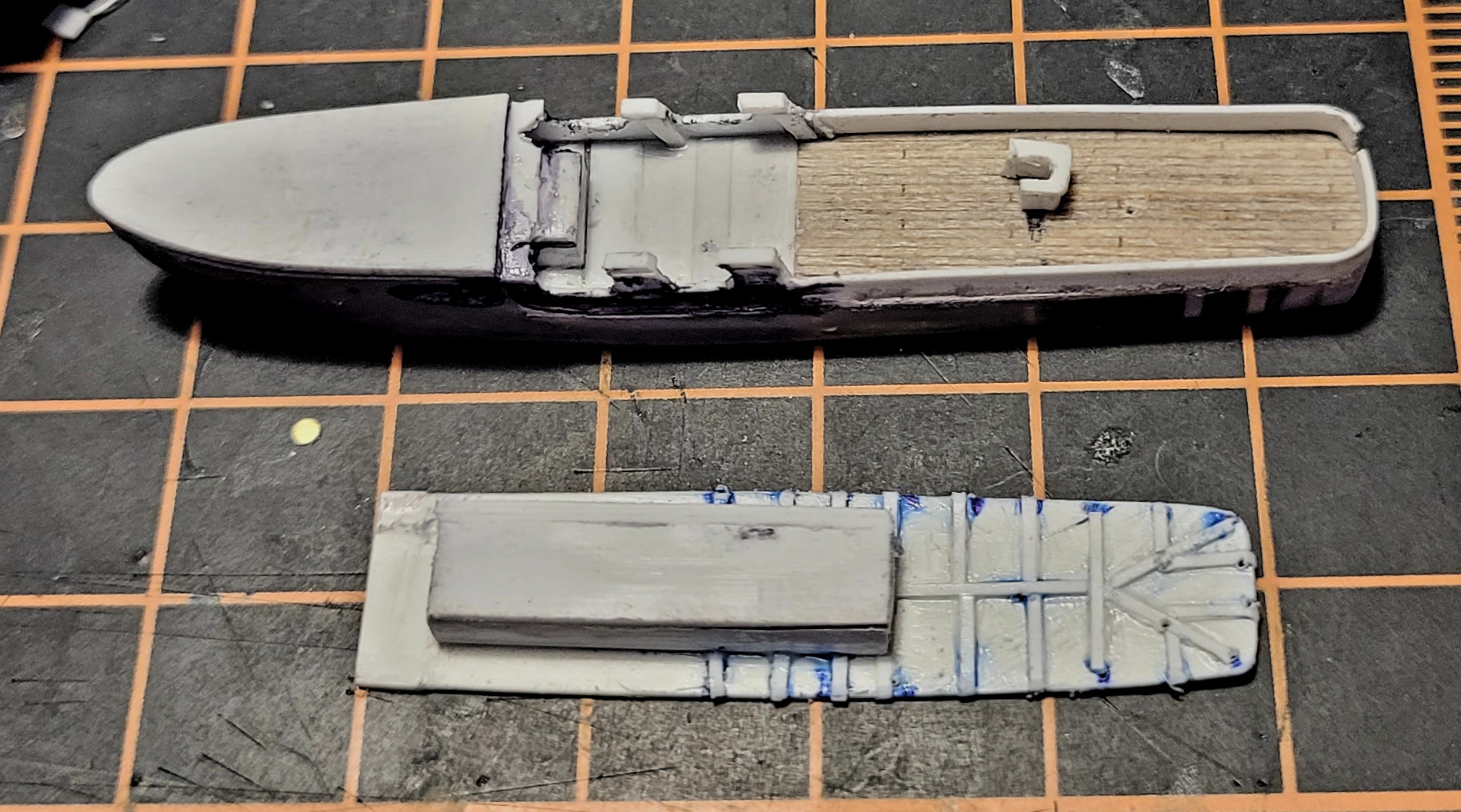

I was working on the Bar on the afterdeck. My meager effort will not begin to entail the grandeur of this part of the yacht.
3 tries. #1, Too chunky. #2, Too big. #3, That looks about right. Still, could Duke have had too big a Bar on his vessel? Well, a snazzy staircase does go next to it.

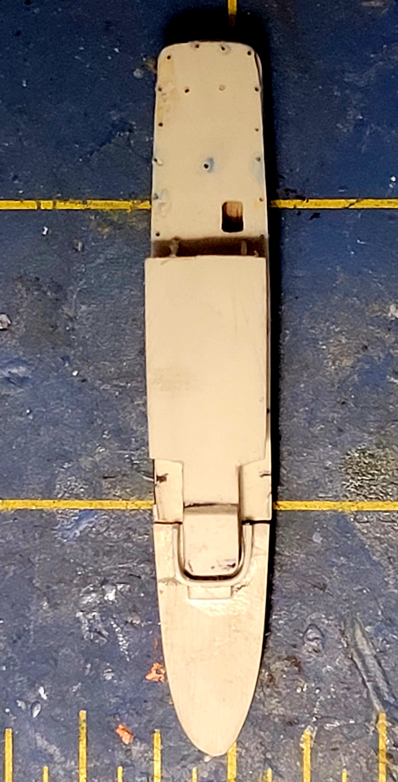

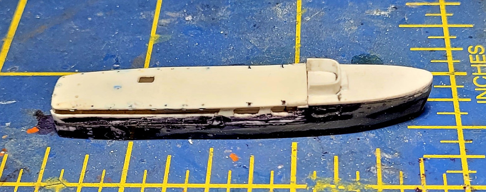

Like the Reliance class cutters, USS Potomac and Calypso models, Wild Goose is another "Covered Wagon" style Master. The overhead frames are marked for drilling supports to the railing below. this also helps stiffen the main deck for molding and casting.

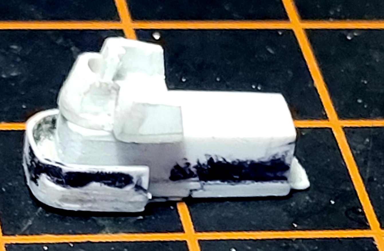

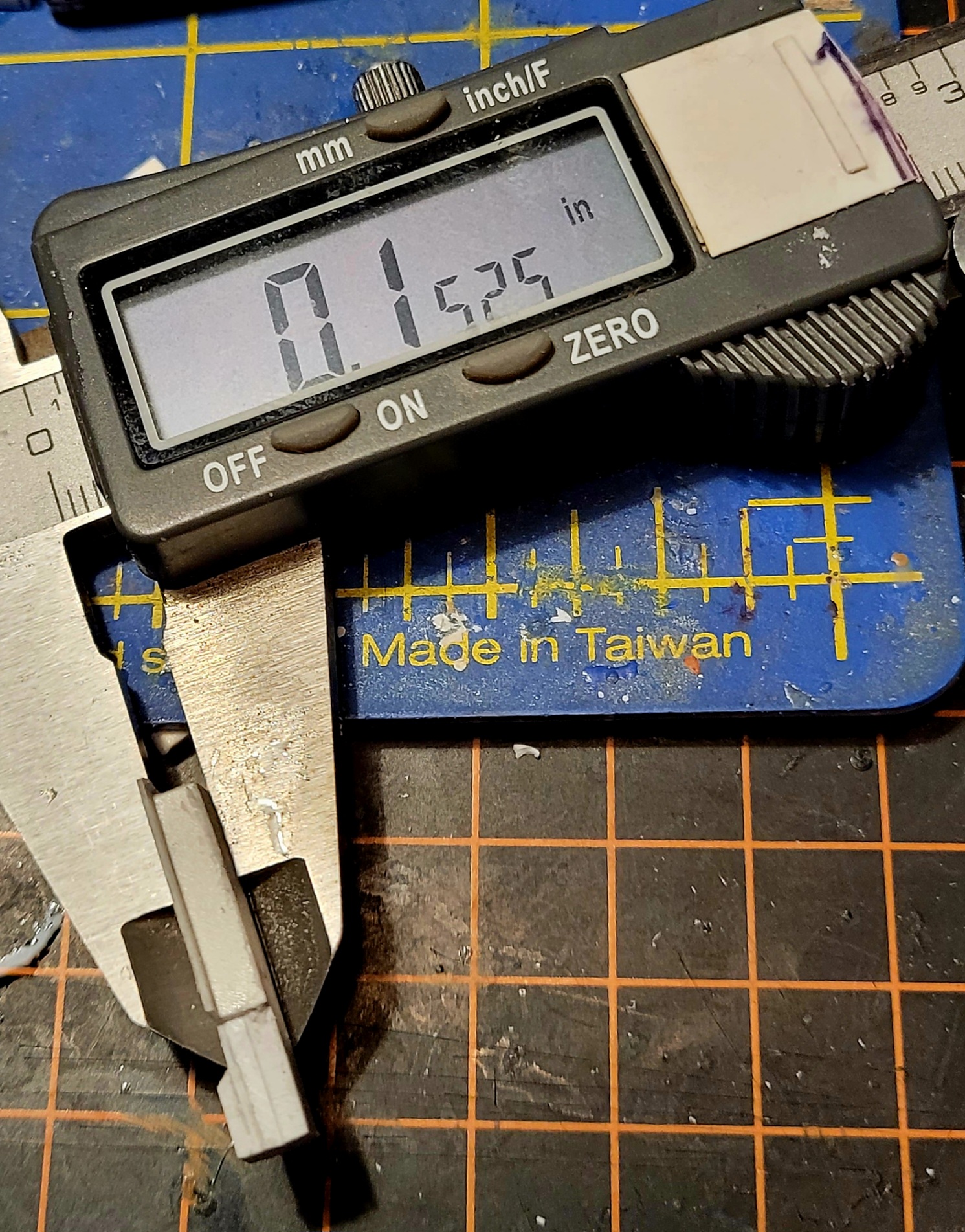

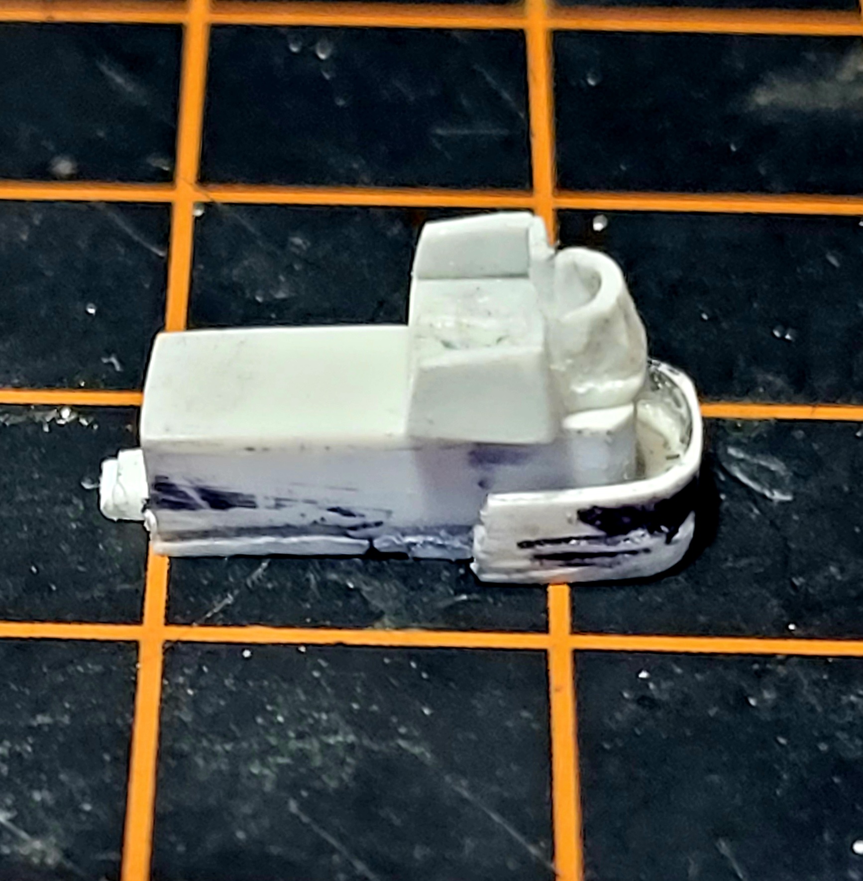

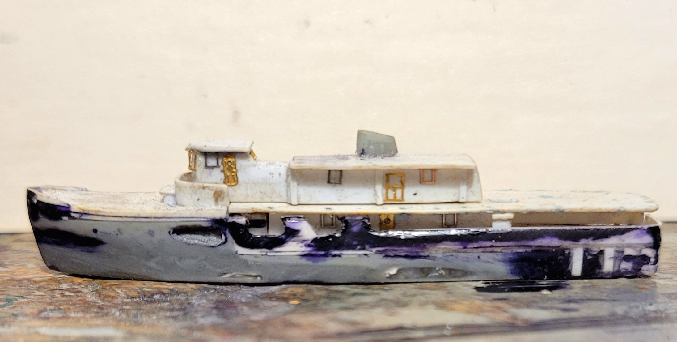

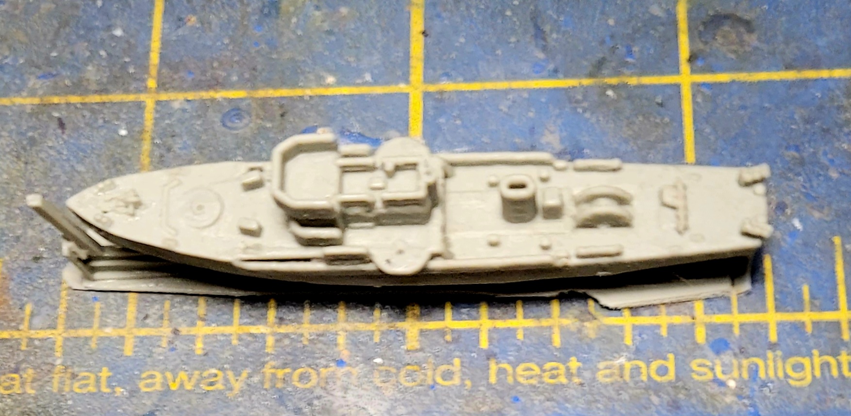

First go at the Master salon, flying bridge and pilot house. The flying bridge is cool, but it's curved front part is slightly undersized.
This pilot house doesn't have the needed elevated bridge, this Master salon (Duke's taller bedroom) is 120 scale inches tall.
John Wayne was 6'4" so It should be closer to 96 scale inches.
Oops.
Do-Over coming up!

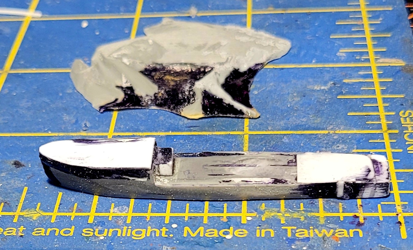

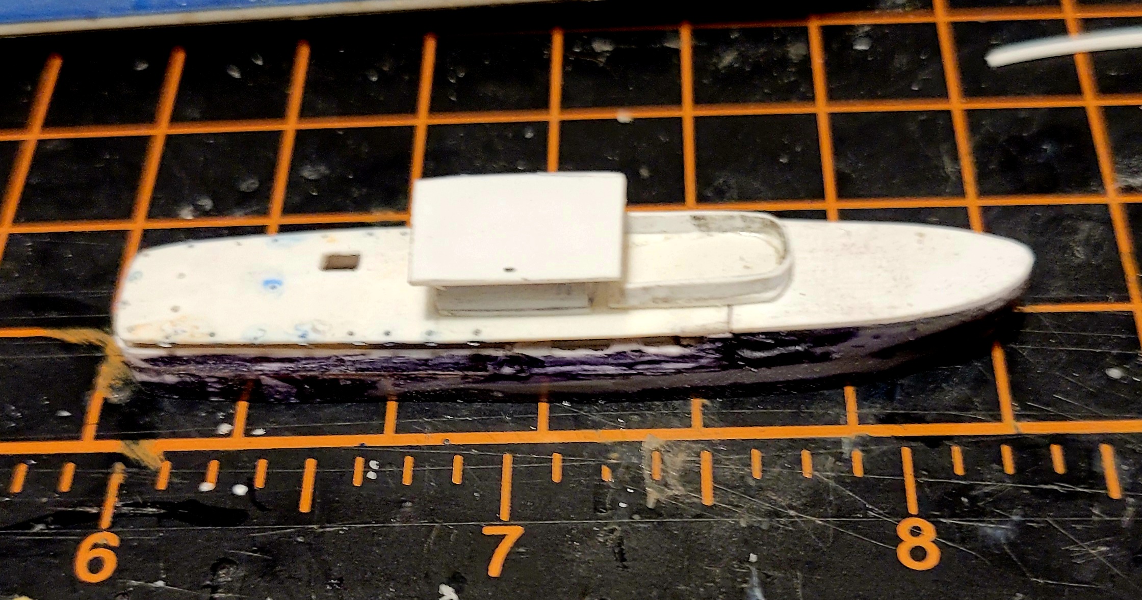

Do-Over progresses. Nobody said the big spray shield had to be part of the deck house.
I expect her to come together something like this.

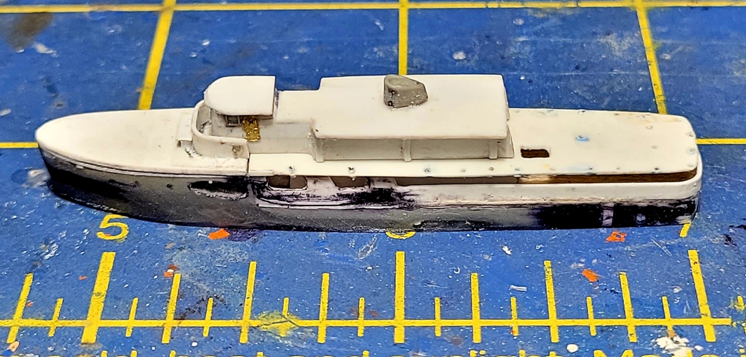

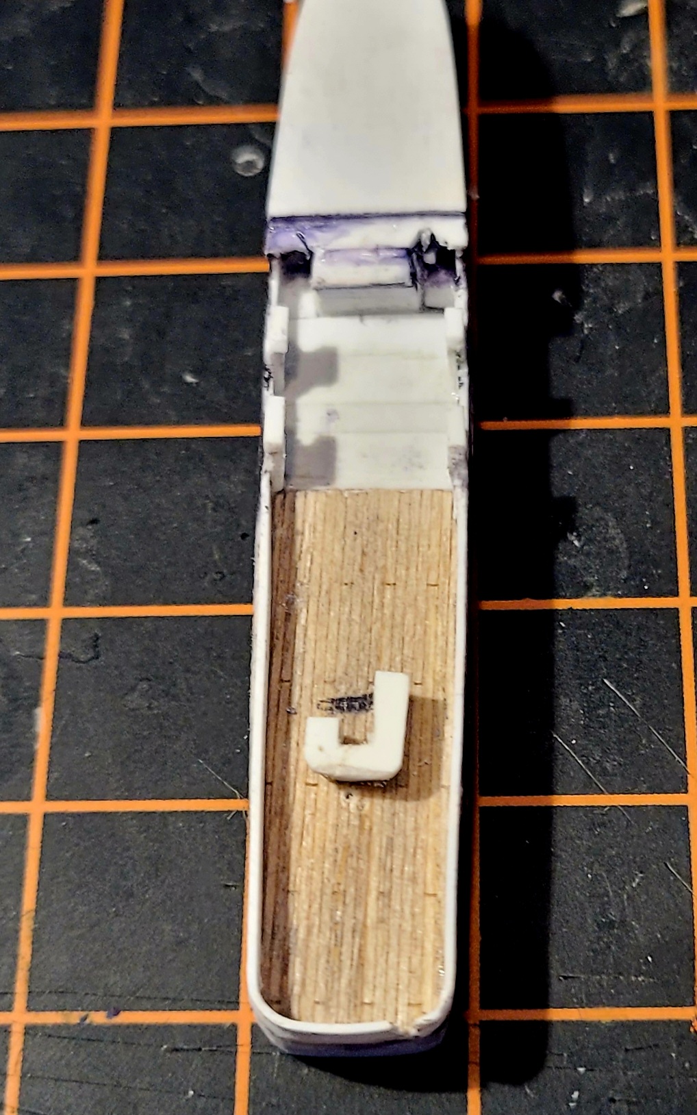

Wild Goose has her stack. A start has been made on p/e door/window details. Her foc'sle need more contour details and this vessel will have her Danforth anchors mastered on the hull. It should be an easy, fun build of a largely unknown ship.
