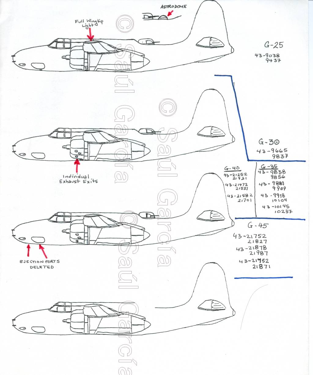

Nose -
The AMT B/C kit includes a good representation of the nose. For my A-20B build, I decided to make it into a gunship. For the A-20G-1, I needed to scratchbuild a gunship nose as introduced with this series. It should be noted than the 20mm cannon armed ships didn't have ejection ports for the spent shells.
However, this was introduced later upon switching to .50 Cal machine guns in lieu of the 20mm cannons...
and then, with spent shell retention, all ejection ports weren't used as a plastic box collected the links and empty shells. A big hint are those side .50 Cal gun hatches which bulged about 3 inches:
Note that the side ejection ports are in place (as it lacks the three inch out bulges) but the open ejection port for the four central guns are no longer there:

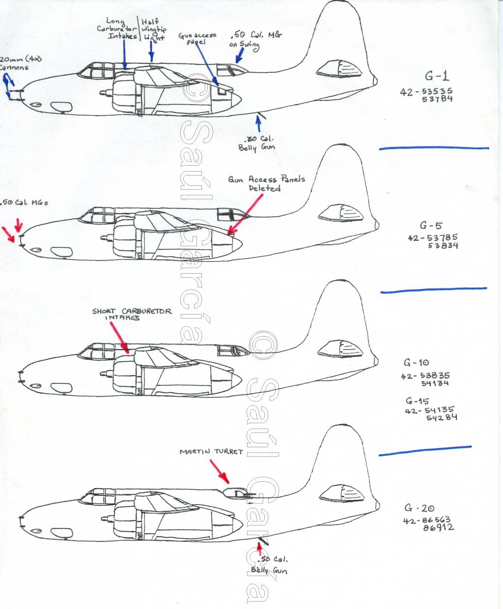

Fuselage - Vents
From this Technical Manual, which covers major differences amongst the late models, we see the heating system (labeled 6 &118 repesectively 23) and also that it takes air from scoops on the port side low after the gunner's compartment and low on the starboard side under the cockpit:
Now, reading the production batch changes, the heating system was changed during the A-20G-15-DO batch. This means before the Martin turret so it still has the open upper gunner's position. Looking at a training film on the flight characteristics, we see the vents on an A-20G-15-DO 42-54282. These vents are absent on all the AMT/Revell/Italeri releases in 1/48th scale. Click any of the photos to see YouTube video.
Port vent for gunner:
Starboard vent for Pilot:
A-20G-25-DO "Bub's Brother" Tail code '?' serial 43-9422. Plenty of anomalies but no sharkmouth for me...
So what? :D Well, we can now determine that this aircraft is either an A-20G-5-DO or an A-20G-10-DO as it lacks the cannon to be an A-20G-1-DO and lacks the vent for the pilot to be from the A-20G-15-DO batch or later:
