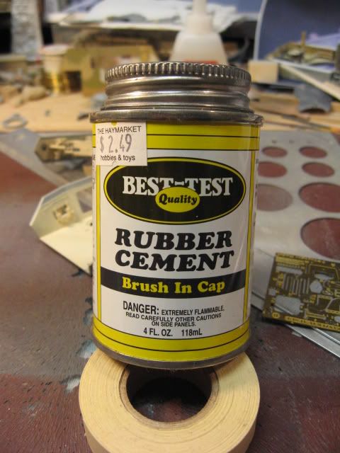

First get yourself some rubber cement , obtainable in any art supply place , or BDSM shop because some of you that don't live in the U.S as I have been told don't have malls .

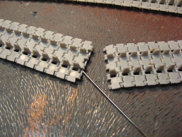

Then apply a boogers worth of the said rubber cement to the insides of the connectors , ........... thusly with a sewing needle or pin .

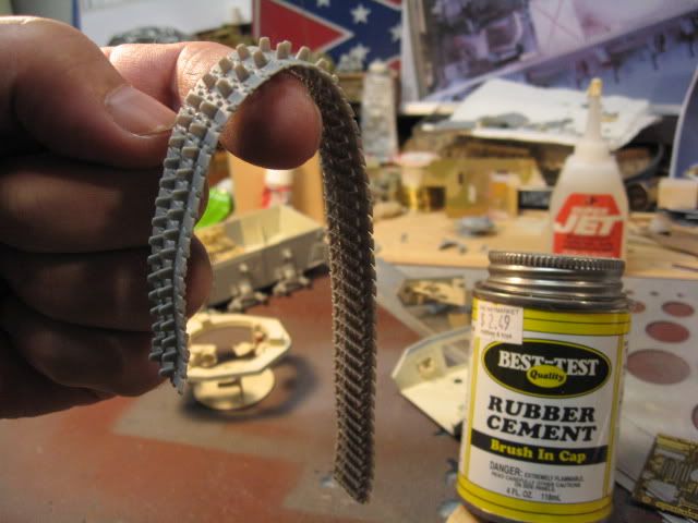

They remain flexible forever , ........ if they come apart in a section , you didn't use enough booger , just reapply and connect !!!

What is exactly the "rubber cement" ? Is the glue that the shoe repairs man use ?
