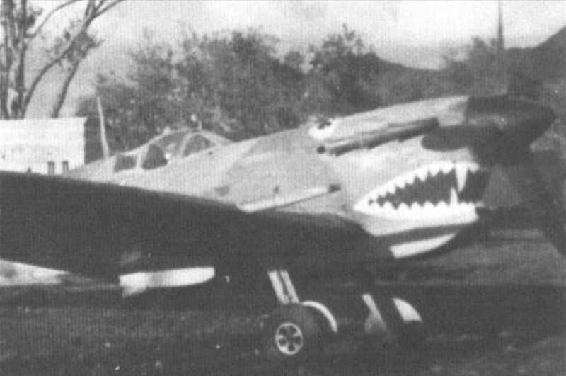

Now let's compare in service photographs of Chappie and we'll note that the right side image is reversed!
Corrected
Close up...
Things to note (since the Airfix kit has so many options):
  • Spinner was a dark color, probably red
  • Rear view mirror in use
  • Five spoke wheel hubs
  • Internal windscreen armor
  • M236 not seen in photograph
  • Cockpit vents under windscreen on both sides
  • Hole from gun heating tube, behind exhausts, not covered
Lot's of work to do! Luckily, the Eduard Spitfire Mk IX cockpit (for their kits) provides the rear view mirror.
