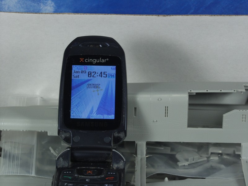

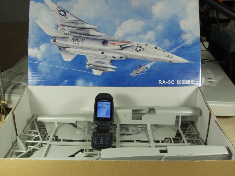

If all of this wasn't enough the kit takes me out of my comfort zone on several levels including painting large areas white so I may be throwing up the white flag on numerous occasions. Well that's enough whining and verbiage for now, here are the time stamp photos...

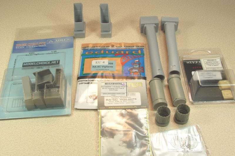

And a look at some of the AM stuff starting with replacement gear bays, Eduard PE, Master pitot tube, late series intakes, seamless intakes, resin burner cans and intake plugs.

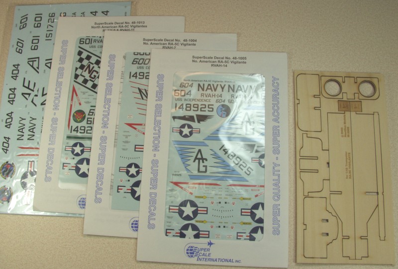

Choices for markings and a Nautilus set to make up for a serious lack of internal bracing.

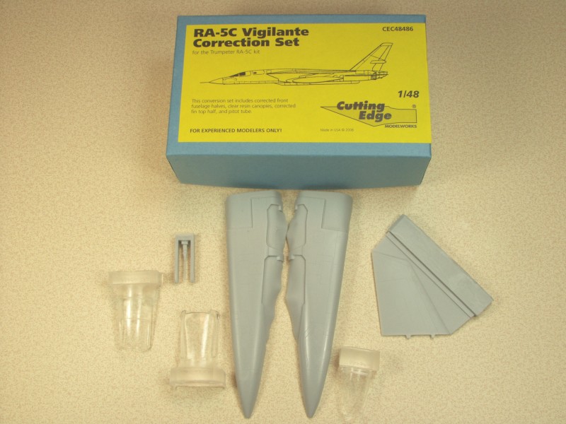

And a Cutting Edge correction set for the forward fuselage and replacement upper tail.

Wood? Wait..what? Where does that come into play? OK see the laser cut sheet. Is that internal bracing for the seamless intakes?

Bob, the rather large and wide fuselage has very little internal bracing. Left on its own the bottom seam wants to sag inward without some help and that's where the Nautilus set comes into play. It also provides a solid mount for the burner cans at the back. I used one of their spar sets on Condor build and it gave the wing to fuselage mounting a lot of extra strength.

I'm not quite ready to start this one yet but I decided to do some planning on how to attack this. I started out cleaning up some of the resin stuff from Cutting Edge. For the most part disappointment followed. First the replacement nose section. Unless you are a Vigi fanatic you probably won't know that Trumpeter got a lot of the shapes wrong on this kit. One of the easiest to fix was the nose section which in the kit is a bit too flat and wide. This part was supplied by Cutting Edge with a number of others in their update set. Once I had the parts cleaned of excess resin I taped them together...
Hmmmmmm, I was expecting better from Cutting Edge, if you line up the rear section which must mate with the fuselage...
You get this at the front end...
Yeah, it's fixable, just not fun. A quick test fit of the cockpit floor hints there may be other issues but I will need to get the pit built up first.
Next up was the replacement main wheel bays from Aires. These are quite nice and certainly look a lot better than the kit supplied part...
The even fit like they are supposed to...
But since they are the correct depth, using them with the Cutting Edge seamless intakes is not a happening thing...
Even using the Kit supplied wheel bays the intakes are a very tight fit and don't line up with the engine face...
This is not a huge problem as I had no intentions of using the kit engines any way but the intakes are also going to interfere with the Nautilus support brace. The kit supplies no intakes at all just a big square hole looking into the interior of the model. The easy way out of course is just use intake plugs, a pair of them is supplied with the Nautilus set and a resin set is available from Steel Beach.
You sure that was Cutting Edge and not Fonderie Miniature??? Looks like my Do 24 fuselage!!
