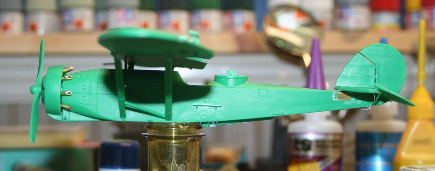

So, I lied about having the floats on, but I did work on a lot of the smaller items today

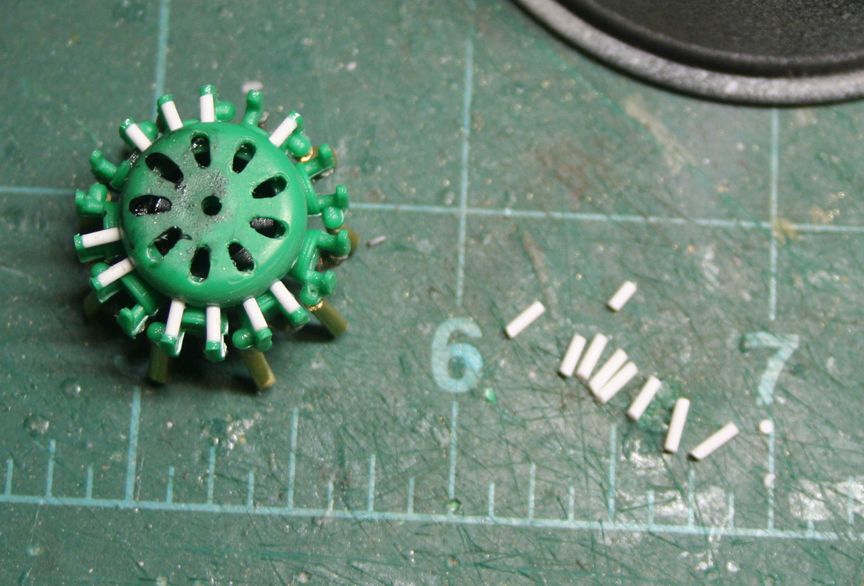

Push rods installed in the engine:

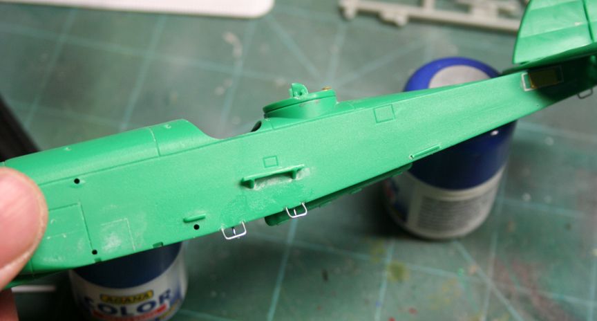

The PART PE set had a neat little gun mount that I never would have been able to assemble. so I cut part of it out and added that to the original kit part, along with the little wheel.
Added a grab bar/tie down point on the tail
Steps out of wire, I have to make another one of these for the other side.

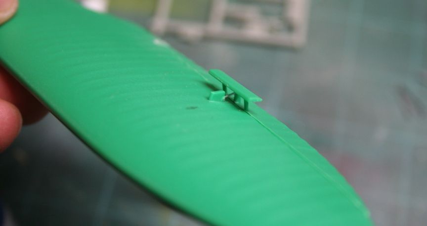

I got these little winglet thingys on the upper wing installed (not sure what they are, never seen them before on any other plane)
PE rudders

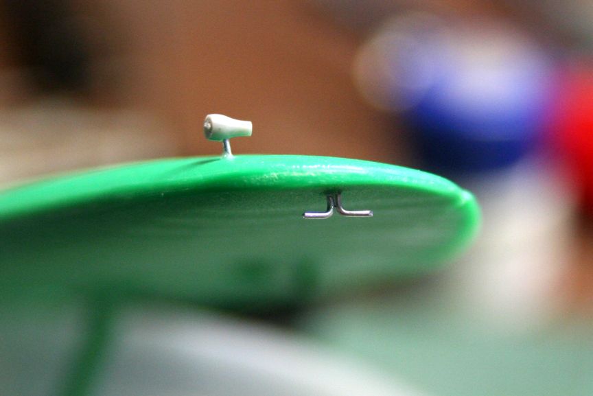

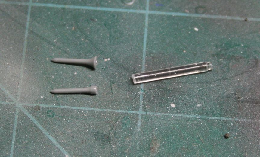

I'm using these parts to make some little marker lights for the top wing. I just clamped them in the Dremel chuck and ground them down on a piece of sandpaper

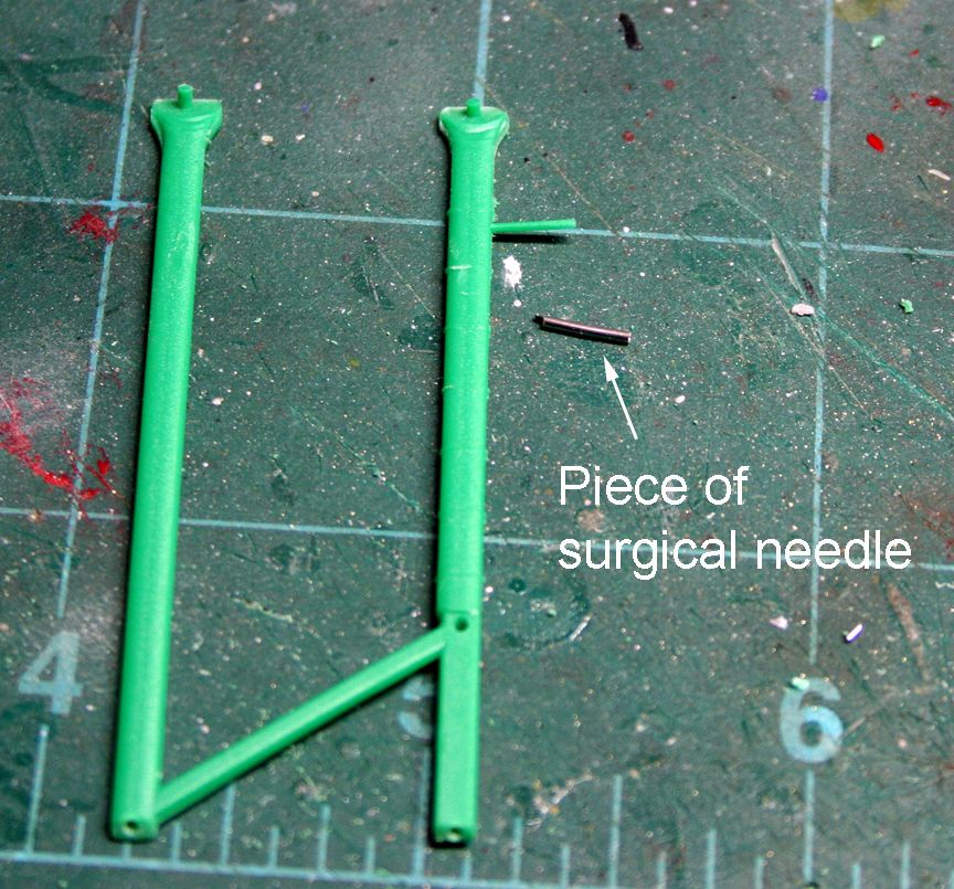

Replaced the old pitot tube with a piece of surgical needle

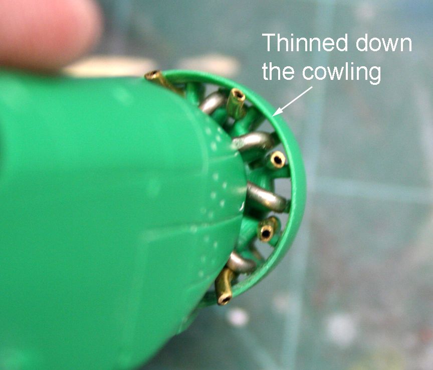

and thinned down the engine cowling!
That's it for tonight!

Those little airfoils on the wings would have to be some sort of trim tab I would think.

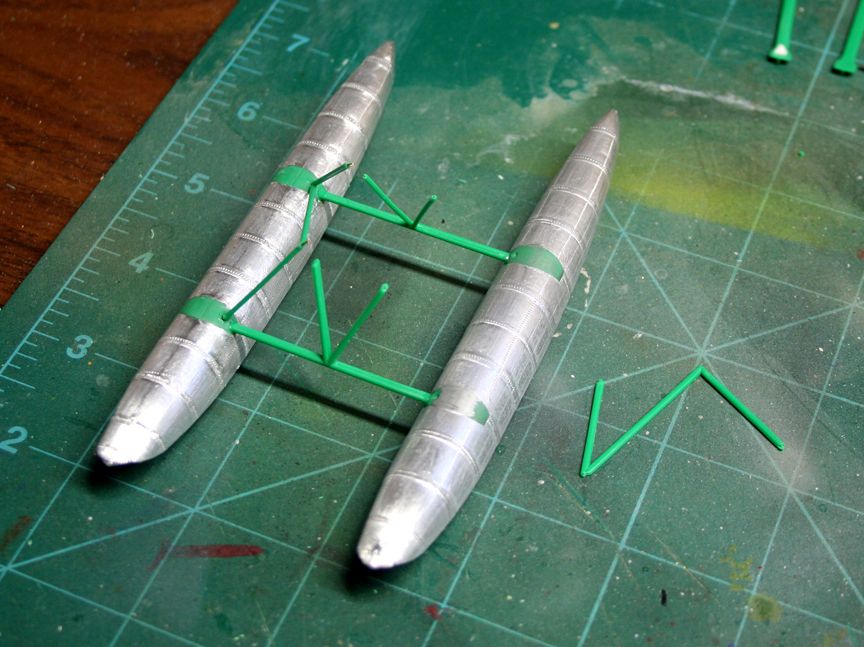

The other float is foiled and sanded, I started to pin some of the struts and then broke my small drill bit. I'll have to try and get another one on my way home from the doctor's tomorrow. Floats are almost finished though.

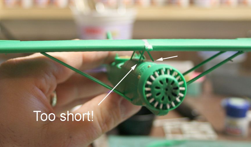

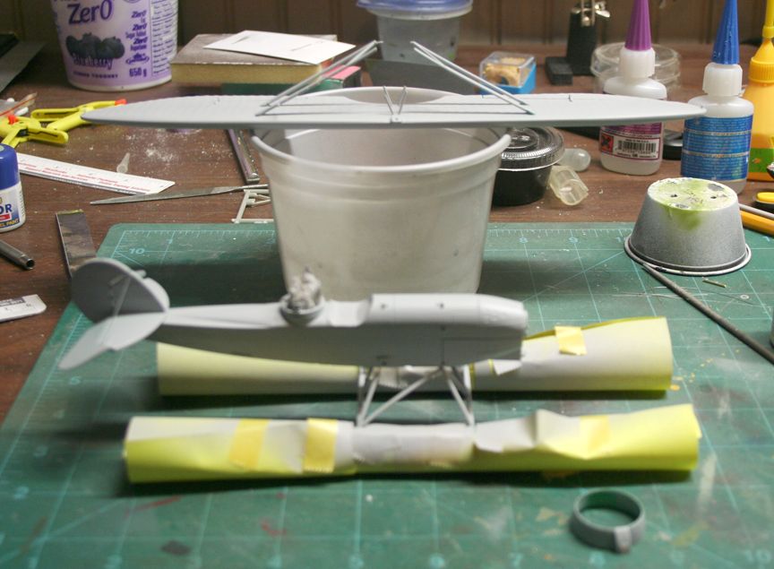

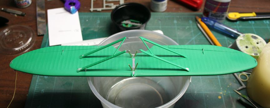

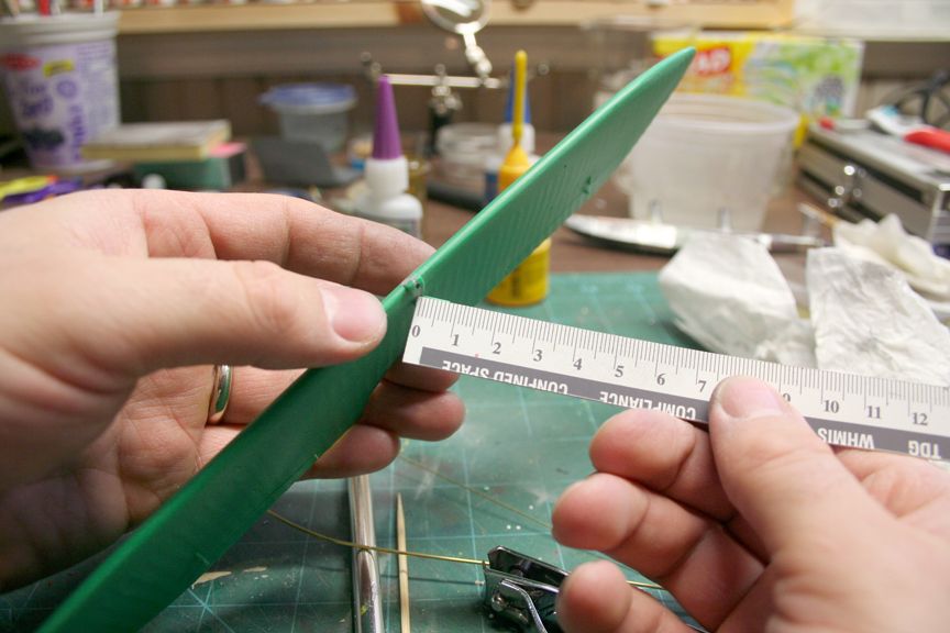

Did a test fit of the top wing and found out that the center strut kit parts were too short! :bang head Aggravating!!!
So, got out the ruler and some brass tubing and quickly fixed that up!
Coming together!!
Nice job :D I like it when a man pulls out the scientific equipment :drinks
It seems that the smaller kit manufacturers have a lot of issues with the struts not fitting :idonno
Nice save . Cheers, Christian B)

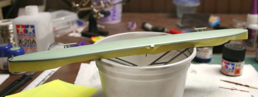

I only need two more pieces of rigging for the wing and then I can paint that. Looking at painting tomorrow or Sunday.
Here's a close up of the marker lights and the little antenna on the port wing tip.

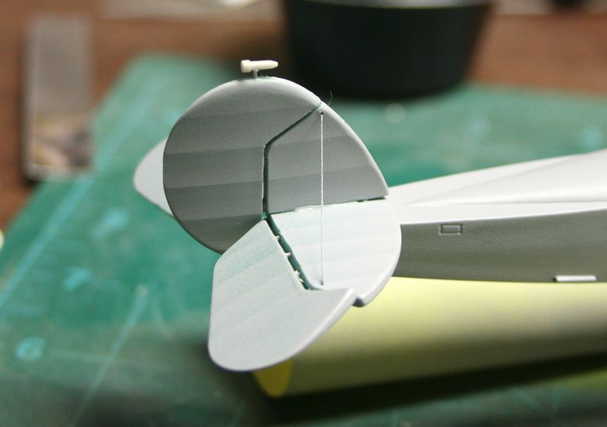

Also, I added a marker light on the rear rudder. The first attempt looked out of shape and too large so I tried to fashion a second one.
Not perfect, but much better.

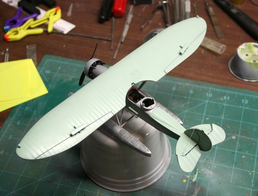

Paint today! I am using Agama Colour water based paint for this plane, Polish silver and Polish navy green. the silver worked like a charm but the green was the worst paint i have ever dealt with. It came out thick and lumpy and I had to thin it out with Tamiya thinner until it was like water and it still clogged the airbrush. I only had a tiny little stream of paint to work with.

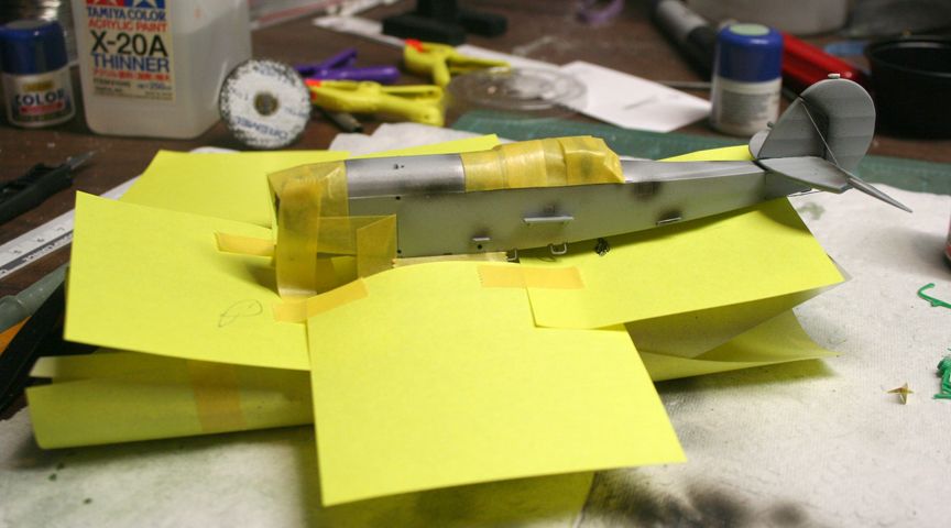

Masking the fuse
and the wing

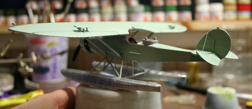

Then a quick rough assembly to see how it will look. I don't have the engine or the wing fixed yet
I really like the colour of the Polish Navy green! Hopefully I can shoot this with a gloss coat tomorrow and tackle the decals. Then a light weathering and a few little bits to attach! :woohoo: :woohoo:
