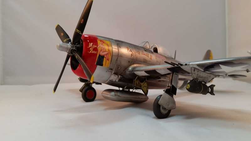

John since we're talking about dirtying up shiny stuff I'll share this.
This was the Pinup Campaign back in 2015.
https://www.modelersalliance.org/forum/pin-up-wings/150410-another-jug-finished?start=60#226003
This started with a mirror shine on it.
I like the way that p-47 turned out. I did pick me up some of that sealer.
