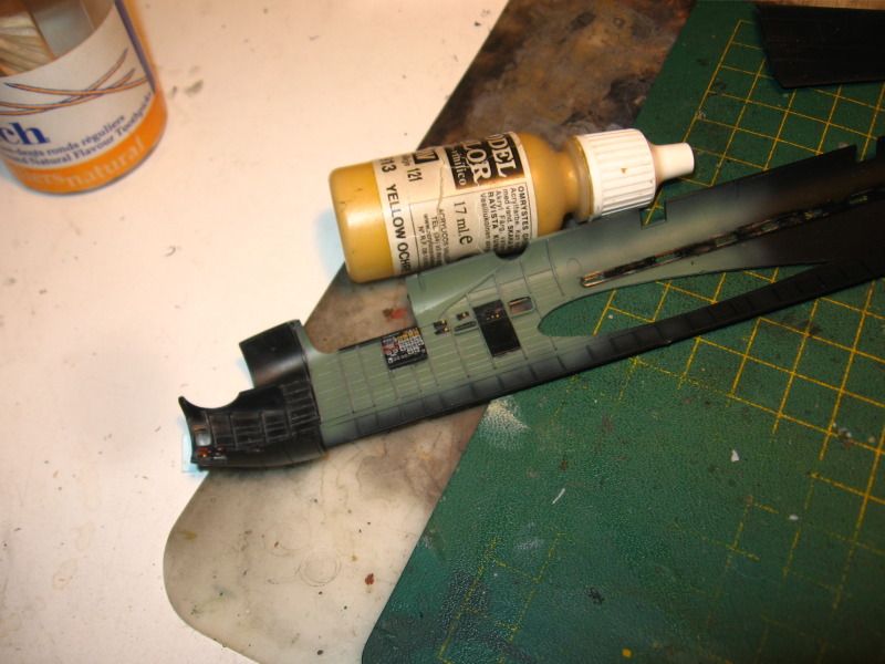

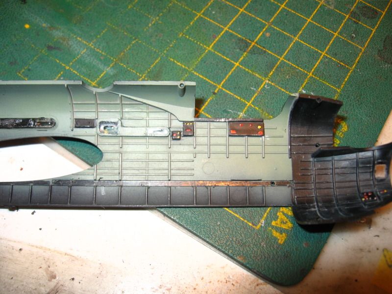

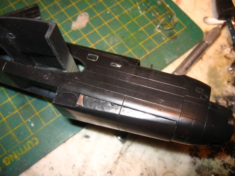

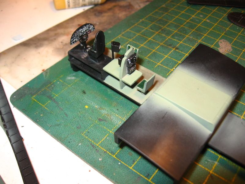

I'm almost ready to button this part up, not my greatest work I'm sorry to say :( but then for what it's worth not much can be seen when it's all together so I'm not losing any sleep over it, besides I'm having alot of fun with it so why ruin a good thing :D .
The instrument decal doesn't line up with all the lumps and bumps, at least I couldn't get it to, so if I had to do it all over again I'd shave them all off...... any way a last few before "closure"

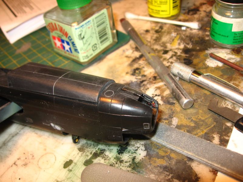

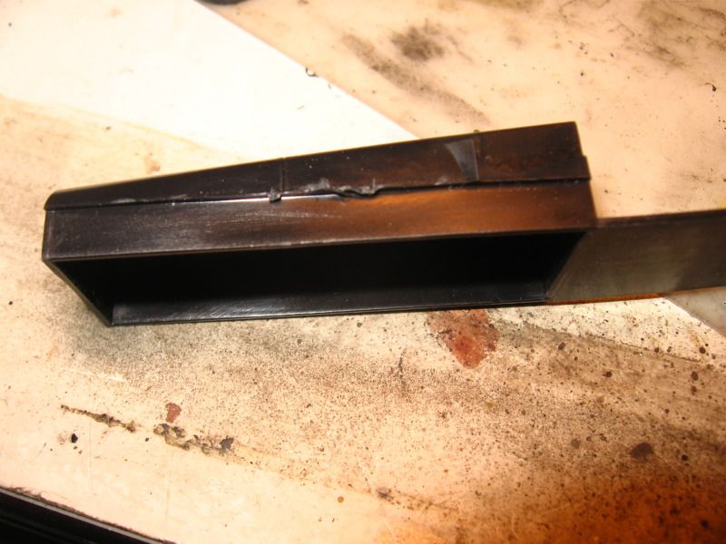

Movin along getting things buttoned up, here is a bit of what I'm saying about some of the moulding issues, now again nothing serious mind you, the attachment point is the little nib to the left.
And as good a view of the surface as I can get.

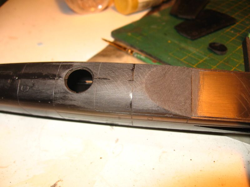

So far this has been pretty much a puttyless build, but the fit of the bombay does leave a bit to be desired. I had to sand a fair bit off the ends to get it go into place without the use of a lot of force although by looking at this you'd probably think it was a bit on the lose side
And then we have the rather large step to deal with that cleaning up will cut into the nicely rounded end of the beveled edge.
So far up to this point everything has had an excellent fit, and even in that our problem child does not represent any serious difficulty. Does anyone have a good pic of this area? I've been all over and can't find anything decent.

Not much a guy can do about the bottom end 'cept yank out the power grinder and do some heavy metal damage :woohoo: .....

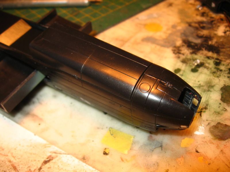

Any way after a bit polish and shine I ended up with this, which I think looks a heck of a lot better then it did when I started

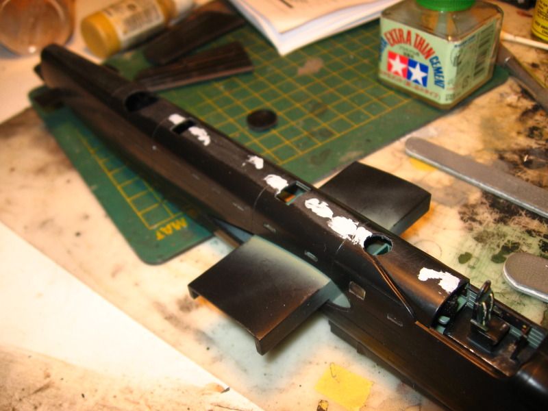

This was the worst part of the join, because there is a clear part that inserts, there is a bit of a step in the plastic to accommodate that which of course leads to that 'orrible "V" notch in the joint so I gouged out the seem line and filled it in with some stretched sprue which is a technique I find usually works well for me.
And a touch of filler to the top to deal with some minor imperfections, I'm sure this makes it all look worse then it is.
