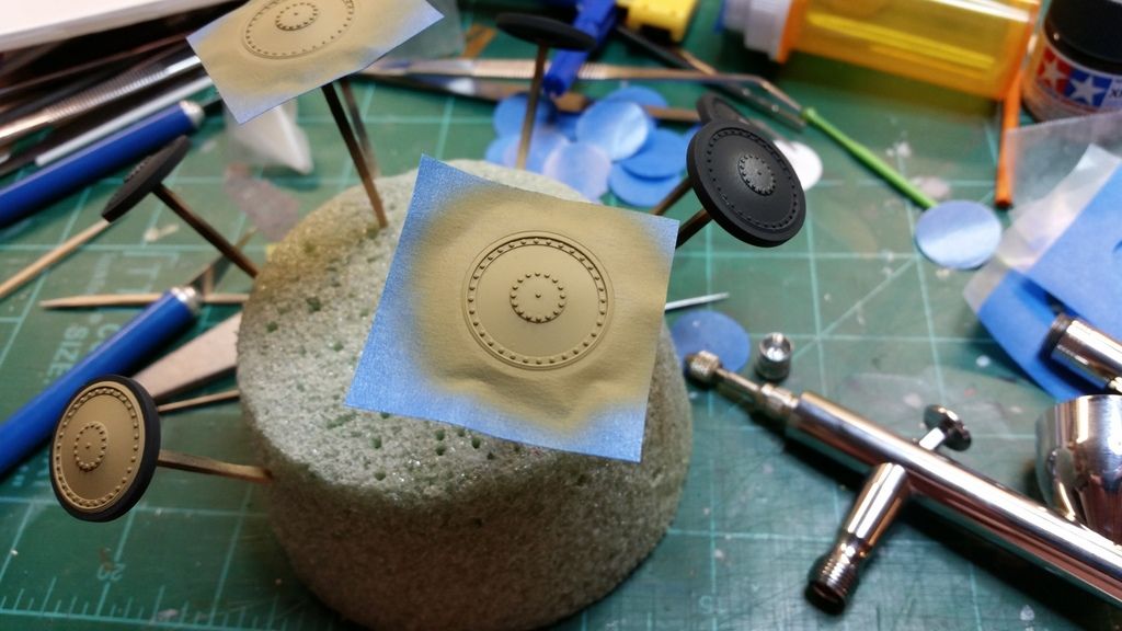

Today I spent time working on the road wheels. First I got them painted Tamiya Nato Black, which I believe was suggested to me by Iron Mike way back, and I have to say its excellent for rubber tires.

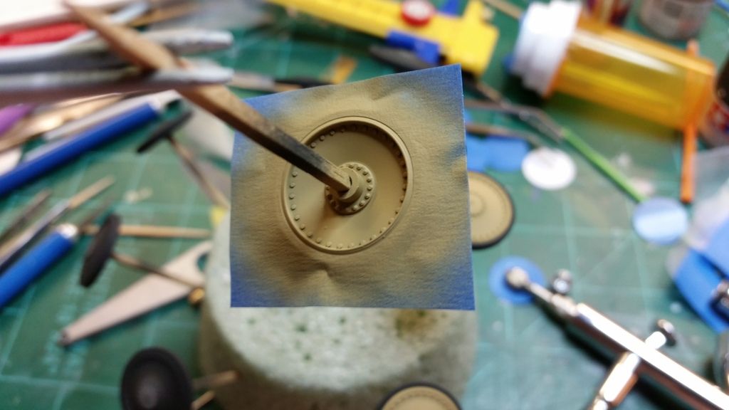

Next was painting the centers. Normally when I do road wheels, I just use a circle template and call it good, but that wont work w/ these wheels. First issue is the wheel is between 2 sizes on my template, and the 2nd issue is that instead of having a nice solid lip, the lip is more of a angled shape, so it doesnt sit clean within the template. So that meant having to use a circle cutter and make tape masks. A couple weeks ago (last weekend maybe) I spent some time playing w/ the cutter and adjusting it until I finally found the right size. I think I probably cut 6 or 7 different sizes w/ the cutter before finally getting one that I felt fit exactly right.

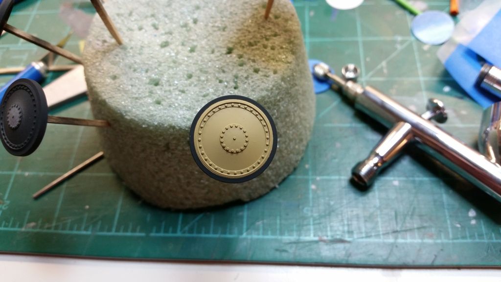

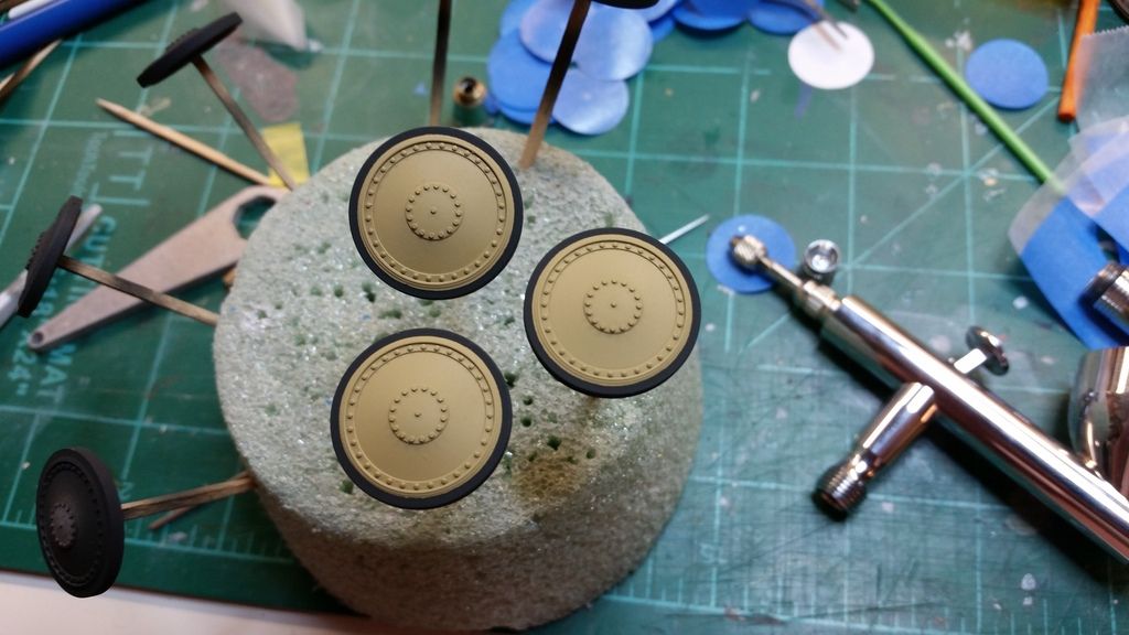

Unfortunately I didn't get any shots before painting, but here's the mask after I got the Tamiya Dark Yellow down. The wheel is masked front & back, and then painted on both sides.
I only did 3 wheels, just in case the tape masks didn't work out, but I have to say I'm extremely happy w/ the results.
Masking takes a few minutes per wheel to do both sides, but I have to say that the results are well worth the time spent masking.

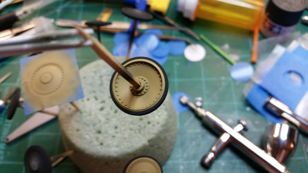

Cutting the tape was actually the easiest part. I've got an adjustable circle cutter, you can see it in the first image. I've not used it much up till now, but it works awesome, I really like it.
This is the type of cutter I've got.
Just laid out strips of 1.5" blue painters tape on wax paper, and then held it down on my cutting mat and cut 20 circles out. Worked out perfectly.

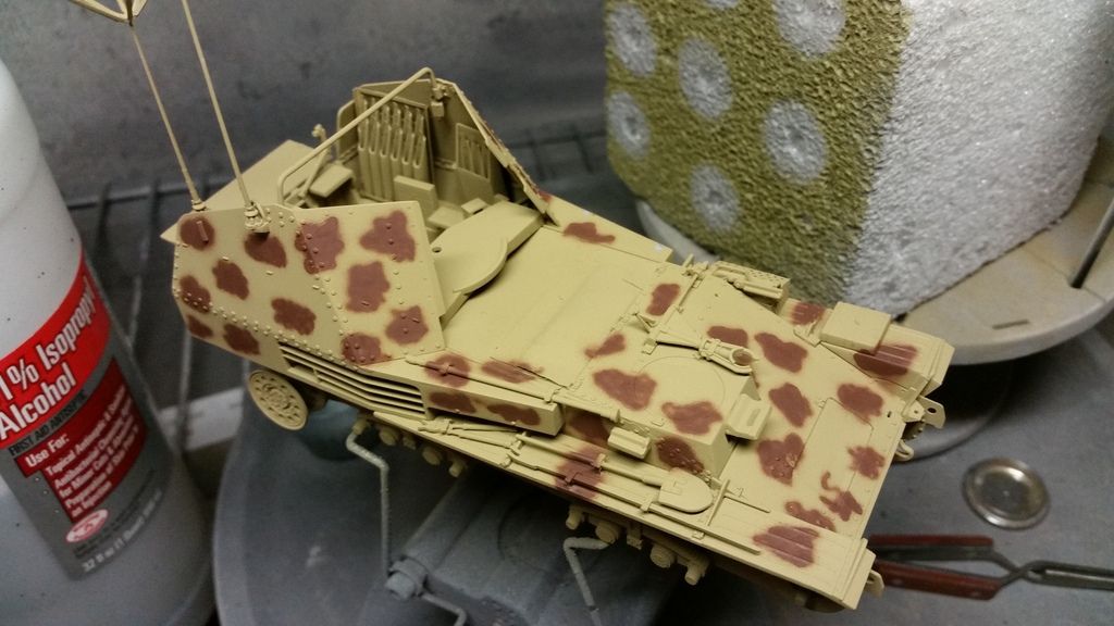

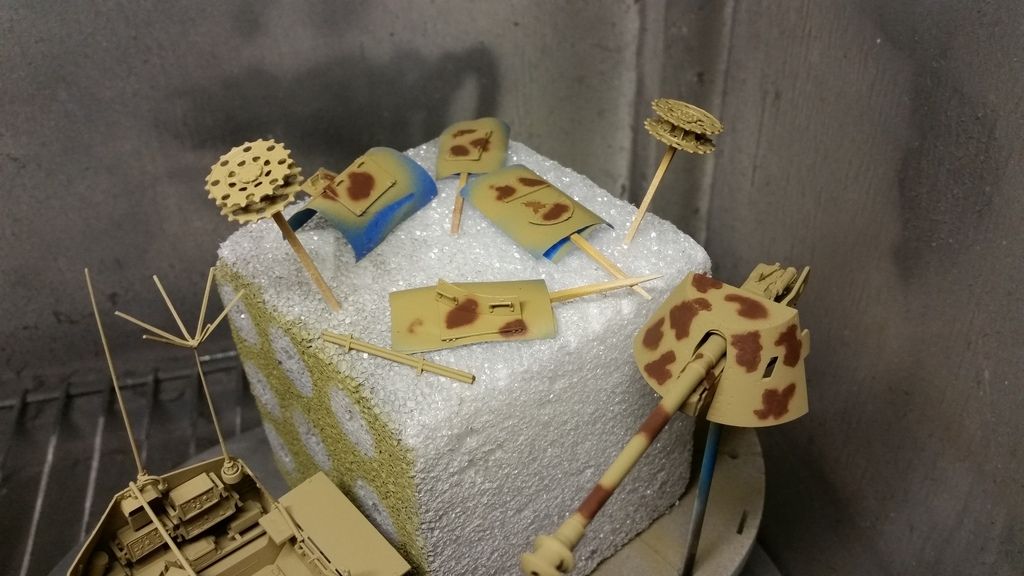

Been able to get more work done tonigth & last night. No pic's to show last nights efforts but I was able to get all of the tracks painted, using Testors Oiled Metal. It's been posted that German tanks had a high manganese content, which prevented them from rusting much, so I didn't base them with a rust color.
Tonight I worked on getting down the first camo color. Its pretty much free hand, just used a fine lead pencil to outline where I wanted the spots, then turned the pressure way down on the airbrush and tried to be real careful w/ the trigger. Overall I'm happy w/ the results. Hoping that I have the time/energy tomorrow night to get the 3rd color down. Tonights color is Tamiya Red Brown.
I discovered after wrapping up tonight that I've managed to miss the transmission cover from the very beginning, so it doesn't have any paint on it, so gonna have to work on getting it caught up.
