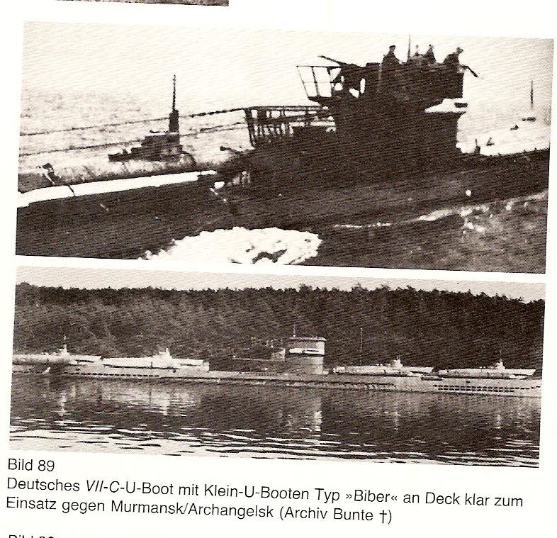

I thought you may find this interesting..........U-295 was a 7C/41 SUB that was fitted out to carry 4x Bibers on deck for a special operation in late 1944 or early '45. Notice the lower platform gun has been removed to probably assist the sub to maintain stability or equalibrium with the extra deck weight. The light stipe around the conning tower and missing tower armarment is usually associated with a boat being used for training (the training stripe was always light yellow), so this may also be a training mission.

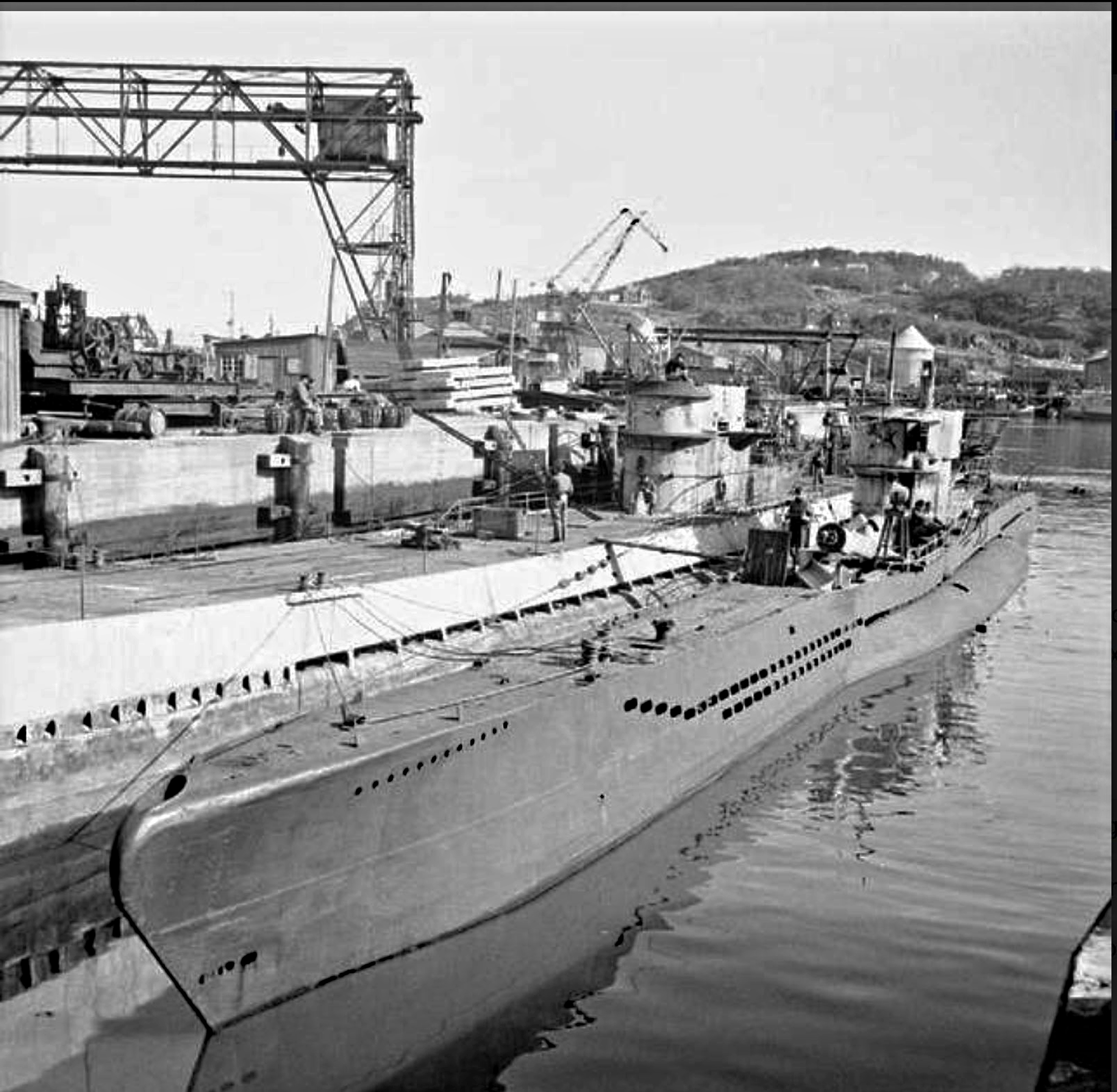

Norway - Trondheim U boat bunker U861(IXD2) & U995(7C).

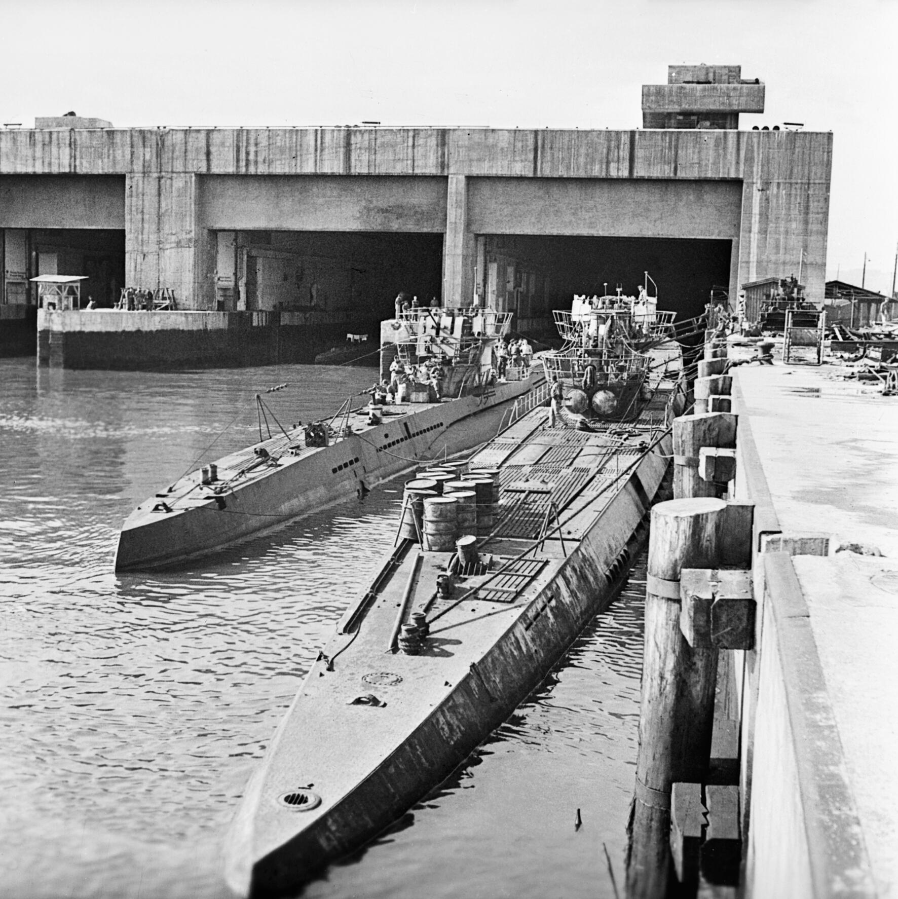

Captured_German_U-boats_outside_their_pen_at_Trondheim_in_Norway,_19_May_1945._BU6382.jpg
These are all great photos and I am still sorting out the details with the Scotland boats all being in transit to Lisahally. I really want to model that look of the crew living off the moored Uboat at initial surrender with supplies and boxes on deck and washing hanging out to dry on the conning tower wires. I love it because it's so busy which is my style.
I just have to mix fact with a bit of artistic liscense as to which boats were next to who. I have found out that U1009 was the first sub to arrive and have matched up some other details but the actual boats seem to move around, which may give me room to move on the positions.

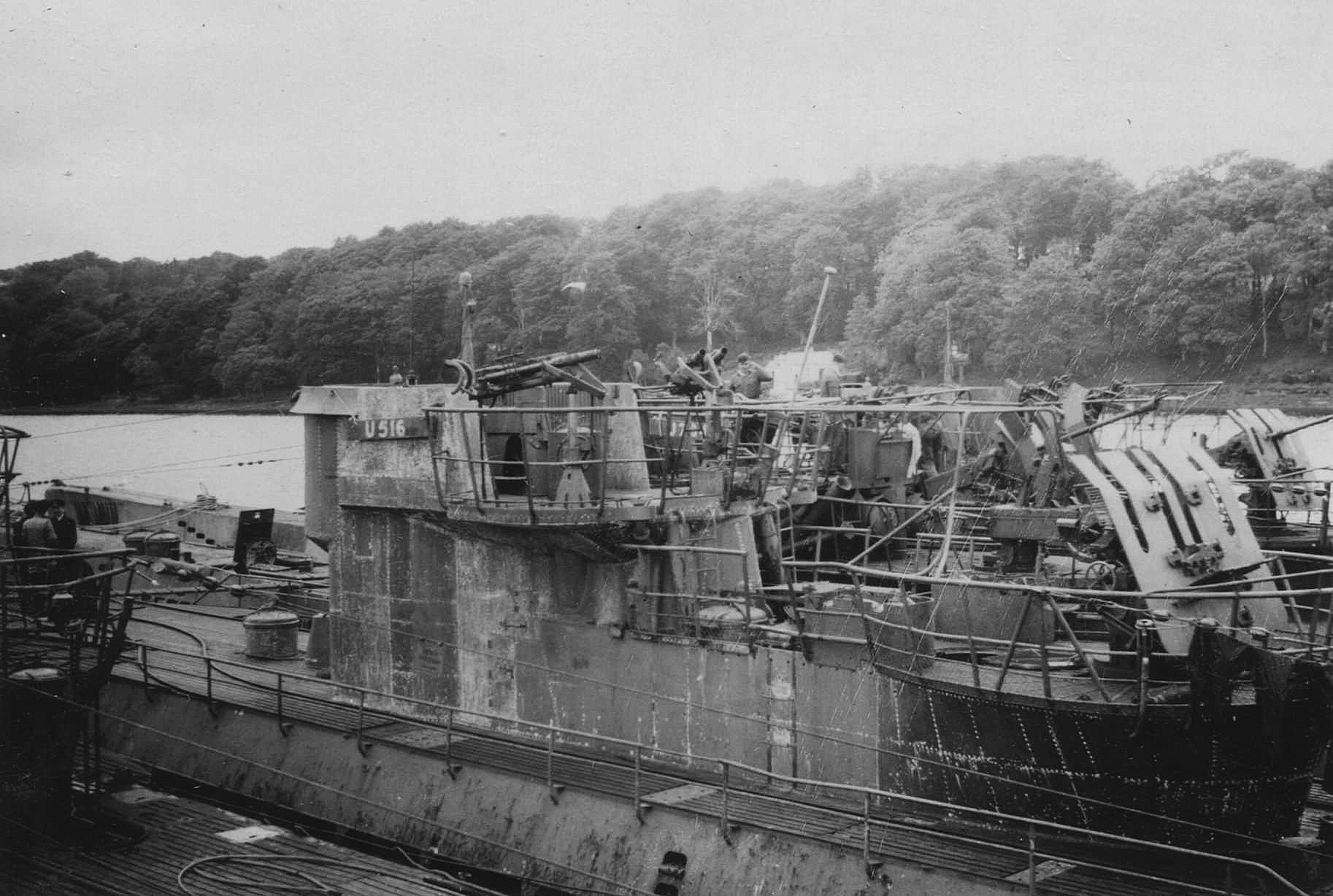

Here is a photo that shows the 3 boats I want to do in the first row and U516 in the last row (basically on the same day) :

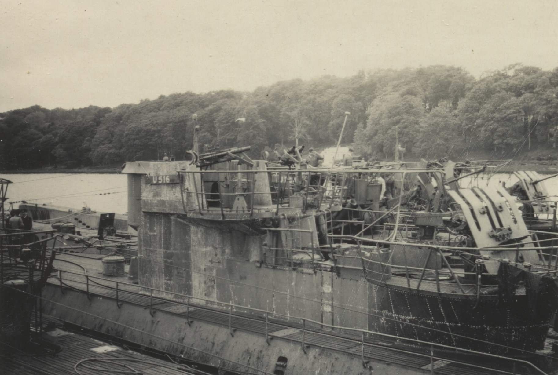

I was finding it difficult to Identify the boats on either side of U516 but upon closer inspection I realised that the number for the adjacent boat(on the outside) can be seen through the railings of the tower of U516. It is not 100% identifiable but it was enough to compare it with the list of Uboat numbers I had for the surrender and what was left through my 'trial and error' investigation. The only one left in the row was next to the pier but I have only a guess for this one ,U255, as this boat surrendered with U244, (on the far right of U516 - see photo at the top, taken from the plane).
This was all very satisfying and very rewarding after all of the research done.
