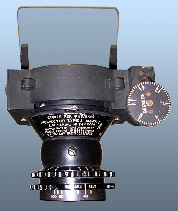

I have a very rare reflector gunsight

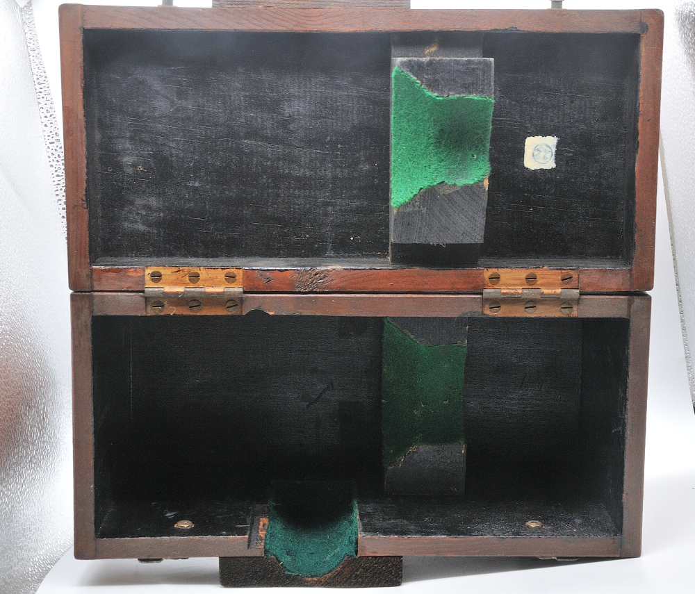

This is a std MkII with an adjustment ability of 5 degrees on the side to allow for the drop of rockets as apposed to 303 calibre bullets
As a result of these and their success the manufacturers put a more refined version in production like this where the mechanism is fully enclosed and the top of the sight is square.
I am looking for any info on my sight, I have researched this a bit and have some answers but i want to see if anyone comes up with the same conclusion as me.
PS note how the std box has been modified to take the adjustment ring

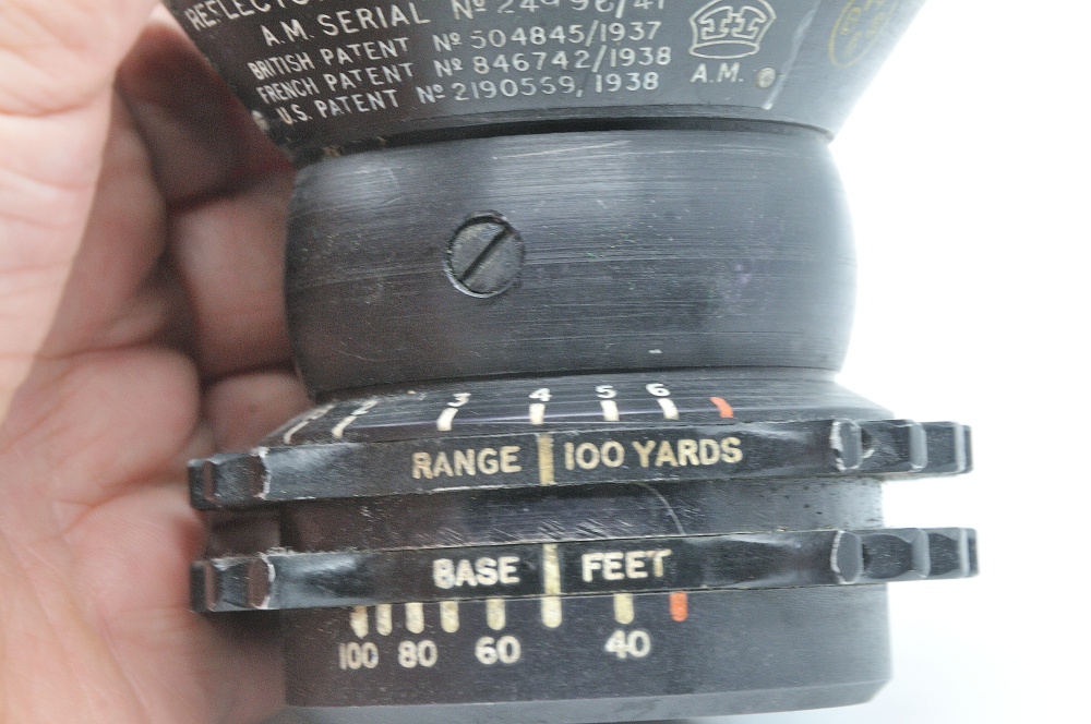

You didnt really need to judge a range. The guns were harmonized at , say 100yds, you set the site too 100yds and the base /feet to the wingspan of an aircraft and when the wings fill the graticule its at 100 yrds and you can fire

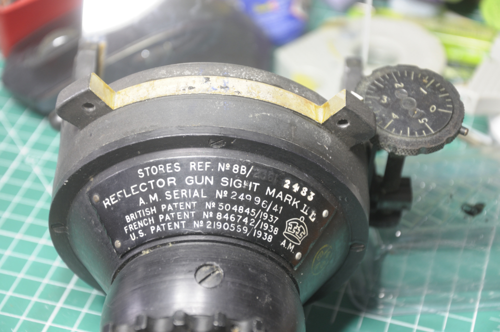

OK so what i have found is this is a MkII L

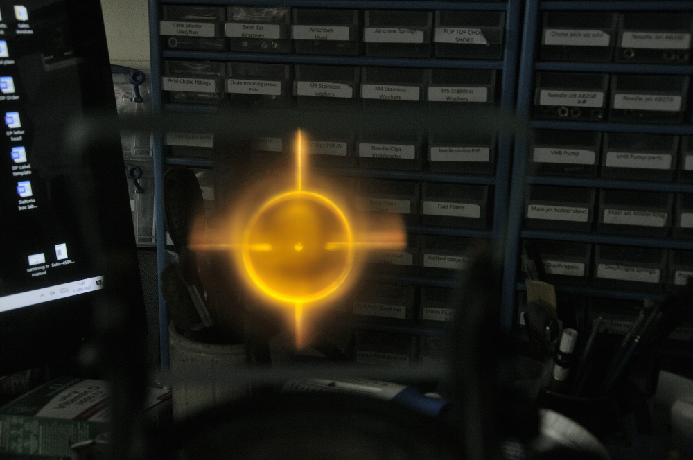

an adaptation of the Std MkII which didnt have the adjustable glass plate The MkII was the std British gunsight also used in the P51. made by Barr and Stroud. Its really hard to take a picture of this powered up as in the aircraft it would have had a dimmer switch on the instrument panel. Also its designed to be focused on infinity and the camera keeps trying to put it in focus on the glass but in reality if you were looking at Rommel in his car 400yds away the sight would appear in focus on the car not on the reflector glass anyway here goes
But turn the light down and
You get a better idea.
The horizontal lines move in and out from the centre spot as you adjust the wingspan of the target, the idea being that when the wing span fits between the 2 lines either side you can fire knowing thats the point of convergence of your bullets.
As your bullets travel to the target they drop because of gravity, An RPG drops approx 4x as much over a range than bullets so the sight glass could be tilted 5 degrees to allow for this so you could hit Rommel with your rocket and still shoot down a couple of ME 109s on the way back to base for tea and medals.
Roland Beaumont found in his Typhoon that the whole sighting thing obscured the target as above and he developed a system by removing the reflector glass completely and the range mechanism and just projected a dot on the the windscreen its self.
A lot better providing you could judge range and were only doing ground attack. You also needed an armoured glass screen as these were optically correct. A std screen produced two dots...

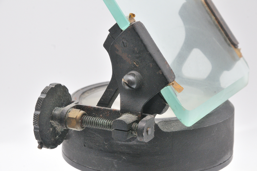

"Early SpitI and HurriI
GM2 MkI --- Mounted in a Hurri angled to match reflector plate opticly with the wind screen to account for double image distortion. Similare problems were encountered with the spit. Version that should be in our Spit Mk1 and Hurric Mk1. Used in early Beaufighters.
The first change in the design was made in 1941 when the circular reflector glass was replaced by one 114 mm (4.5 in) square, the circular design having been found to have slight optical aberrations. This modification was designated Mk IIs, later Mk II*, fixed gun reflector sight. Existing sights were retrofitted with new sights heads, and the circular sight heads are now highly prized by collectors. The dimming screen was discontinued, as it was said to be rarely used.
When rockets came into widespread use, a special version of the GM2 was designed in co-operation with Farnborough, to allow for the increased gravity drop of these projectiles. The reflector screen was made to tilt forward by the pilot from 0 to 5 degrees depression, according to airspeed and the known drop of the missile being used. This modification, which involved the replacement of the sight head, became known as the type 1 Mk II conversion, and the sight then became the Mk IIL.
GM2 - MkIIS or MkII* --- What HTC currently uses in all spit, hurri and typhoon. Notice pronounced rounding of reflector plate corners.
GM2 - Mk2L --- Used in Hurri IIC\D and Typhoon. Dial changes the angle of the reflector glass by 5 degrees for bombs and rockets."

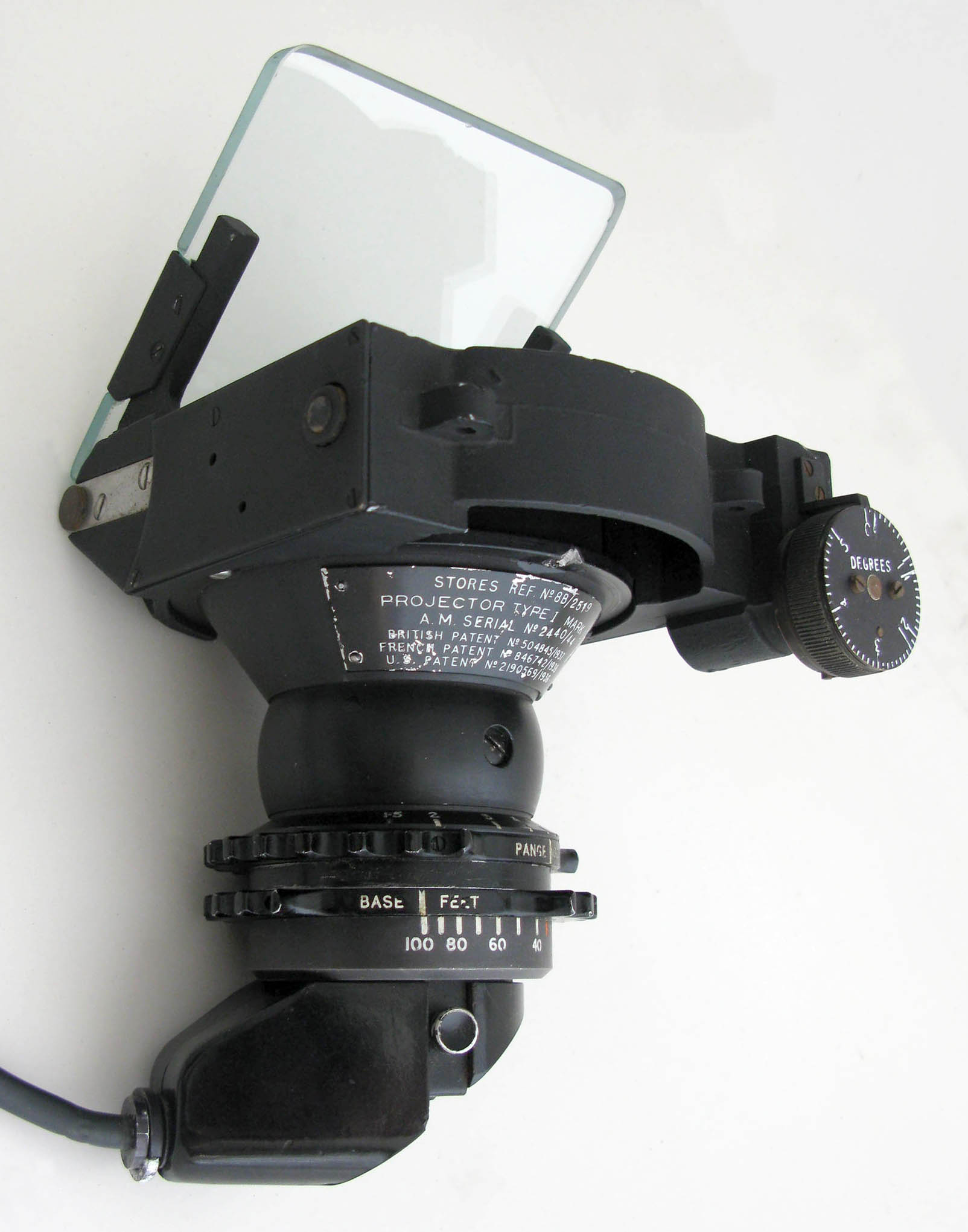

This where it gets tricky because the sight above is substantially different to mine.
The link says its a Mk1 but its not really, its a Mk1 with a MkIII top on :) known as a square top, mine is a round top.
but your article is the first i have seen that even mentions a MkII L so well done :)

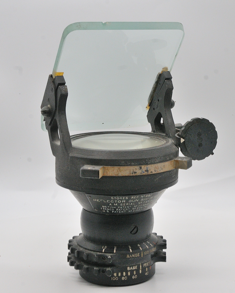

Square top
my round top
