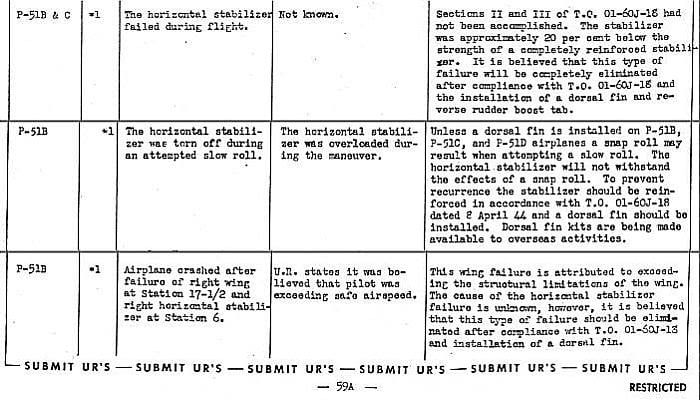

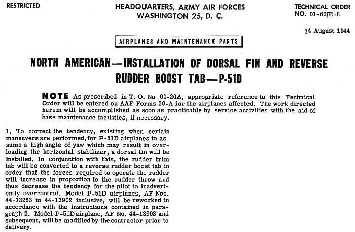

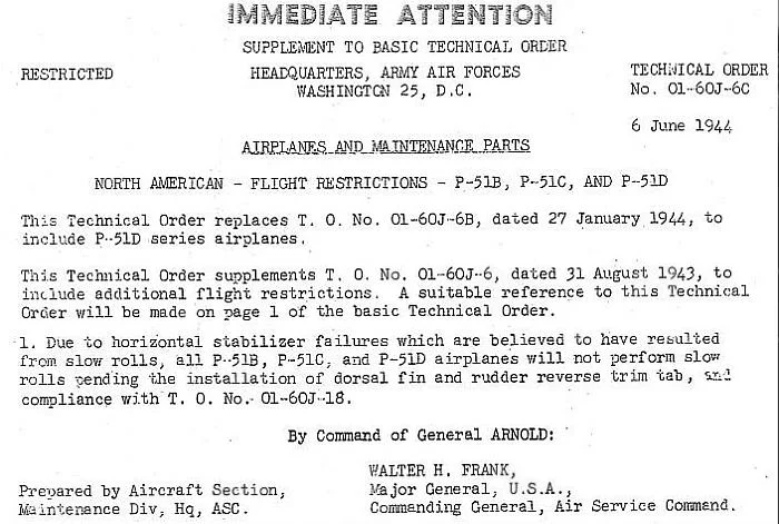

It was a retrofit:
OK you know that's just leading to more questions, The fin was put in place to off set the side area that was lost by going with the bubble top. If my understanding is correct, then why did the B/Cs need more side area?
It had to do with the power increases of the engine (Merlin and copies over the previous Allison). The extension was easy to retrofit without changing the production vertical fin (whose area could be increased as was done when the Cavalier mods came into being with another increased HP engine).
