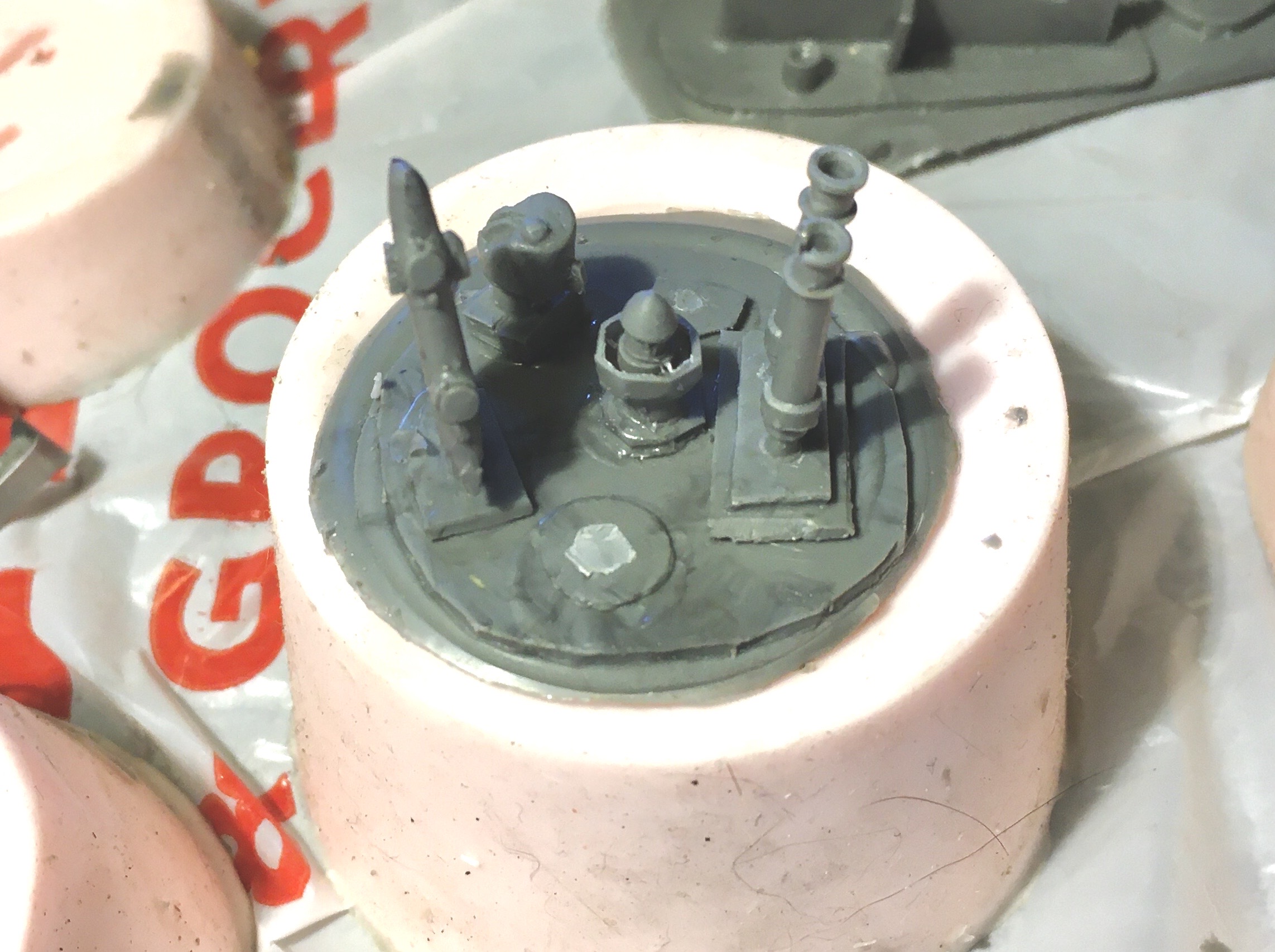

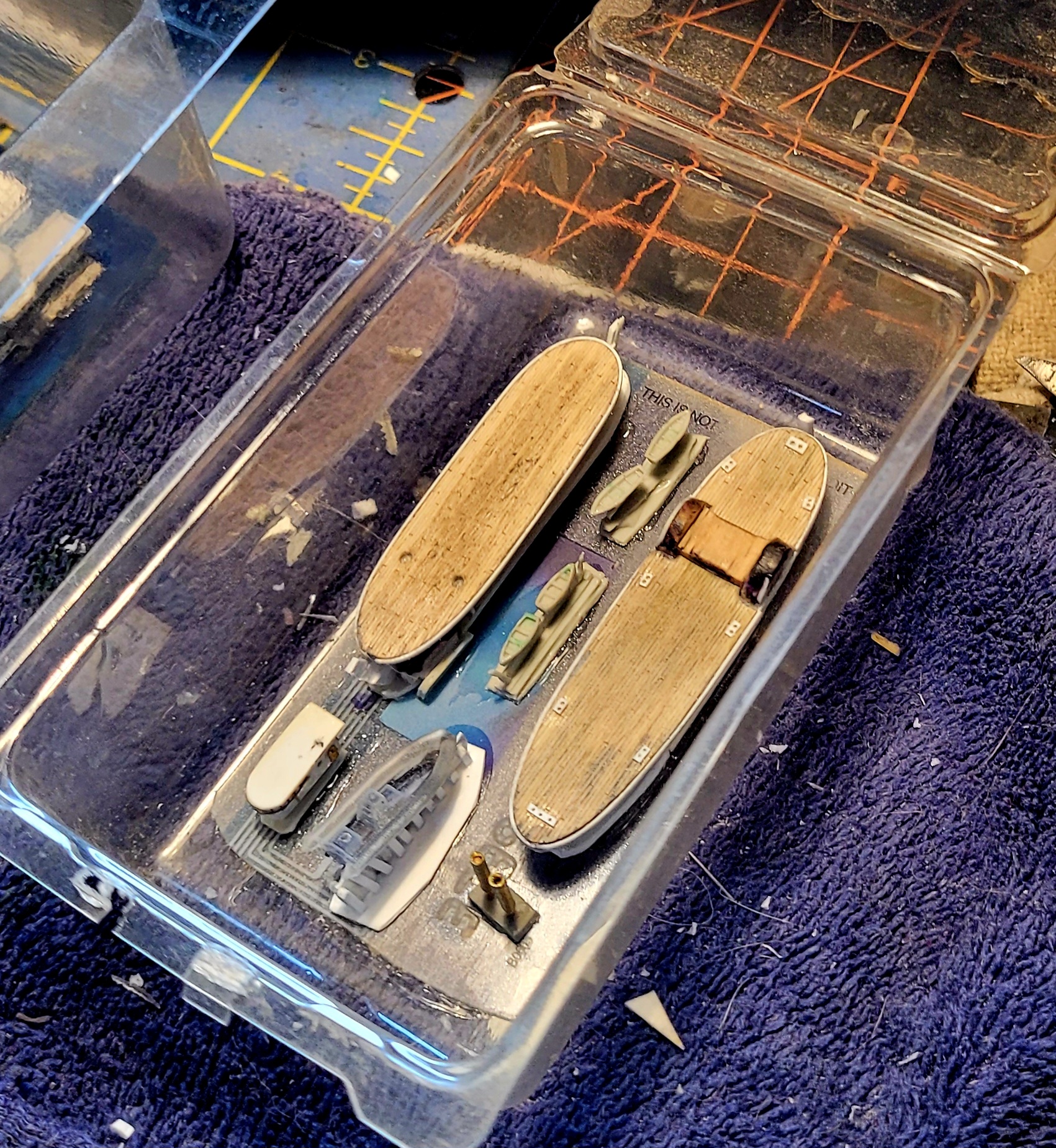

The process begins with our old childhood friend. Lego! I use a bit of natural clay, to line the bottom of the mold box.
Place the "Masters" on the clay, so they will stay where you want them.

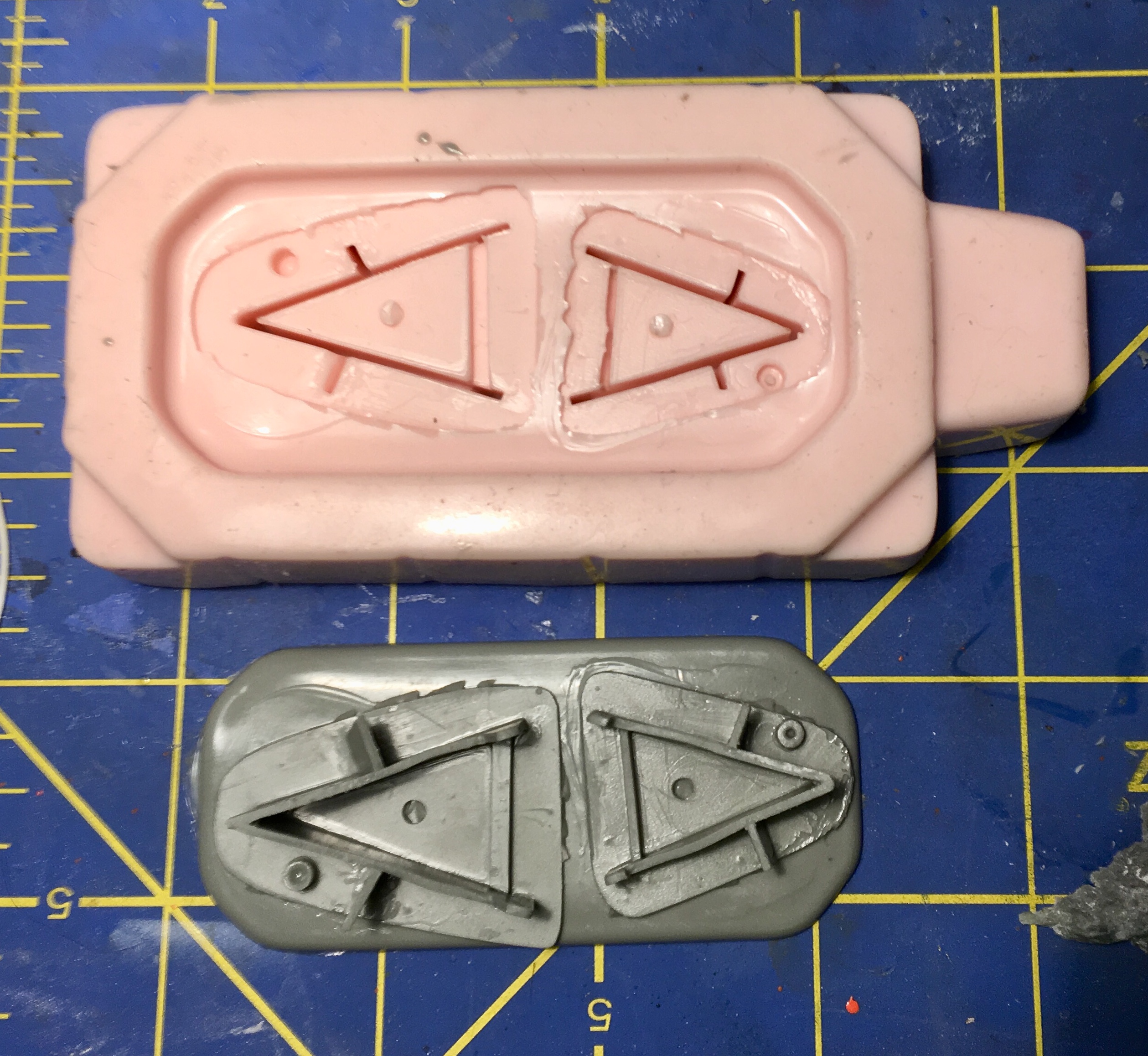

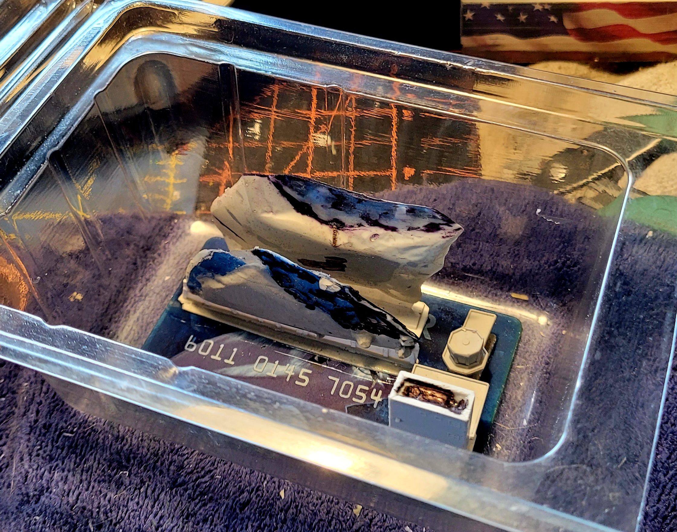

Mix your RTV, I use 10/1 ratio 2 part rtv rubber. I get it from Micro-mark. Mine is over a year past the "Use-By" date, but we'll see how it goes! :drinks
48 Hours later, in defference to my "stale" RTV, pop the lego off the walls of your box. Flex the mold, and remove your "Masters". Now is the time to wash everything. I use a wee bit o' shampoo, and an old toothbrush.
Clean the clay off the mold, and wash up your Legos for furthe use.
Close-up of the cured mold. hood to You have to be secure in your Manhood to use the Red/White RTV components! :coolio

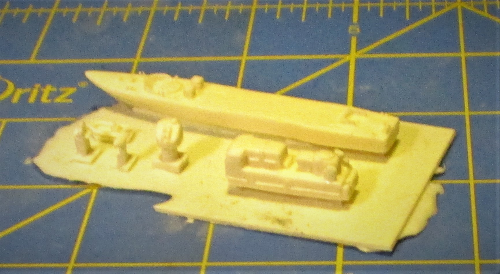

I had the stuff, it's paid for, so I thought I'd give it a shot, and molding/casting IS a little bit of model-fun!
