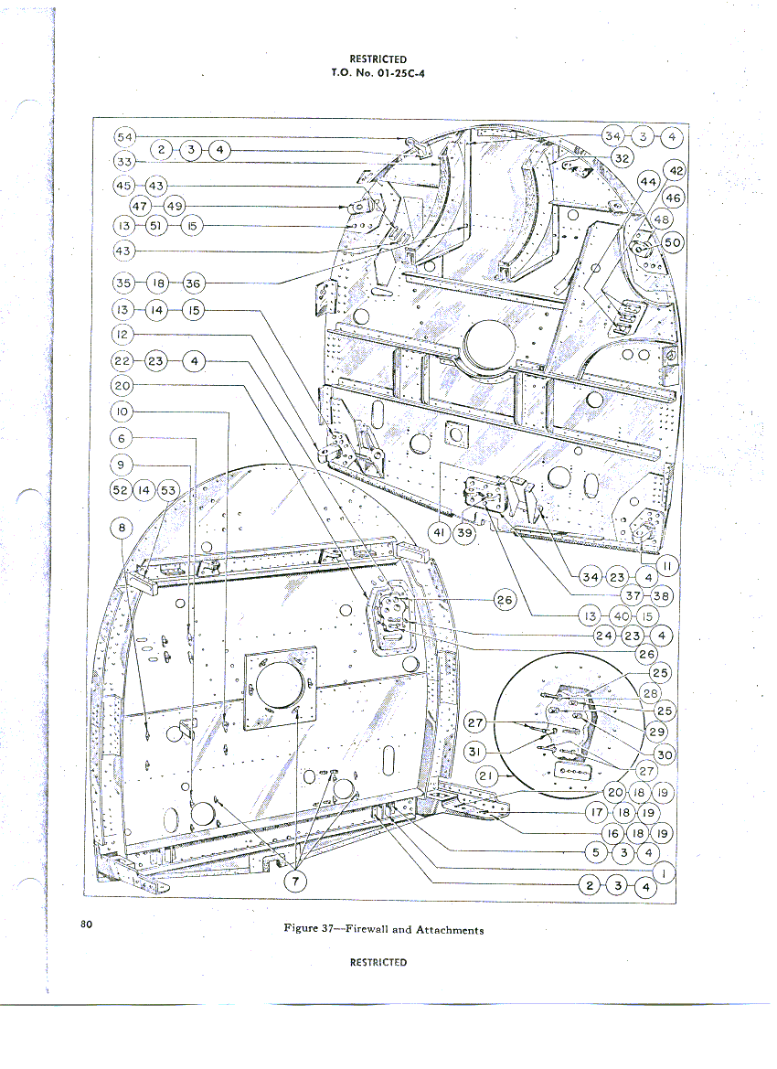

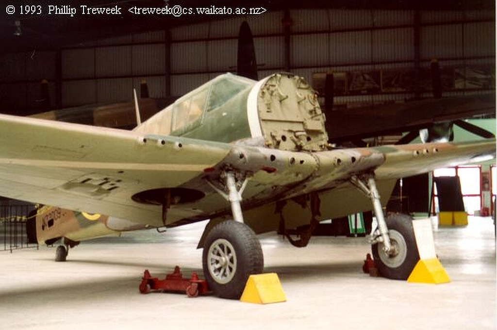

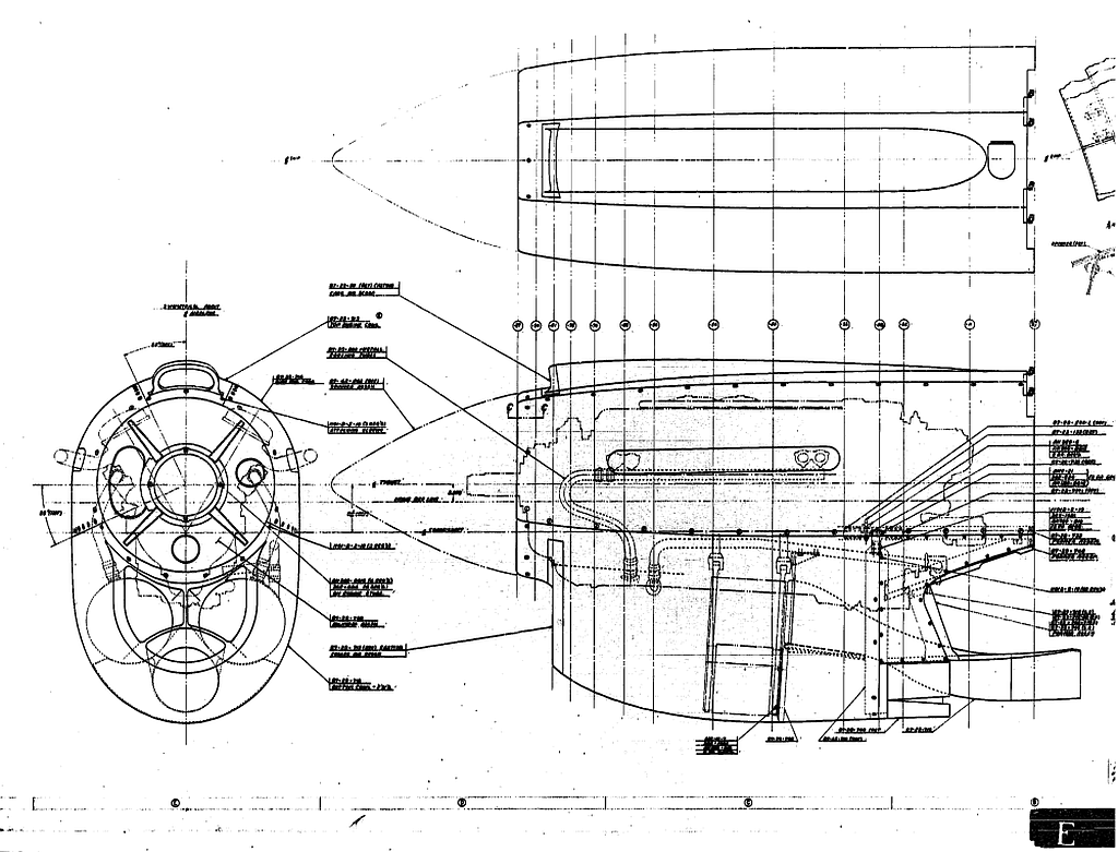

Not sure yet. Thanks to you and others I have quite a bit. Right now looking for a diagram with captions for the engine side of the firewall. Have some photos. This is going to be more in depth project.
Joe
Saul, you always come through.
Nope, the other way around... You always come through to show what you did with what I provide. You're always welcome to the well. ;) Click link (well) if you are not sure what I am referring to...
So, don't be afraid to ask... I have as many manuals as I could collect as well as books and photographs, many of the aircraft under restoration (although I don't rely on those images unless cross-referenced to the manuals).

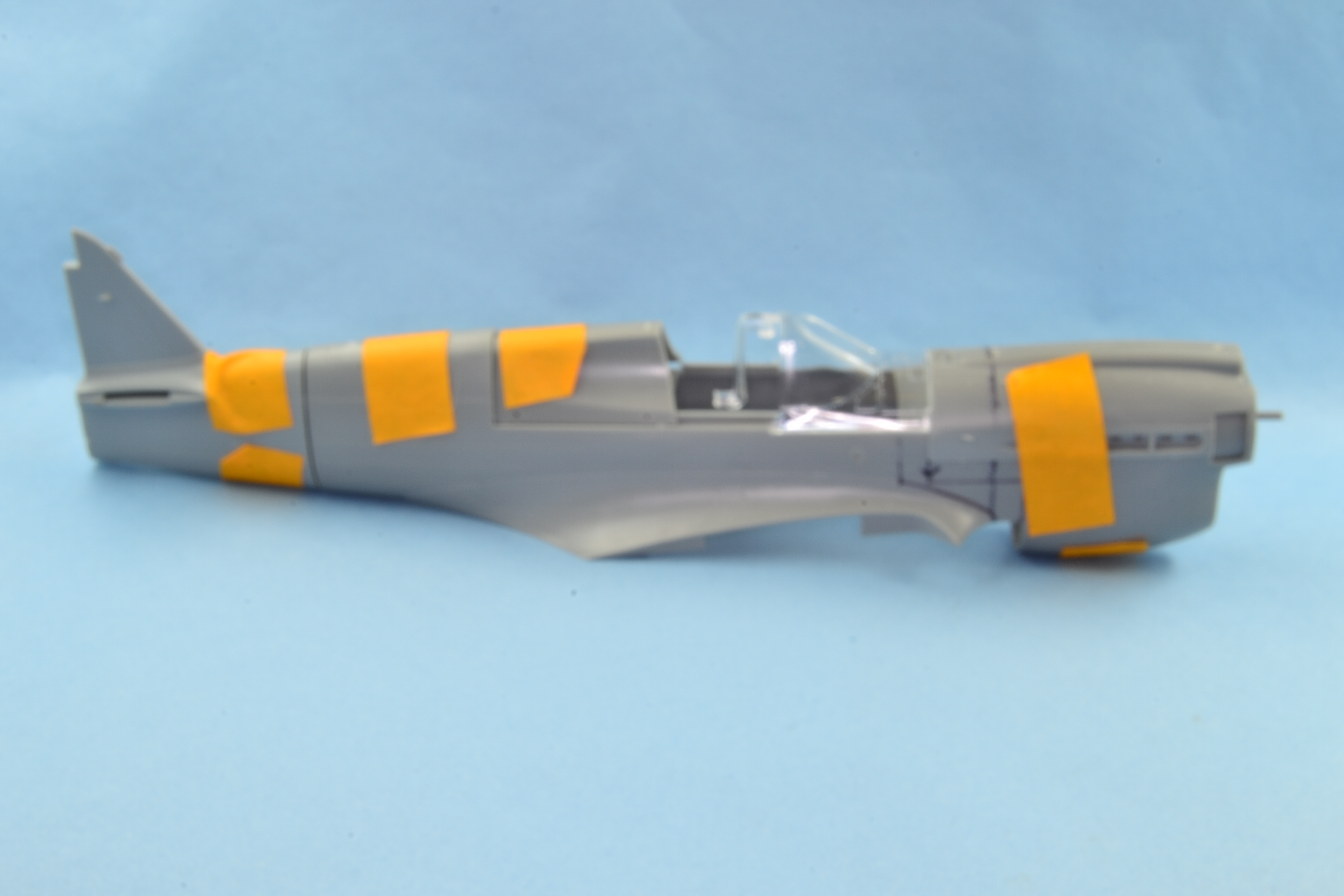

Hasegawa 1/32 P-40E. Where to start? How about with some styrene carving. The firewall is begun, some odds and ends added. The inner bulkheads are roughed out. Much more to do but it is a start.
Joe

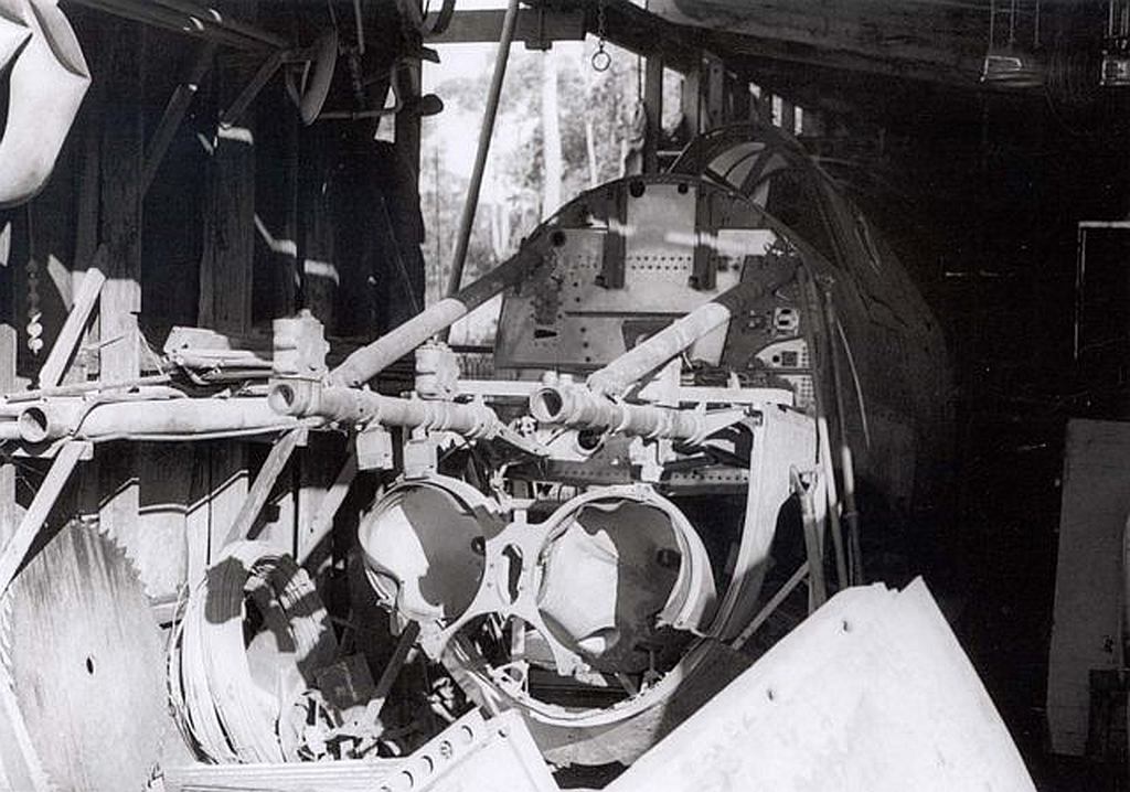

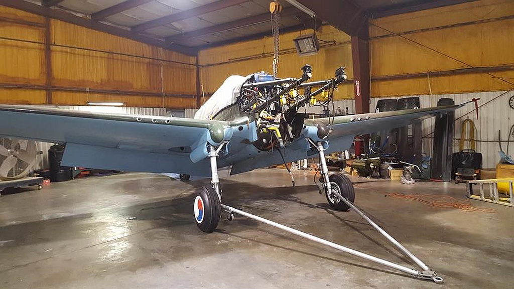

What I need to do is go through what I have. Somewhere I have something showing the firewall and engine mounts before the engine is installed. Need to find it.

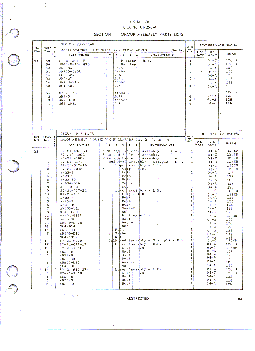

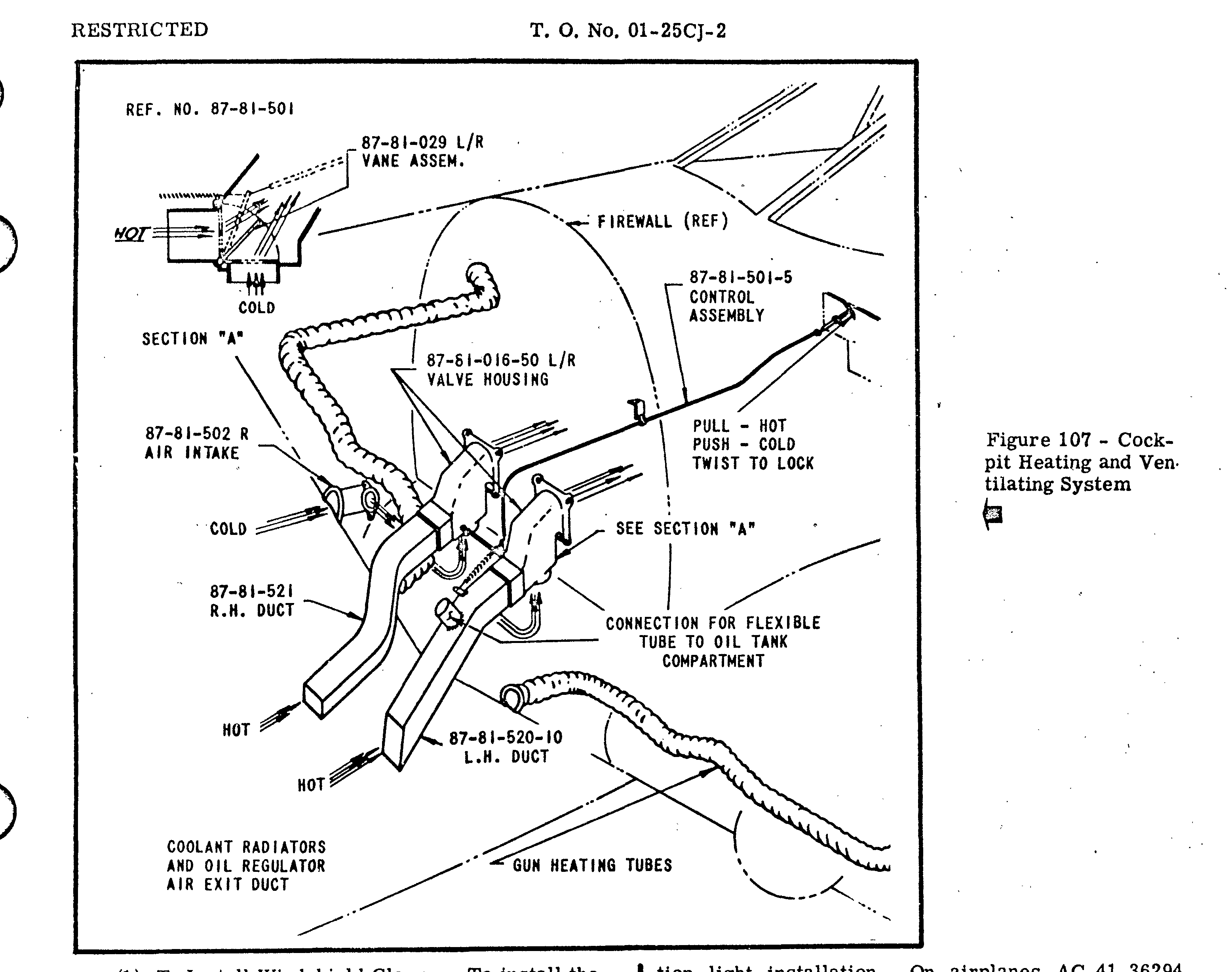

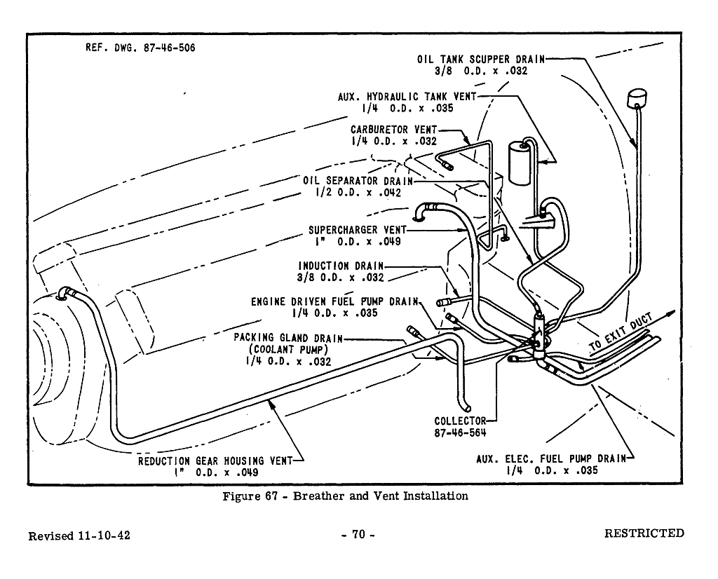

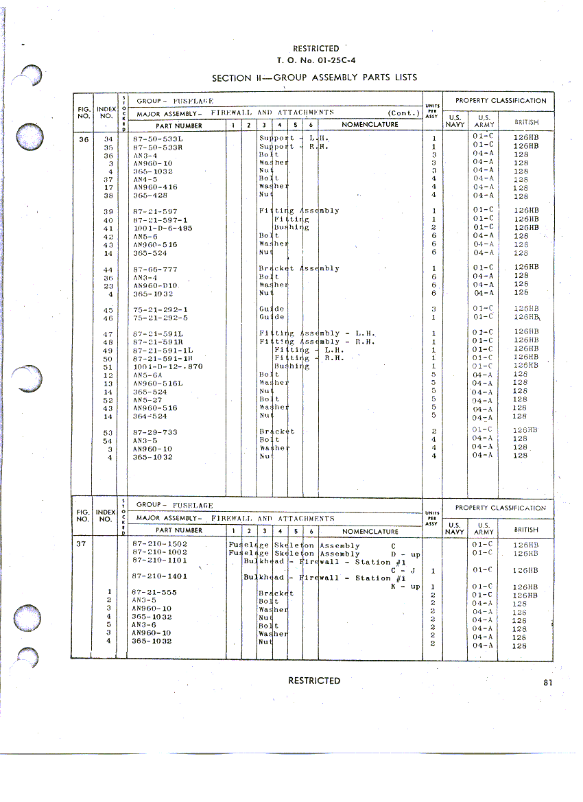

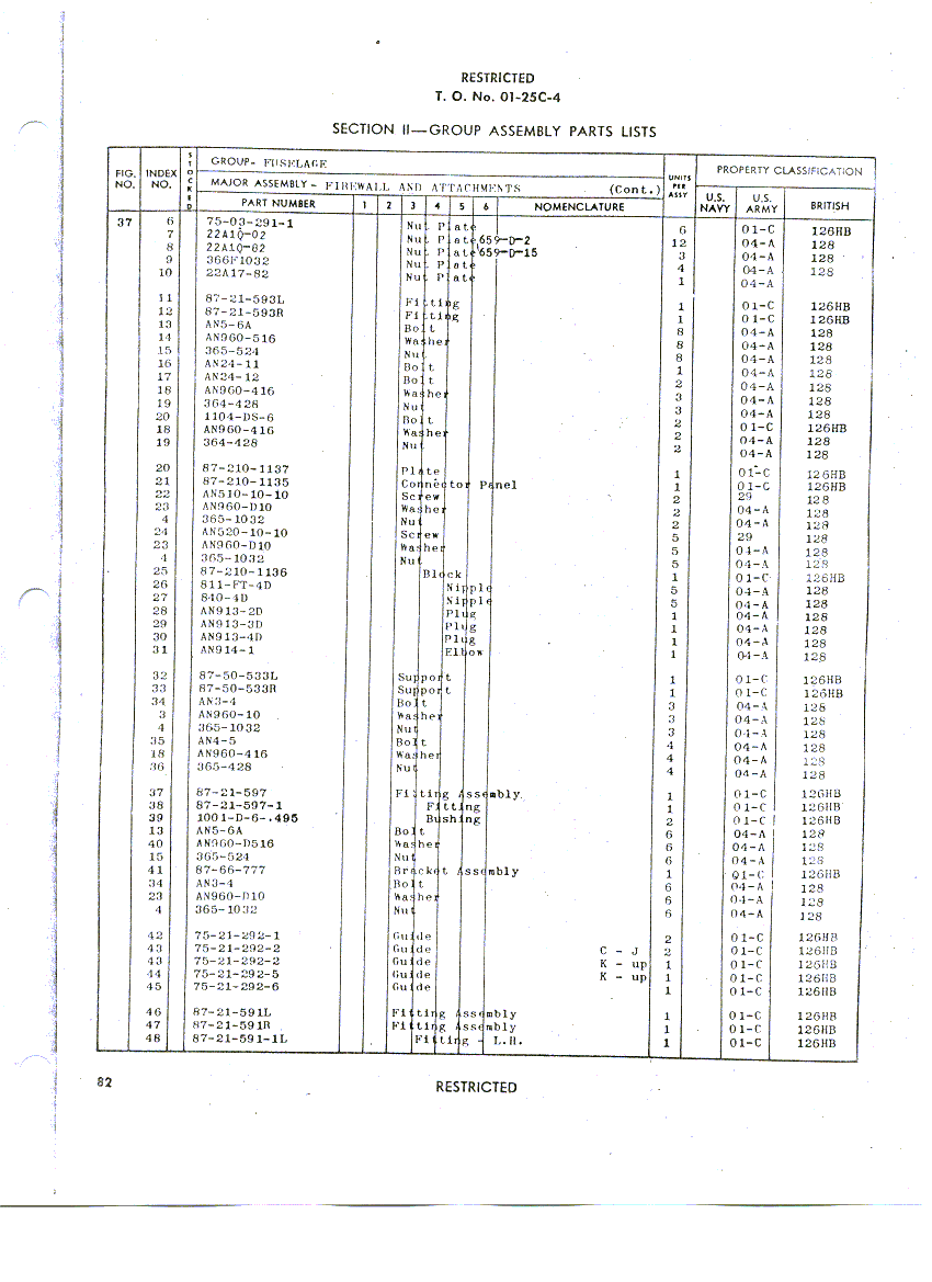

Well, you know I have it if you don't find it. Thanks for sharing here. Some extras for the firewall... Use what you can and let me know if it is TMI:
