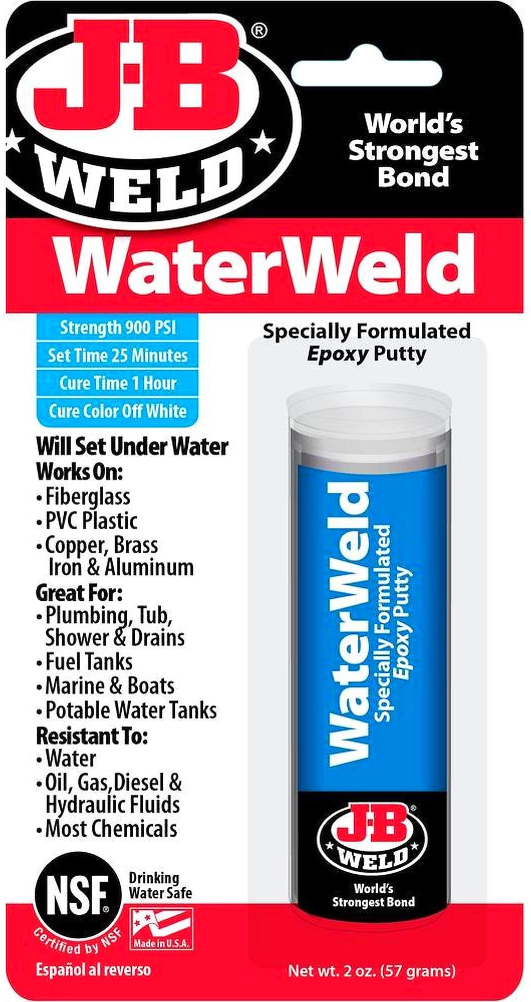

One thing after another for me... snowed twice, then freezing rain, then snow just so that Mother Nature shows me who is number one (using her middle finger). Of course, this happened right after my "issue with tissue" afterwards which the ceiling underneath leaked. I took the toilet off and back on to make sure it was installed properly (it was). Got angry as I realized I have a problem with a pipe. Since the plumber would tear into the ceiling of the lower bathroom (directly under the upper bathroom) I asked myself, aren't I a plastic modeler? Don't I cut, measure, attach, cover seams, prime, and paint? Soooooo, what is the difference in ripping the ceiling afterwards? Long story short, cut out a rectangle, found the cracked copper drain pipe (no pressurized water there) and repaired with the correct putty, primed it, and it seems to be working. Next week, if all is well, I'll repair the ceiling. Today, I found out fow fast I can go from vertical to horizontal on the ice... twice!

Saul you puttying over a copper drain pipe? I've not heard of a copper drain pipe. Might be a yankee thing, I don't know. I think I would be cutting out the offending pipe and replacing it.
@Rhino what's your thoughts here?
I'd have gotten some brass or copper sheet, formed the sheet around the pipe and soldered it over. Plastic is a different story.
Turns out it was brass but there is an epoxy putty designed for this type of repair on drain pipes (obviously not supply pipes). No pressure in it at all so it is working fine. Letting it cure a few days before fixing the ceiling.
@Rhino, you're a plumber? :D Lots of handy people here, I am NOT one of them!
Older homes (1960's) were piped in copper for the drains and galvanized iron pipe for the water supply. It is commonplace for areas where wastes don't drain readily to corrode more readily than the rest of the drainage. Usually a professional would cut out the offending old copper pipe using a neoprene Fernco gasket, then pipe the repair in PVC (poly vinyl chloride) plastic pipe.
It sounds like Saul made a suitable repair this time. Additional attention may well be required in the not too distant future.
Such a leak is oftentimes likened to wiping your backside on a hoop. There's no end to it.
