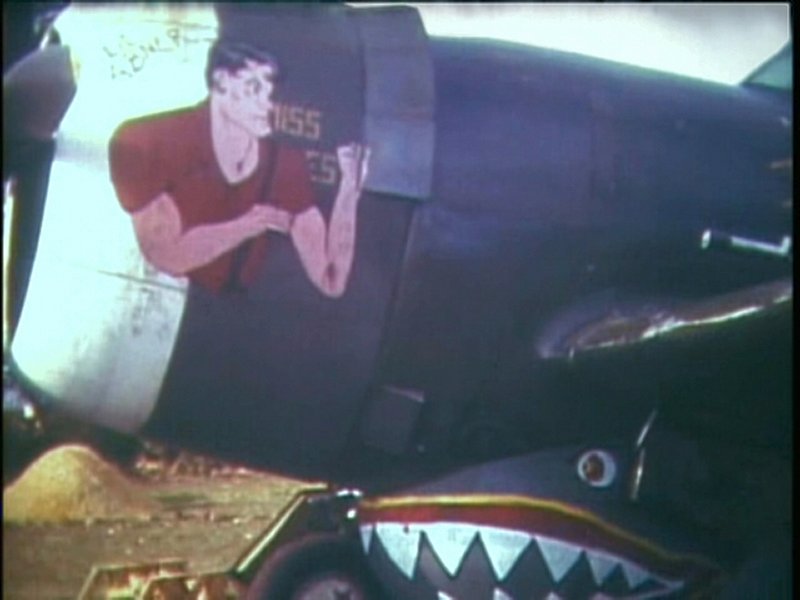

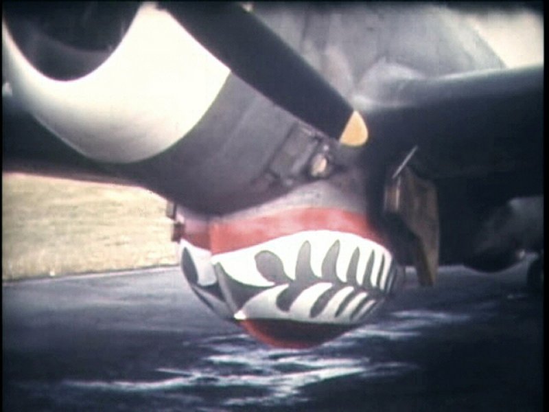

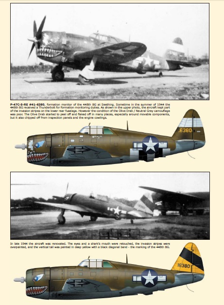

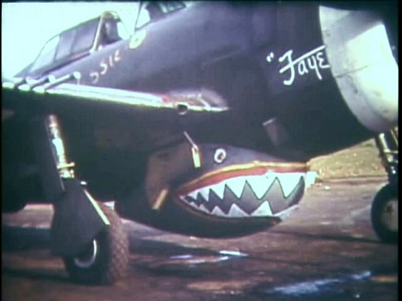

LM*O has a sharkmouth on the long range belly tank.

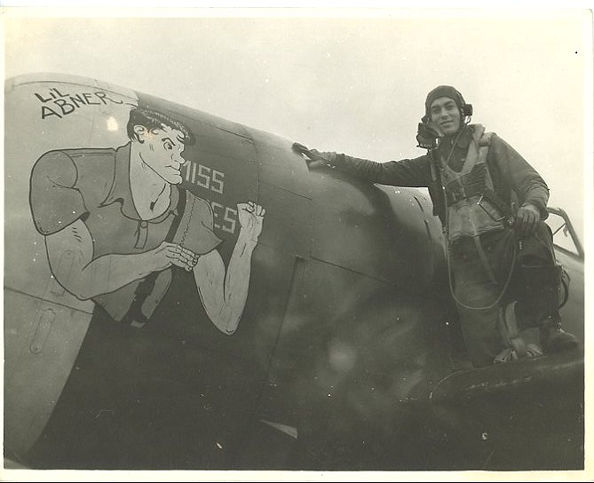

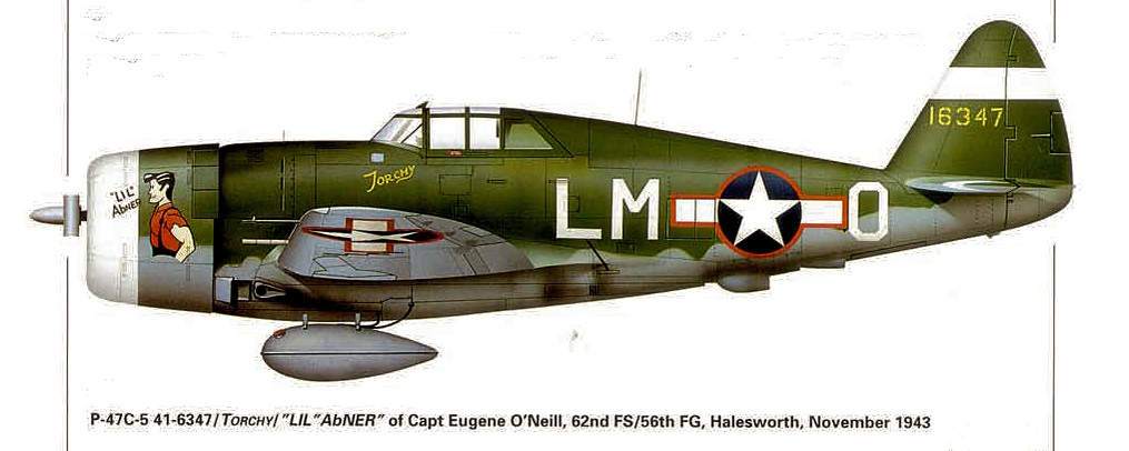

Different tank...
Diffrent artwork

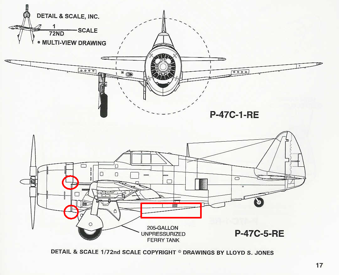

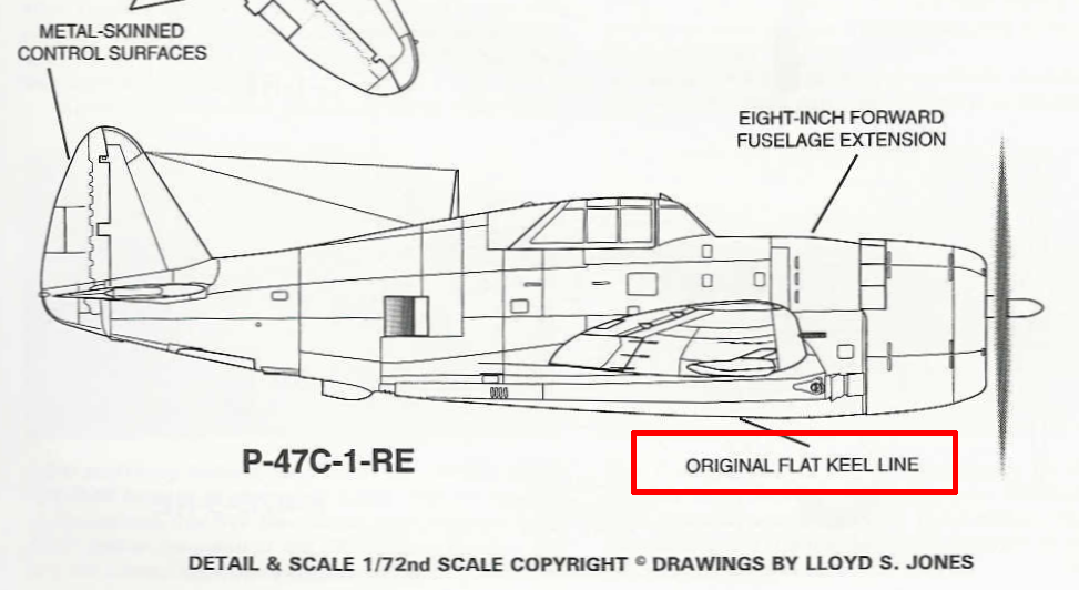

Neither the cowl flaps nor the belly look right to me.
OK, looking at the manuals, I think I see that the belly is bulged when it should be a flat keel line at this stage. I don't see the issue with the cowl flaps though.
Regards,

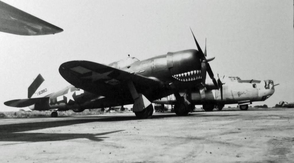

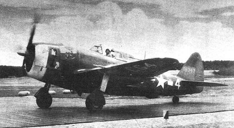

This photo shows the straight line on the cowl below the cowl flaps, no curve there.
Here is a close up of the cowl on 41-6358, P-47C-RE-5
The C had no provision for a drop tank from the factory, so the belly had a smooth curve all the way to the tail. When the drop tank was incorporated a slight bulge was produced so the sheet metal would cover the added plumbing. You can see a change in the curve just behind the cowl, and a second change near the trailing edge of the wing.

I've read a couple of places where the belly bulge was added on models -1-RE, the earlier did not have the wet/bulge belly. I see what you're talking about John with the curve, it's between the cowl flap and the cowl cover. Its a straight trailing edge.

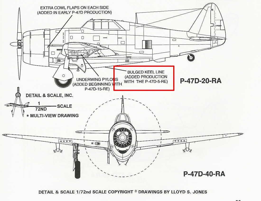

The trouble with following plans, even those from Air Corps Library Engineering are things that creep in. Lloyd Jones usually uses official drawings to create his plans and I see he added a bulge to the P-47C-5-RE and has that curved part below the cowling flaps:
Yet both P-47C-5-RE do show a slight keel bulge.
