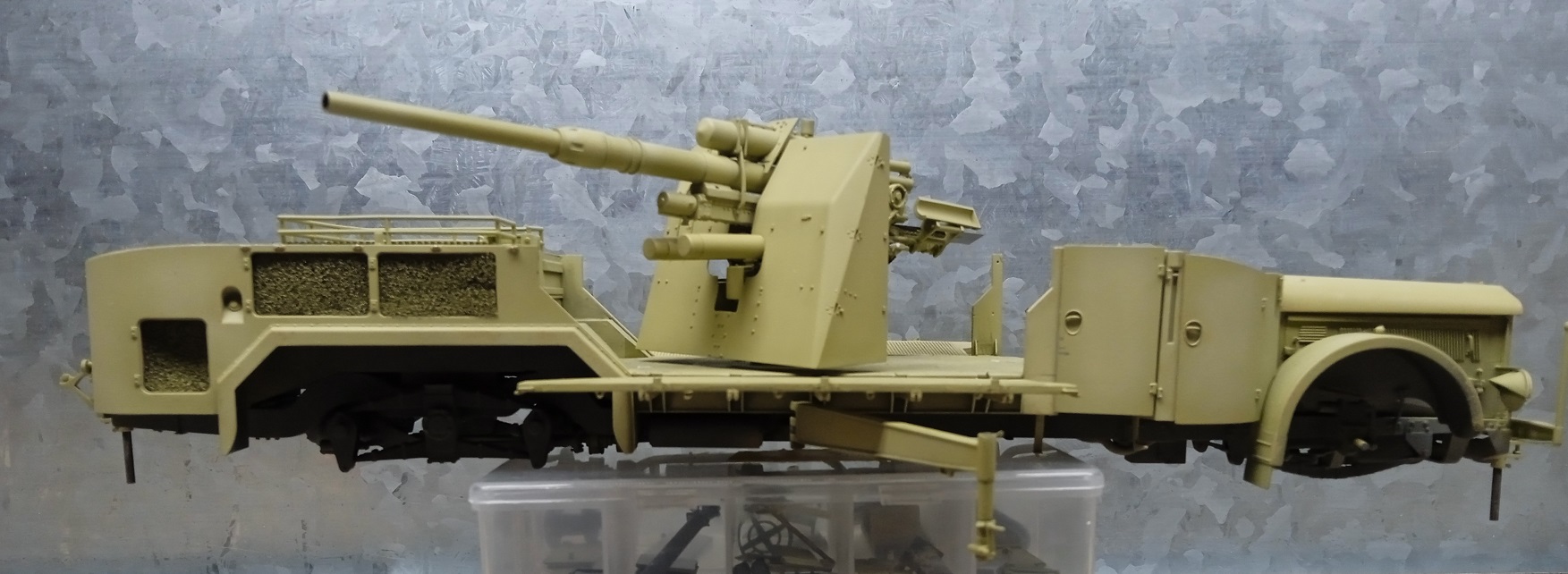

Nice kit, but could have done better.
Some tubular parts are slide-molded and others are not,
And they don't provide you with a shield for the FLAK,
Luckily I have the Border FLAK kit which contains tree different ones and one of them is the right one for this version I'm going for.

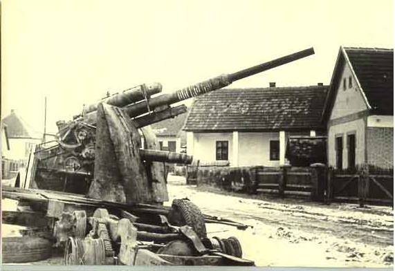

The German yellow version definitely had a shield ,if you look at period photos

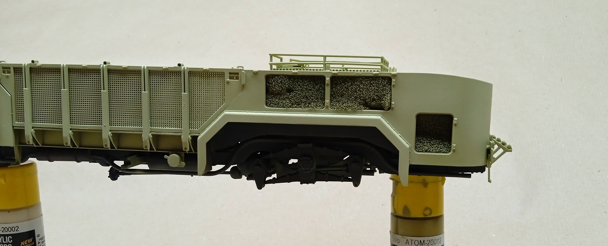

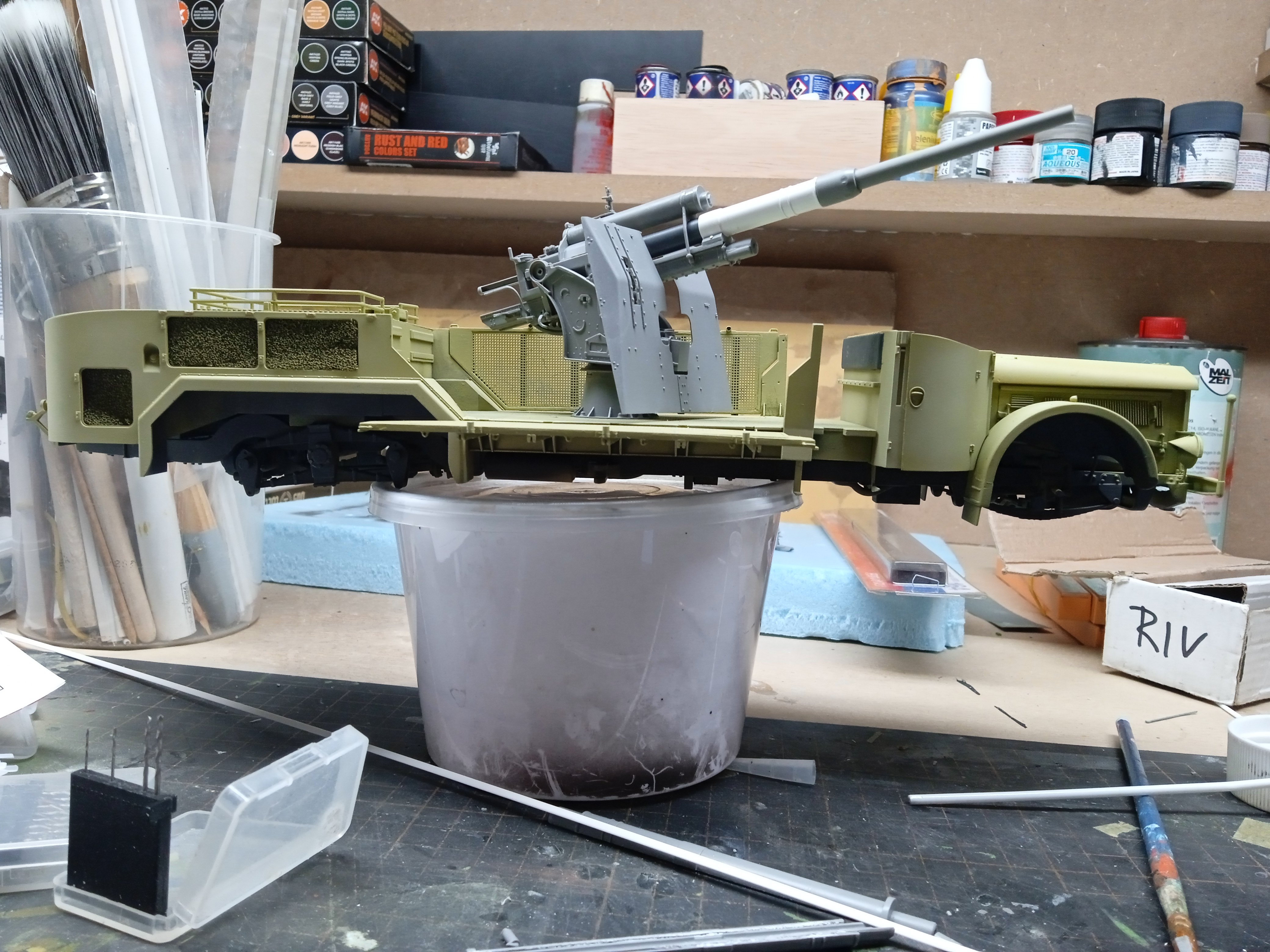

First time I used the new ATOM paint
Cannot be airbrushed directly from the bottle, but it had to be diluted
Sprays well and dries quickly.

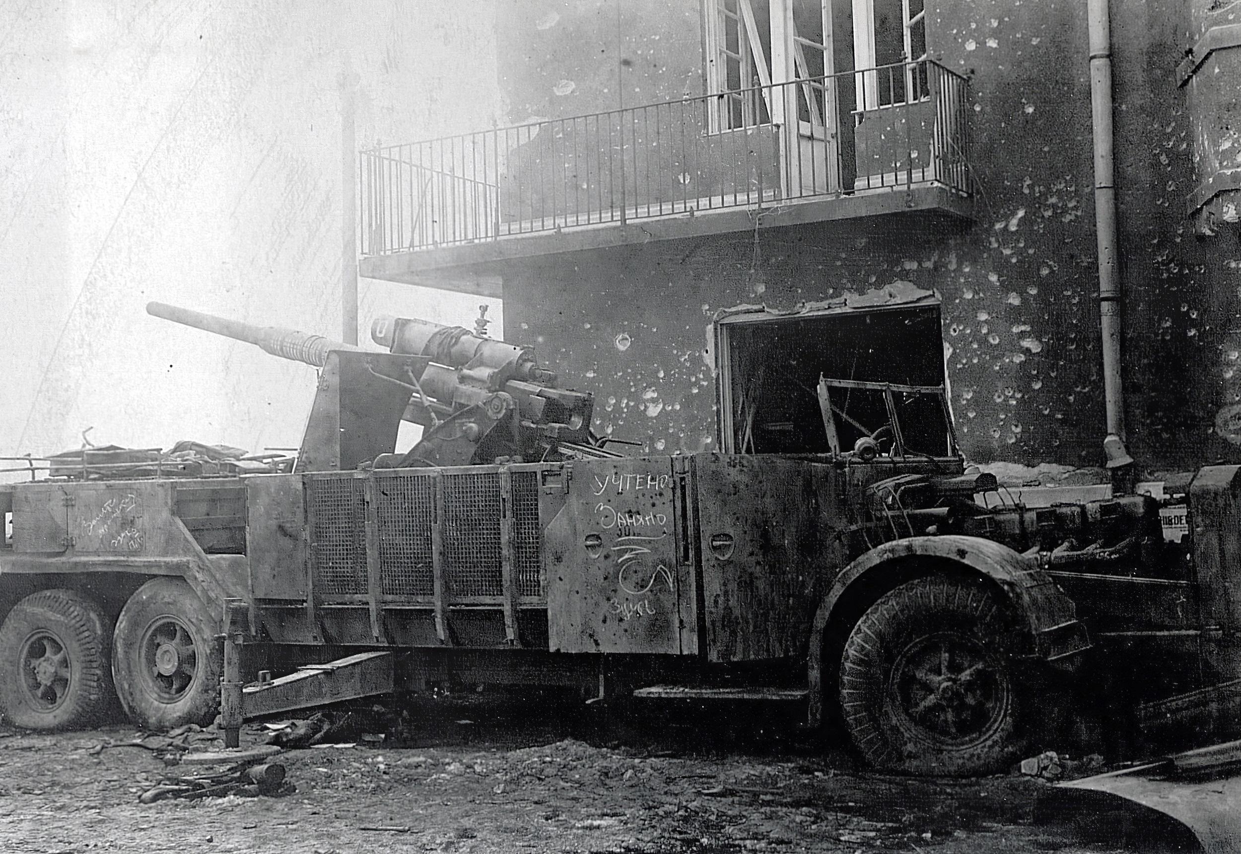

Interesting about the shield on the 88. Can you post a reference photo?
Always like your builds as you take on a lot of detail work.

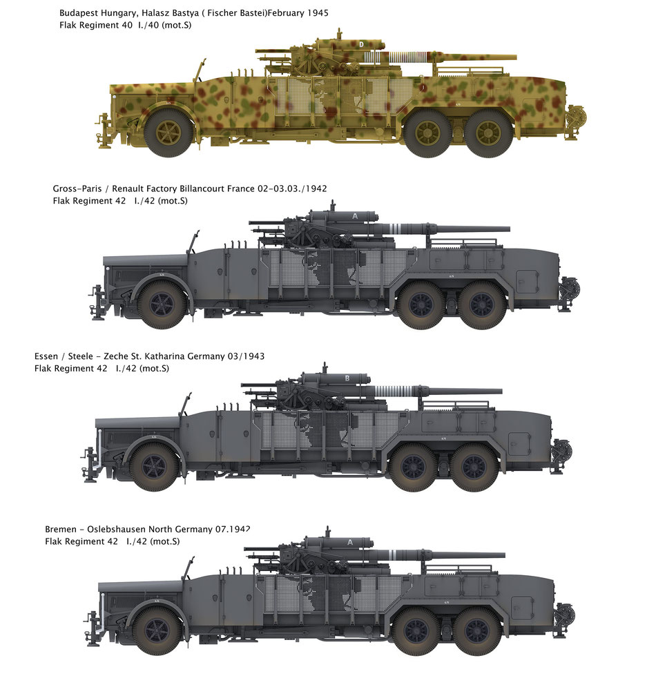

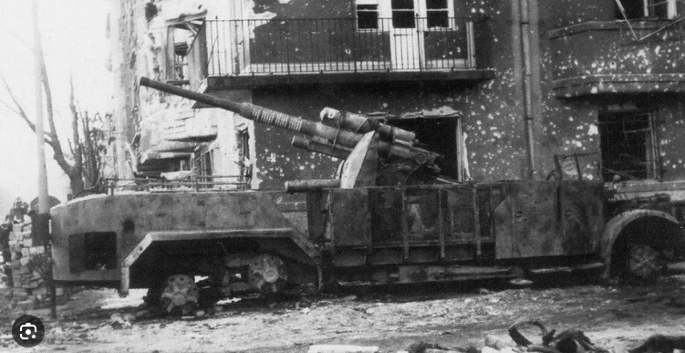

Looks like all the Darkgrey versions didn't have the shield ,

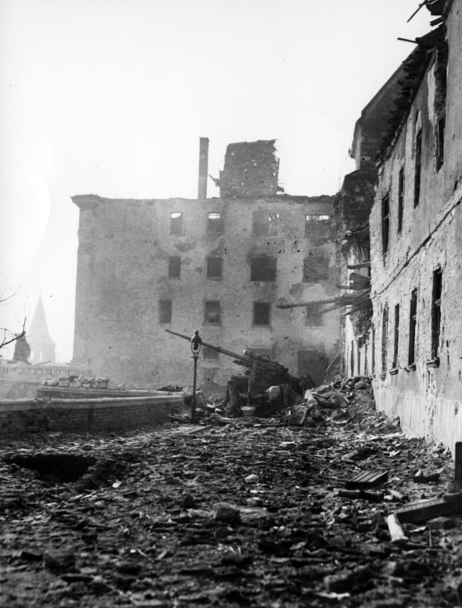

All remaining FLAK Trucks were lost during the Battle of Budapest /Hungary 1945.

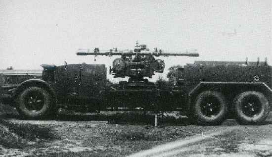

Also a version with a rangefinder (next kit ? )

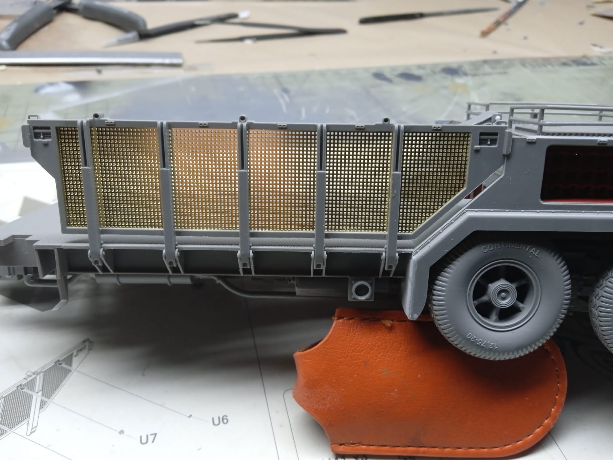

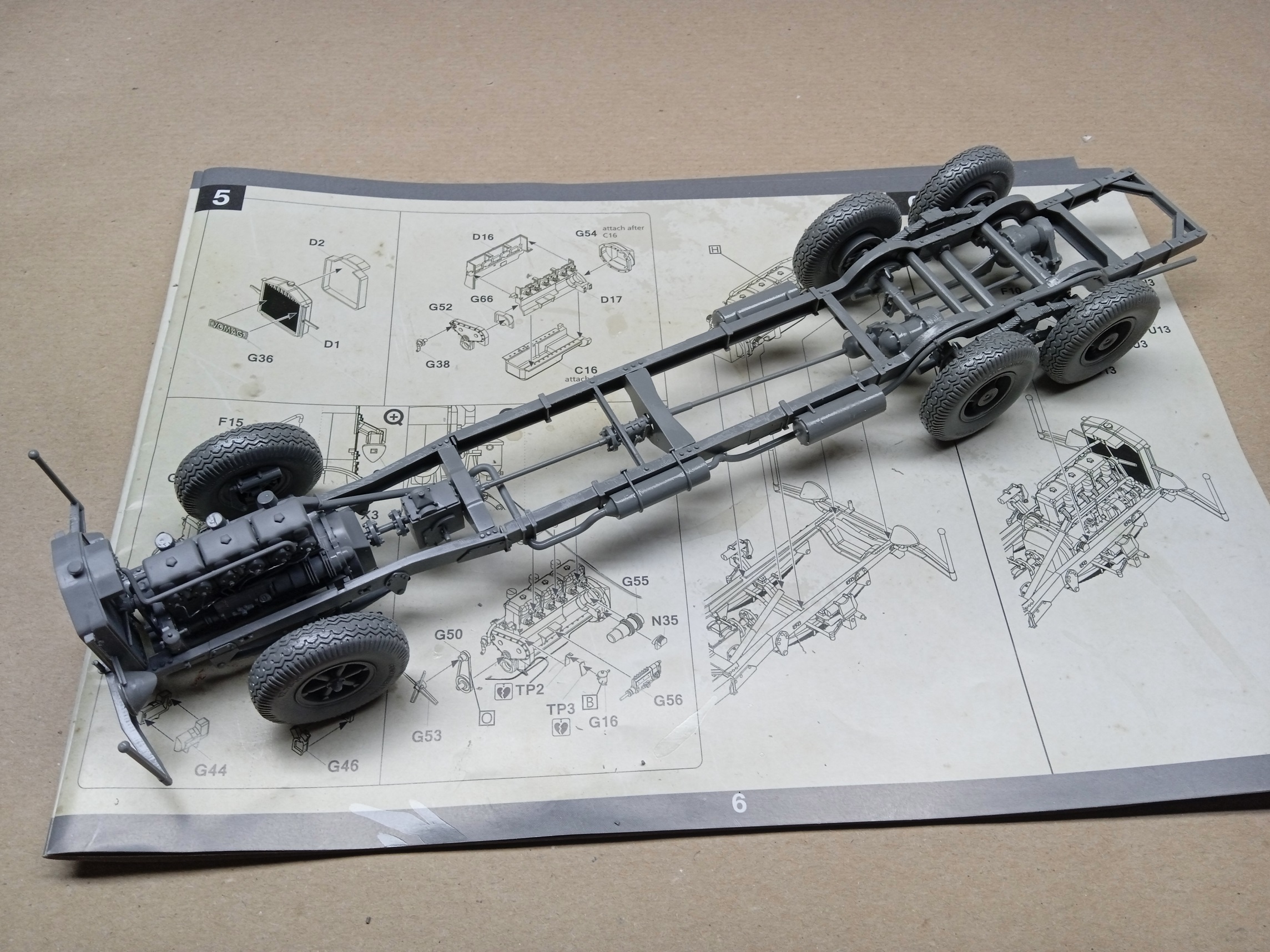

No fit problems ,some seam lines over rivets , had to replace them ,
Find the instructions not really clear for placing some parts on theFLAK .....

That looks really cool Piet! That isn't the usual 88 shield that is used on the field gun. Thanks for posting the reference photos.

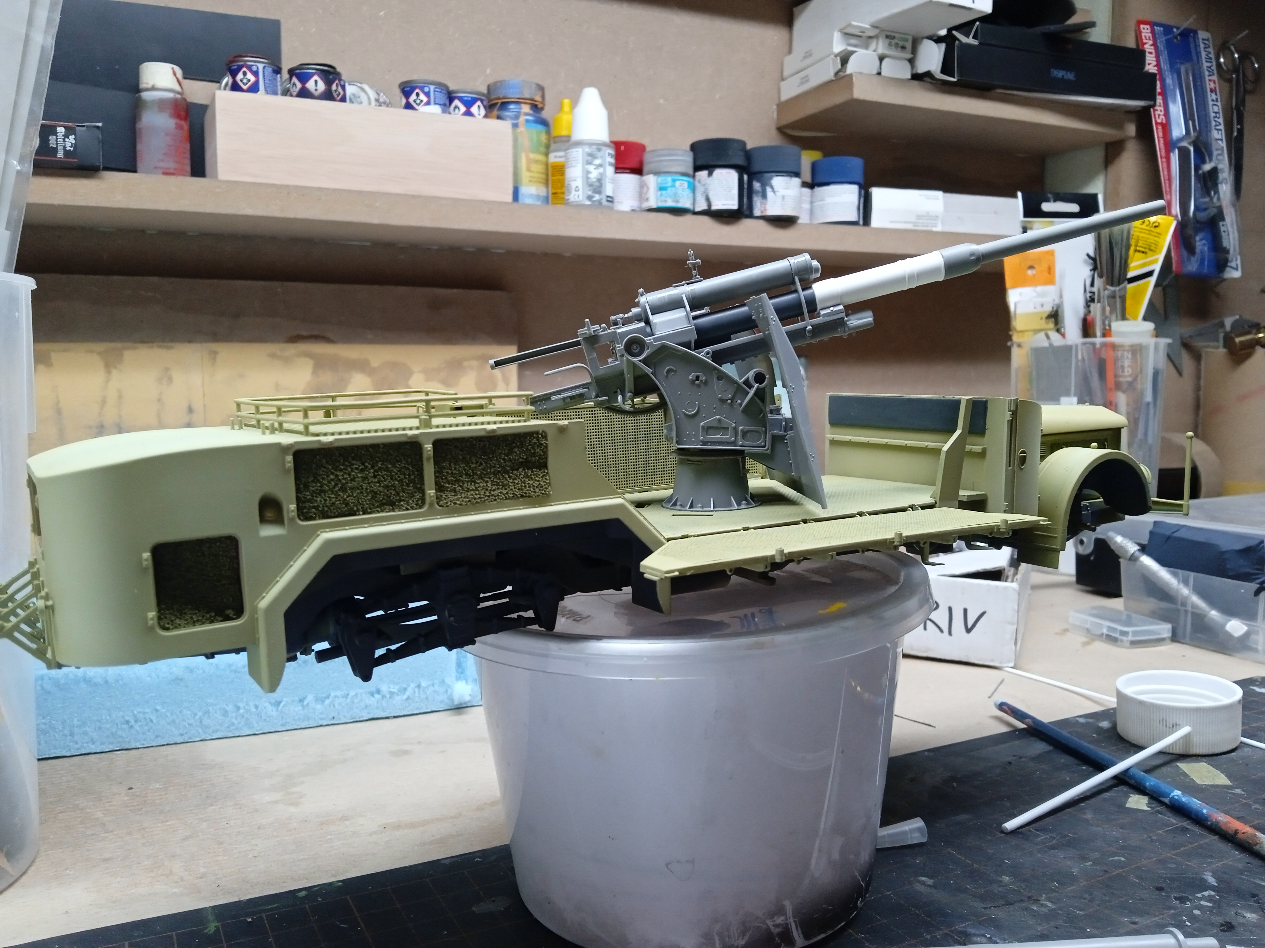

By the looks of it it is a pressed version,
and the sides are hinged (haven't attach them yet )

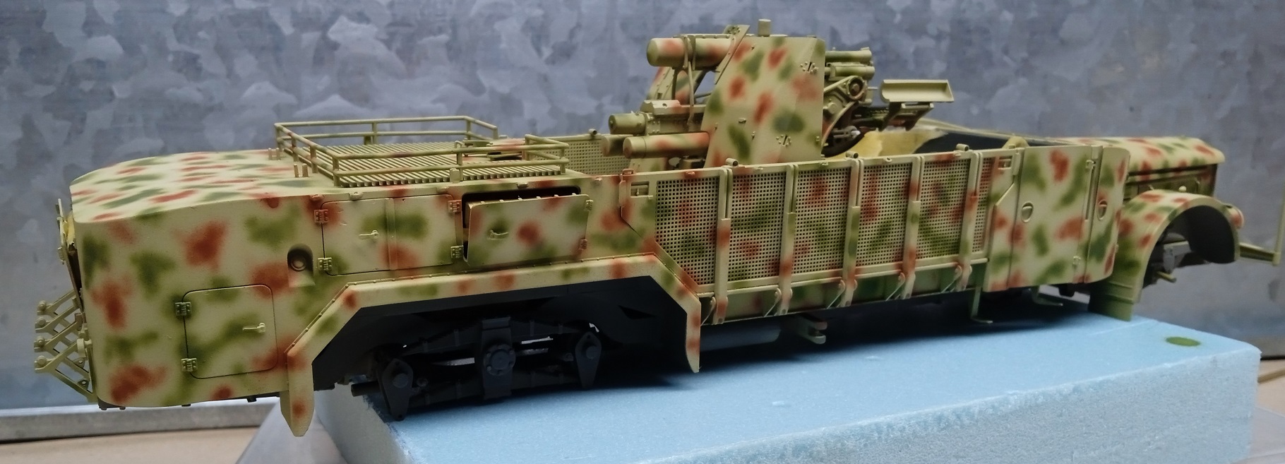

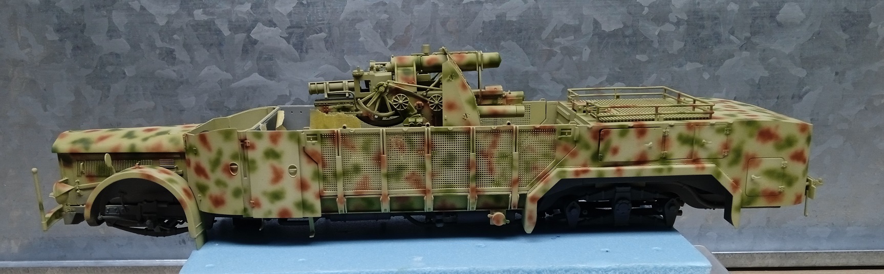

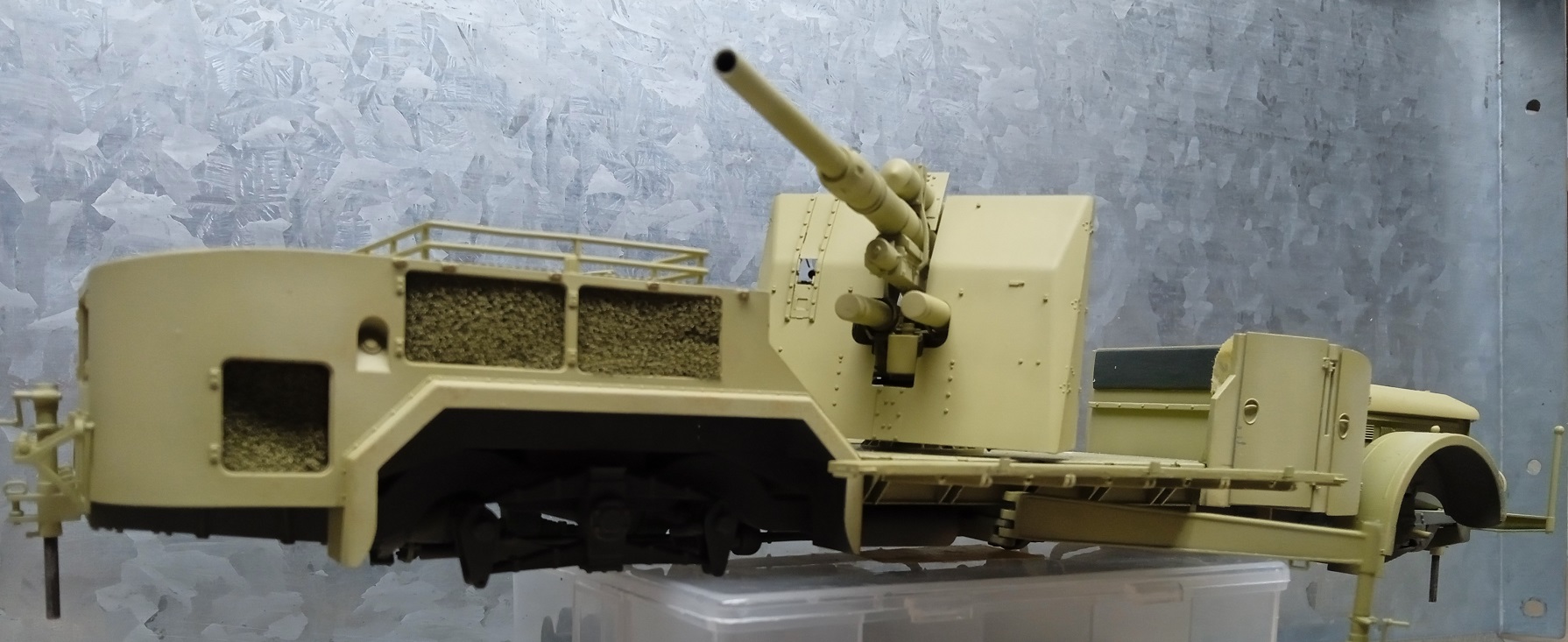

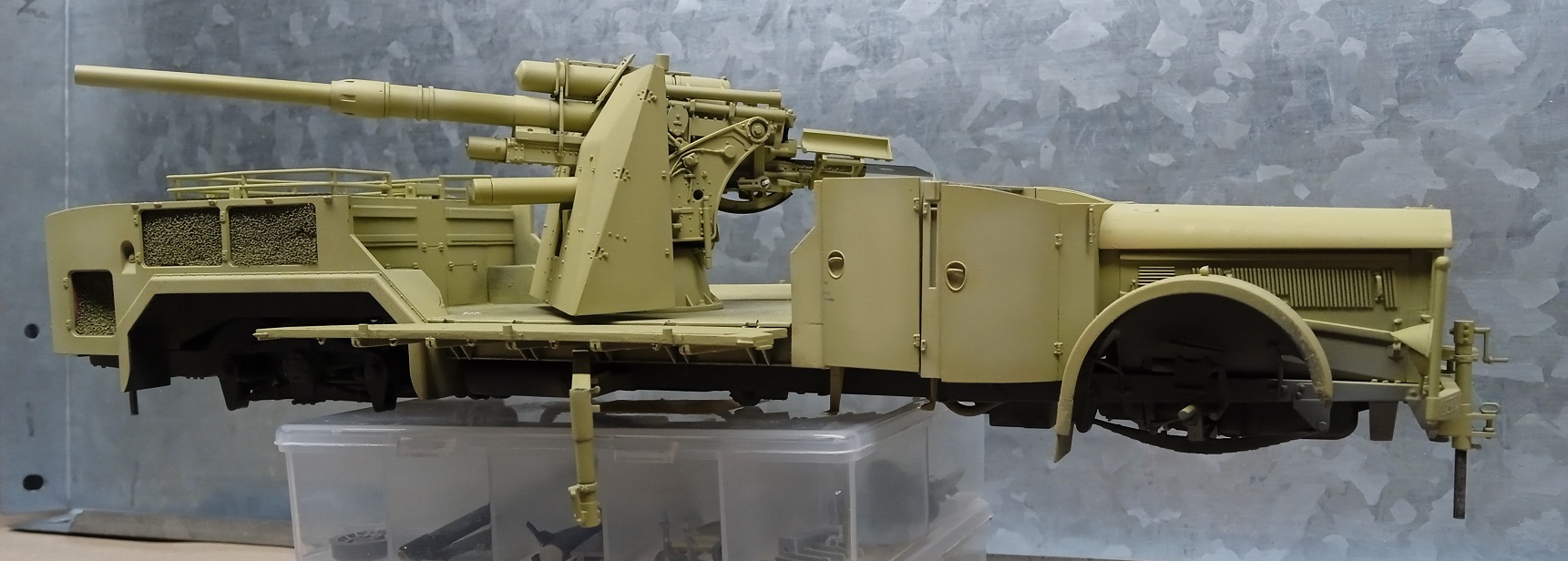

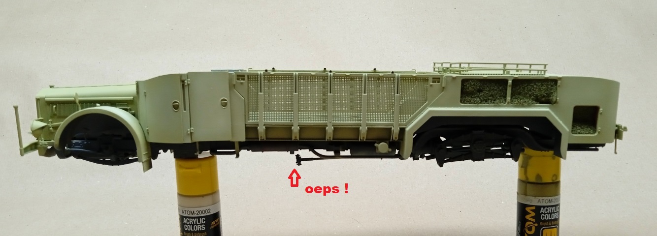

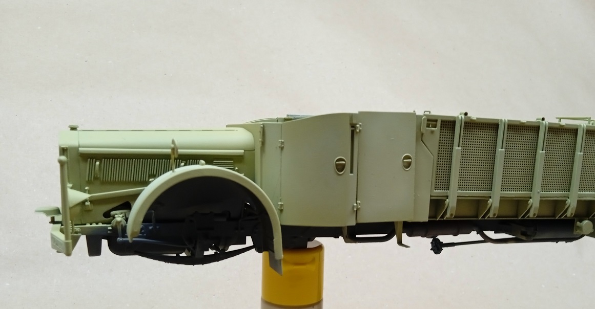

Completed the FLAK this weekend and added some extra details like wiring.
The Pressed version shield is from the Border kit becaus Das werk doesn't give you that option (as mentioned before )

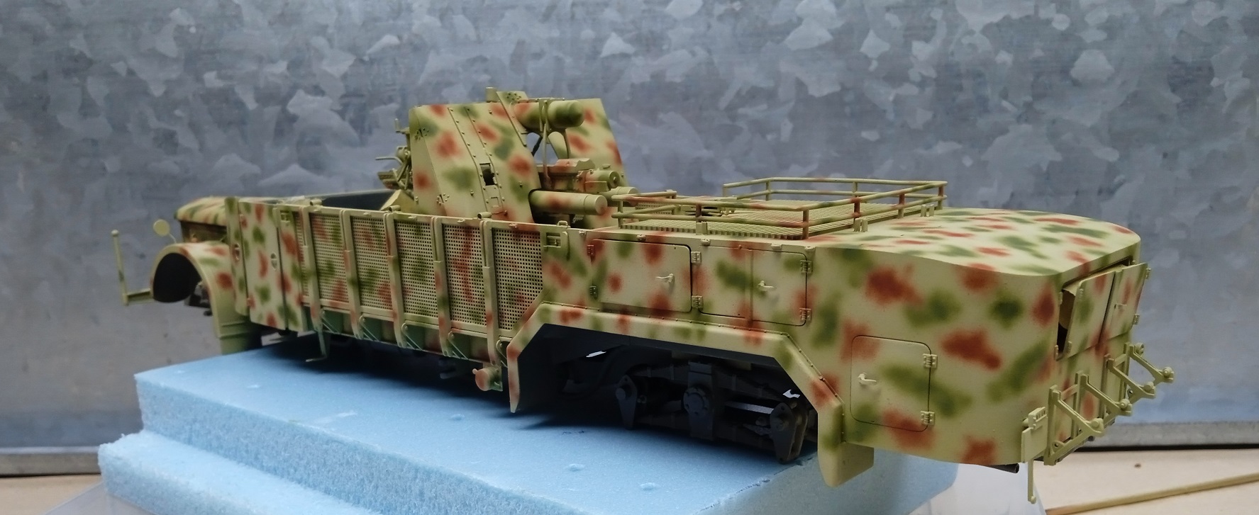

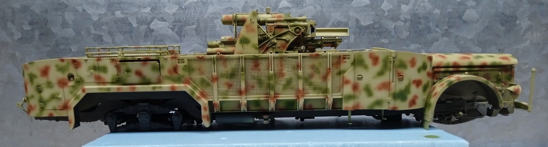

Next , spraying some green and brown camoflage spots
