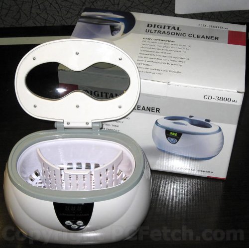

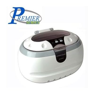

Bob, go to Amazon and find a new one. There are some which are MUCH cheaper than the one I almost pulled the trigger on at Micro-Mark (before they started competing with the brands they carried by copying them). I am on my second one.
This is the one I bought and it is now $27.88USD shipped:
Click me to buy!
It is the simpler model and is only On (3 minutes) or Off.
The 3800 model, which I owned previously, could be set for different times. Amazon has this for $34.95USD and Free Shipping!
This is the better buy.
