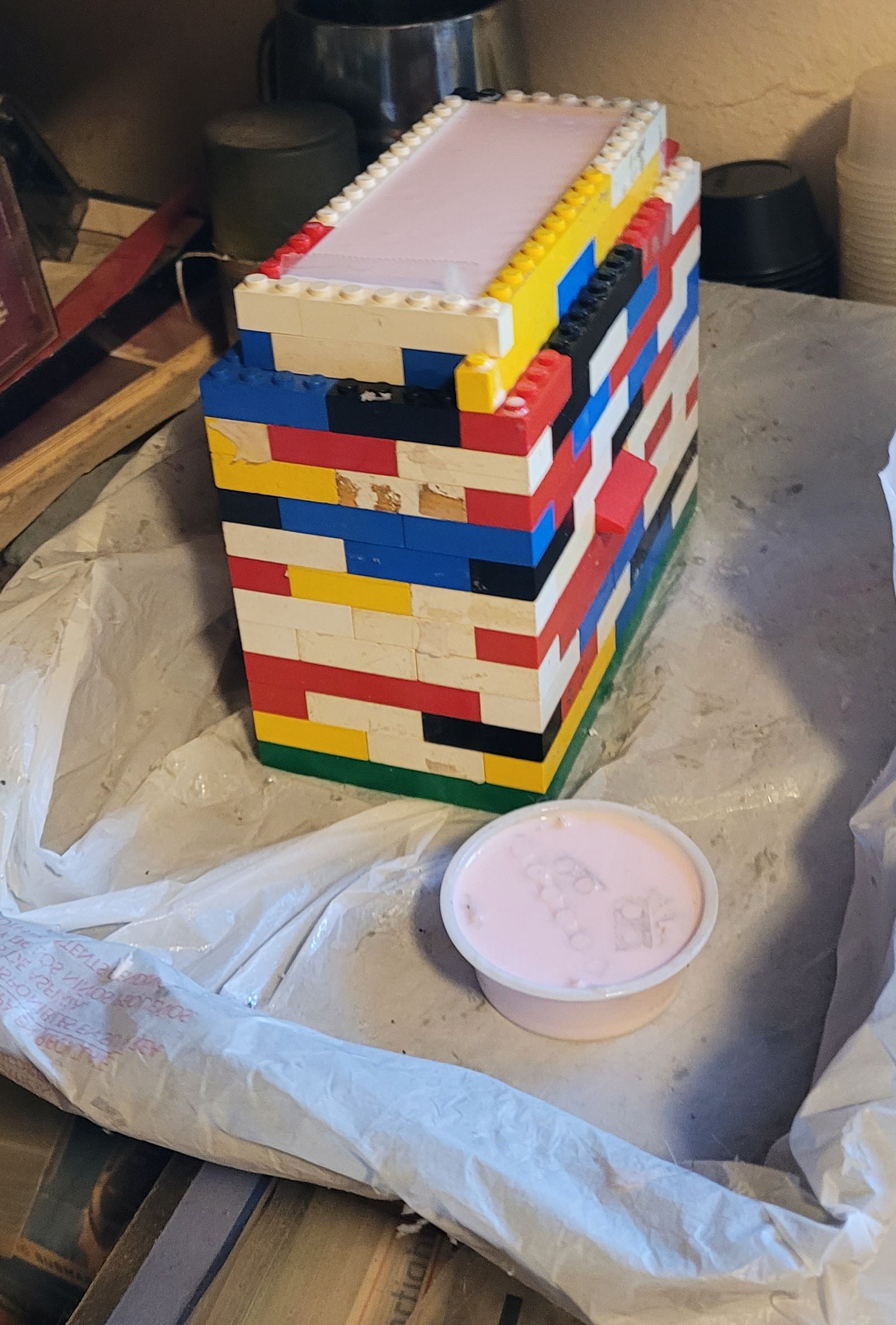

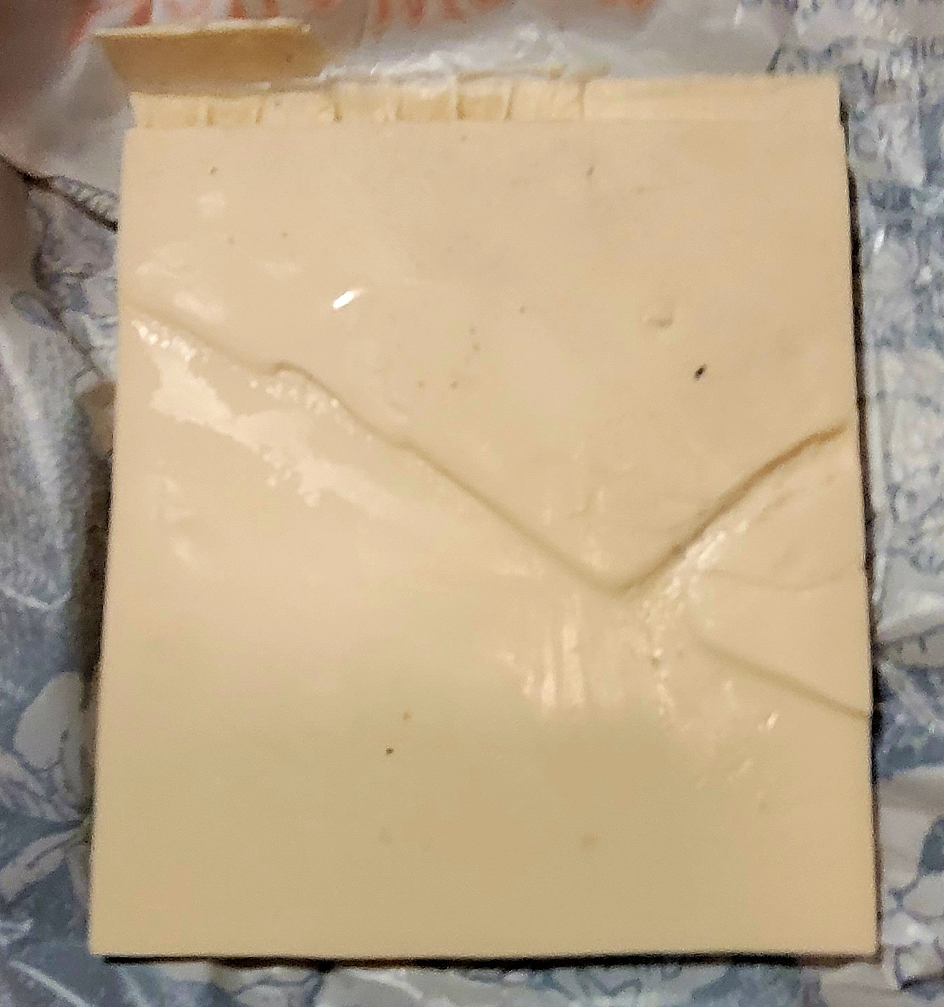

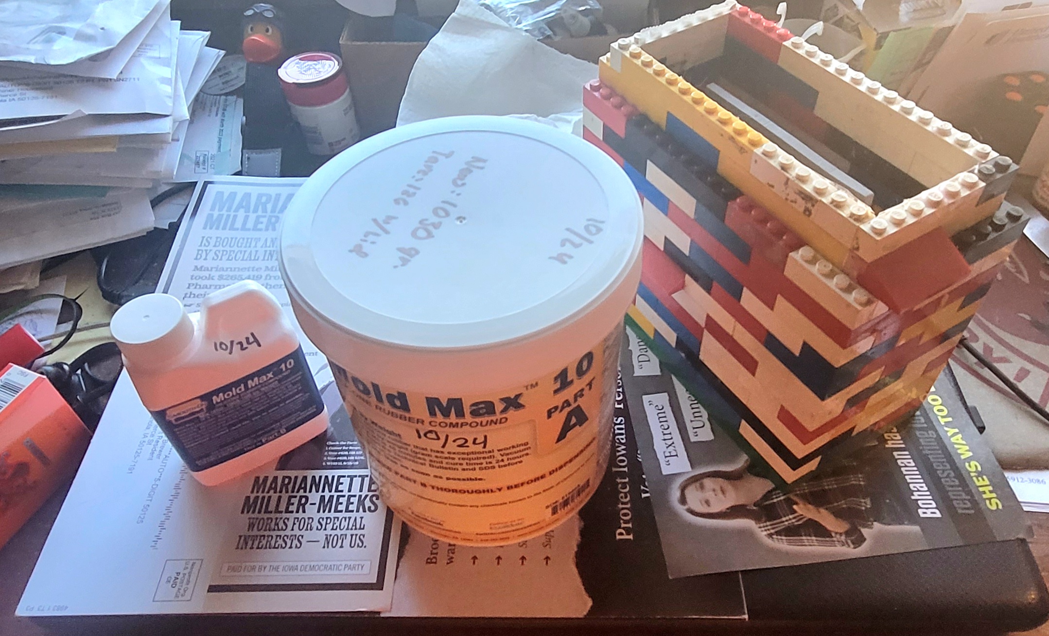

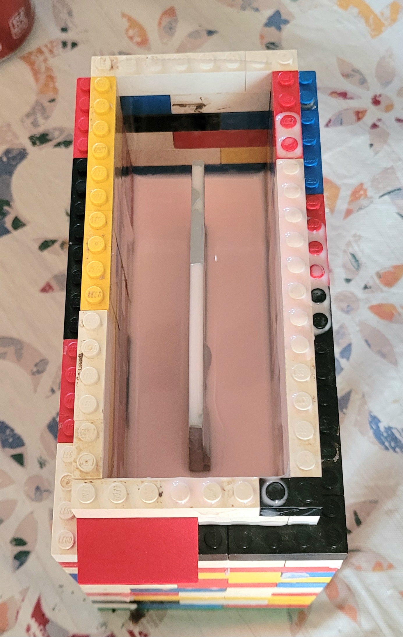

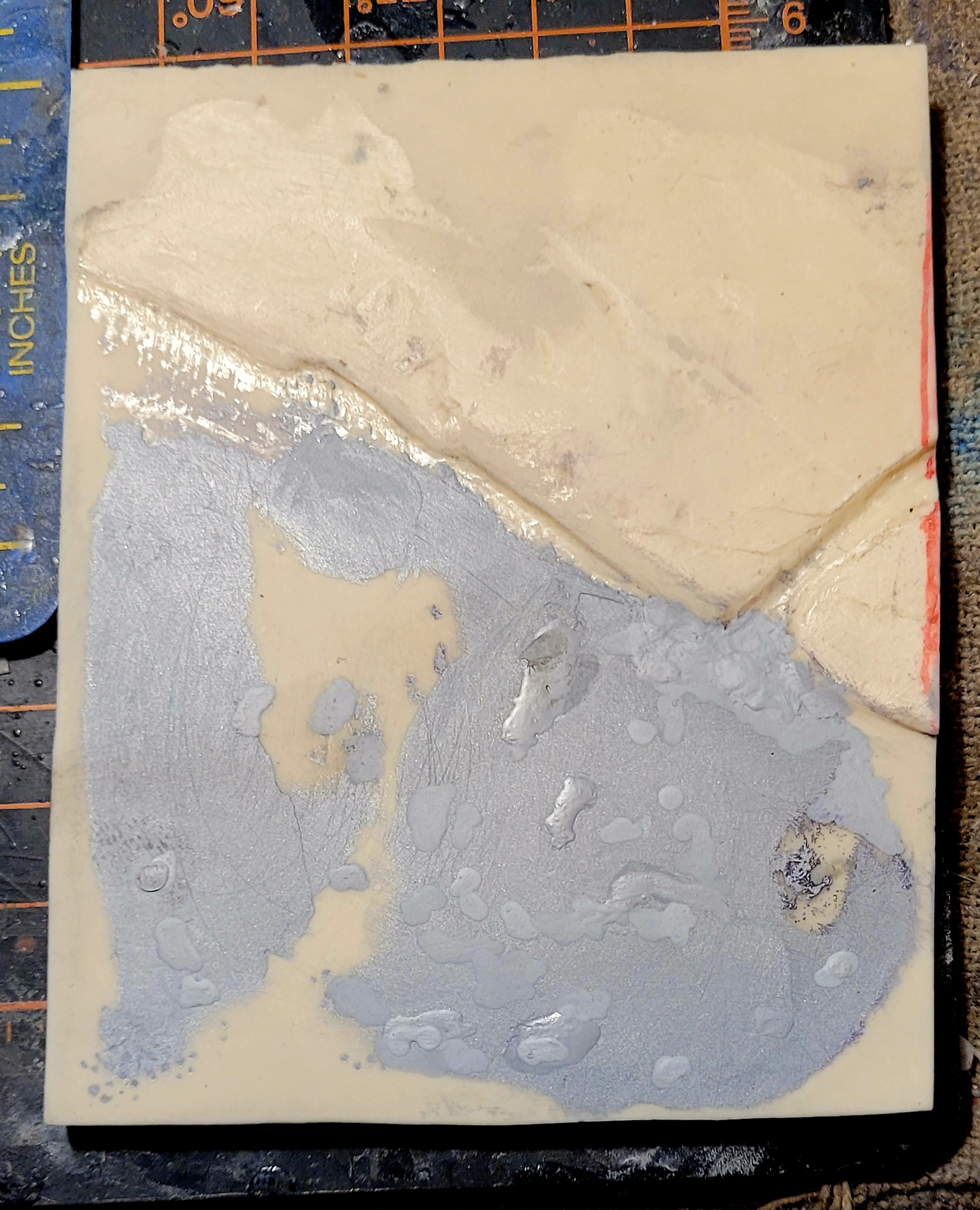

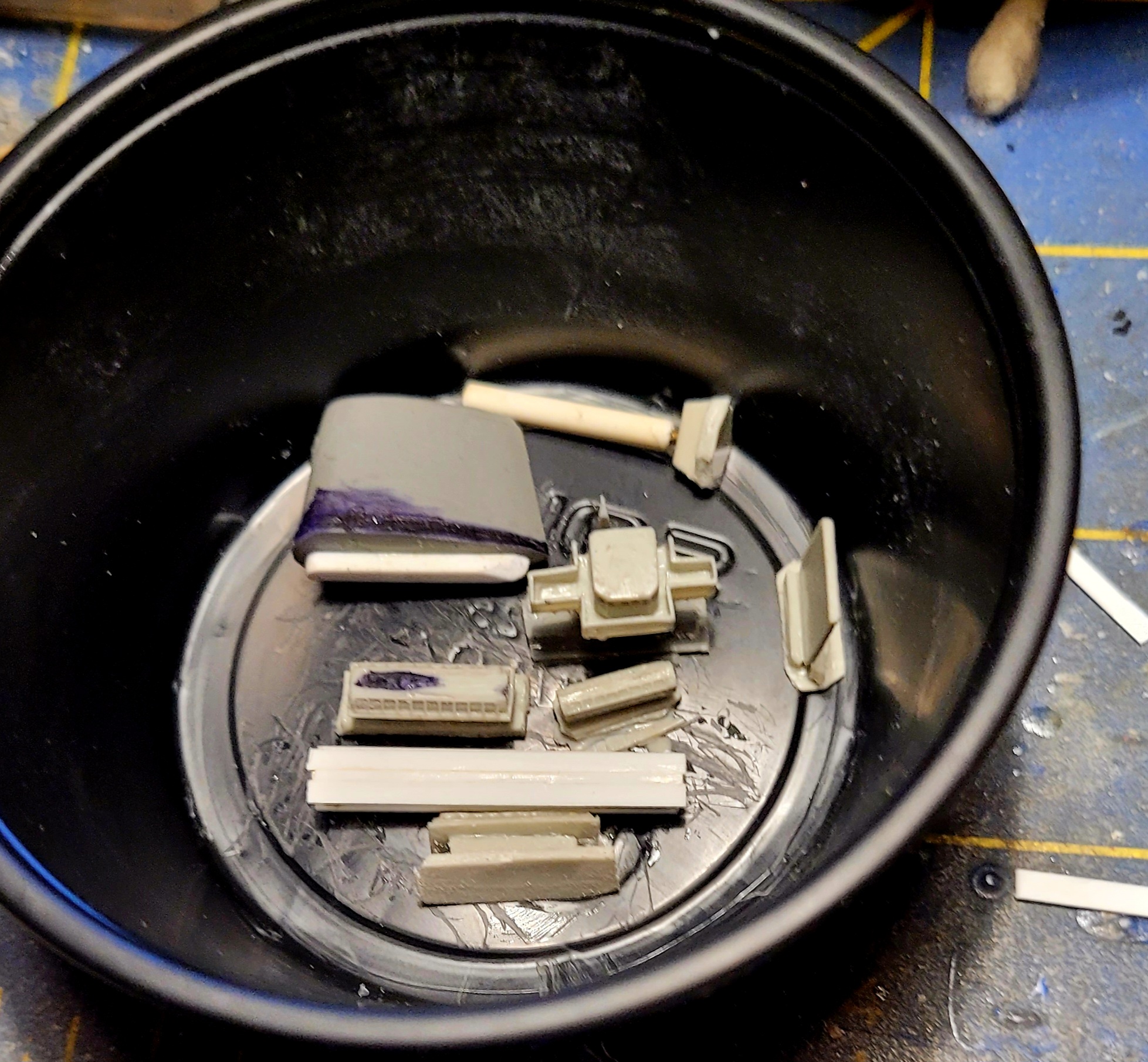

Here's what 414ml of RTV looks like in the bombastic Base mold box, less the Lego brick bleed-through. I lined the box with tape this time, to better seal the gaps. This was every morsel of Mold Max 10 I had on hand.
Only 240 ml to go! :yipee:
COME ON, UPS!!
MUHHU HAHA Hahaha! Material order arrived today! :yipee:

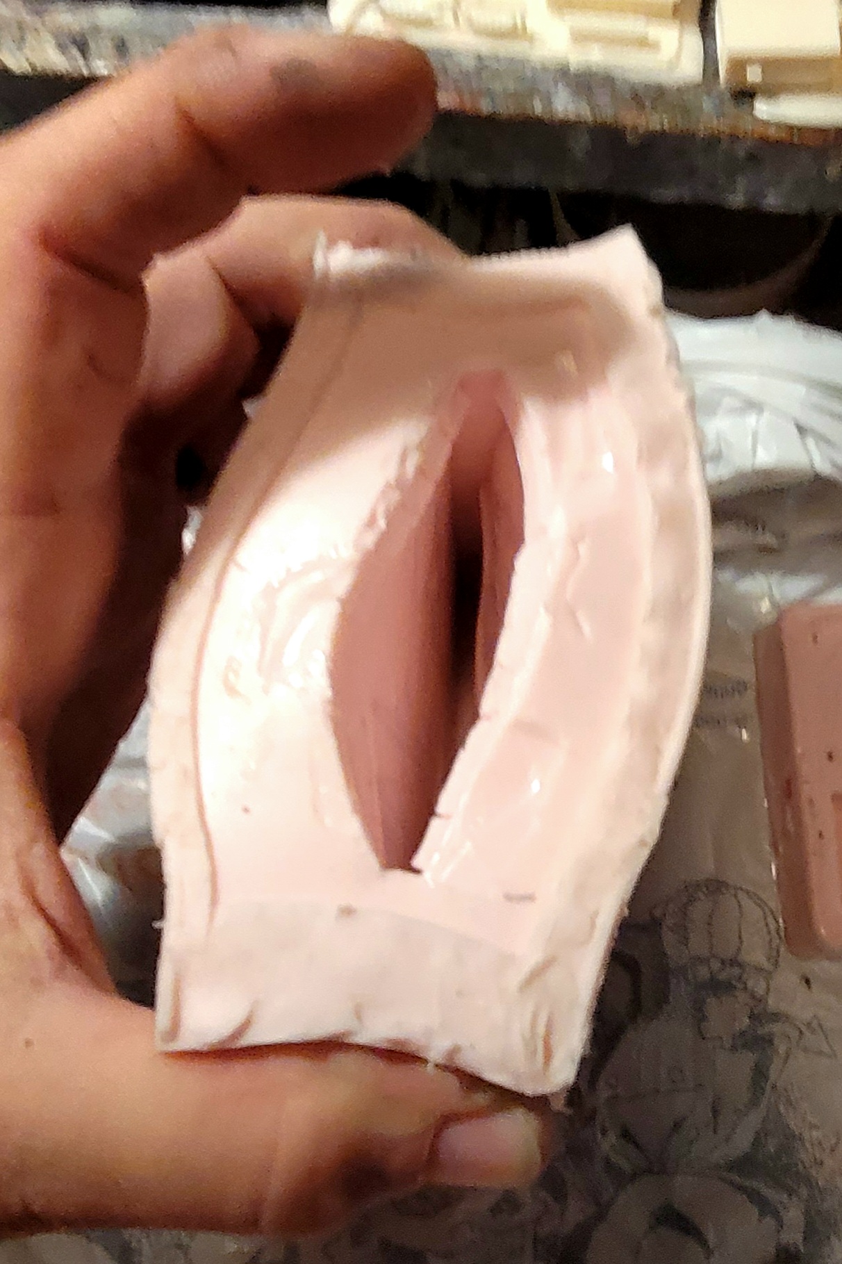

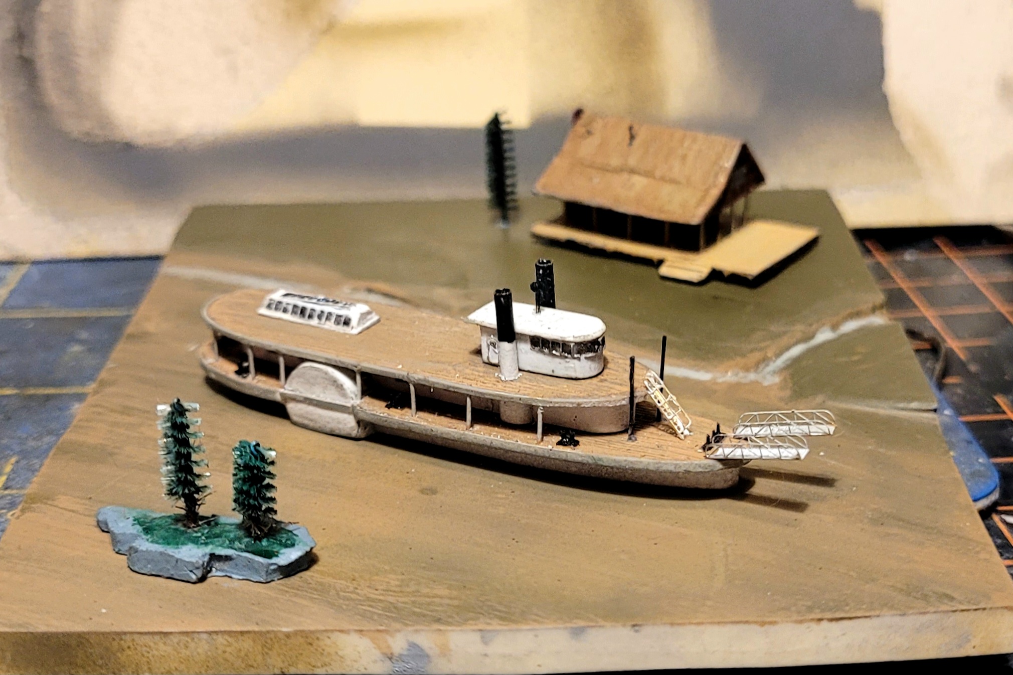

The vertical base took total of 770 grams of Mold Max 10. This is the most ridiculous mold I ever have made. There is 1030 grams of Mold Max 10 in the trial size plastic jar. If it works like it should, I will be casting bases with finished tops and bottoms (maybe a tiny seam line) in another 24 hours.
The original horizonal mold base casting has taken 4 days of filling and manicuring, so far, to get the river/water/ocean/road flat. There is NO way on God's good green Earth I would ever sell one of these to you! Nor would I cut and sand anything I in such a fashion to get it ready to sell. Too time consuming!
I was working on 2 early bases for box art purposes. They measure 3.5 X 4.25 inches.

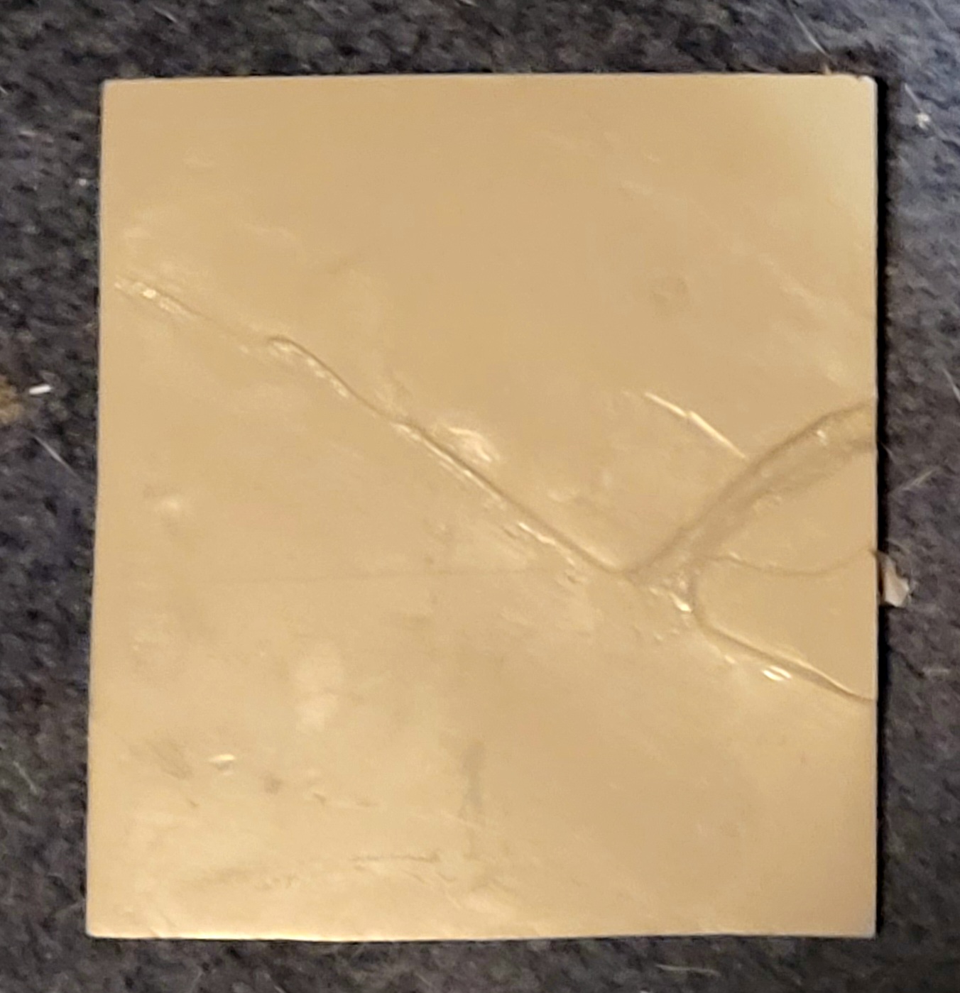

The huge, new (?!?) mold fills easily. :yipee: The production base measures 3.5 X 4 inches. The first casting looks dandy, save a divot in the river, where the RTV pulled out a bit of filler. Not a commonplace occurrence! 60ml of liquid fills the mold.

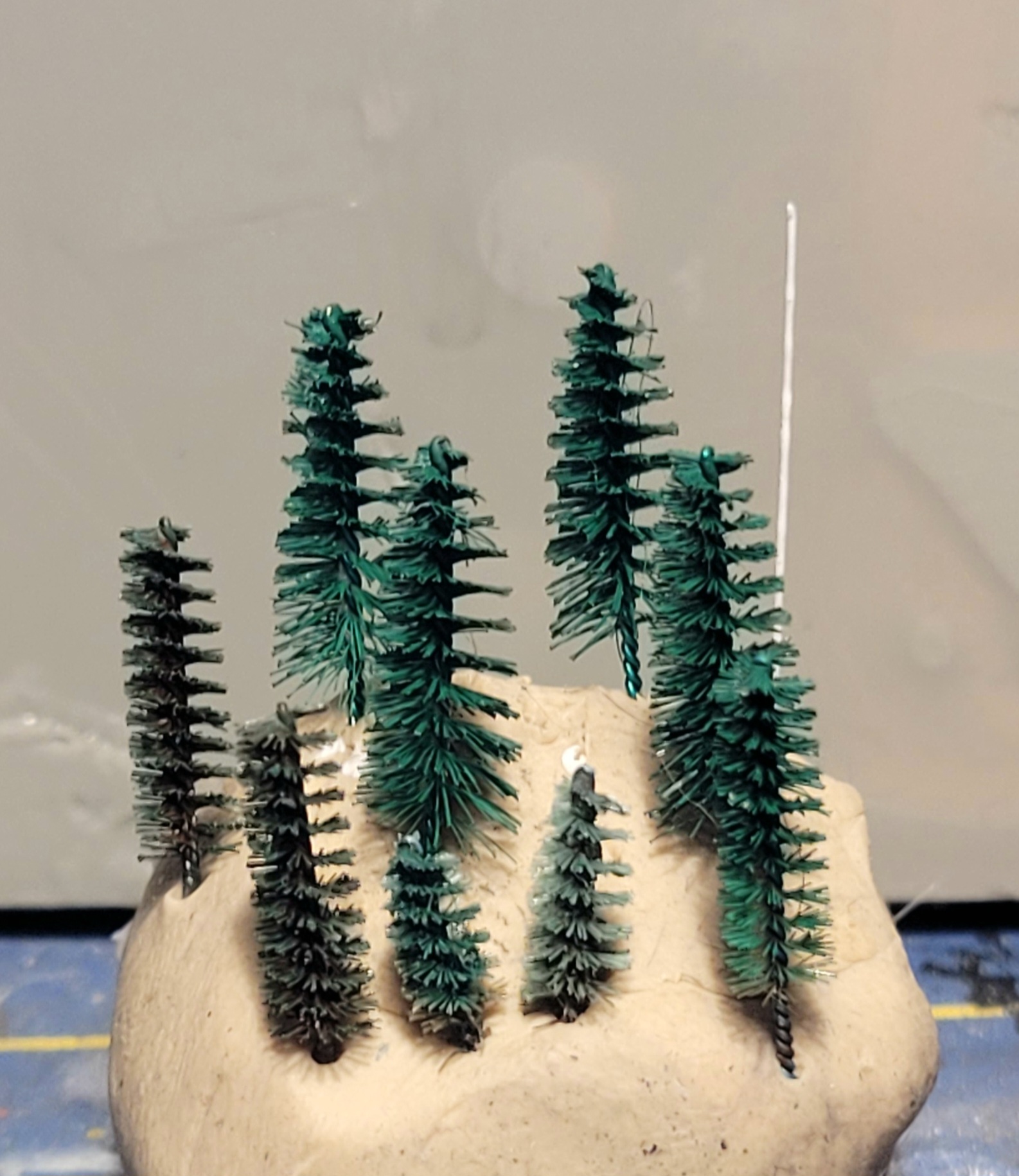

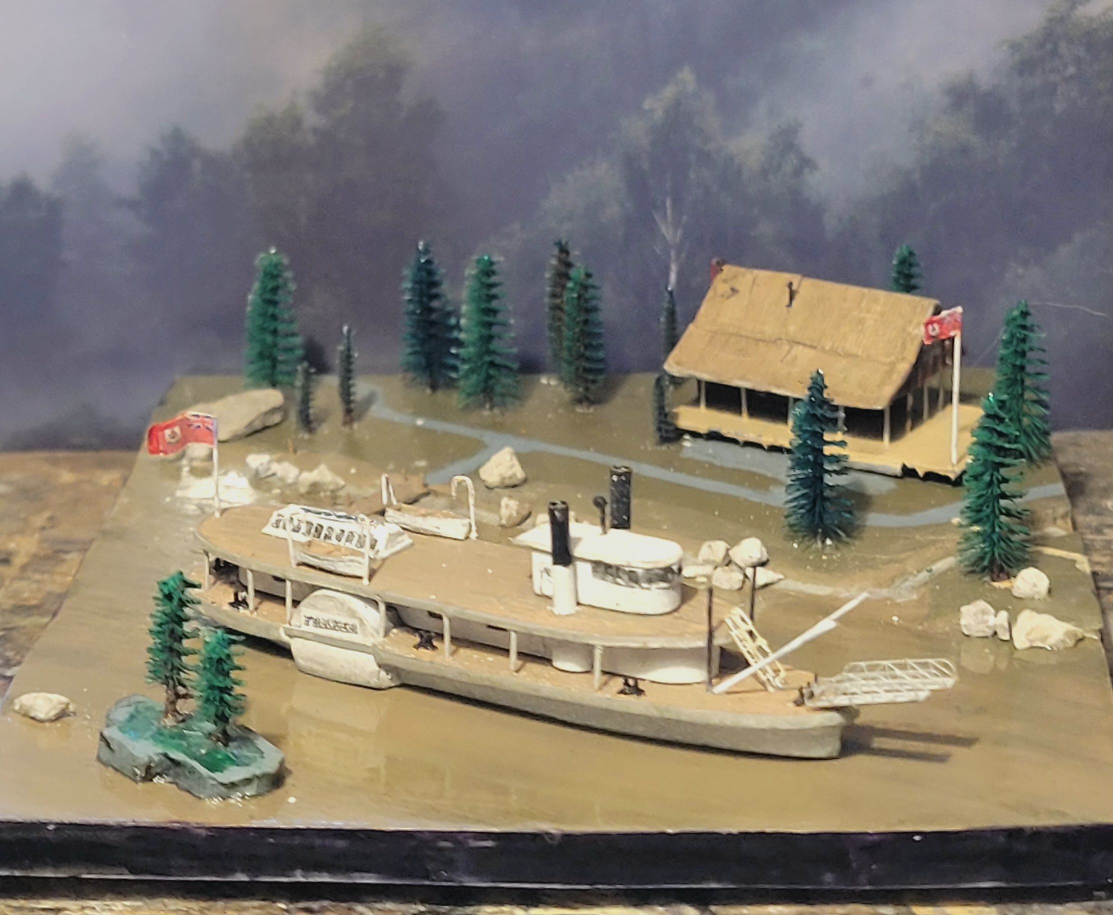

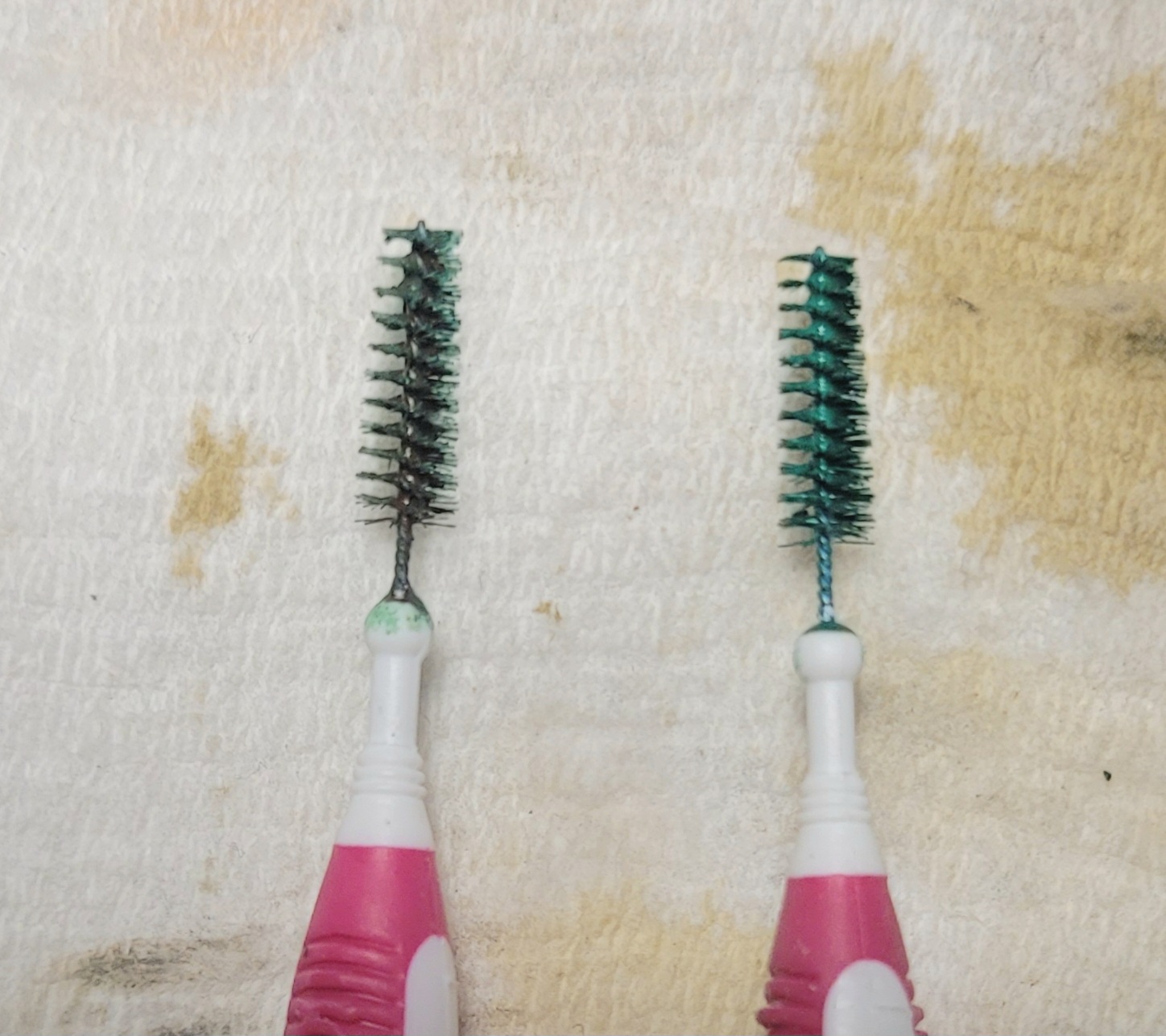

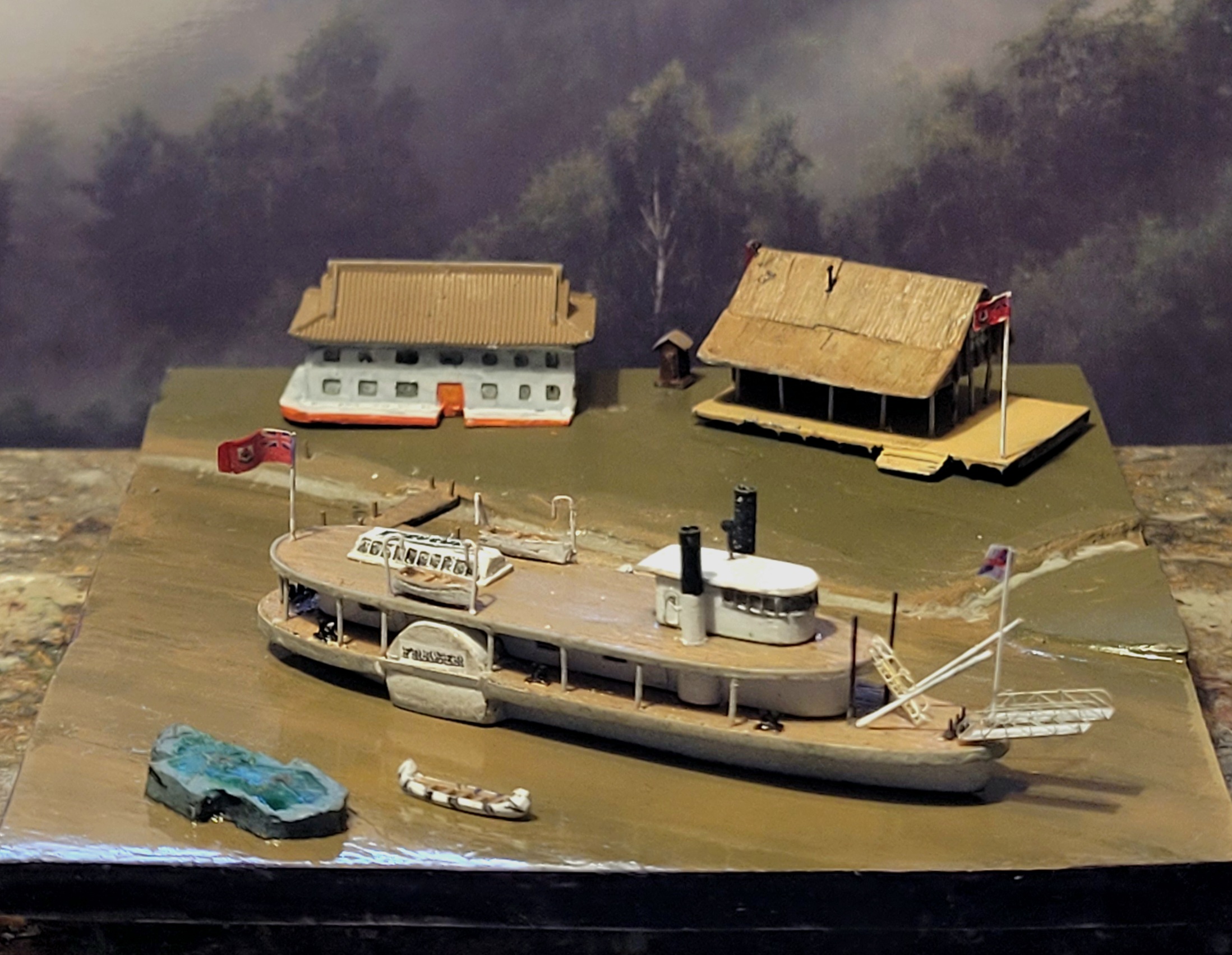

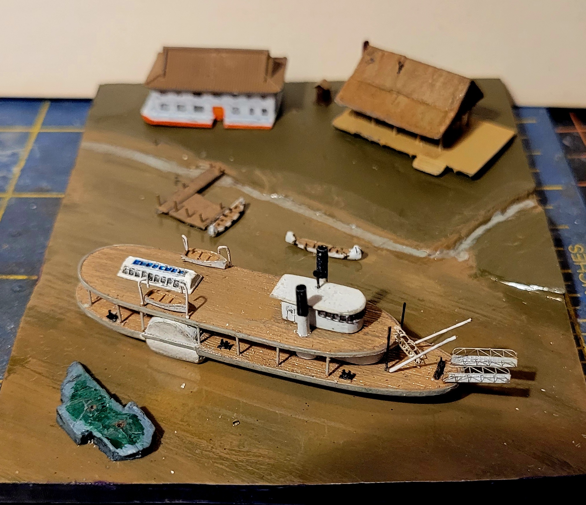

Model supplies can be found almost everywhere, if you look. My Fraser river steamboat diorama will have evergreen trees. Making these from dental brushes is a quick, easy way to do it. The can be cut and shaved to different heights without much fuss. The box-art version won't feature trees of rocks along the riverbank.

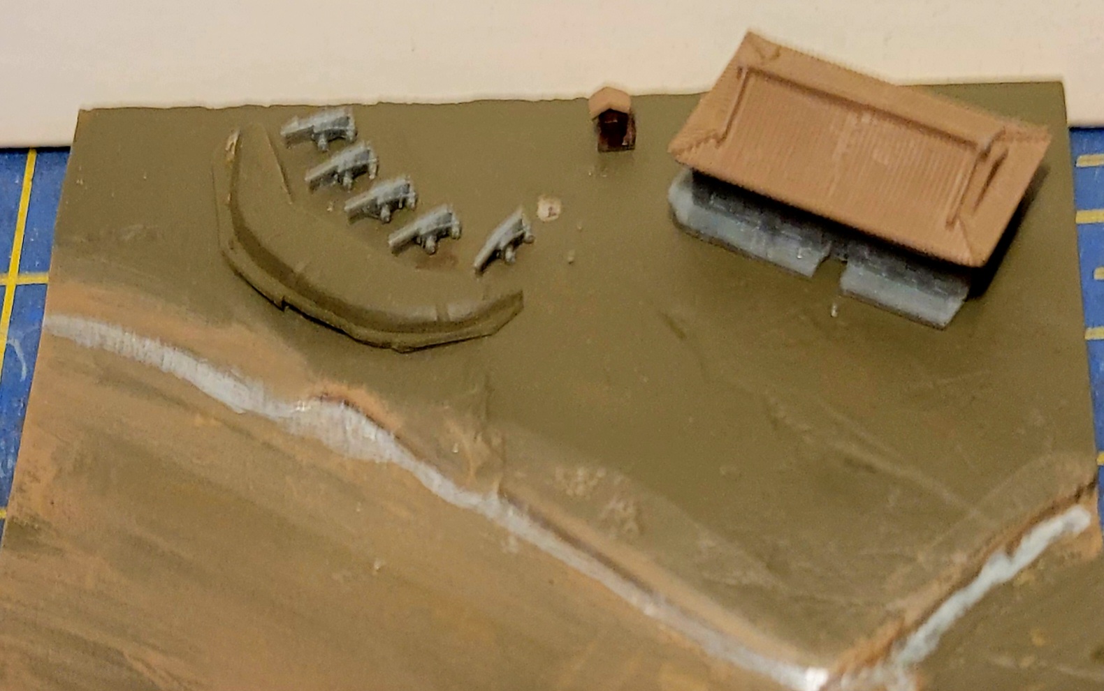

Maybe you prefer a battery of cannon, guarding the Fraser? The barracks/boarding house, outhouse/latrine and earthen berm can be sited on your base wherever you decide.
Here's the catch, in my got-carried-away-ness, I made too many accessories for the set to fit them all on the riverbank together.
You must choose. But, choose wisely.
A ring of P/E railing would do it! This kit doesn't include any railings.
The base mold is churning out bases. It casts the way I hope it would.

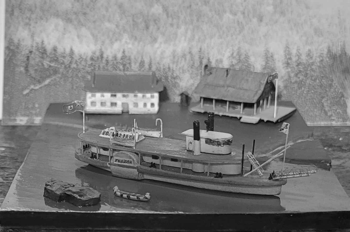

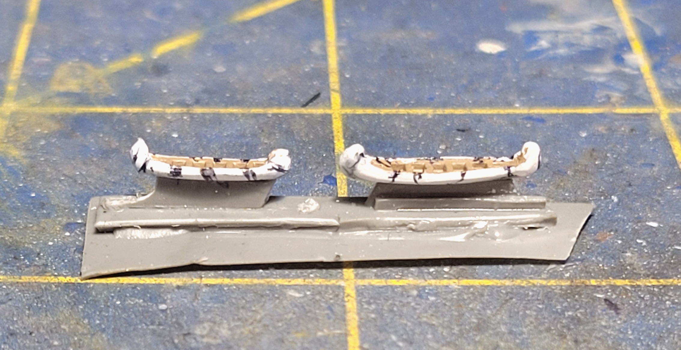

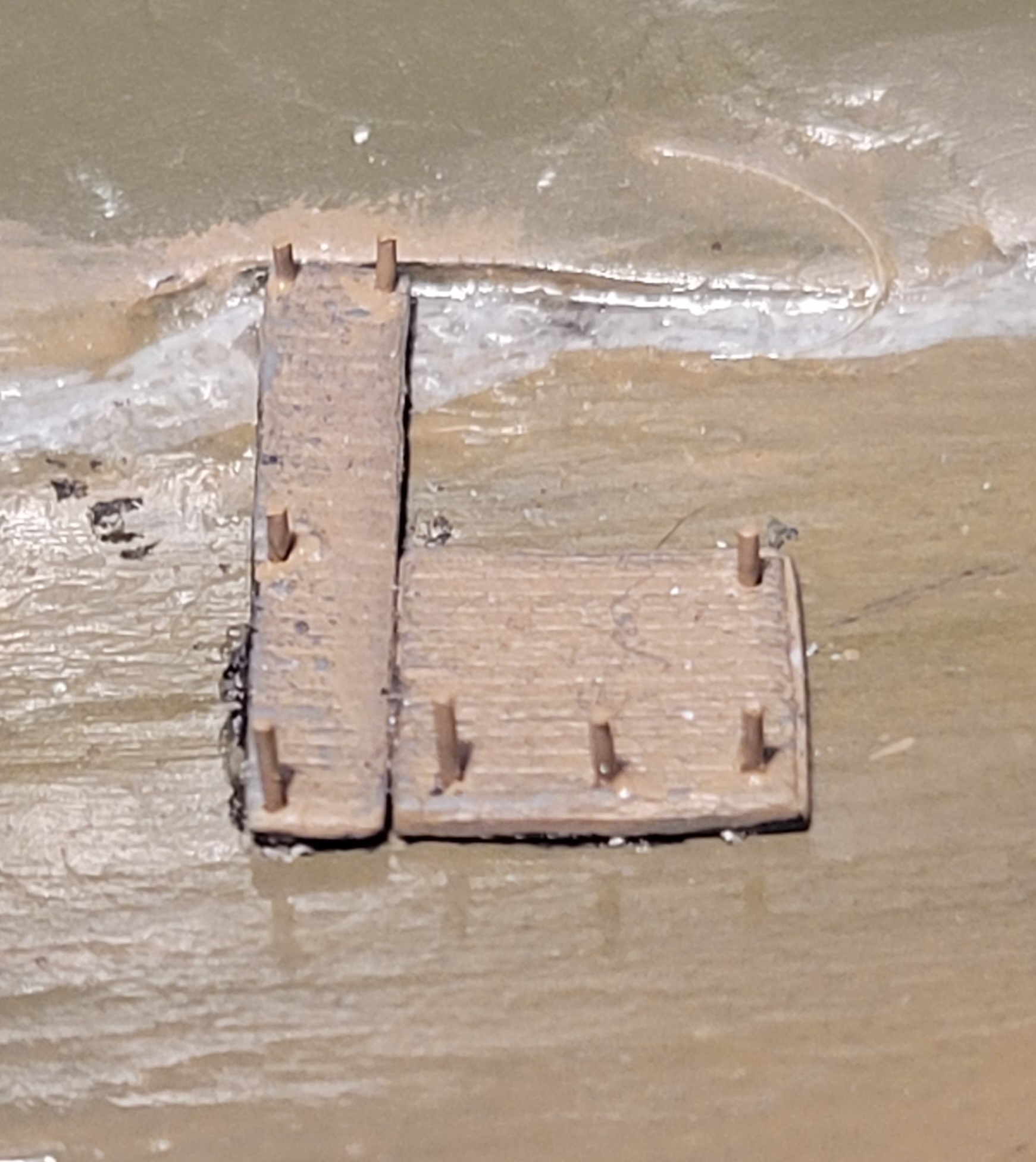

Painted birchbark canoes, Evergreen forest and finished dock. The trees are for my own build.
I left out the gun battery on purpose. I think this looks too much like civilization. Too busy! The boarding house is owned by a man named Howard. He emigrated from Sweden. If memory serves, his last name was Johnson. :bigrin:

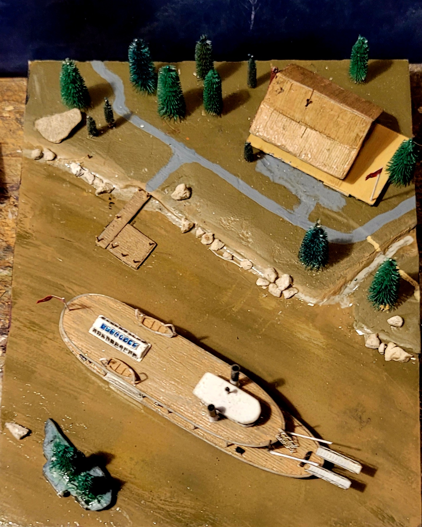

I painted the whole base OD green, and streaked the river with different tan/green tones. Using Tamiya X-22 a big brush and long strokes made the current. It took 3 applications. little dabs of X-22 clear on the surfaces facing the current, and letting it cure on a 45 degree angle, gives the upstream effect.
With box art finished and kit boxes on order, the "Work" is almost done.
Now the fun begins!

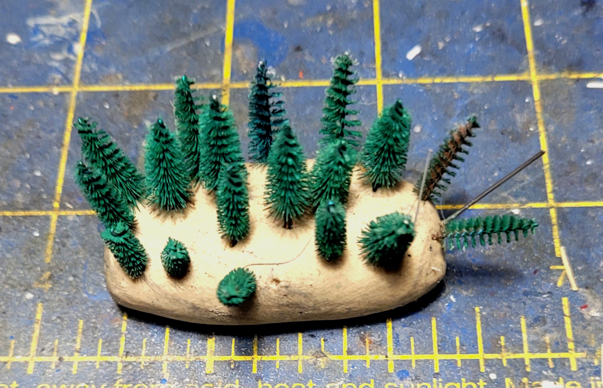

This is enough rocks. They are actually rocks. 15 trees still look less than Canadian forest-like. I found a way to chuck the dental brushes in a drill and shave them with a razor into a conical shape. Painting them is a snap, but they all have to be flatted. Evergreen trees are not shiny.

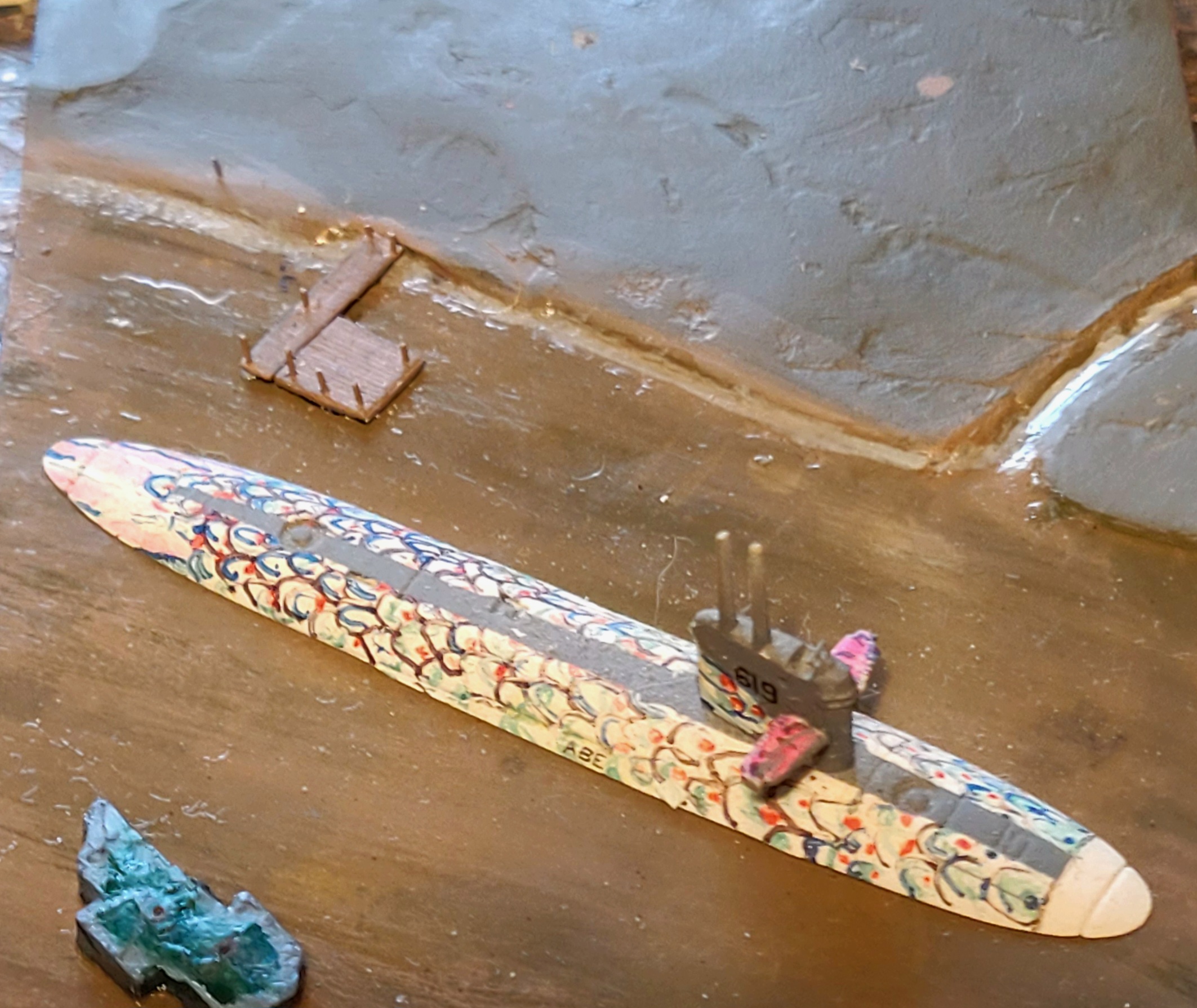

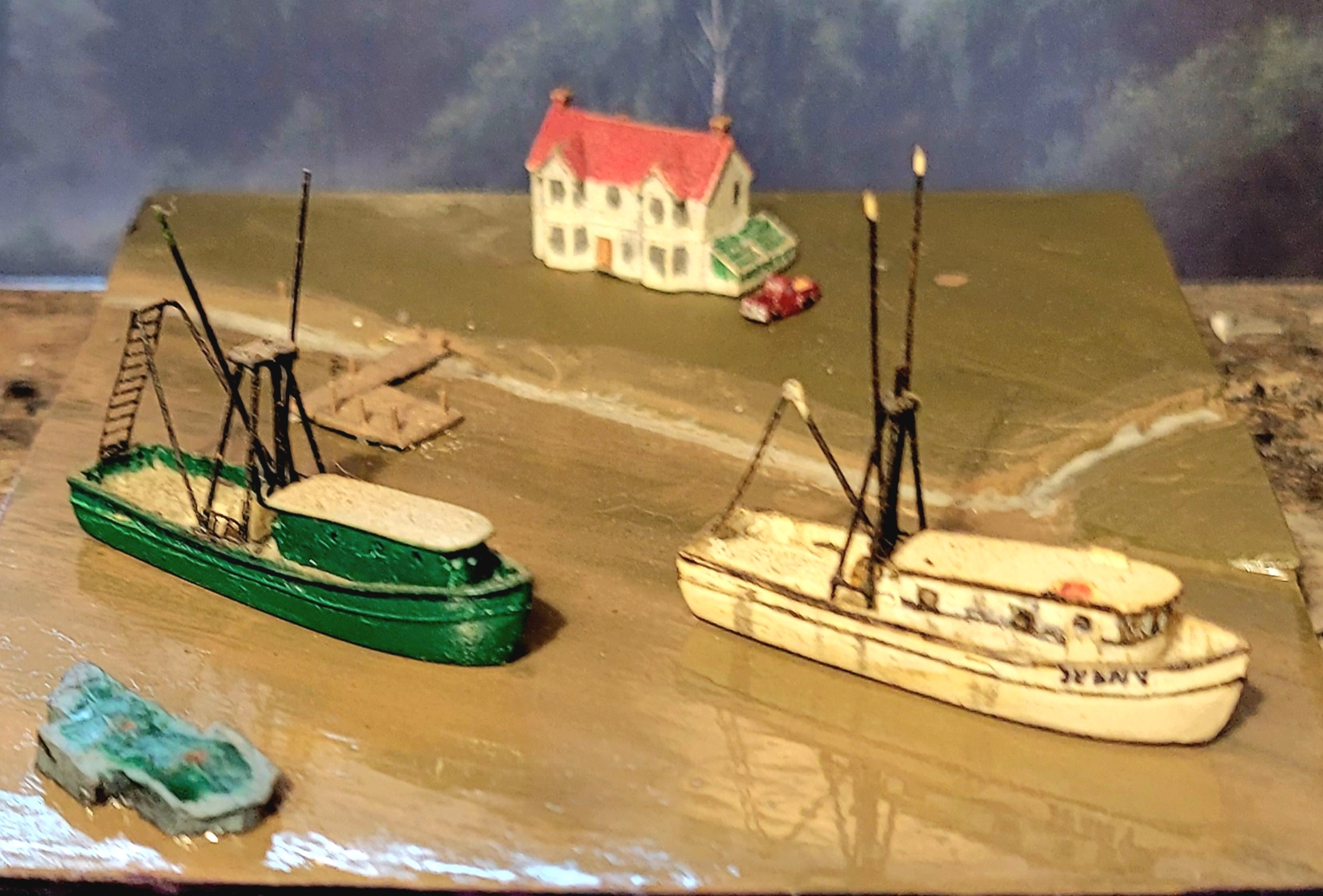

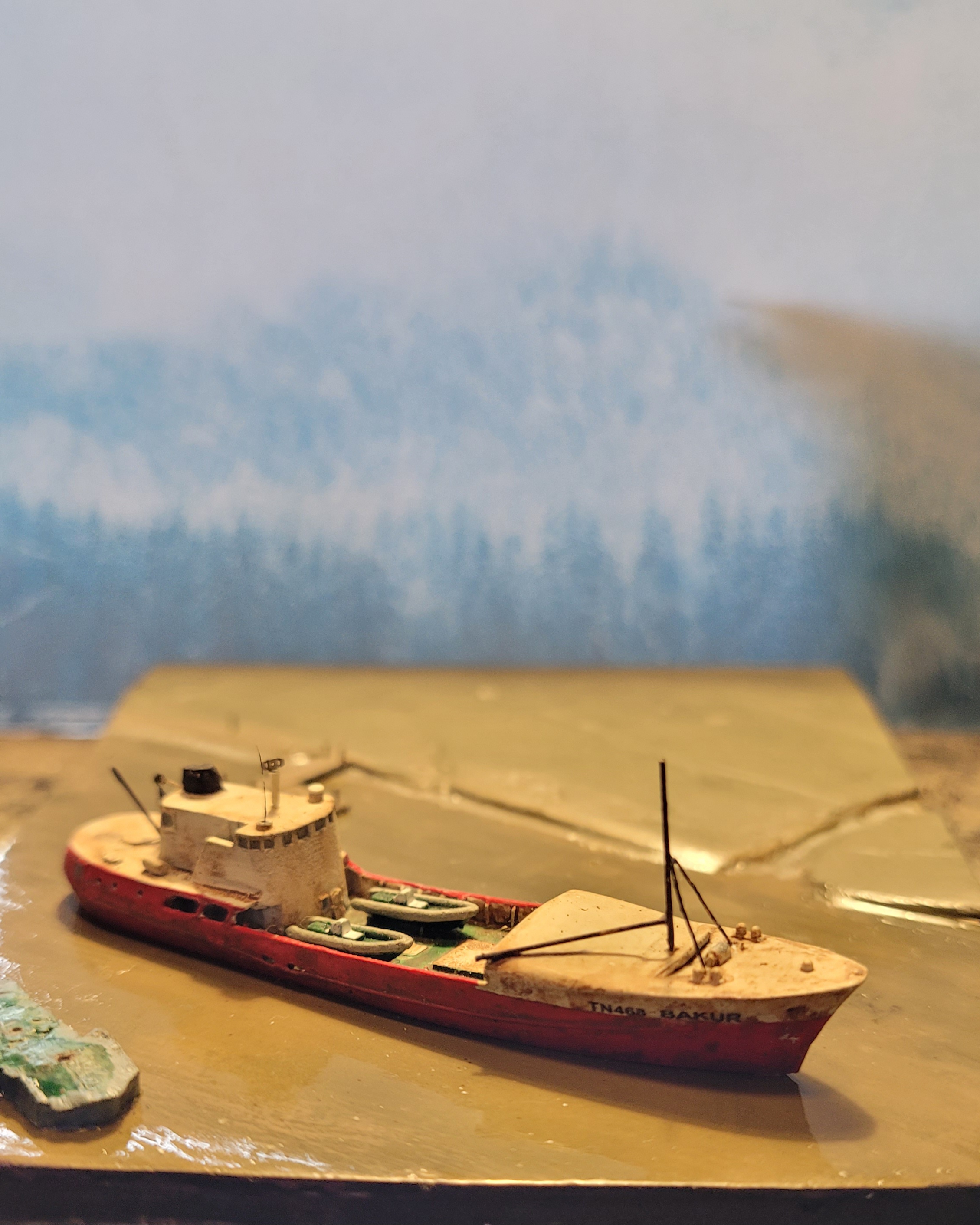

Other uses for the new river base:

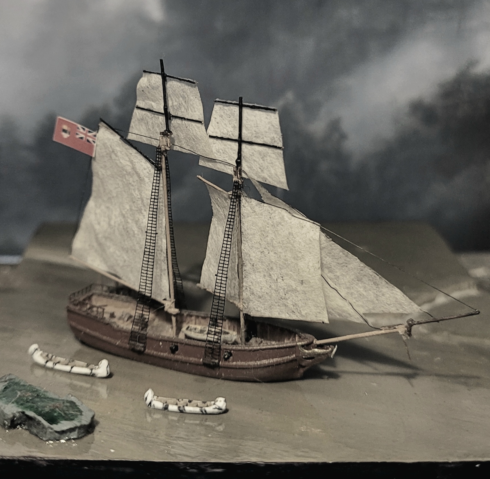

The Nancy schooner on the Nottawasaga river.
Georgia shrimp boats on the Darien river.
FV Bakur departs Halifax, NS.
Jamaican Self-Defense Force Submarine Abe sails from Montego Bay, Yah Mon!

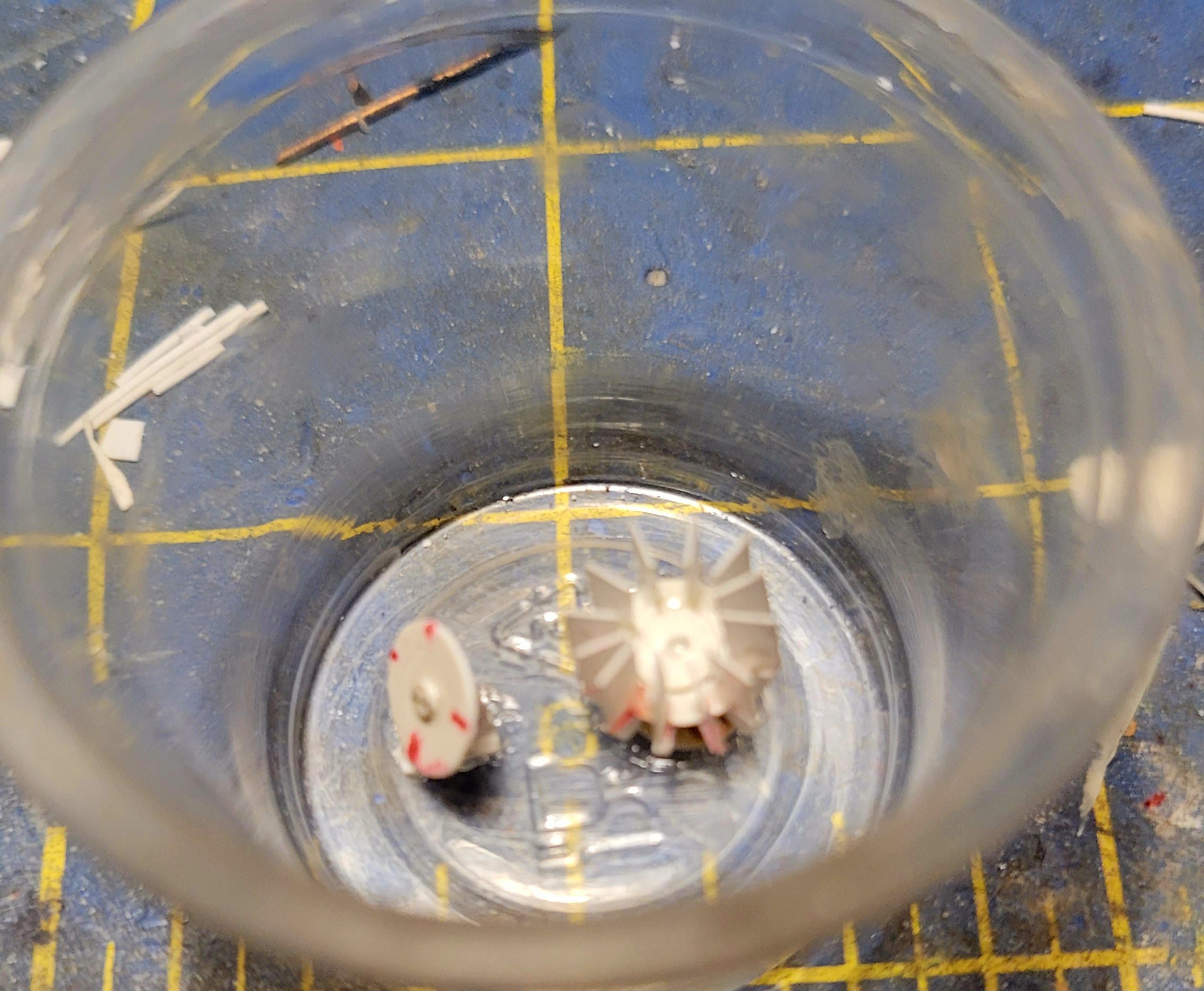

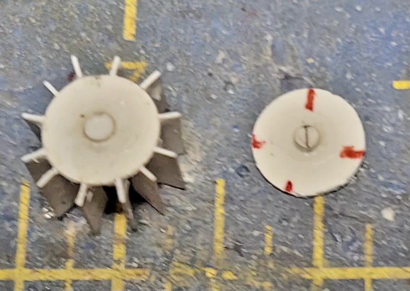

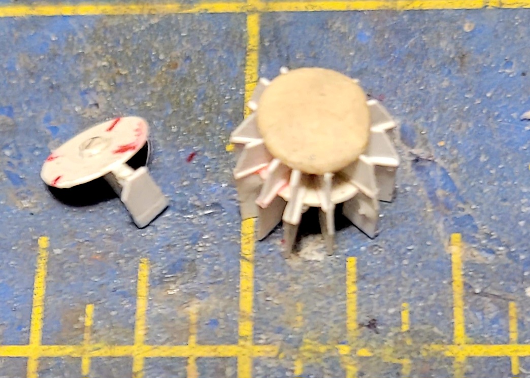

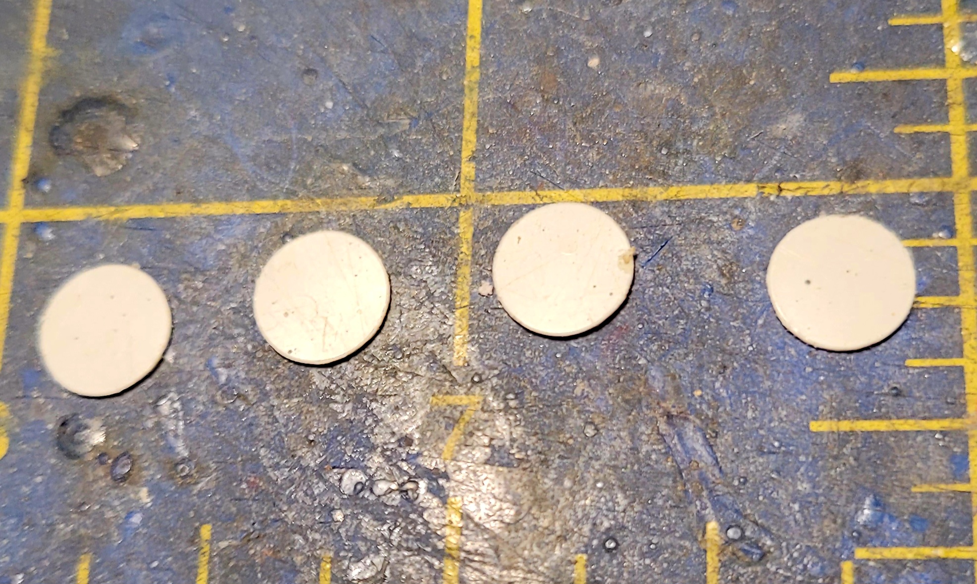

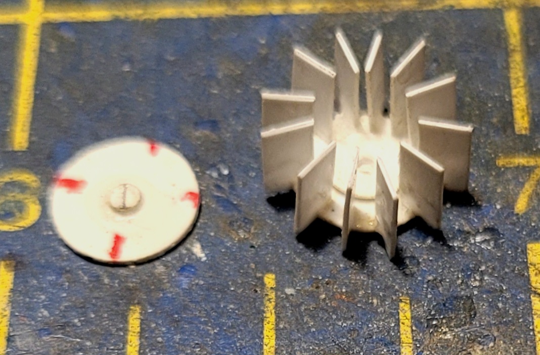

The weak link in a sternwheeler model is the paddlewheel.
My idea is to mold and cast the 1/700 paddlewheel in sections, with a separate hub for the modeler to assemble.
THIS IS AN EXPERIMENT.
The intention is to do so without making the axle of the wheel solid, oversized and obviously crude. (ME?!)
Without a plausible, scale, paddlewheel, TLAR's 1/700 SS Whitehorse Gold Rush riverboat kit crashes to a halt.
