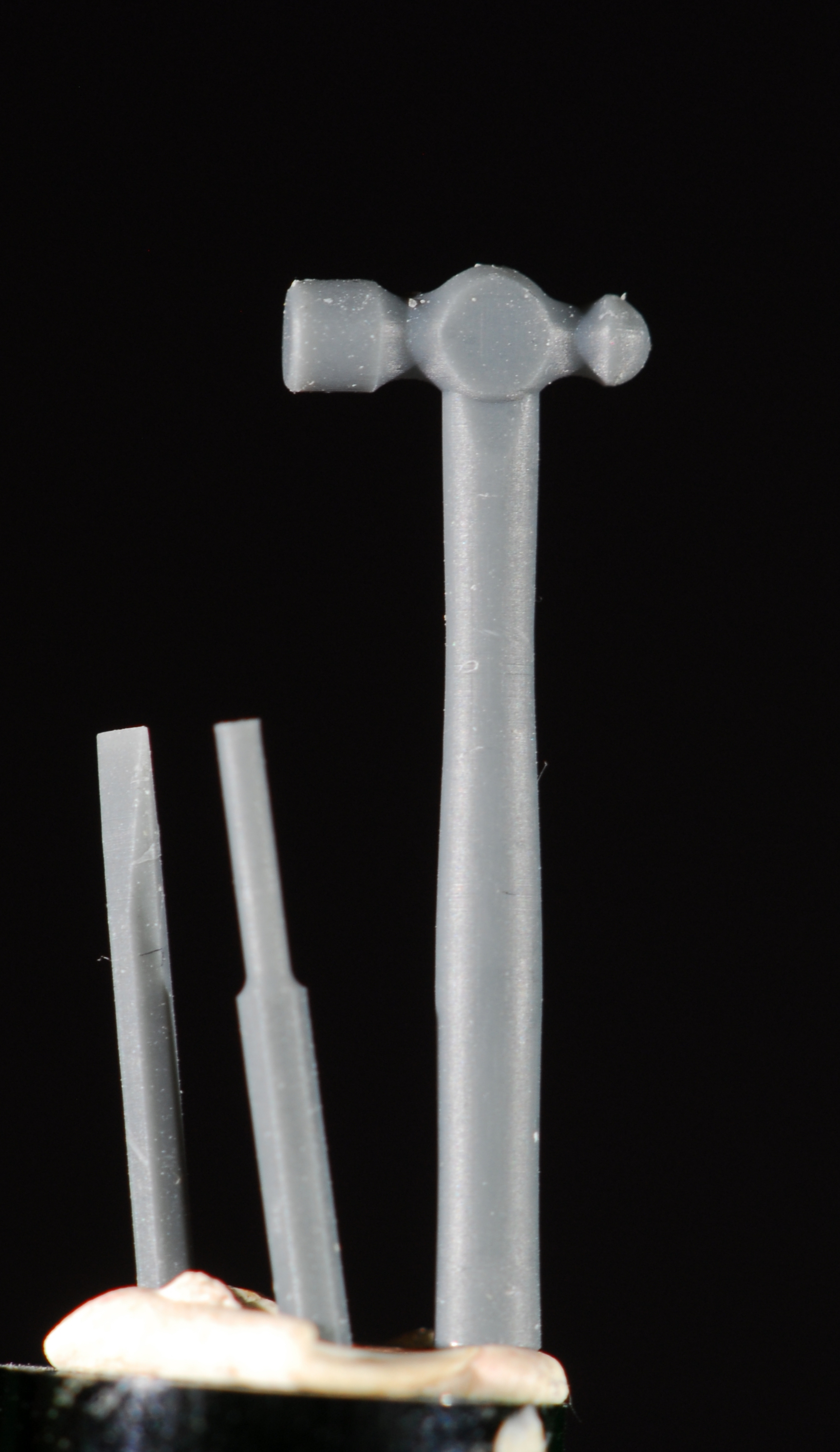

Here are some of my 1/16 scale tools I printed out and offer on Cults3D. I used a new technique to create the handle for the hammer. I created a series of ellipses and "skinned" them with a surface, then converted the surface to a solid.
