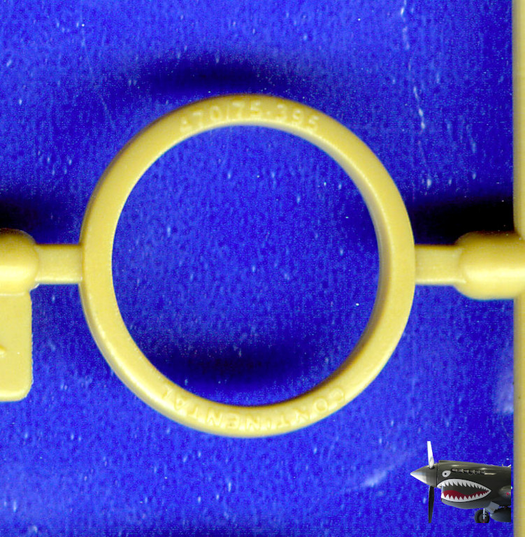

This set retailed for under sixteen US dollars and is a good value considering all the detail found therein. The Continental logo as well as size markings , for the narrower Ausf D, are there as well as several variations although only one complete suspension can be built from the set.

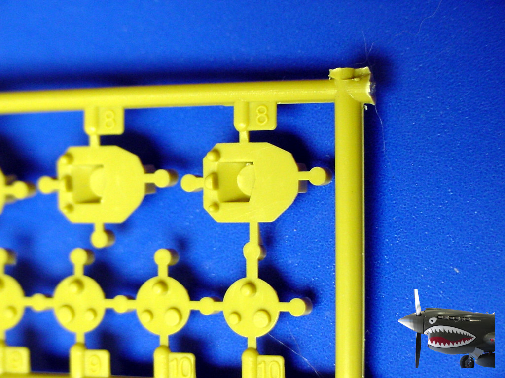

The plastic is slightly brittle so care must be taken when cutting items from the sprue. I suggest using a shear, such as the ones sold by Xuron, and cutting on the sprue but not against the part. Since there is some flash, it is a good idea to use a fine emery board to remove any sprue nubs.
The slightly waxy sheen did not come off even after a wash with grease cutting dish detergent. However, the plastic responded well to Testors liquid cement. Methyl Ethyl Chloride caused some stringiness to appear but the bond was instantaneous.

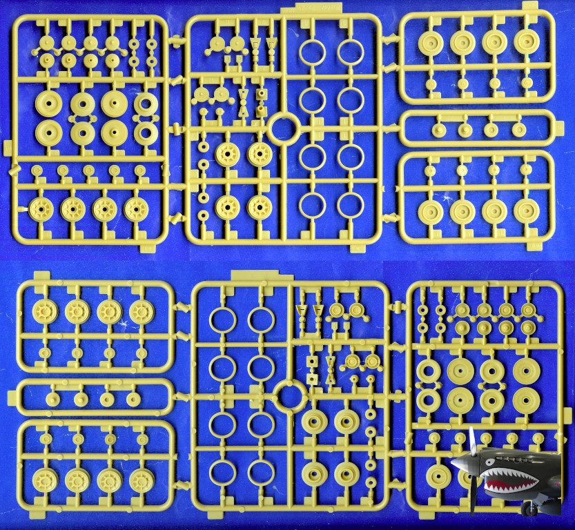

Photos show Sprue W, five of which are in the set, which has the following gated sprues (left to right), across the top:
  • Outer roadwheels and hubs (hubs visible here) for Ausf A-E
  • Support rollers
  • Outer roadwheels and hubs (hubs visible here) for the Ausf F-H (early)
The center gated sprue contains both early and late roadwheel dampers, tires, inner roadwheels for all variants, spacers for the roadwheels, return roller mounts, and two late model outer return rollers.
The last gate has the outer roadwheels and hubs for Ausf H (late) to J, another two late return rollers (both inner and outer), and all steel roadwheels (both inner and outer).

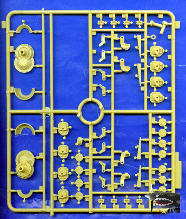

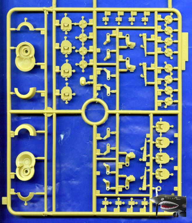

Sprue S, two per set, are included. Here we get two sets of early differential covers with armor, minus the bolts, on a separate gate. The main gate has two sets of bogie mounts (Ausf A-J and late J), two sets of drive sprocket axles, bogie arms, three types of bogie mount covers, leaf springs, and two types of leaf spring caps (Ausf A-F and G-J), idler wheel axles.

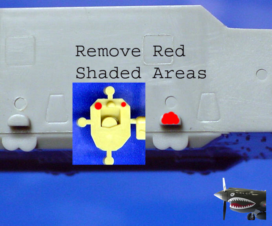

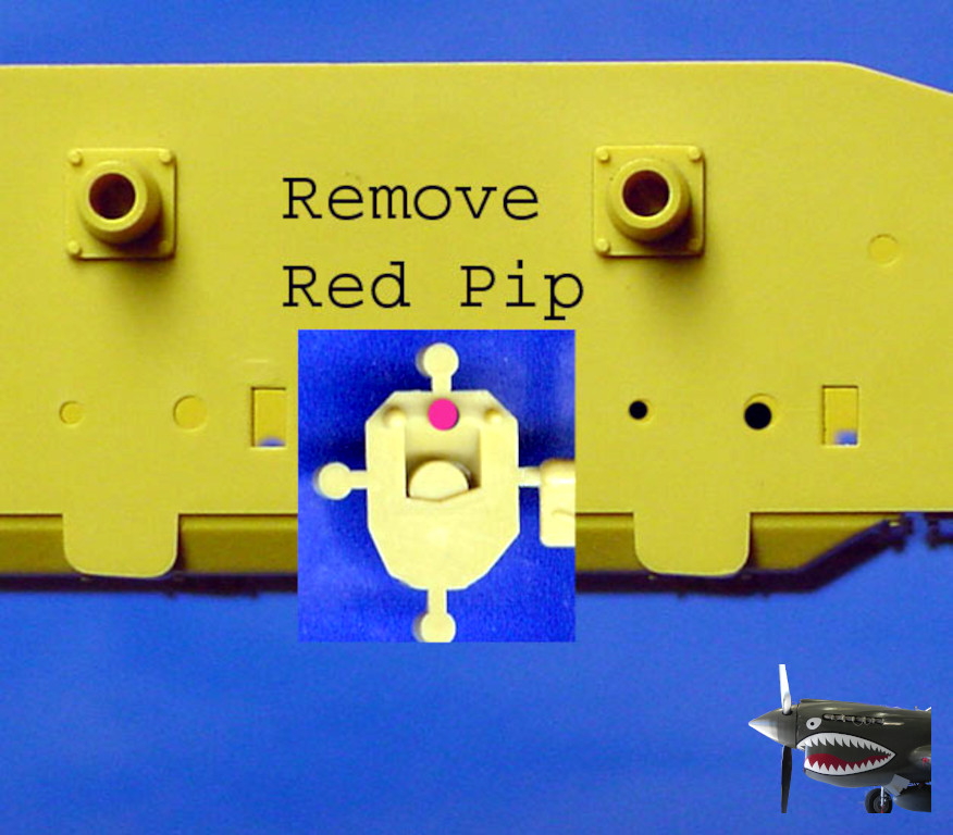

First, note that Tristar’s instructions are wrong. They would have you remove the wrong nubs for each manufacturer. For the Dragon based hulls, remove the two round nubs. The hull themselves need to have any tabs removed. The half moon nub on the Tristar part is actually half of the rod that is to fit in the hole on the Dragon hull.
Dragon Jagdpanzer hull from their Imperial Line series...
Shanghai Dragon Pz.Kpfw. IV Ausf. J kit (Gunze Sangyo molds):

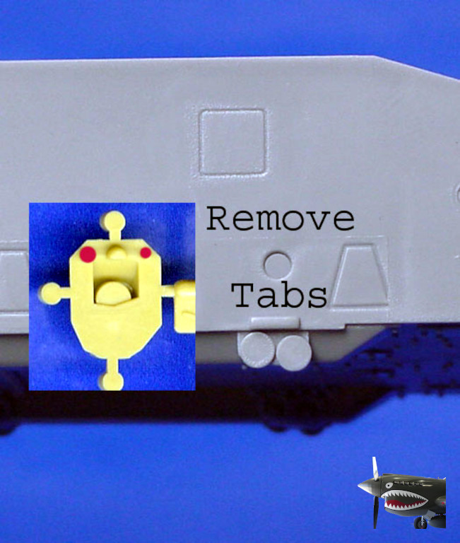

For the Tamiya kits, one needs to remove the half moon shaped nub in the center of the Tristar bogie mounts. This will leave one with two rods of unequal size to fit the unequal holes on Tamiya’s hull. This is when you will notice that the holes are reversed from what is needed. The Tristar right side bogie mounts fit perfectly on the LEFT side of Tamiya’s hull and vice versa!
My suggestion then is to remove the larger rod and mount them on the correct side and take the time to align the parts properly.
