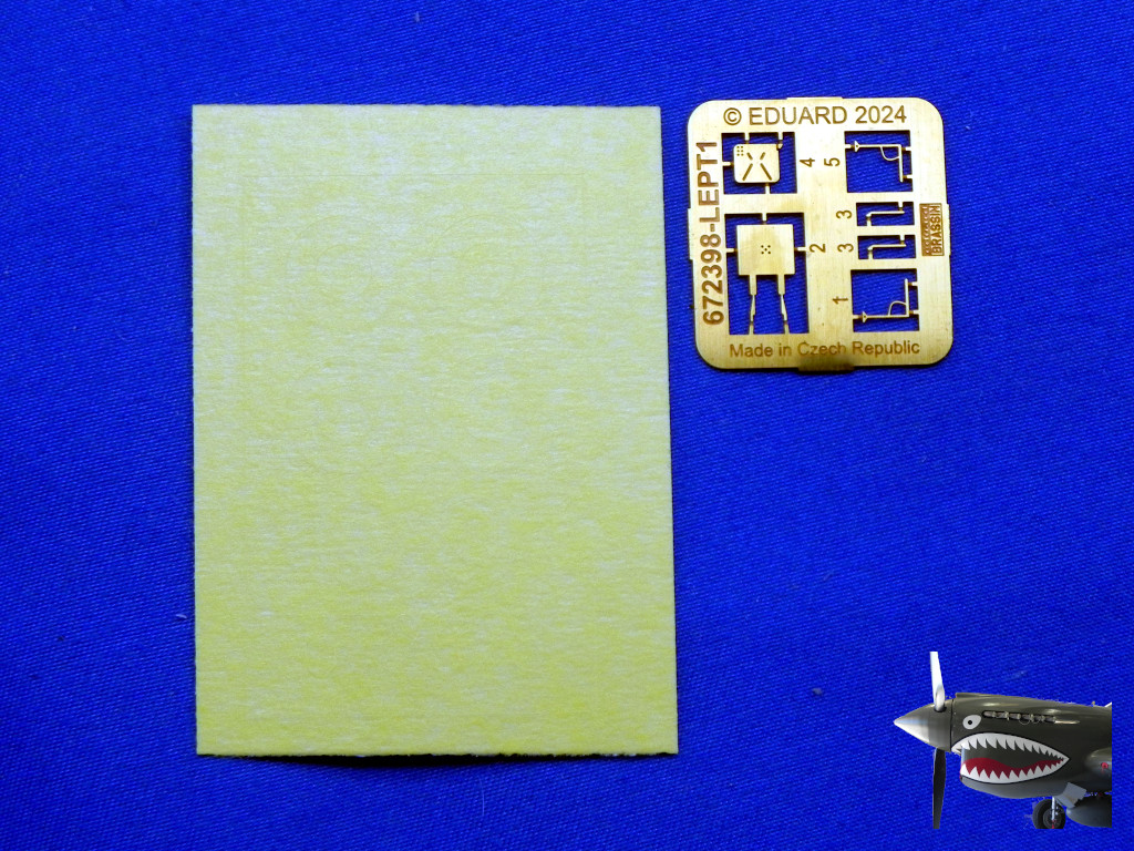

PE & Masks too? Count me in!

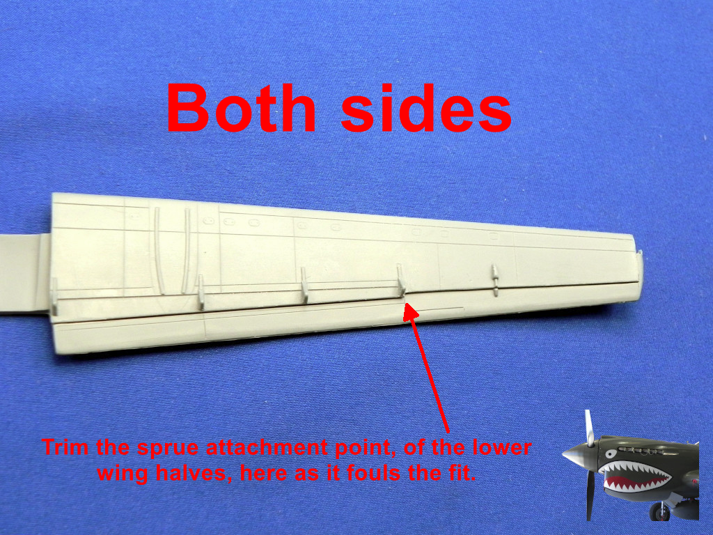

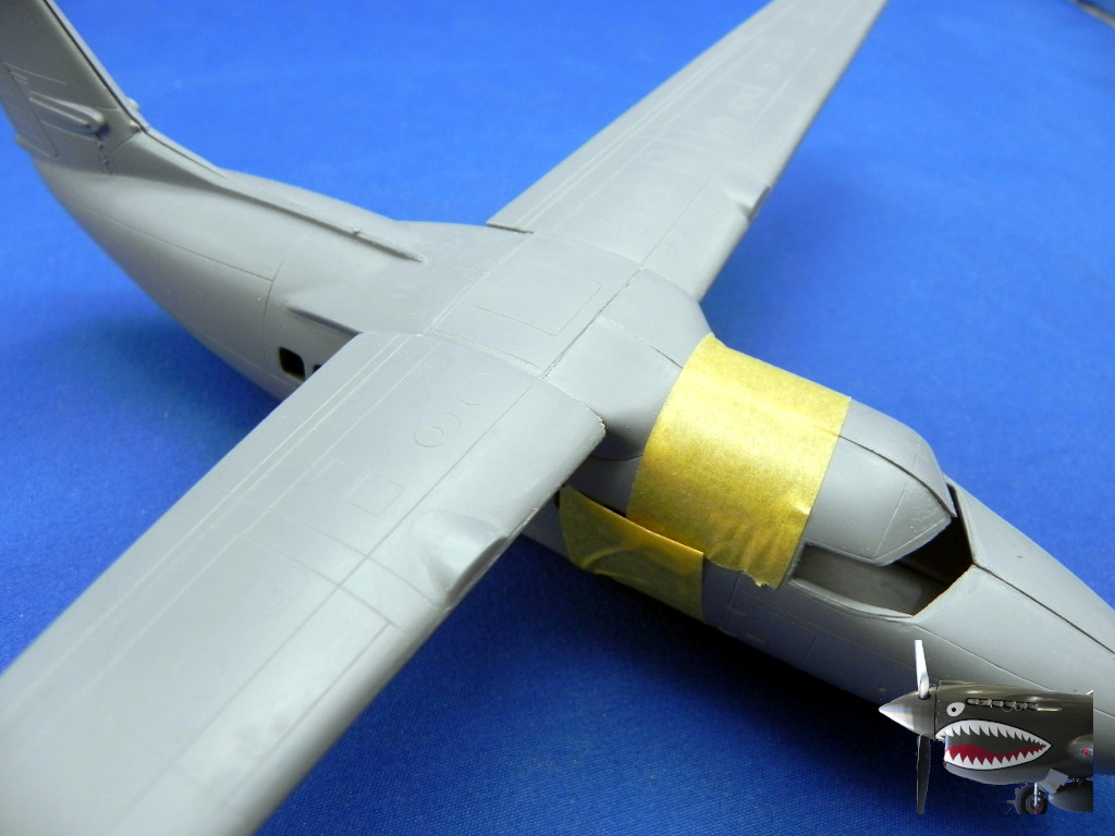

Before adding the engine nacelles, I jumped to step 21 to see the fit of the upper wing (modified from the Gavia kit to be one piece to which the lower halves are added). Note that the wingtips have a cutout for the navigation lights which was missing on the Gavia kit (and the Eduard re-release) as well as the AZ Models release. This means that my earlier statement of KP Models incorporating the AZ Models clear parts sprue is incorrect as it too has been modified.
There is a lot of flash and, once the seam areas are squared away, the fit of the wing is actually very good to the fuselage. Obviously, the fuselage is only taped in one area here:

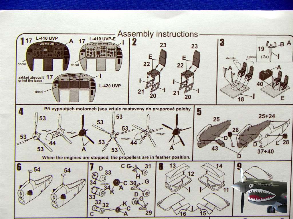

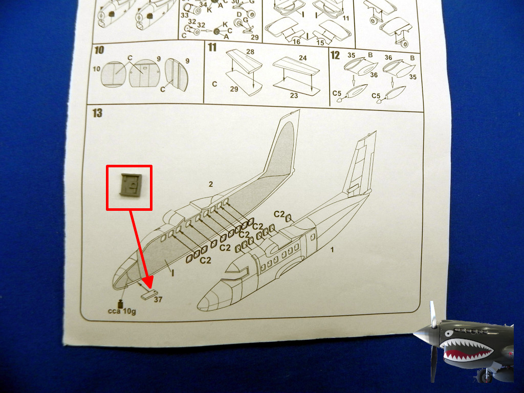

Just compare the actual nose wheel bay, in red square, to the drawing on the instructions!

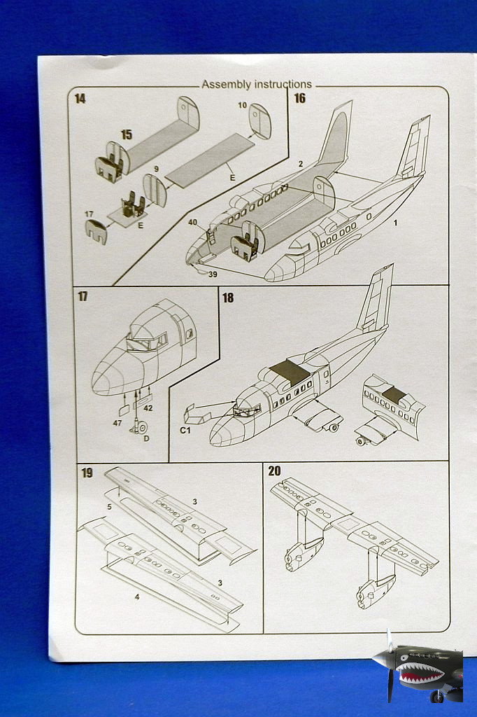

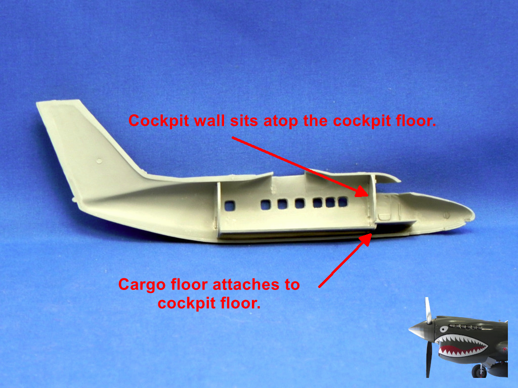

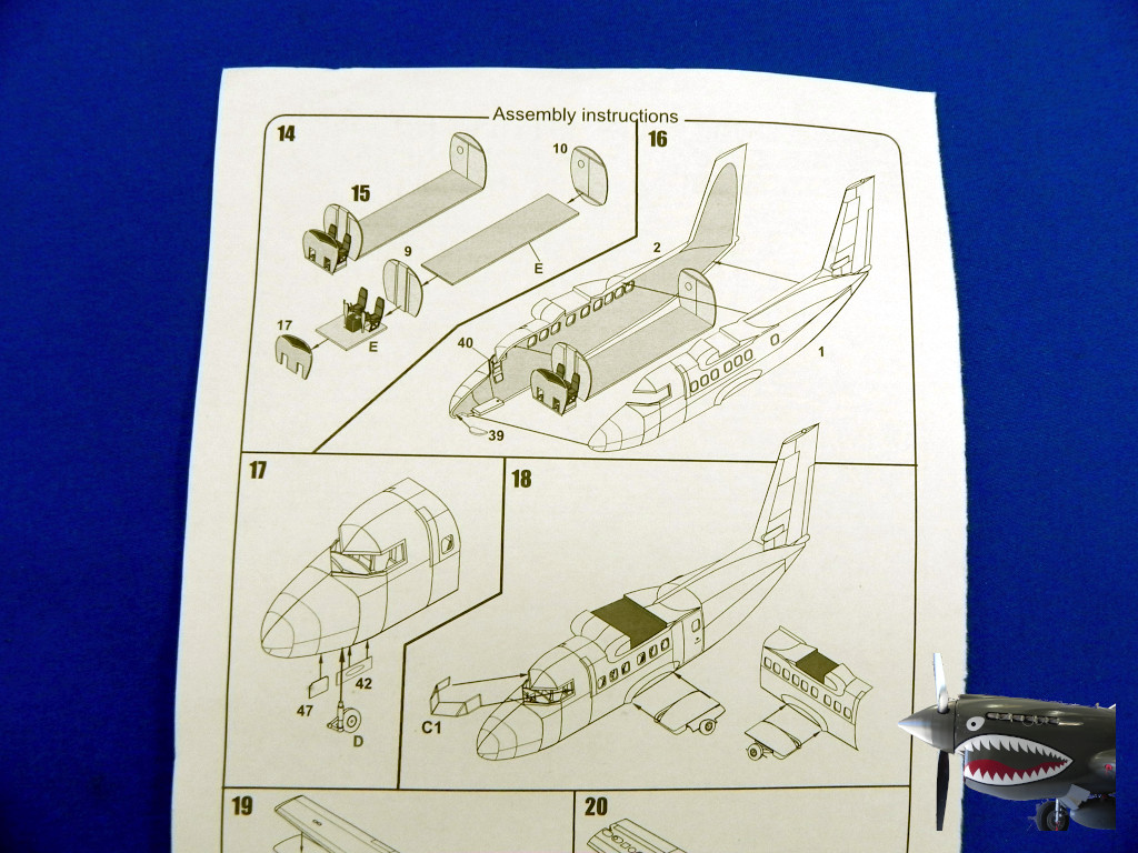

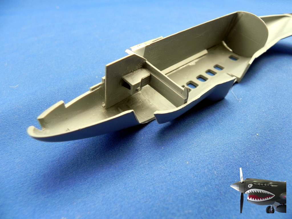

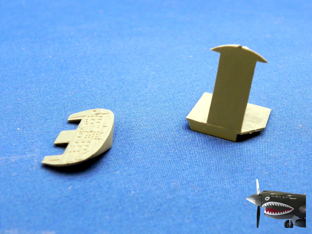

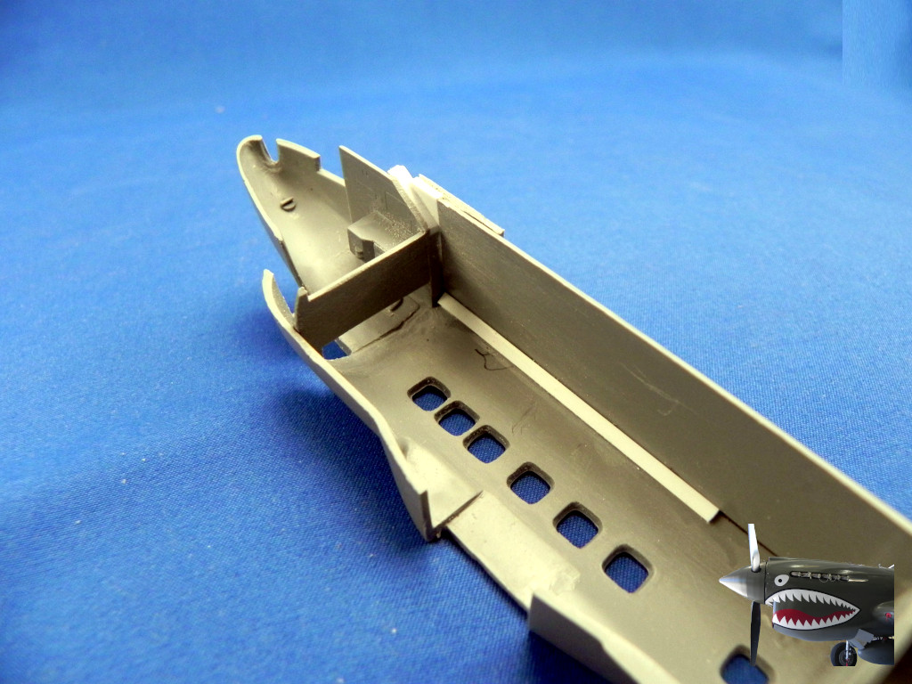

The cockpit interior is confusing! In Step 14, we are to attach the rear cargo bay bulkhead (Part 10) to the carbo bay floor (marked E but is Part 6) and then to the cockpit bulkhead (Part 9). Now the cockpit floor (Part 18 but marked E again, perhaps Step 3?) is correctly shown long to which the instrument panel (Part 17) is attached to the very end. This is wrong! There are locators scribed on the floor and on the fuselage sides to locate it as the coaming needs to be centered under the cockpit windscreen opening. Step 15 then shows a short cockpit floor?
This is the correct configuration of the cargo bay floor at the BOTTOM of the cockpit floor onto which the cockpit bulkhead was added. This raised the cockpit correctly.

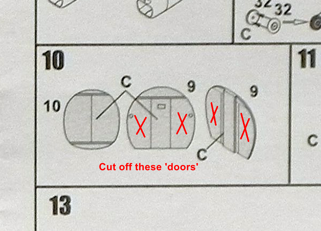

Never being one to leave good enough alone, I ripped out the cockpit bulkhead and removed the 'doors' as these would either be open or have curtains.

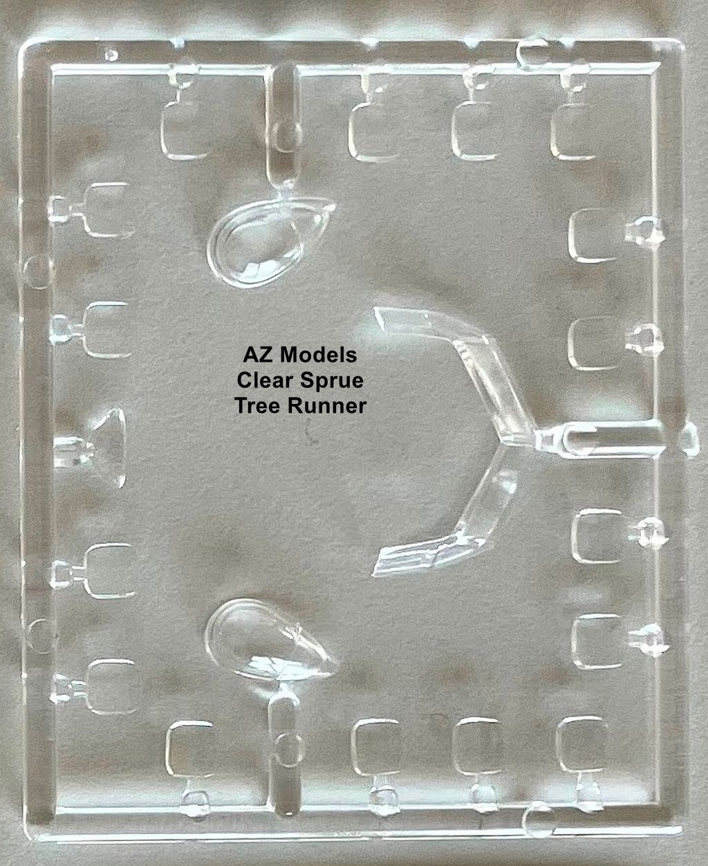

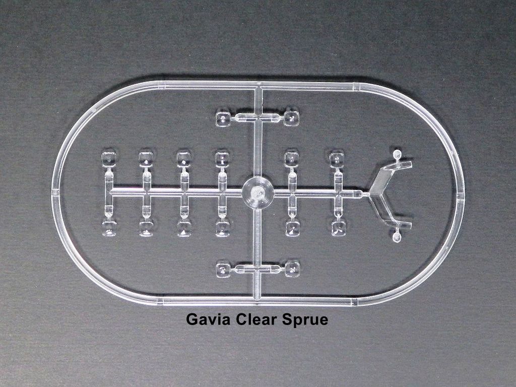

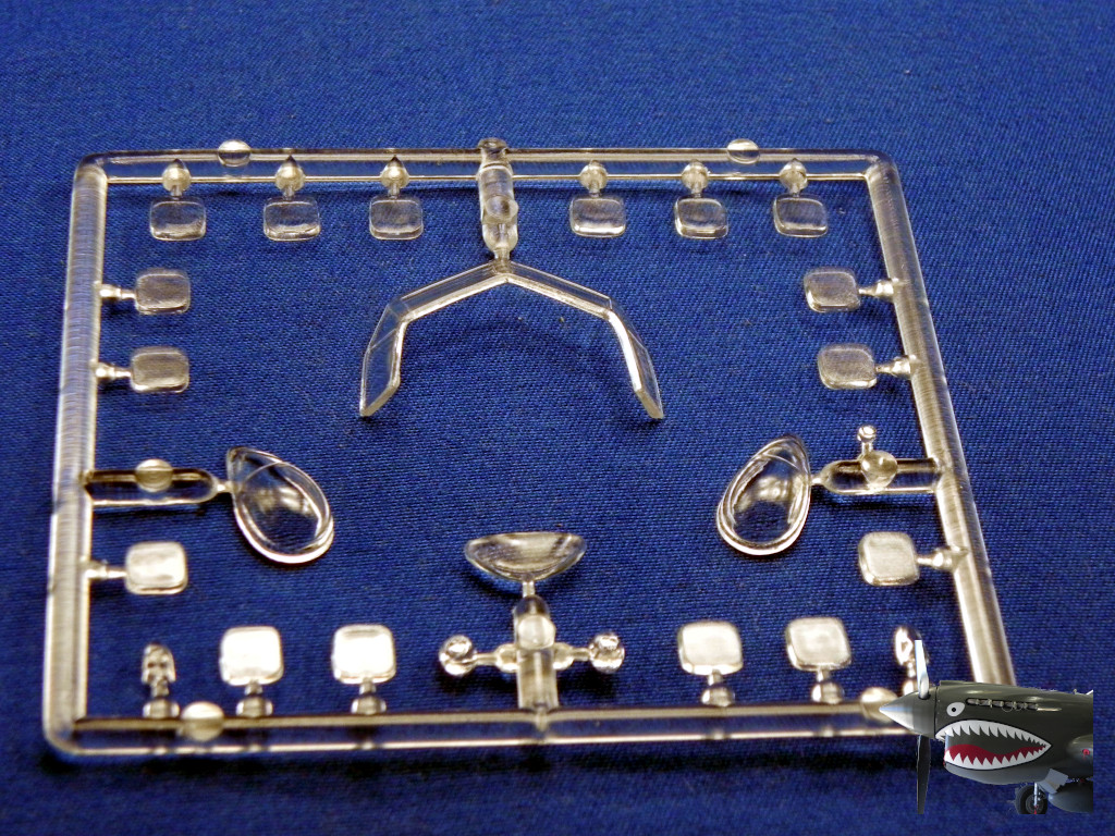

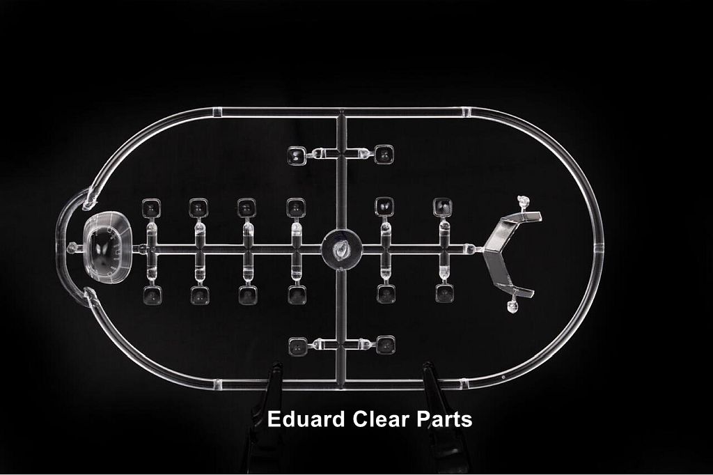

The evolution of the clear parts...
Gavia clear sprue tree runner:
Eduard updated it to include a clear nose to be used in conjunction with their PE set:
AZ Models Clear Sprue Tree added the bulged windows on the sides.
It is obviously different from the KP clear sprue:

First off, in Step 1, for the L-420 (& L-410NG) it is mentioned to use a decal for the 'glass' instruments. They are not on the sheet but the decal for the earlier variants is on there. Step 2 fooled me in that the supports (thin tubes in real life) were hollow. I can replace them but they won't be seen unless I cut open the starboard access door. Step 3 has me curious as to why Eduard offered replacement control yokes so I looked at the kit and saw the asymmetry, not a big deal to bend them to match. Step 4, one should used the 5 bladed propellers for the kit included markings. Step 5, parts 43 are simply blanking plates with absolutely no details, not even an incorrect mesh patters. There is a duct there which was an opportunity for KP Models to add another change as well as the aforementioned solidly molded exhausts. Solid air inlets in Step 6 is another place KP Models could have improved the mold. The outer main gear wheels in Step 7 do have nice details but lack tread and the legs are extremely basic shapes. There is nothing to comment or improve upon in Steps 8 & 9.

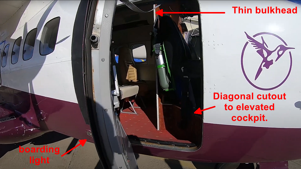

The cockpit entry door is correctly positioned on the fuselage but the interior has a bulkhead butt against it and the cockpit floor is higher than the lower level of the door... Yes, don't ask why, but I looked it up!
By simply cutting off these doors, the bulkhead would not only be more accurate, but save all the trimming, filing, and sanding done to get the fuselage halves to meet:
The doors are not on the real deal and certainly not on the medevac version here:

Still liking the kit... just perturbed! Yes, photos of plastic will follow but I have a heavy work week... I did look at the Gavia builds on YouTube (since it had the interior) and noticed that AZ Models offered a correction set of a resin nose and clear plastic parts. The latter are IDENTICAL to the KP clear parts sprue tree runner! When AZ Models offered the kit, their correction set was included. So, when KP released their newly tooled kit, it obviously relied on the Gavia kit with the AZ Models correction in place.
Last...Oy! If thisis true, it does mean that all the AM for the Gavia kit is a perfect fit to the KP. Quick summary, Gavia's designers own the Intellectual Property (IP - design), Pavel owns the molds, Eduard bought the rights to produce from said molds from Gavia's owners and Pavel. It seems AZ Models got their hands on the Gavia molds and produced a replacement resin correction nose and a completely new clear styrene sprue tree runner and KP Models decided to incorporate the changed contours of the nose, and include the new clear sprue tree runner with their release. so, essentially, the KP Models Turbolets are the 27 year old Gavia kits with the resin nose incorporated as well as the improved clear parts. There are some other minor changes too.

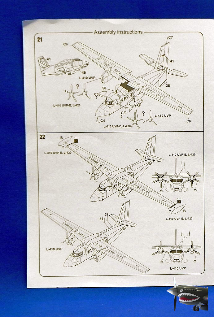

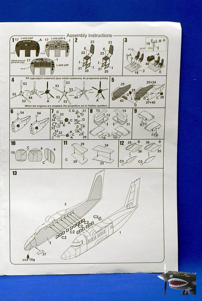

The instructions are confusing as they are not clear. Also, the print layout makes it worse so I photocopied and printed each page separately so they could be larger and follow a proper sequence.
To save you the trouble, here they are in the proper order:

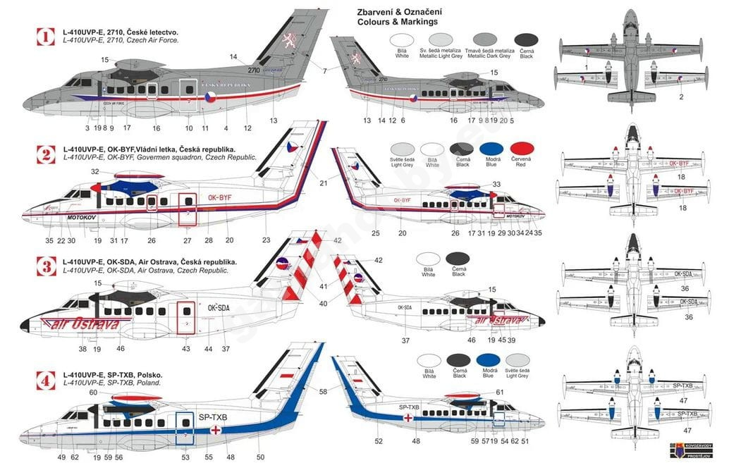

Of course, one of the Gavia releases had this scheme included:
Scheme 1 - Czech Air Force Let L.410EVP-E20D number 2710:
Scheme 2 - Czech Let L.410UVP-E20D Tubolet Registered as OK-BYF:
A good view of the open door...
Scheme 3 - Czech Air Ostrava Air Line Let L.410UVP-E17 Turbolet Registered OK-SDA:
Help with the lighting...
Scheme 4 - Polish Let L.410UVPE-16 Turbolet registered as SP-TXB:
Notice the lack of the red crosses...
Now, it also has AHEJ on it under the horizontal stabilizers...
