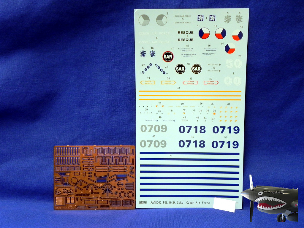

Step 4 has you glue the PE instrument panel directly to the styrene part and completely forgets that there is an acetate film (like Eduard did) which should be applied to the white painted styrene part before attaching PE21.

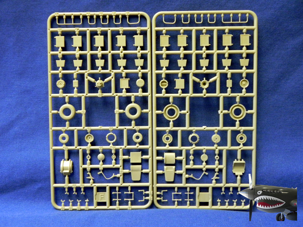

Step 24 has unidentified pieces. The backrests are F-13.
Step 26 has unidentified pieces. The backrests are F-13.

Step 30 has an unidentified piece. The backrest is F-13.
Step 31 has an unidentified piece. The backrest is F-13.
