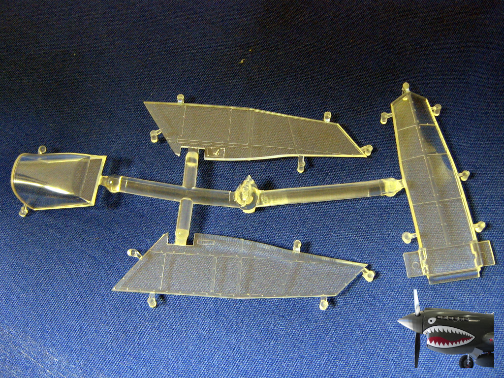

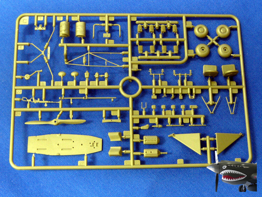

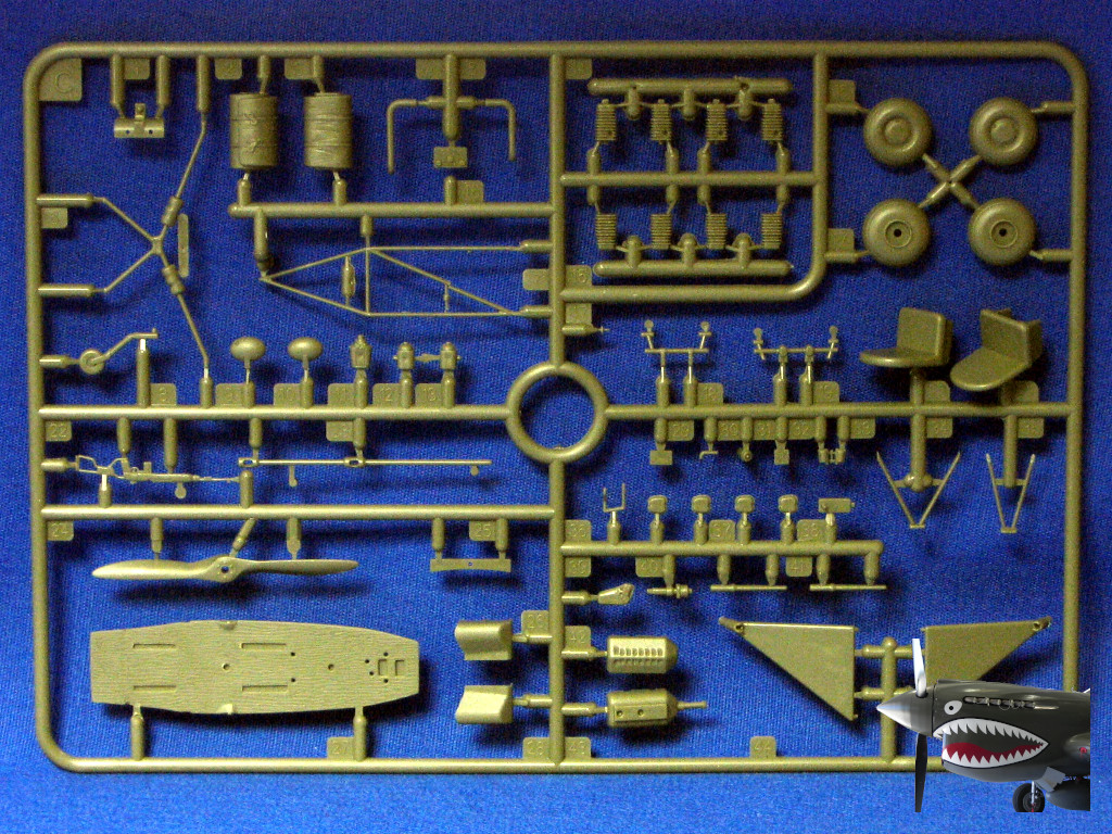

This model arrived in a rather large box with a nice but inaccurate painting of a Grasshopper flying over a column of Tiger tanks. Interestingly, the sample is form the Chinese domestic market with the name of Weijun Models instead of Bronco. Inside, we find 72 olive styrene parts on three trees, four clear styrene parts, 17 different photo-etched parts, instructions and a sheet of decals. There is plenty of empty space in the box.

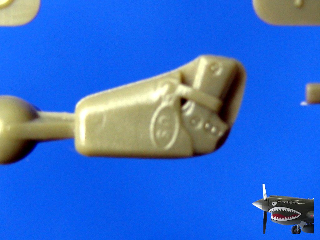

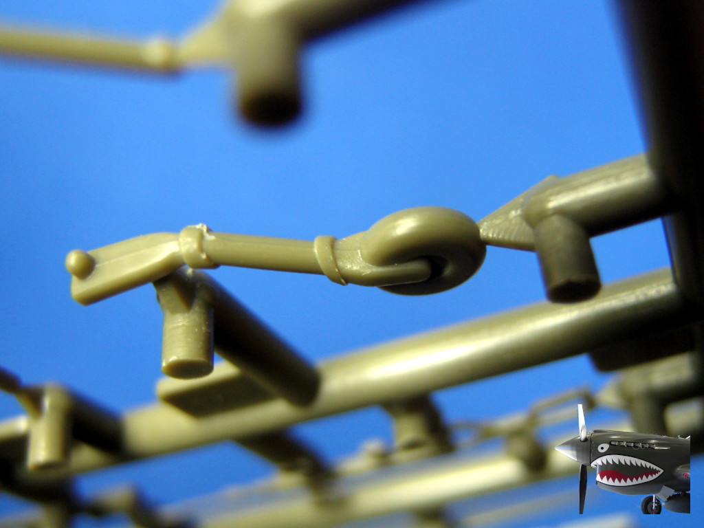

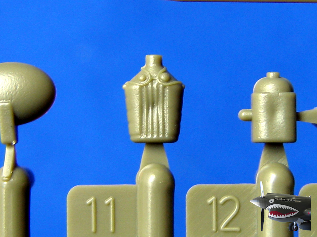

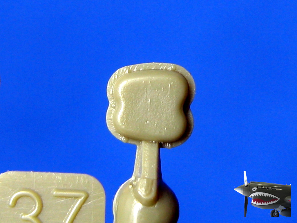

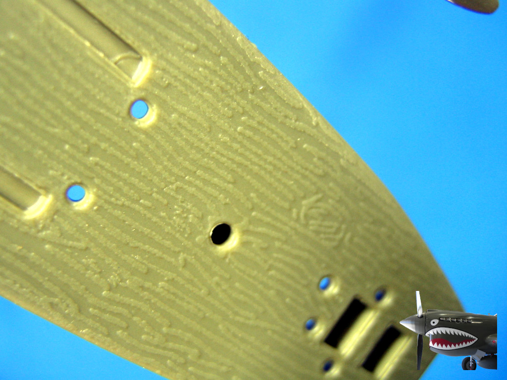

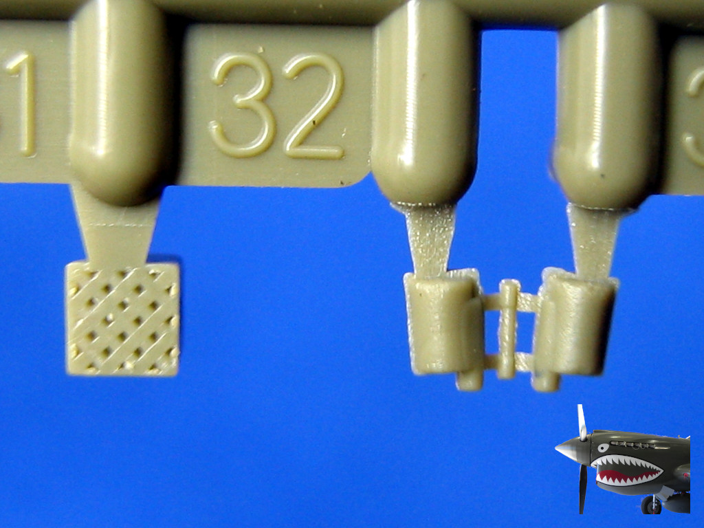

The molding is very good with no flash or short shots. However, looking at the details, some are extremely fine while others are rather clumsy. Case in point, the Colt M1911 in its holster is rather sharp while the seats are really thick.

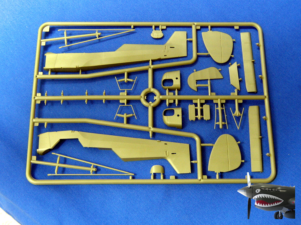

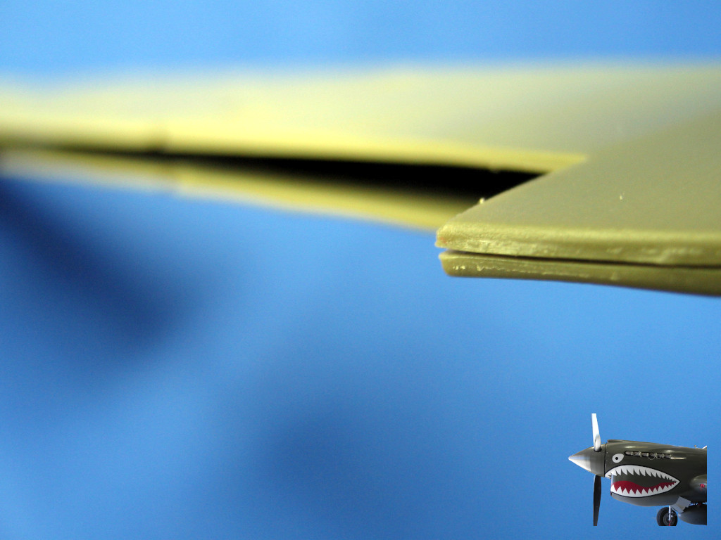

Cutting out the main parts and taping them together show that there is good fit all around but my main concerns were the details. While the Piper Cub is a simple aircraft, it is hard for me to believe that it can be properly modeled in this scale with only 76 plastic parts. This is especially true since neither slide molding, multi-part molding, nor is pin molding in evidence here. This means that details on the bottom of the fuselage (main body) are missing.

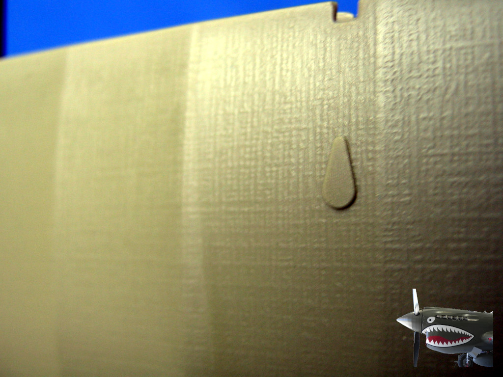

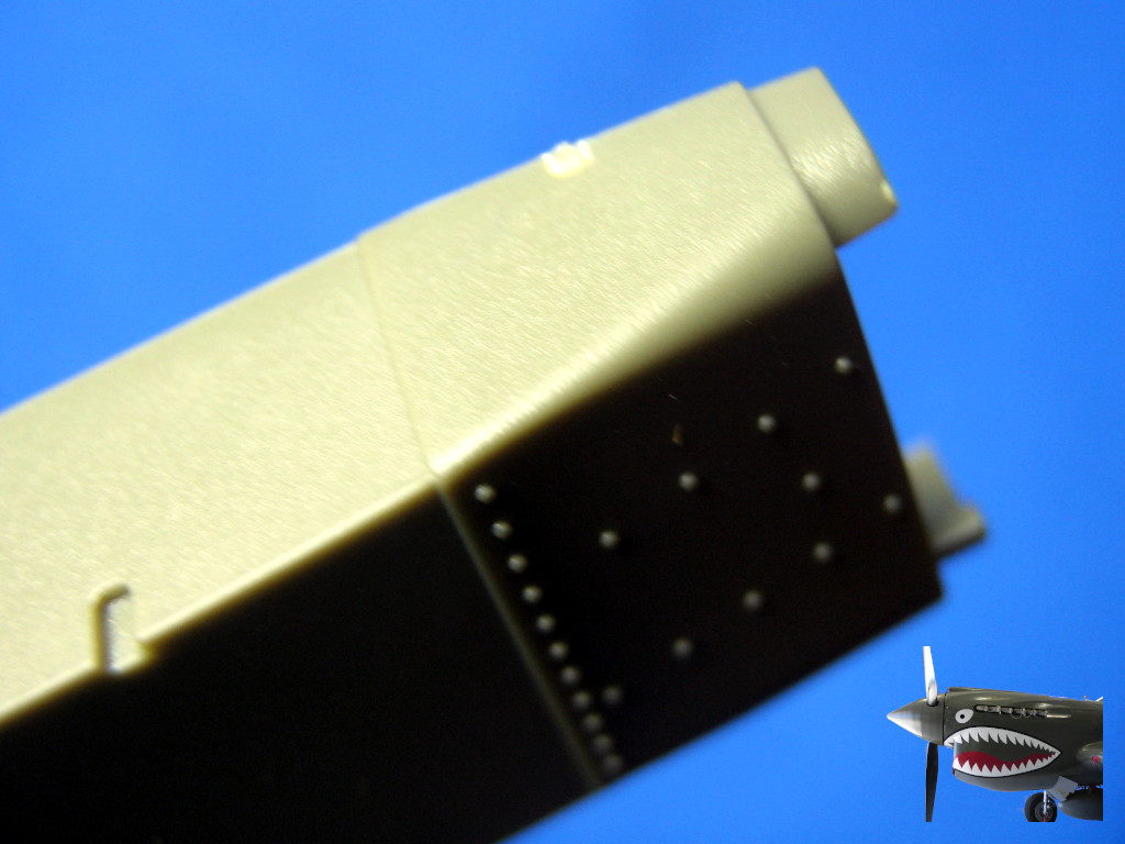

The actual aircraft is made of aluminum, doped canvas, Plexiglas, and wood. There are some other materials like steel but those are kept to a minimum. The riveted construction of the sheet metal nose is well done for the sides but the bottom lacks any of the rivets. I would have expected to see rivets on a tree to shave off. The nose is made of two sections causing a seam which is difficult to remove. This could have been avoided by using three parts following the natural panel lines.

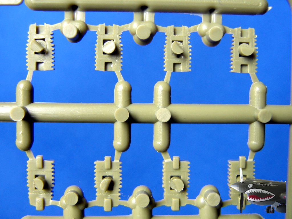

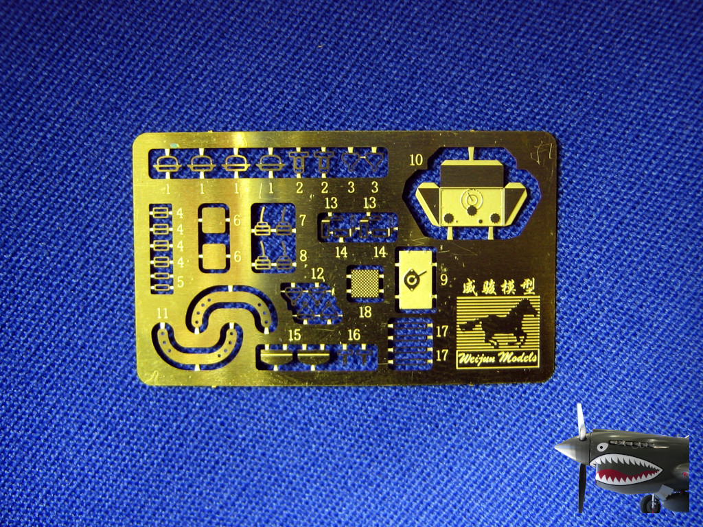

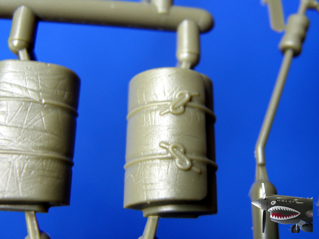

There is a bed roll which is best tossed, no radio, which is needed for an observation and forward air control. Frivolous parts on the photo-etched sheet which replace perfectly adequate styrene parts, raised knock out pins on the mating surfaces of the engine’s cylinders, one piece tail wheel assembly, and the list goes on.

The only options in the kit are a bench seat in place of the rear bucket seat, and the option of plastic or photo-etched part. I choose plastic as the photo-etched offers nothing other than a folding exercise.

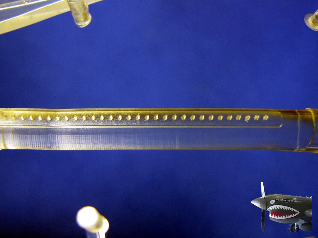

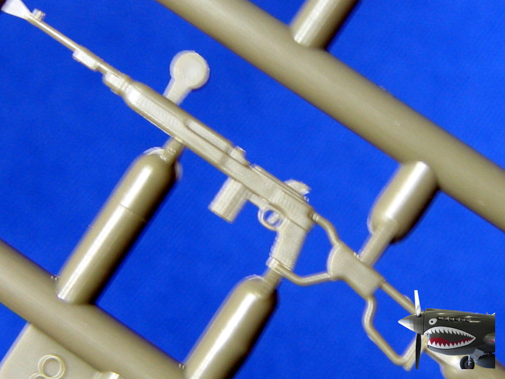

The rudder pedals (C18 and C 19), control the rudder B8. They also control the tailwheel while on land (taxying). The internal bracing is fragile and well done for the most part. A carbine along with a pair of binoculars, canteen, and a Colt M1911 are furnished. However, no color details are offered for the instruments (at least a decal would have sufficed), no locking mechanism for the entry door (B9), and the worst being that the modeler must cut off rivets and add them to the windscreen from a clear sprue. Clear plastic is much more brittle than colored styrene and this procedure will be difficult. No mention is made of how many are needed (three times the amount per inch of the sides).

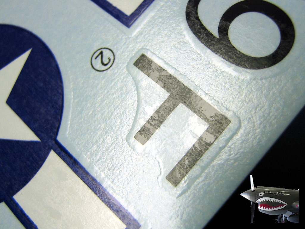

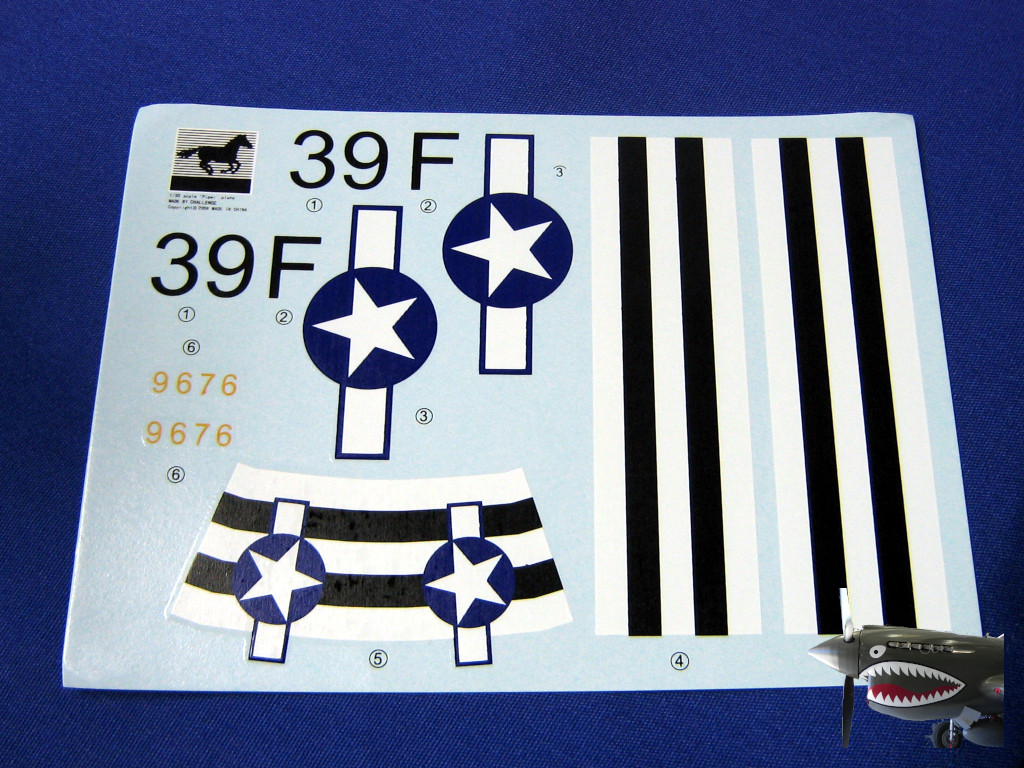

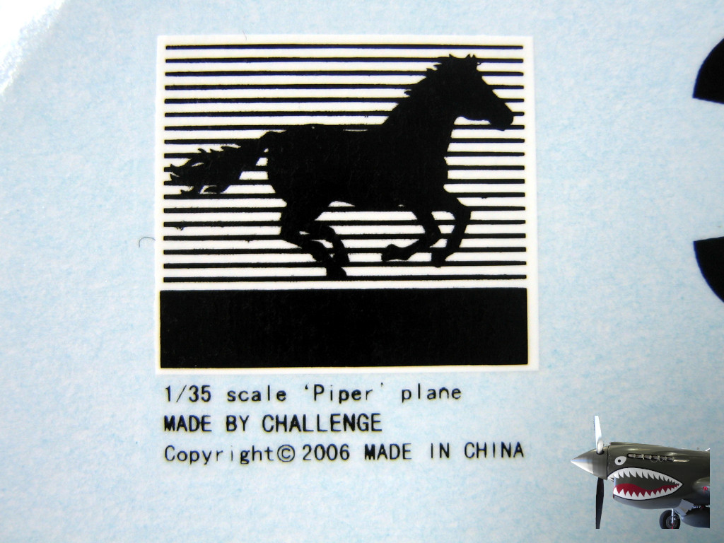

The decals are a bit thick and have a speckled gloss finish. No stencils are provided, nor are any other markings other than 39*F and the serial 9676. No other information is provided, not even colors! While the box art shows a white 39*F, the decals are in black and the wrong type face! The serial is in yellow when it should be Orange-Yellow.
This aircraft is either 43-29676 or 44-79676 and belonged to the V Artillery Corps. It was painted in Olive Drab 41 over Neutral Gray 43 with edges in Medium Green 42.

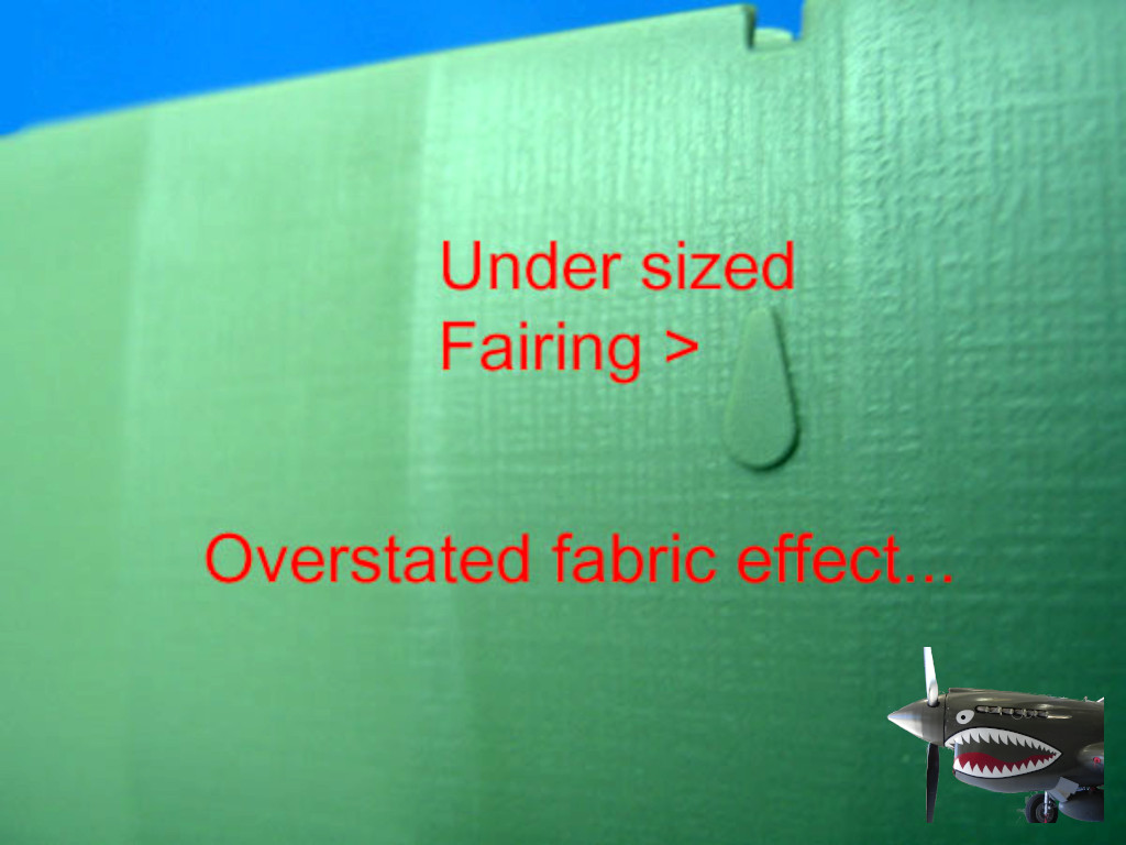

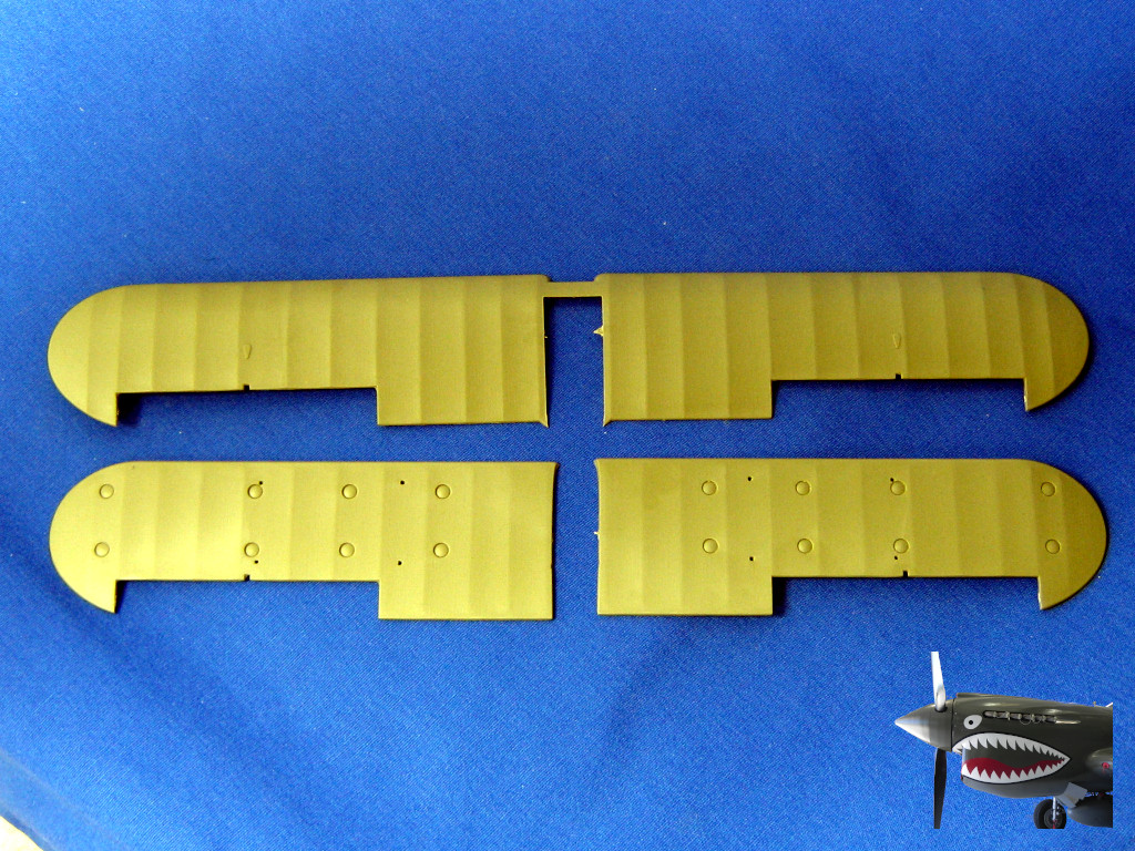

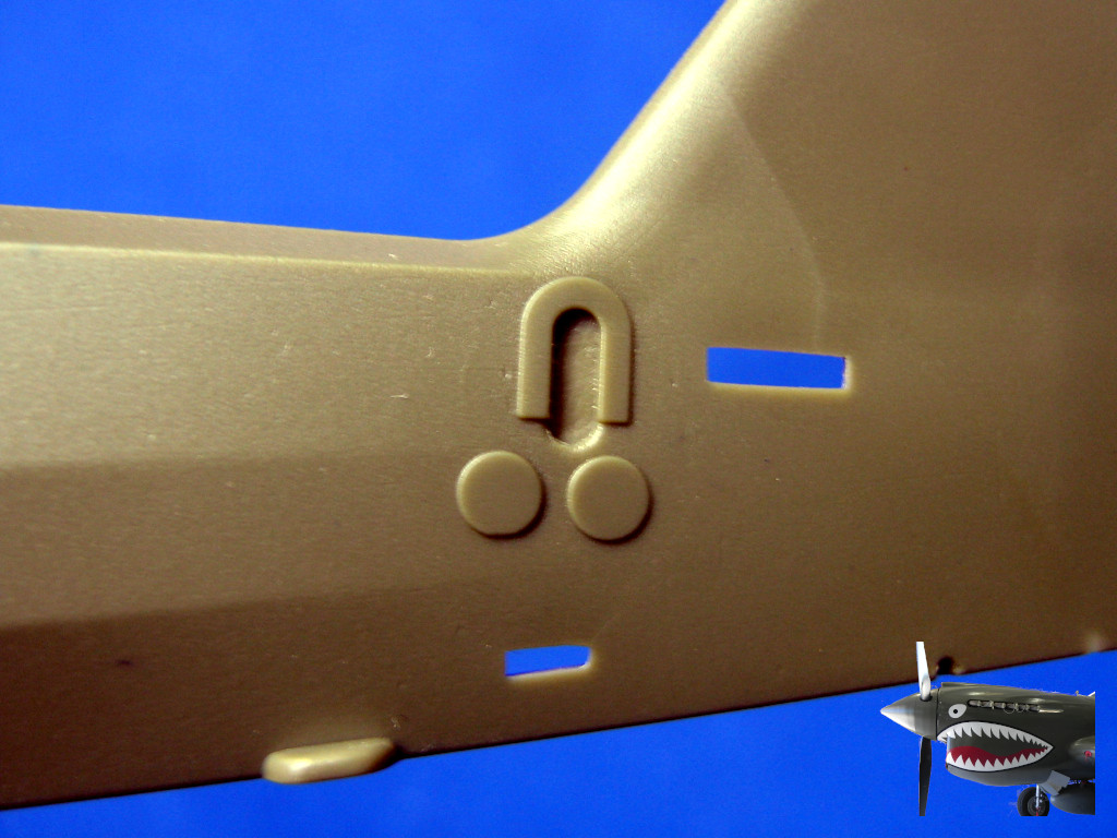

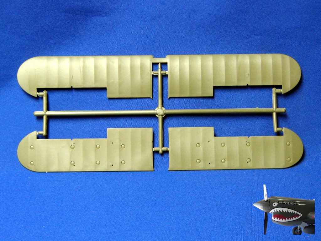

Taking some measurements I have from a survivor in Poland, I compared a few items. Wheels 450 X 220 are a good diameter. The inspection hole covers (the round items near the tail), are a good match but those on the bottom of the wing are grossly over sized. It seems that the designers mistook it for recessed landing lights! Fill in with putty and add disks matching those on the side of the fuselage. While one is at it, add two more (side by side) just behind the bungee poles of the landing gear.
