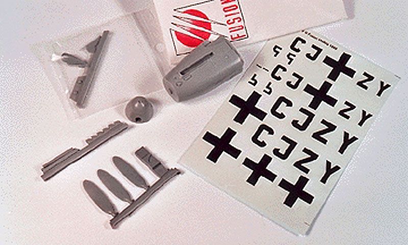

the kit

Mike the set is from Fusion Models - but! there are now no decals with the set - I wasn't told this when I purchased the kit from New Zealand, even though it was shown that it did contain decals, then had a shitfight with Fusion who said it was stated on their website - funny about that because it wasn't stated until I contacted them and asked about the decals, the next day the site was updated about ''no decals'' with this set.
Still looking for a letter sheet of suitable decals unfortunately
