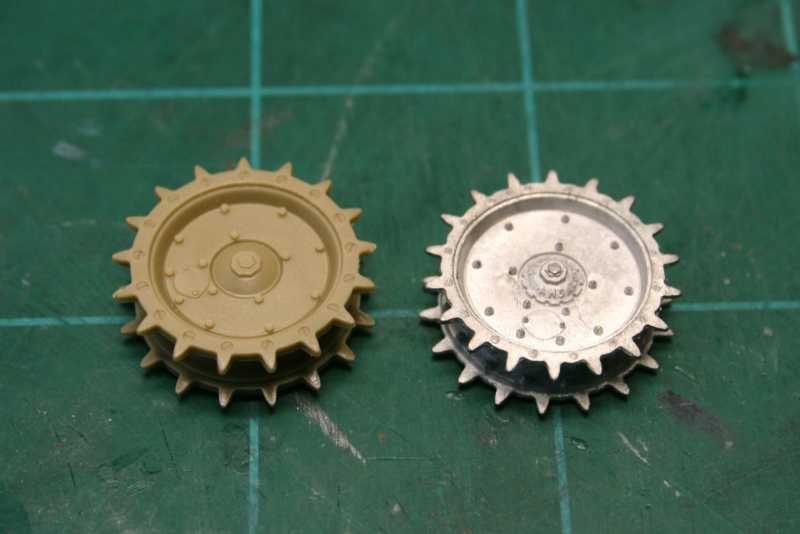

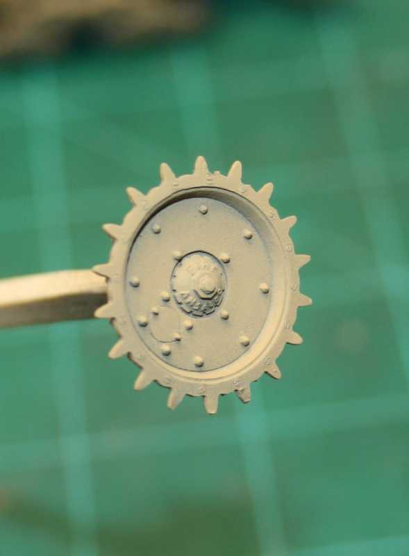

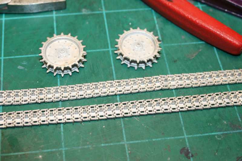

Thanks, guys! Moving forward, I added a dark wash to the recesses and removed the excess. While that was drying, I broke out the tracks. Friul provides drive sprockets in the package, I like the extra detail on them and the kit sprockets don't fit the metal tracks.

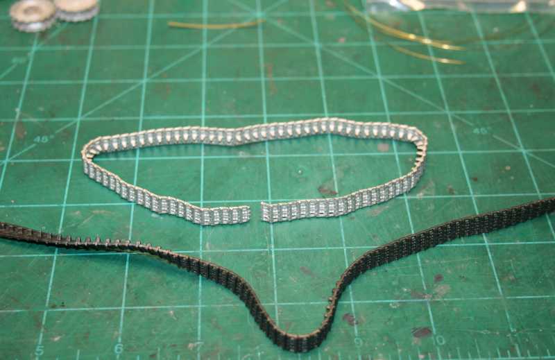

I consulted the Book of Armaments, Chapter 2, Verses 9 to 21 for the number of links per side. "And the number of the counting shall be 87, no more, no less and blow thine enemies to tiny bits, in thy mercy." Oh wait, I've gotten a bit silly...

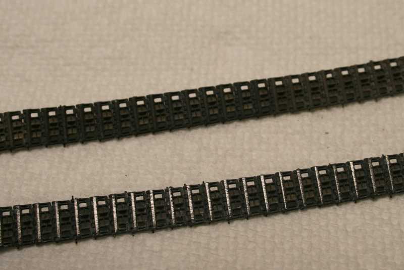

First run as compared to the kit tracks.

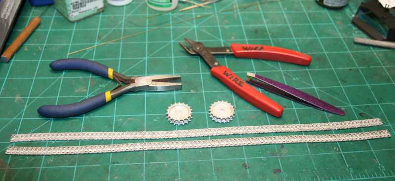

On to the second run!

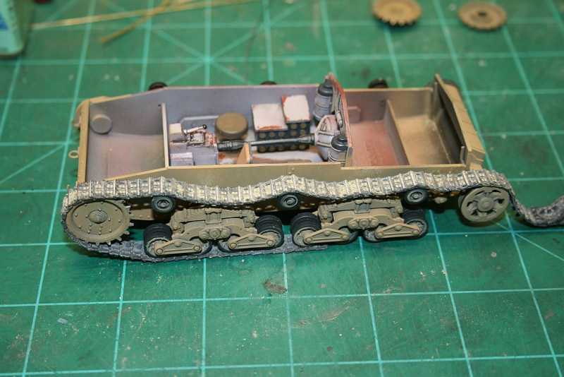

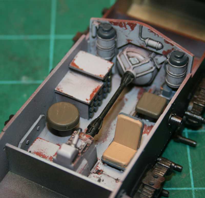

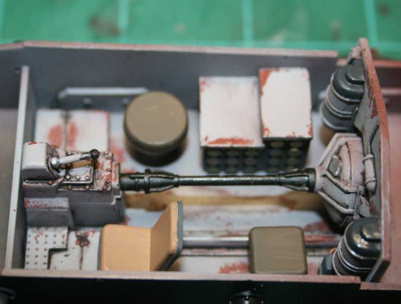

I did like the way the wash looked, so I shot a flat coat over the interior, added some bare metal spots with pigments and graphite pencil. Seats are just a first coat of paints and mocked up for photos.

I finished the second run. Friulmodel gives you 220 links, but not enough wire to assemble the 174 required. :idonno I had saved wire from past projects, so I could finish, but it seems they'd have that worked out by now. I usually replace their wire with .20 brass wire, but these links are smaller and the holes would have to be redrilled to accept the larger wire. :pp I'll say this set was well molded, not a lot of nubs to remove like on some of their other tracks.

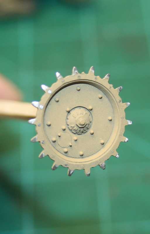

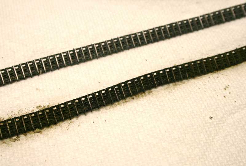

Thanks Chris and Piet! Had to work yesterday morning and wasn't feeling like modeling yesterday afternoon, so i took the rest of the day off. :laugh: I got up feeling it this morning so I charged into tracks and running gear. After a dip in the Black 4 Tracks, they look pretty good.
A quick pass with the sanding stick polishes the wear surfaces.
I hit the other side and mixed up a sandy looking batch of Vallejo pigments.
distribute the pigment over the tracks as randomly as you like, then apply a little pigment fixer, alcohol or acrylic thinner to set the mix.
I like to add some over the top by tapping the brush and letting the pigments fall. Hard to tell what the finished product looks like when it's wet, so you may have to add more or another color to get it right.

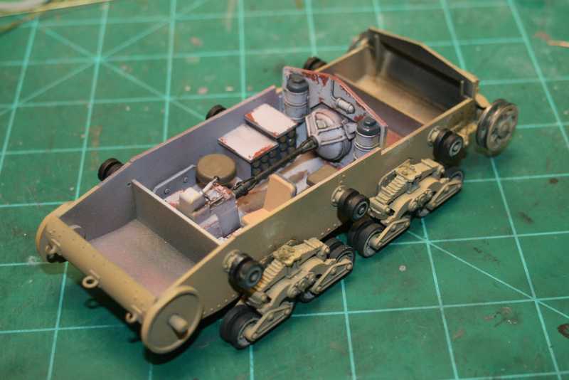

While those were drying, I went to the garage to get base color on the lower hull and wheels. Tamiya Desert Yellow thinned with Tamiya Lacquer Thinner.
And here's a taste of what I'm gunning for.

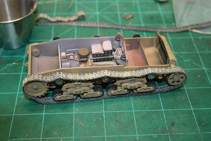

Installing the tracks is pretty simple, I wrapped the tracks around the sprocket, making sure the teeth were engaged and then spread the run over the returns.
I flipped the hull over and added the last pin.
I've exaggerated the sag a little, but being an old Tamiya kit, there's no take up to the track. It will look good when the upper hull is installed.
