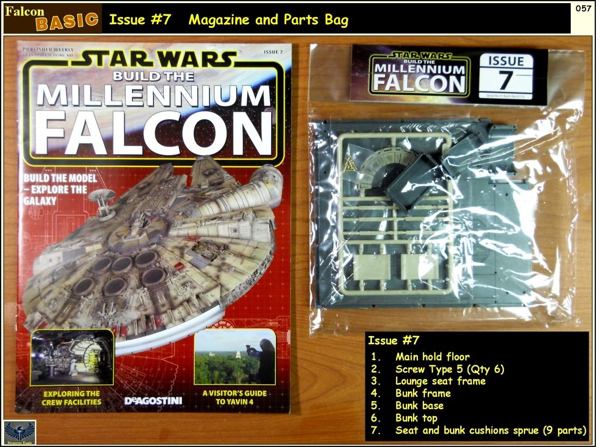

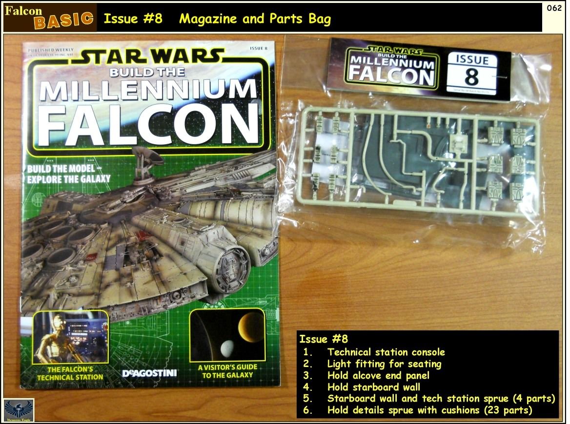

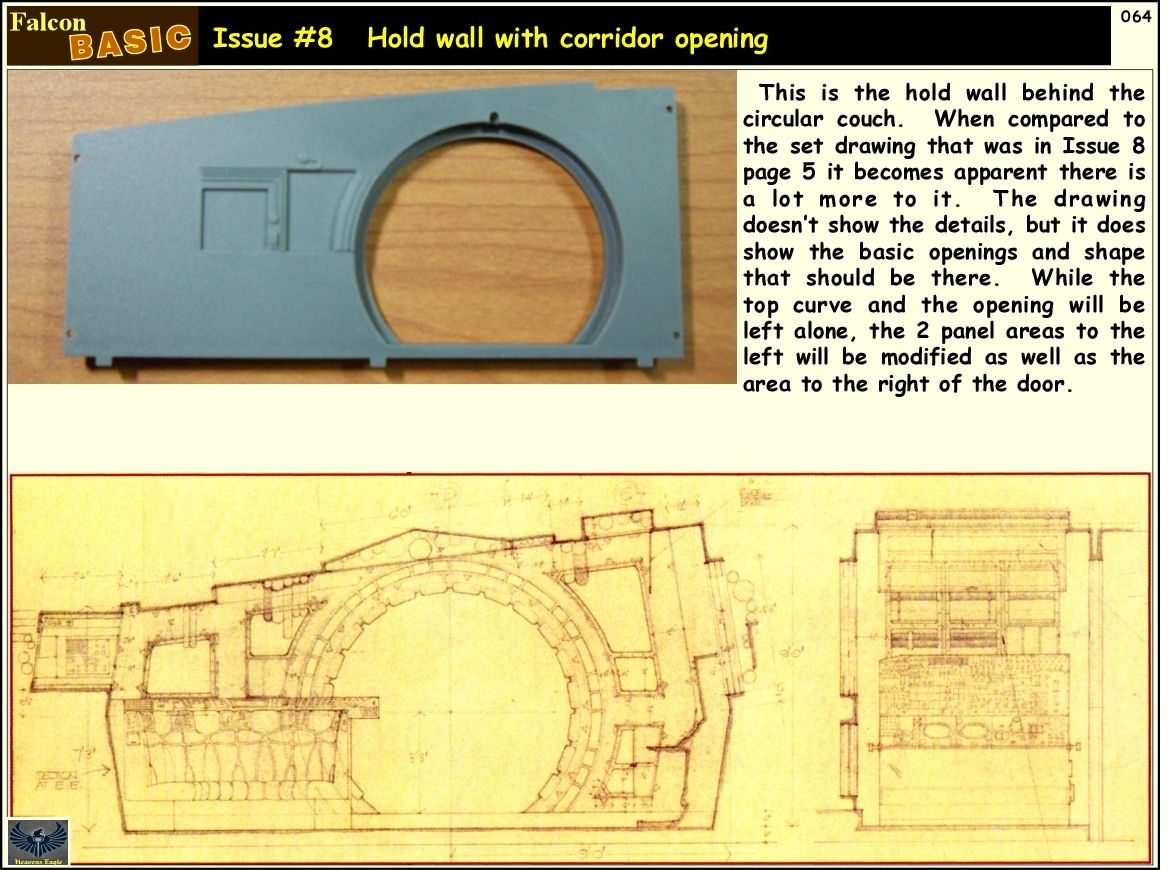

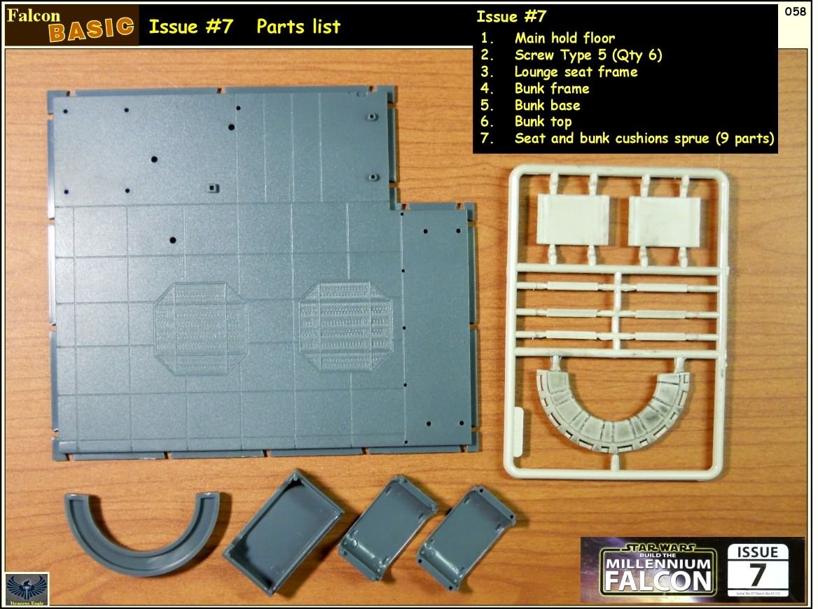

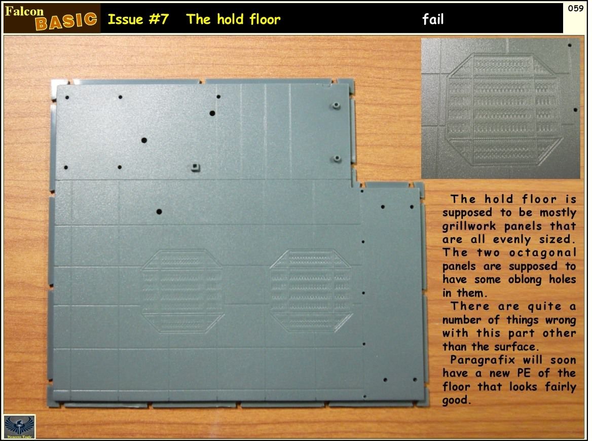

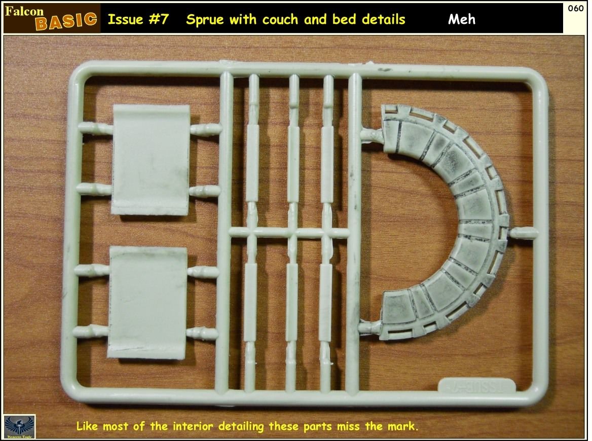

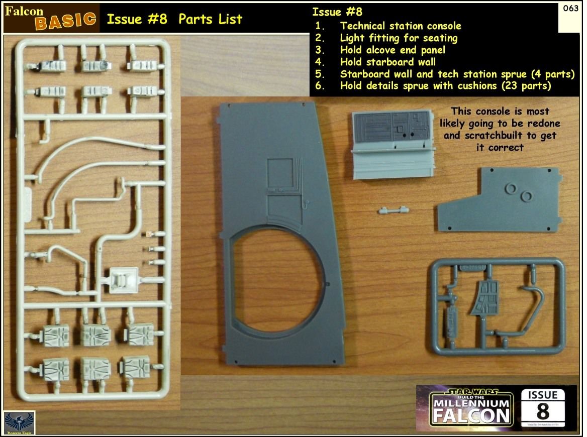

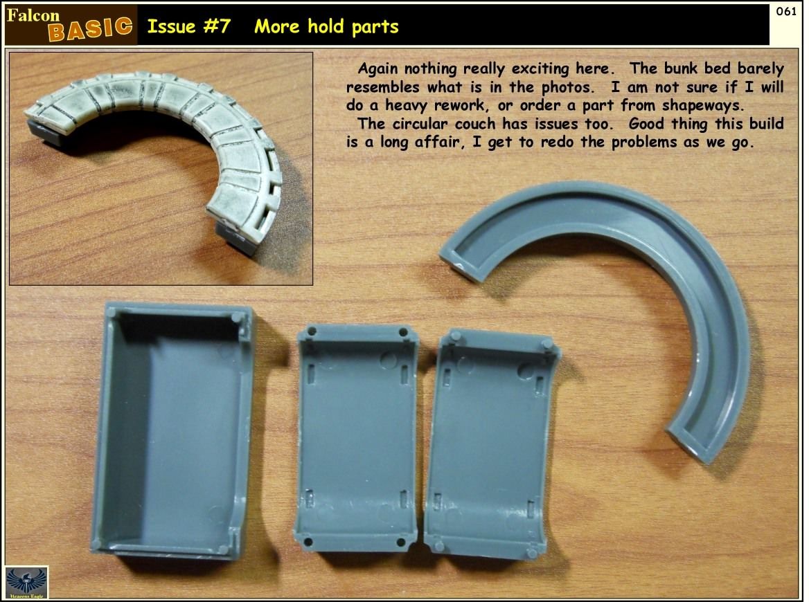

Here are Issues #7 and #8
Falcon-Basic-057.jpg~original
Falcon-Basic-058.jpg~original
Falcon-Basic-059.jpg~original
Falcon-Basic-060.jpg~original
Falcon-Basic-061.jpg~original
Falcon-Basic-062.jpg~original
Falcon-Basic-063.jpg~original
Falcon-Basic-064.jpg~original
Thanks for looking in, this post has been revised to have Issues #7 and #8.

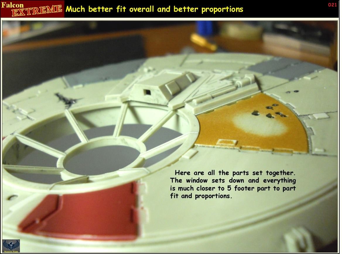

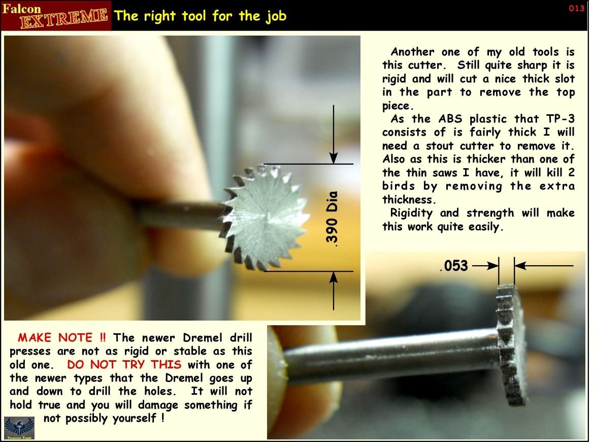

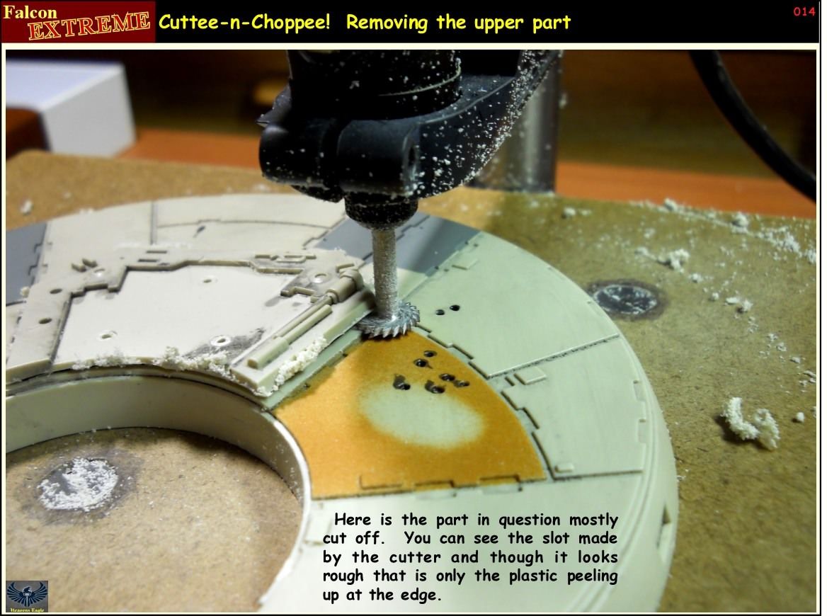

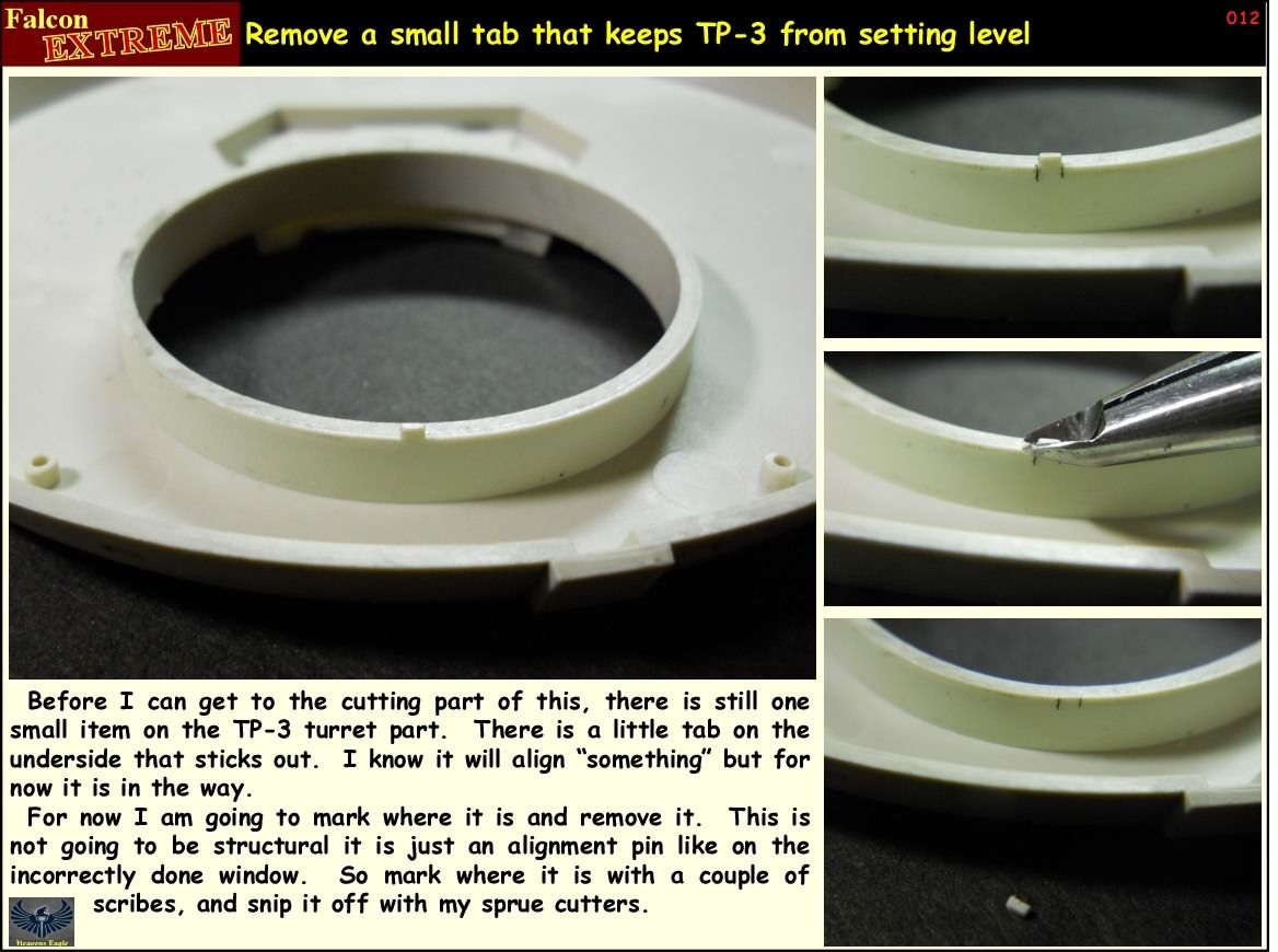

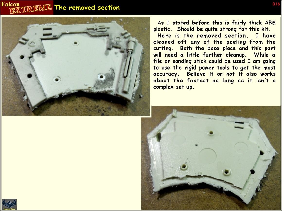

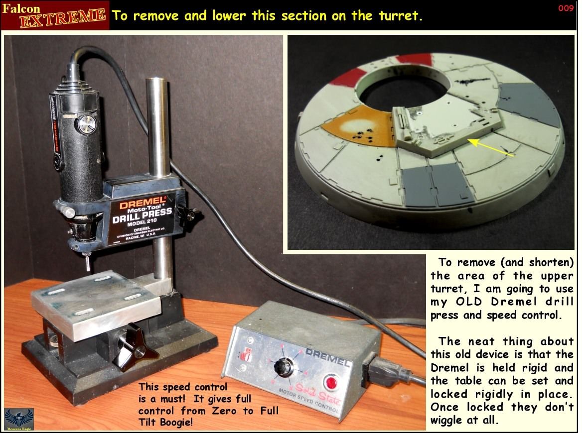

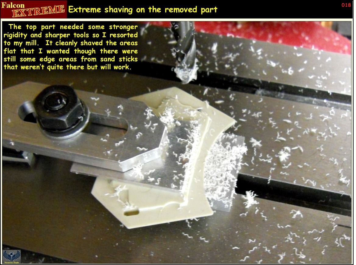

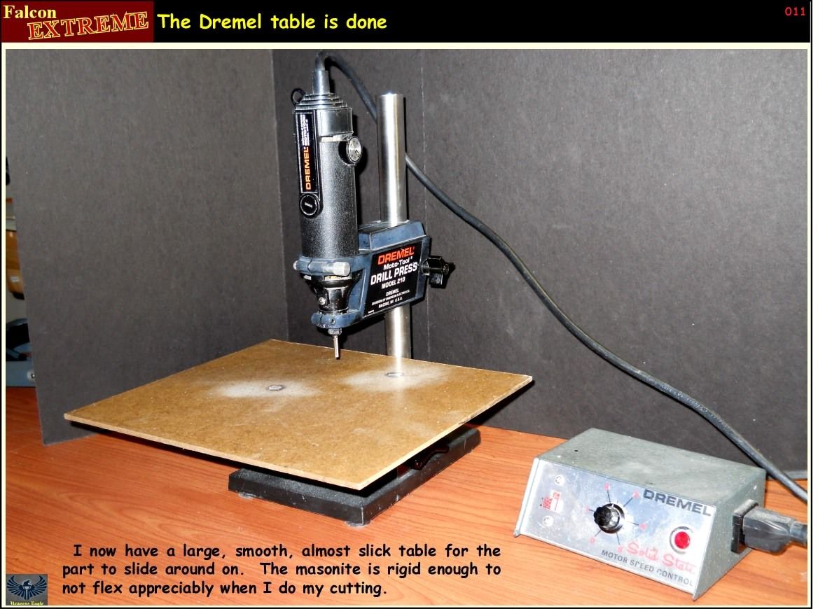

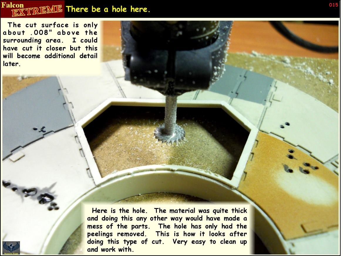

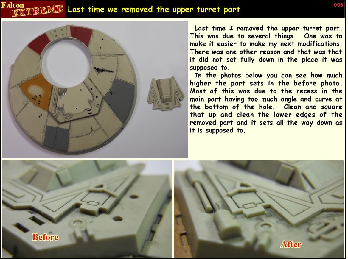

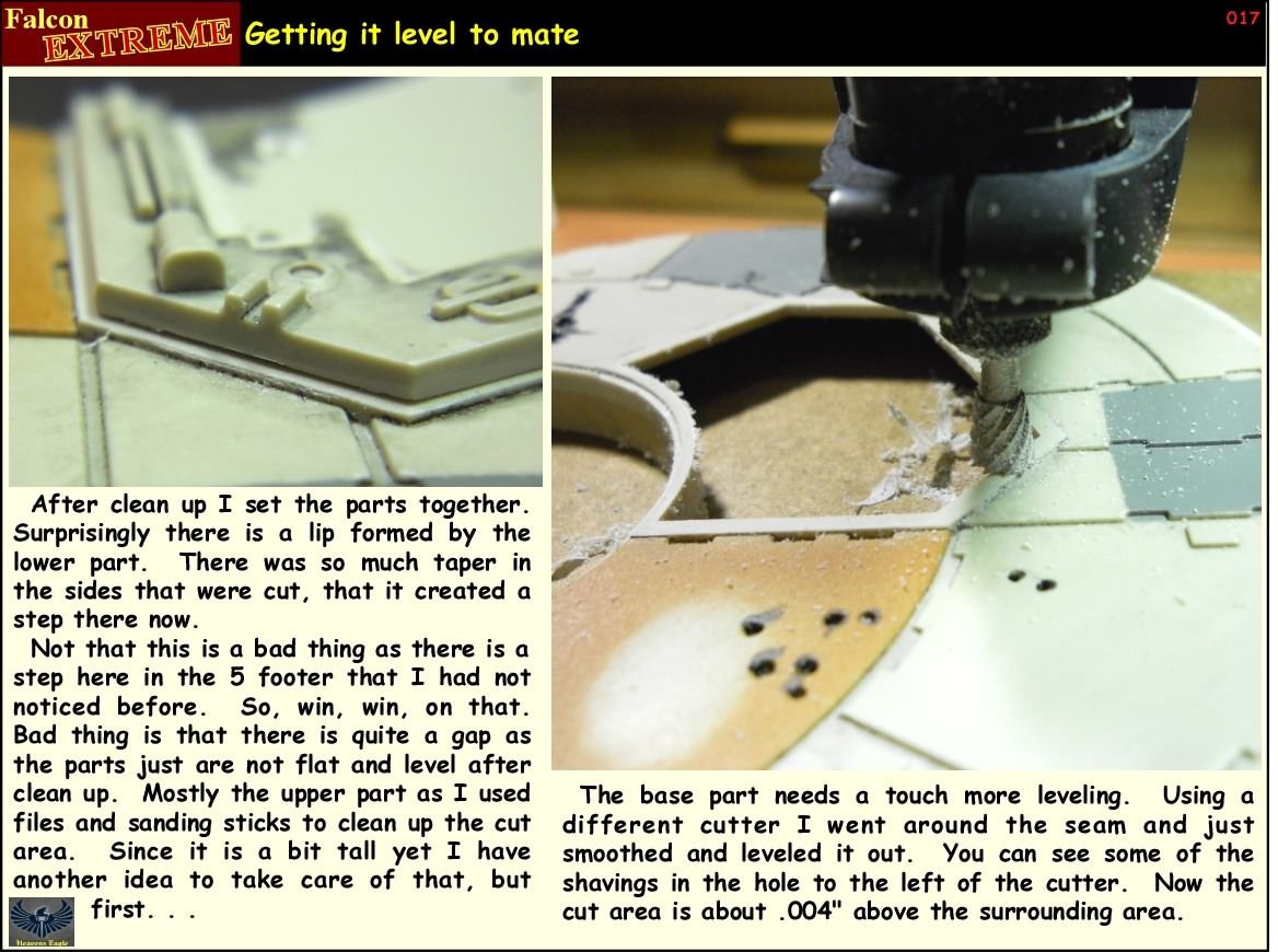

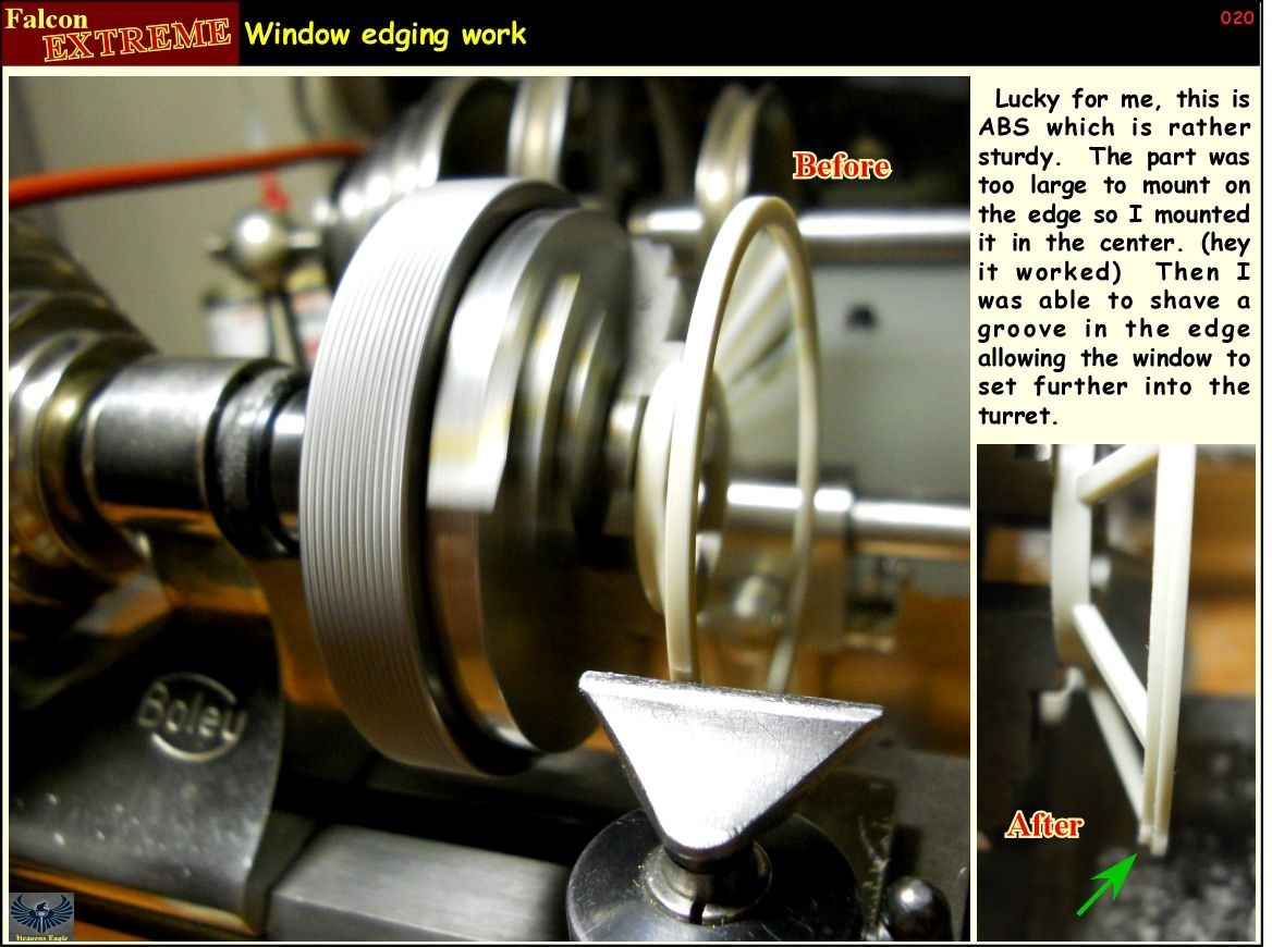

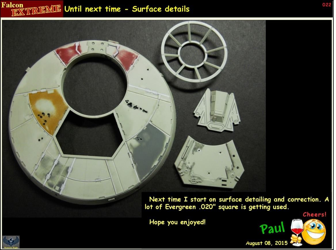

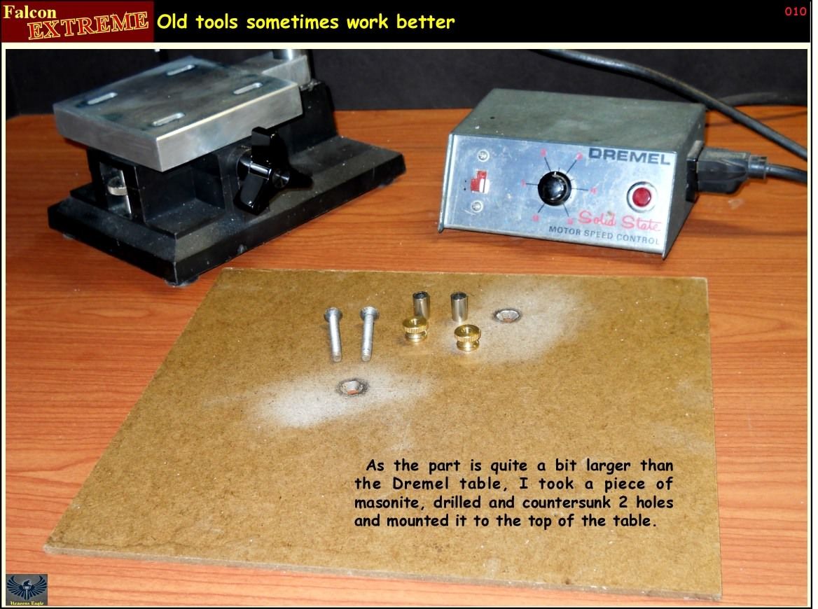

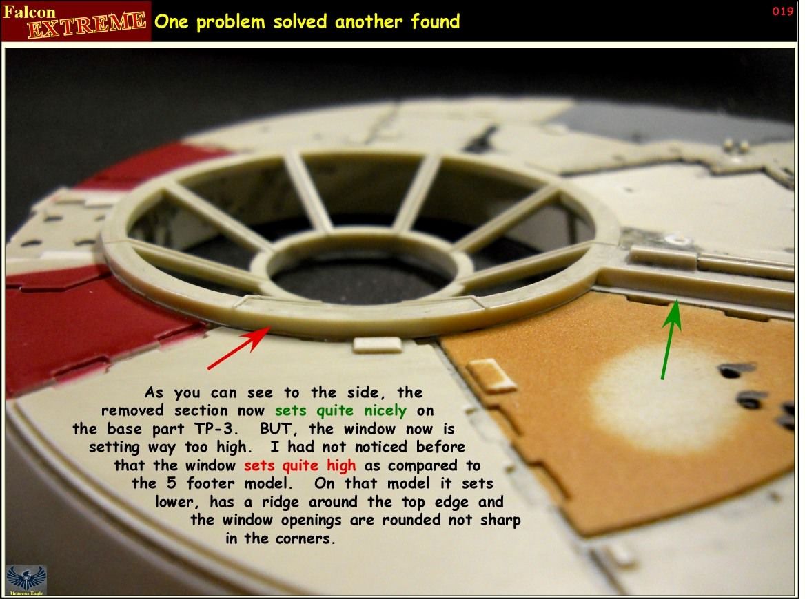

Here is a new post on the Falcon build. It is an extreme one showing how I use an old type Dremel and Dremel drill press to "machine" a part off.
Enjoy
Falcon-FX-008.jpg~original
Falcon-FX-009.jpg~original
Falcon-FX-010.jpg~original
Falcon-FX-011.jpg~original
Falcon-FX-012.jpg~original
Falcon-FX-013.jpg~original
Falcon-FX-014.jpg~original
Falcon-FX-015.jpg~original
Falcon-FX-016.jpg~original
Falcon-FX-017.jpg~original
Falcon-FX-018.jpg~original
Falcon-FX-019.jpg~original
Falcon-FX-020.jpg~original
Falcon-FX-021.jpg~original
Falcon-FX-022.jpg~original

Excellent update Paul. Yeah the new Dremal drill press is more like a toy compared to that thing. Good job on the video also.

This weekend I have been watching American Pie movies and I totally filled and removed all the edge detail on the turret TP-3. Have been adding all the little details around the edge that the 5 footer showed. Kept running out of one type and had to make some more.
More of what?
Little resin castings from a set of masters that I did. The mold of the one piece is starting to get a little worn. I am now reviewing to see how much more is needed to be added.
