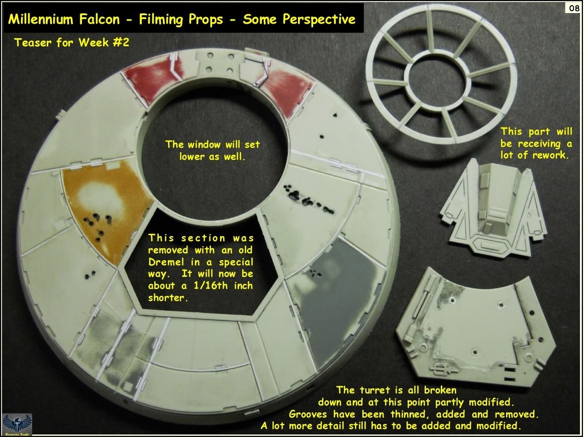

Just a little update to keep everyone up to speed. Have made some decisions about the direction the build is going to take. Here is a little update showing why along with a teaser for Week #2.
Falcon-016.jpg~original
Falcon-017.jpg~original
Falcon-018.jpg~original

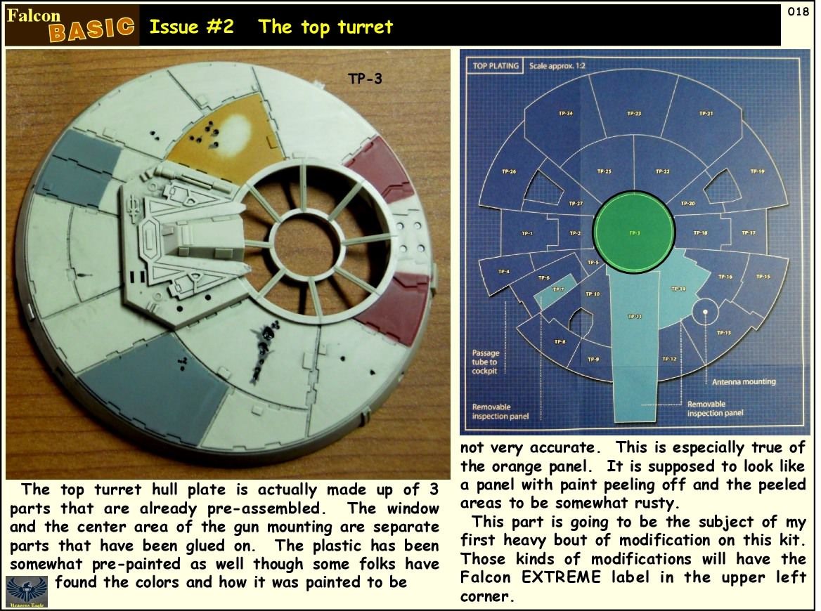

There is where it is at. Week #2 will have the show of what is in that pack as well as the how-to on what has been done on the turret. I will tell you up front that similar mods are going to be done all over the model in upcoming months. How much will be determined by what the part is and what is needed.

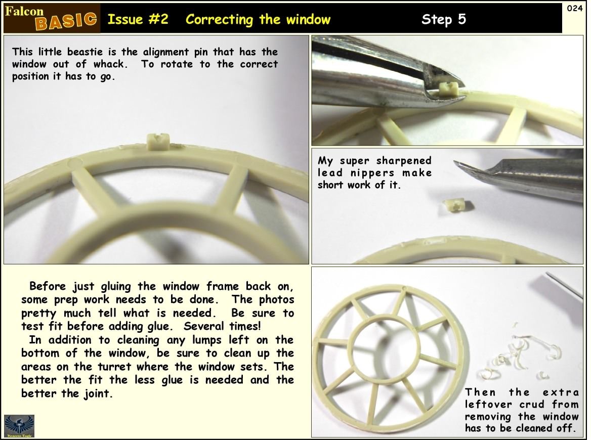

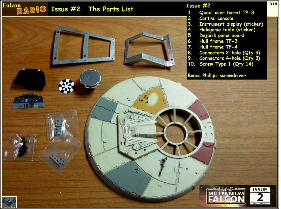

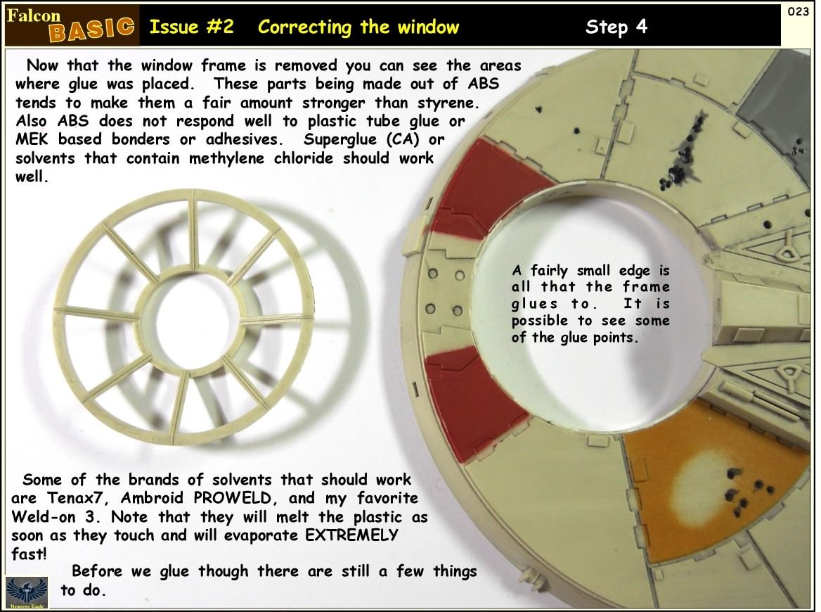

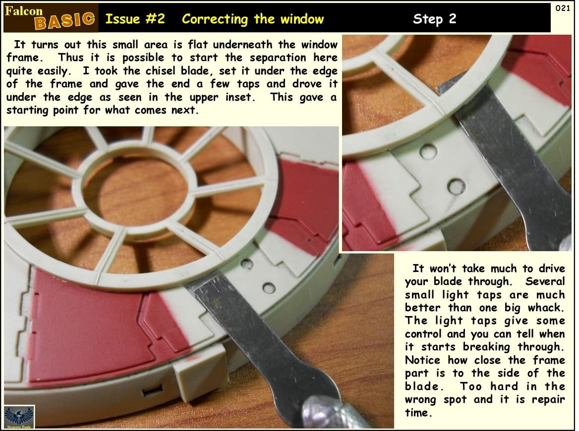

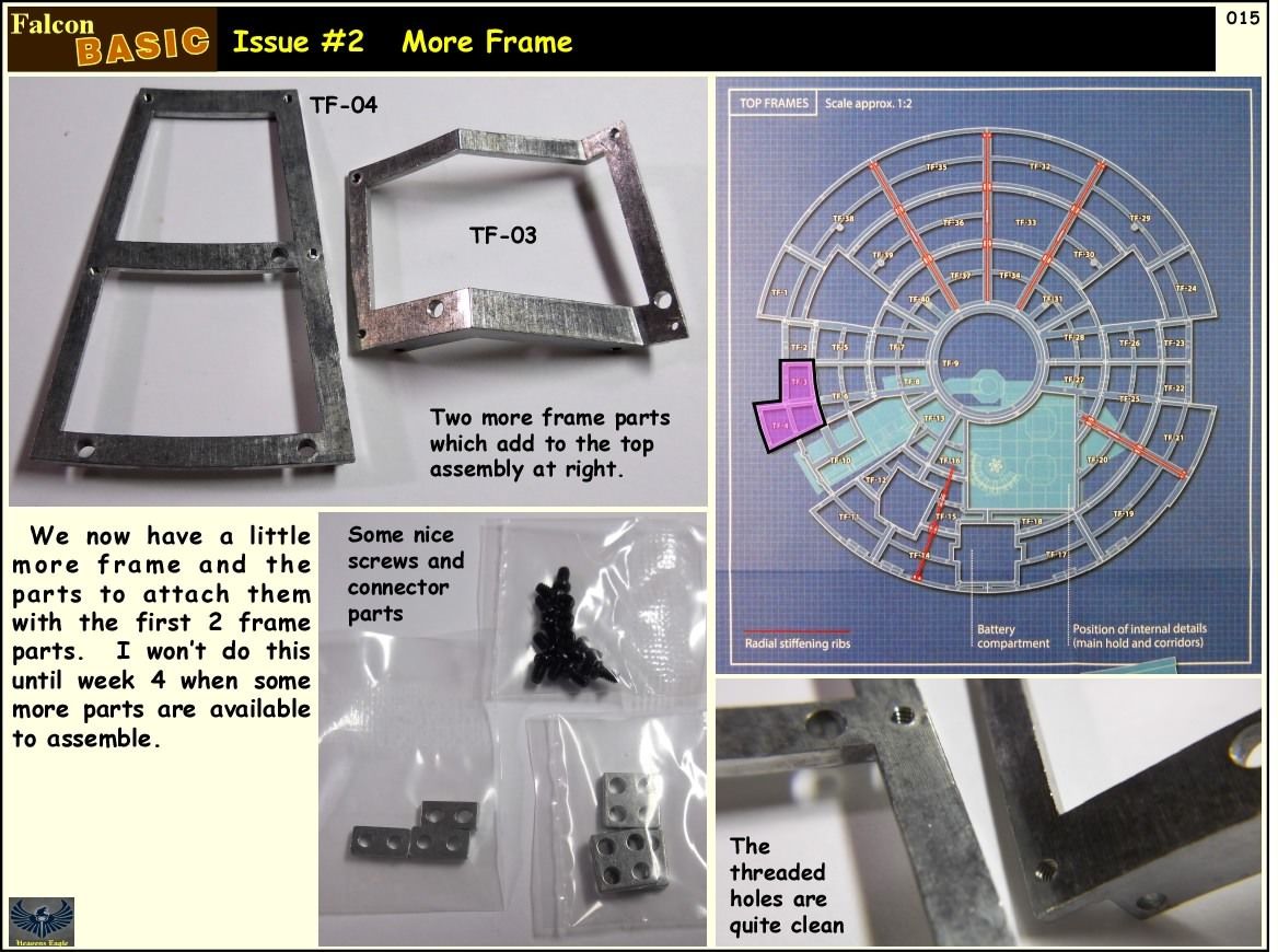

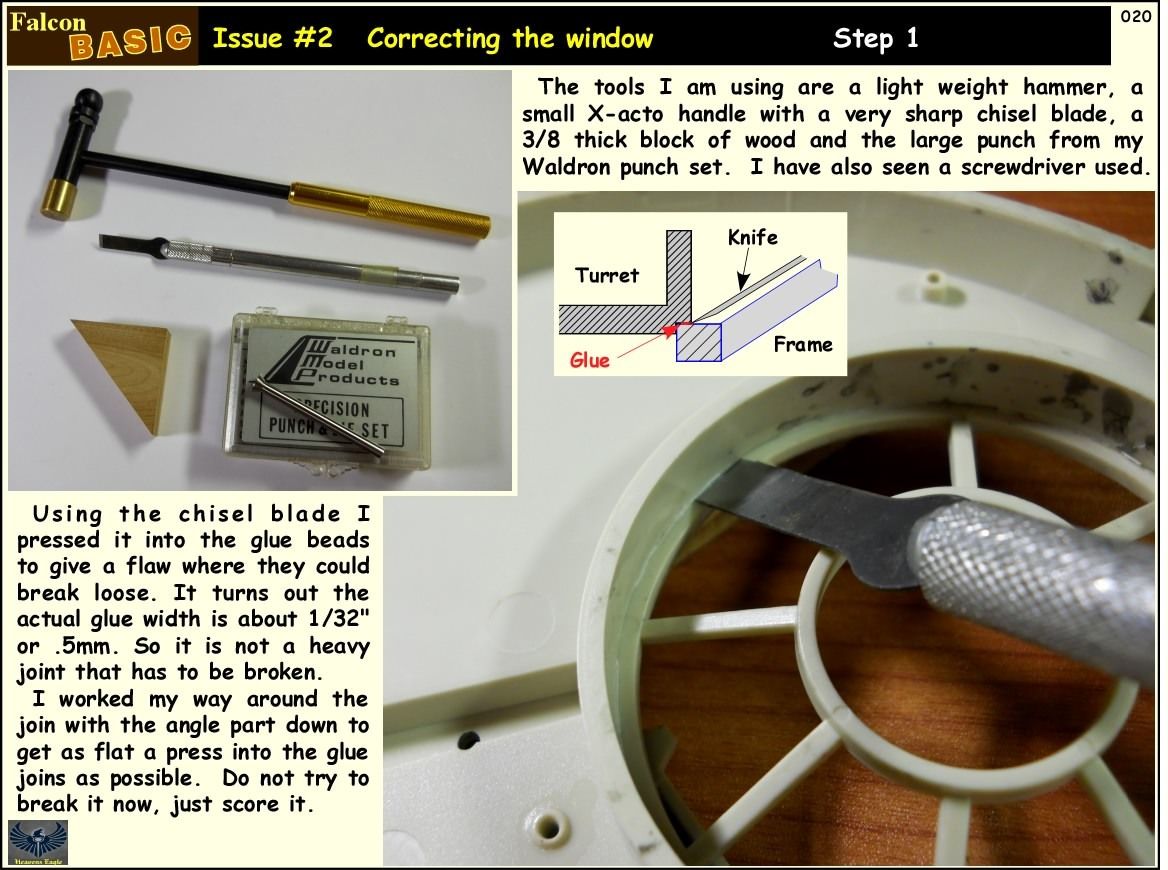

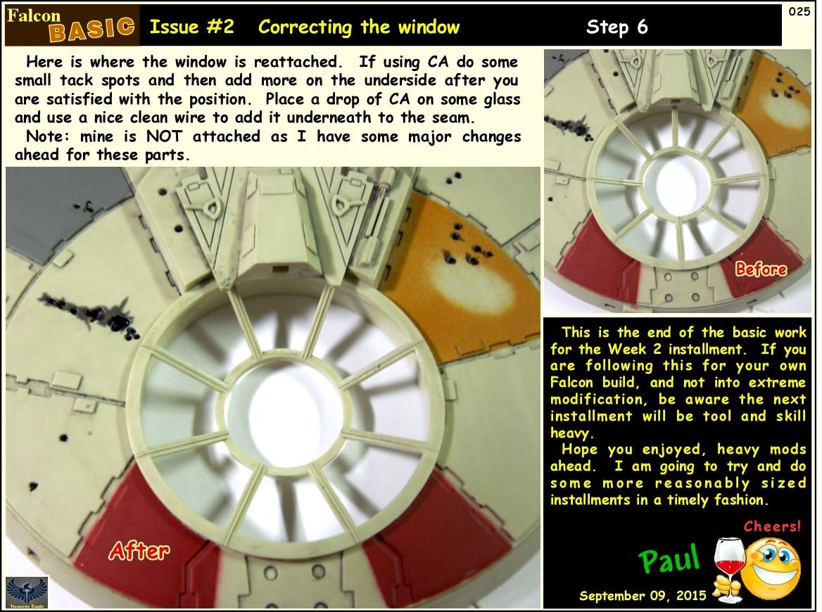

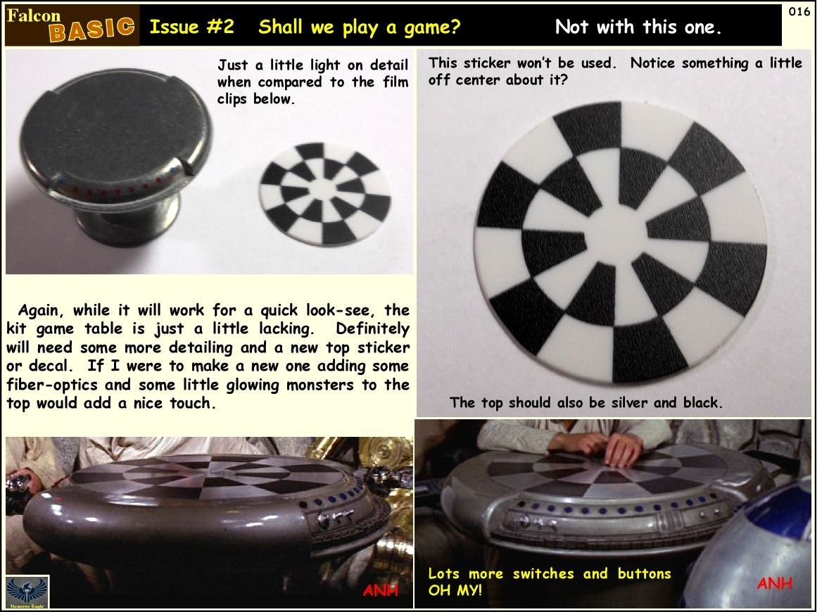

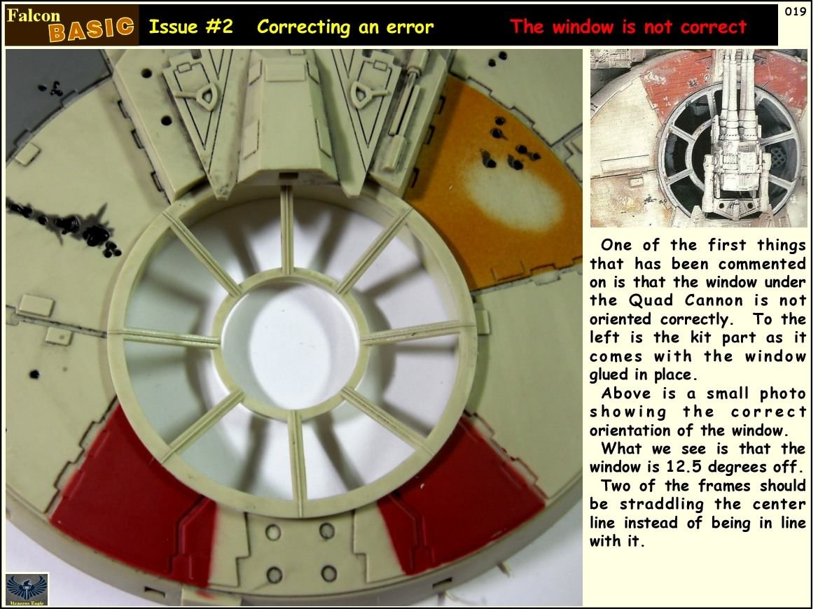

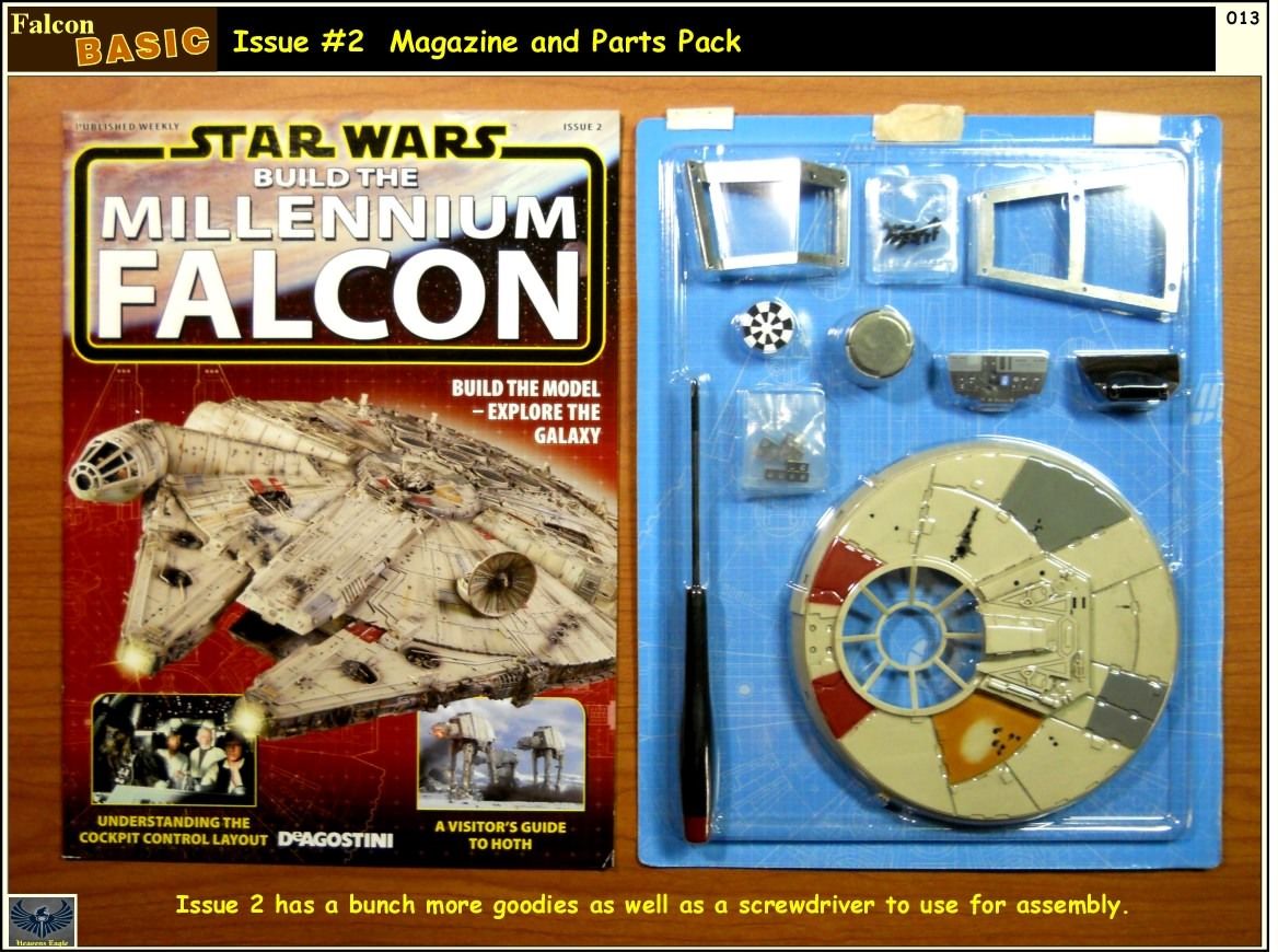

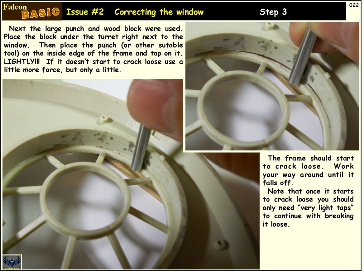

Here is the Week 2 "Bassic" installment. I will be posting an additional "EXTREME" edition here which will have all the "real" work. :tomato
That section isn't up to posting yet (still working on the part) But hopefully I should have something more in a few days.
So here is the "basic" for week 2.
Falcon-Basic-013.jpg~original
Falcon-Basic-014.jpg~original
Falcon-Basic-015.jpg~original
Falcon-Basic-016.jpg~original
Falcon-Basic-017.jpg~original
Falcon-Basic-018.jpg~original
Falcon-Basic-019.jpg~original
Falcon-Basic-020.jpg~original
Falcon-Basic-021.jpg~original
Falcon-Basic-022.jpg~original
Falcon-Basic-023.jpg~original
Falcon-Basic-024.jpg~original
Falcon-Basic-025.jpg~original
Hope you liked it, as always if you have any questions, feel free to ask.
(and no Dave the video isn't uploaded yet)
REVISION
Updated some of the photos and added in a missing item in the middle of the list. Nothing major changed.
