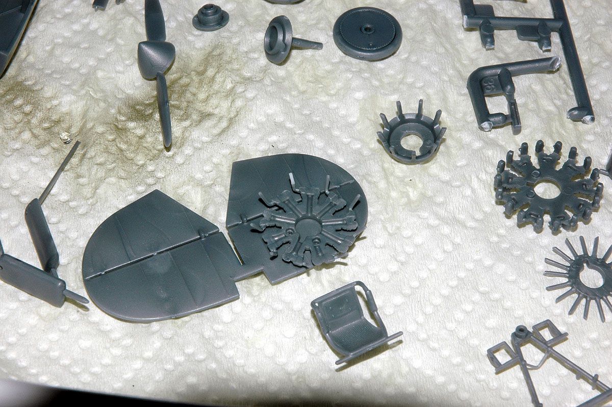

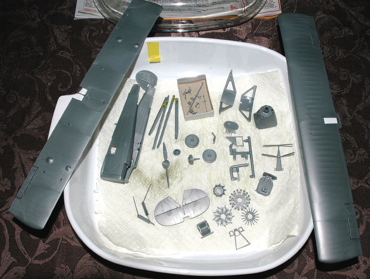

Here are most the parts cut and cleaned, there are quite a few join lines that need to be tidied up before anything else.
I found that one of the exhaust pipes were broken, unfortunately it was not in the sealed bag
So used a small piece of .025'' plastic rod and then carefully drilled all the ends out.
Note the pointed spinner.

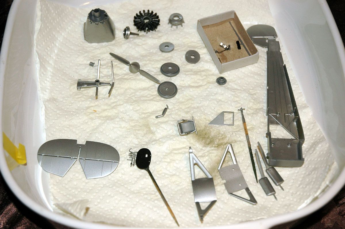

Some progress a last!
Since deciding to use a rattlecan (Tamiya A/S 12) for the silver finish I decided to spray all the parts before construction
giving me a bit more control with the paint on certain areas of this kit.
I intend to add the top and bottom fuse ribs so I can easily respray these once the fuse is together.
I used Tamiya T/S 17 for the rear cowling as it is a very smooth hi gloss specifically for the cowling decals later on.

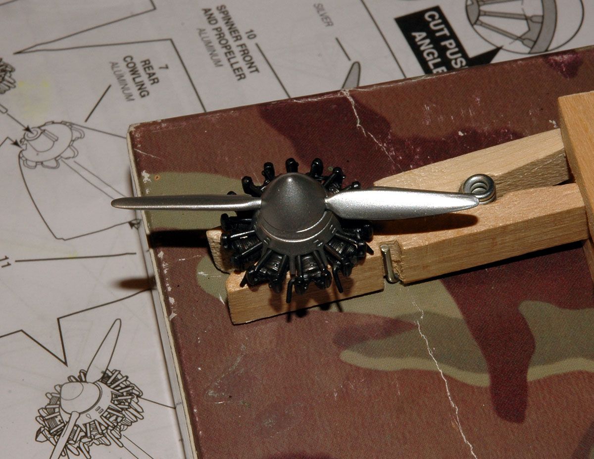

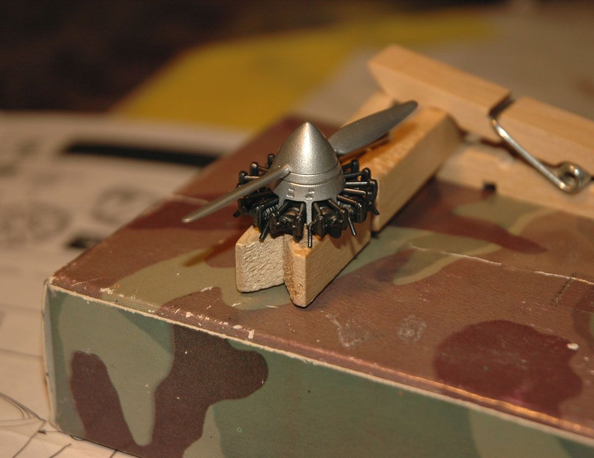

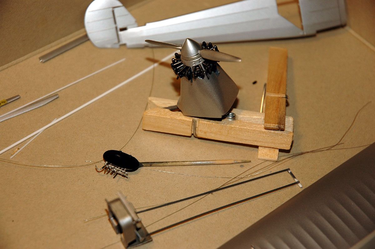

front cowling spinner bak and prop just dry fitted to the completed engine.
The pushrod part is very breakable - much caution is required here cutting from the sprue.
Also the pushrods are way to thick and not really round, reducing the size of these results in breaking them very easily.
One option would be to cut them all off and add some proper round plastic rod, I almost went this way
but persevered with them and got them looking respectable - after much cursing!
dry fitted to the rear cowling.
I intend to add hoses to the fuel line tank lines under the IP using stripped computer wire shields, also adding the fine wire
from these for various control cables.
Have added some of the fine wire to the levers and used .020'' rod to simulate the rudder cables

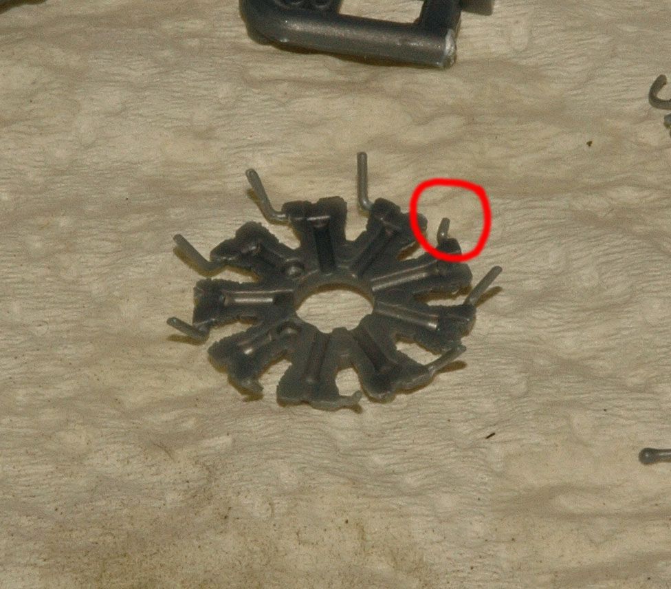

Ok engine buffs, can you tell me the reason why one of the exhaust pipes blows into the carburettor on this engine.
(as I found tonight after dry fitting the carb and engine......)
on the kit there is a pipe on the carb that goes straight into that ( as I thought broken/missing) exhaust pipe on the
engine.

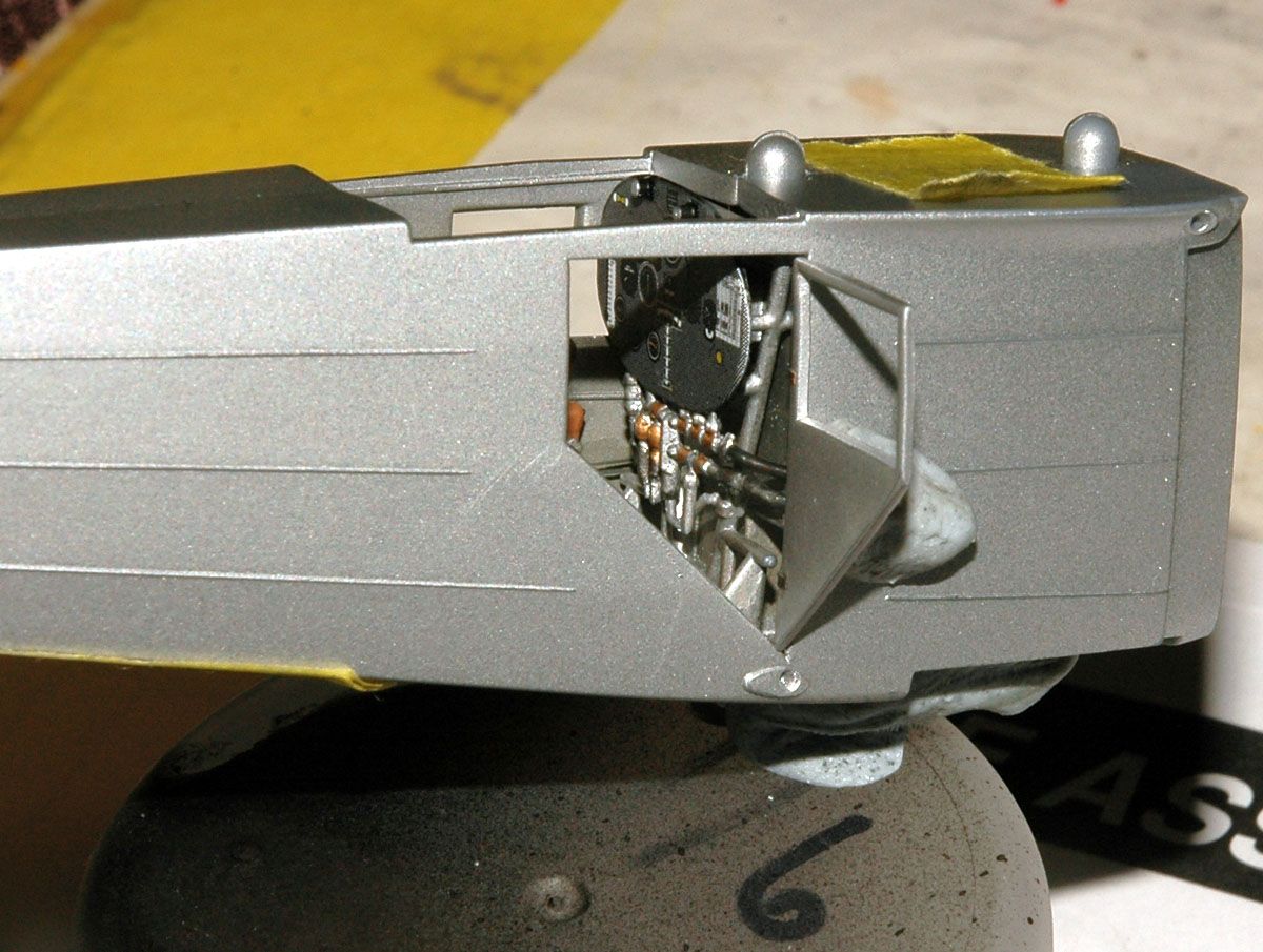

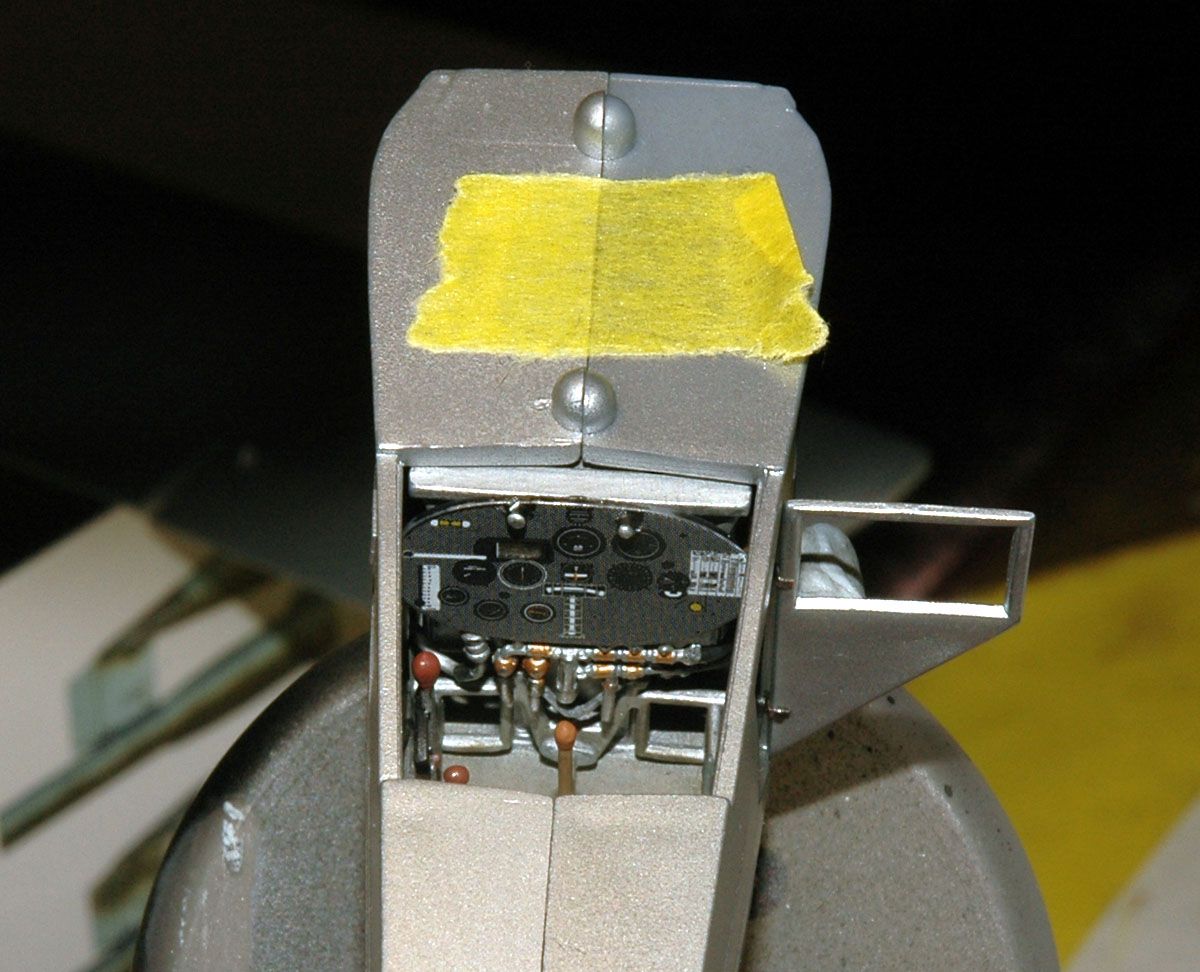

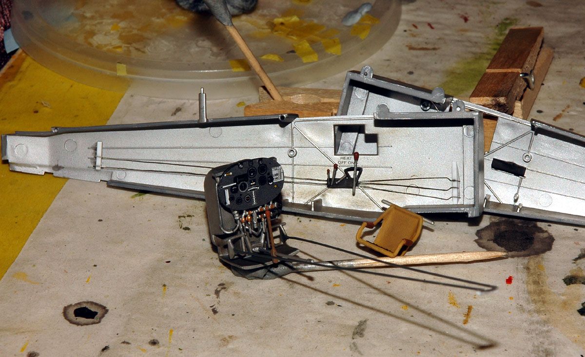

When I dry fitted the IP to the bracket in the pit on this kit, the IP seemed to protrude very far forward into the pit, if this was the case on the real aircraft I have doubts that Lindy would of actually been able to get in the door!
found this pic
note the position in relation to the ''L'' shape of the port window
which shows the IP set much more into the pit fueltank.
So I ground down the mounting brackets and the rather large IP mounting block to get this result, dry fitted as per kit, the IP covered a good 1/3rd of the door entry space
added two hinges to the door
and a final look at the parts before this is all buttoned up, the seat was called to be painted all aluminium, in all the pics and even the classic movie it showed a wicker seat
now I have to wait until tomorrow to close this up as I forgot to Future the windows ( drying now!!)before I started this kit :bang head
