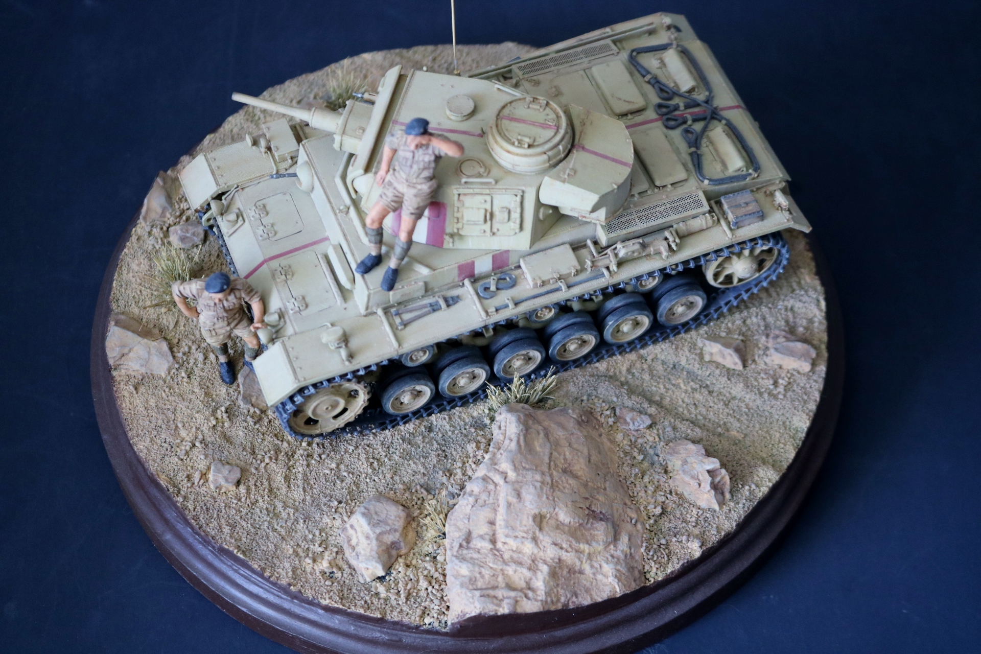

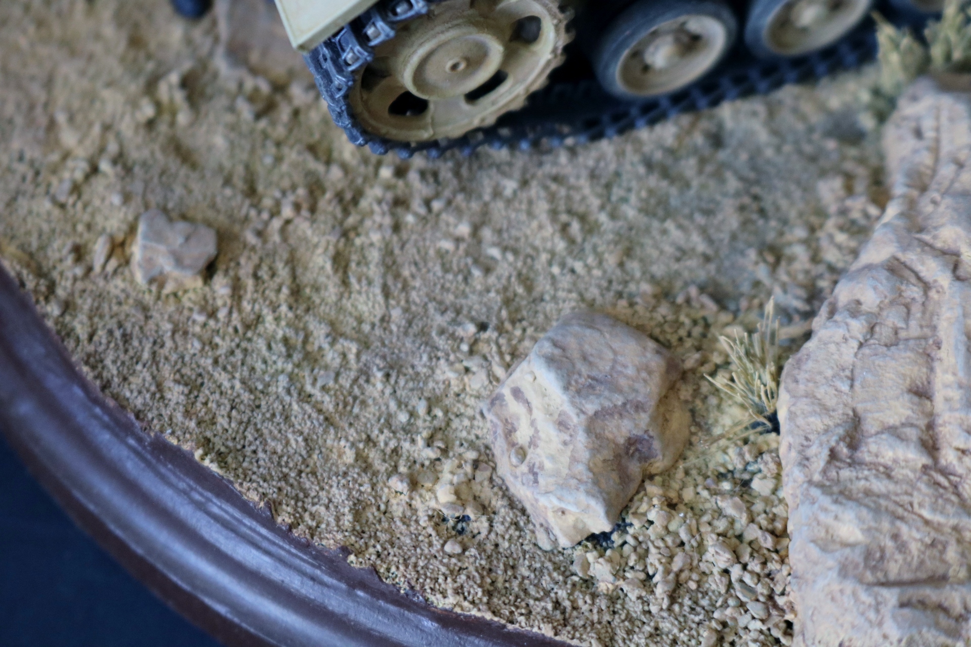

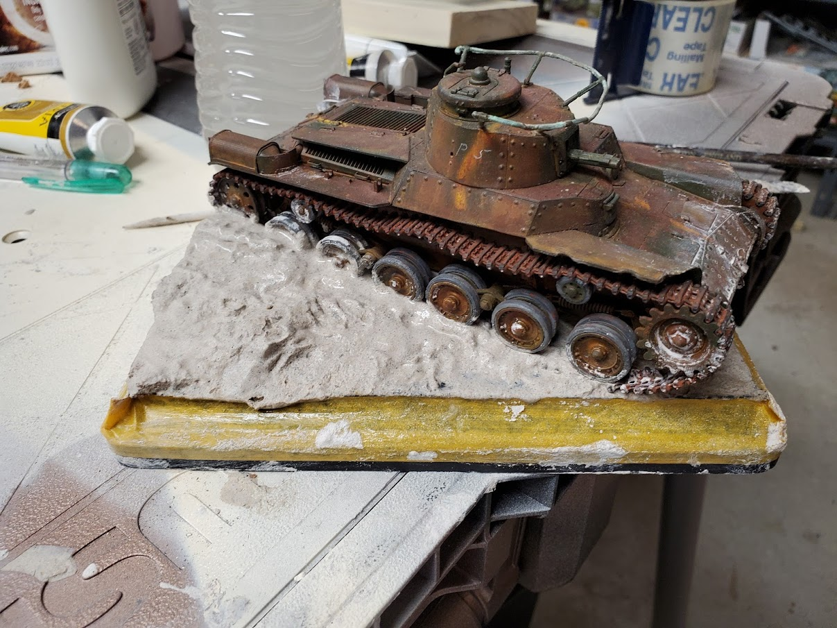

Last North Africa base I did. The finest sand is either fine or extra fine acrylic paste, smaller stones are kitty litter (unused, non-clumping), medium stones from the garden and the largest is a plaster cast using premade model railroad molds.
