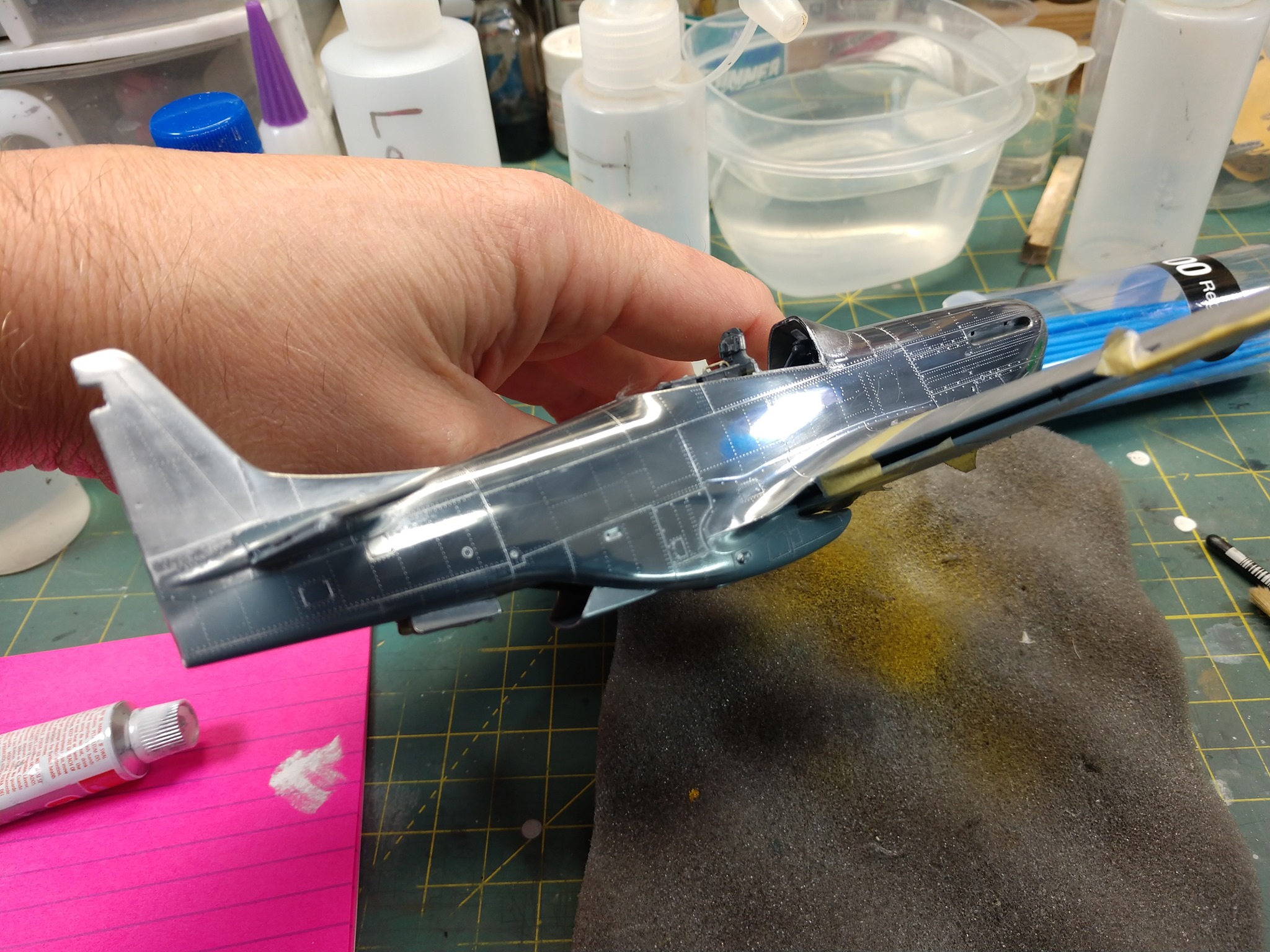

Preparations is the key for achieving a nice NMF, the model must be free of any debris, lint or fuzz. The plastics need to be free of any defect, scratches and smooth as possible before we apply the paints used for the NMF. For sanding I like to use these products for my prep. I really like using the Infini stuff and the 4000 polish gives a great smooth finish. Don't forget you can use some of Tamiya polishing compound to really get a smooth finish.
I use the compound after I apply my base color which we will talk about now.

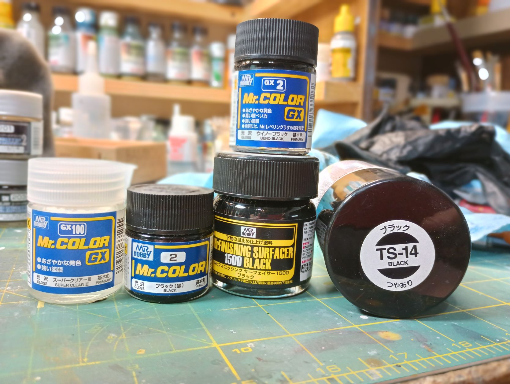

Black Base and Gloss base(don't mine the Mr. Finishing Surface 1500, that comes into play later)
The given is you need a very glossy black base coat so you can get that nice aluminum sheen. TS-14 must be decanted be for use and set aside to let all the gases evaporate or you will end up with a mess if you shake it one decanted. I rarely use it. I really love the GX2 Ueno Black, this will get a you a really deep Glossy finish. Once dry you can go back and mist with Mr. Color Level Thinner and it will look like a mirror. The hardest part out of all this is keeping the model free of crap once you hit it with the black gloss. I have read were some have a big Tupper wear box they will place the model in do cure to try and keep it lint free. Good luck as I have found it nearly impossible to keep free of that stuff. That's were the sanding pads, micro mesh and polishing compound come in.
The Gx100 is a very nice gloss coat and you can use for your experimentation. I can be applied over the black gloss but find it not necessary if you use the GX2 and misted with the Leveling Thinner.

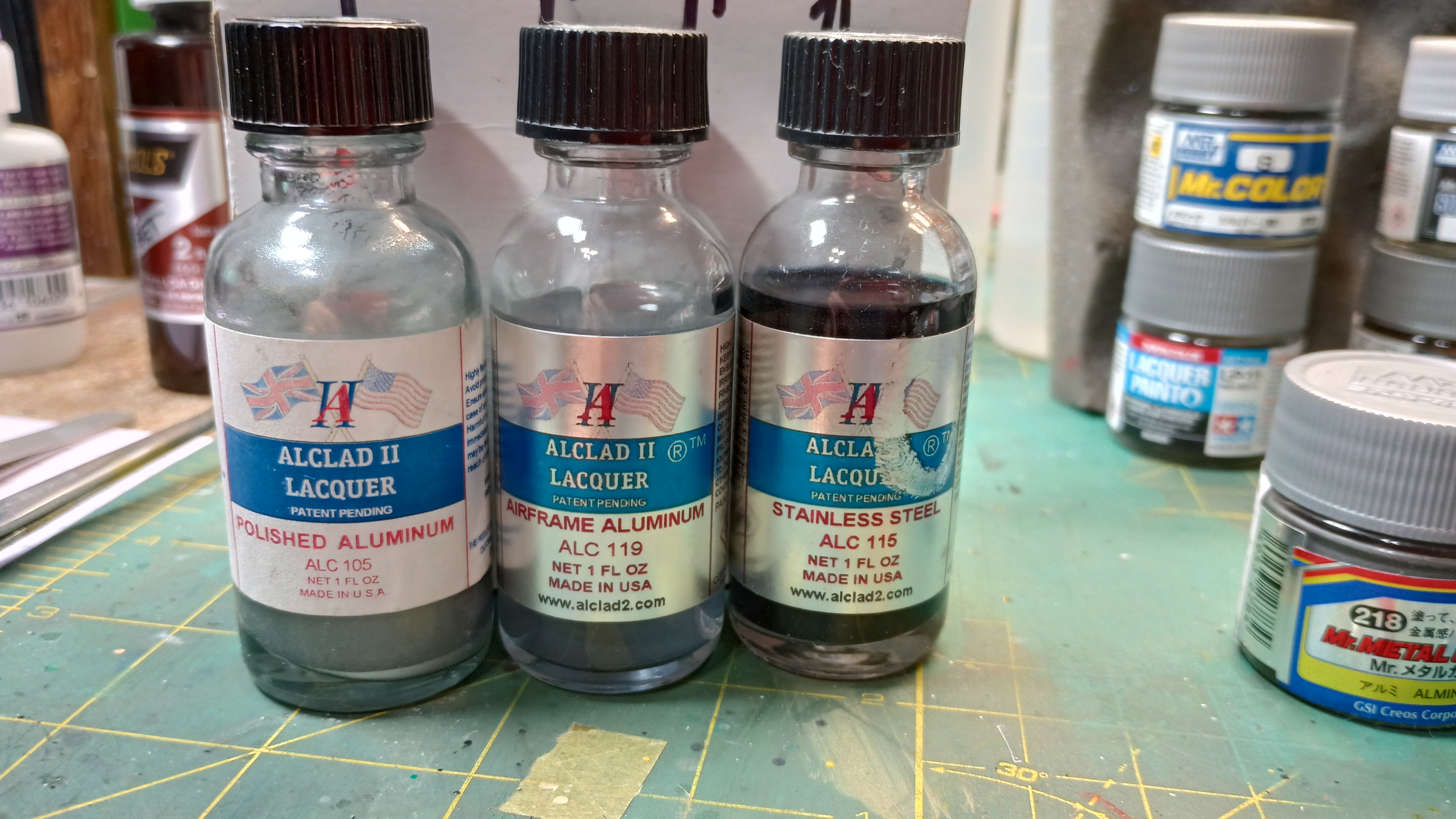

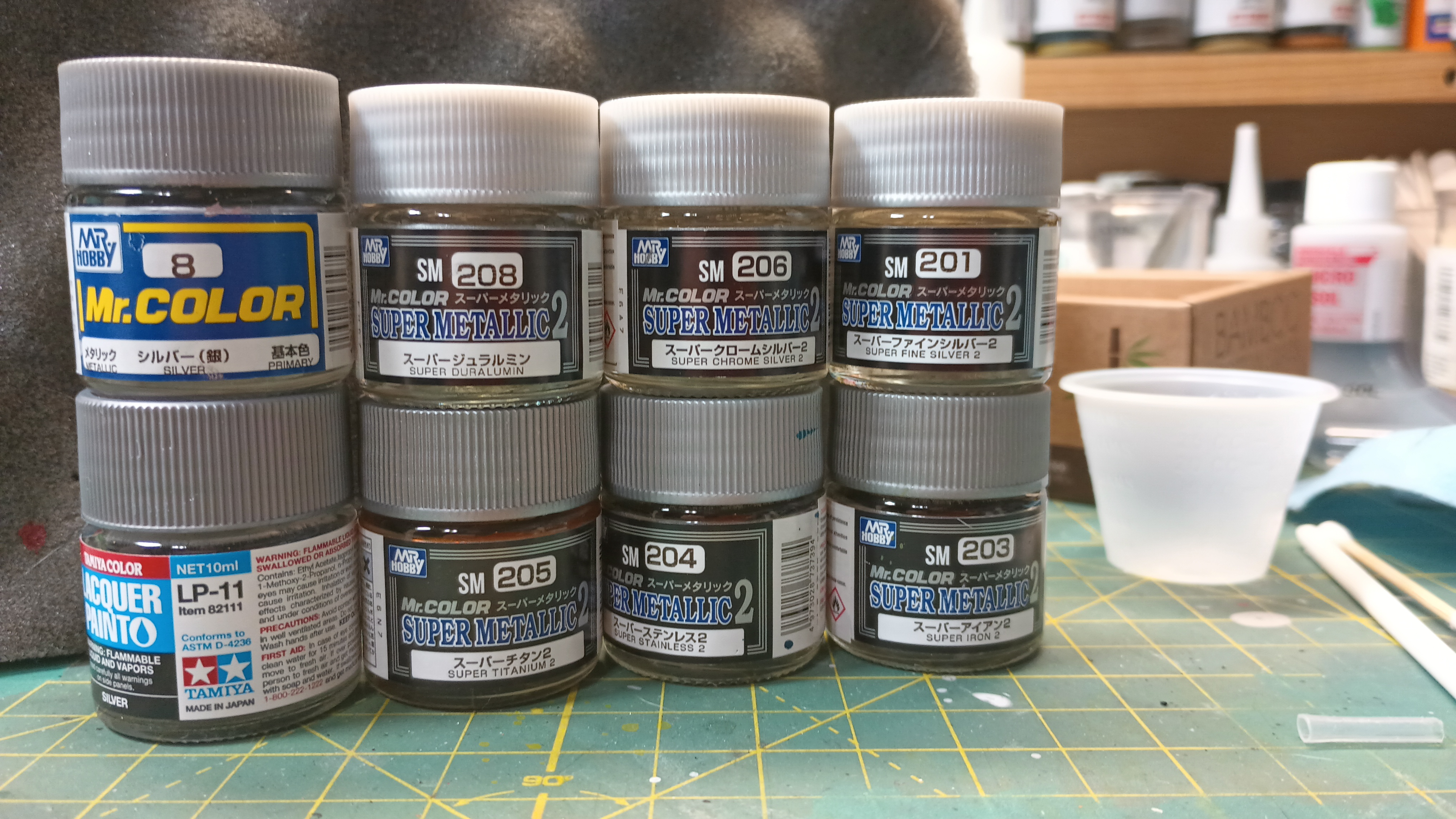

Time for the colors used for my NMF. There are a lot out there but I only use a few. I will use Alclad, Tamiya, of Mr. Color
When I was doing my NMF the traditionally way I always used the 3 Alcalds shown above. Under a black gloss base, they give off a very vice sheen. My favorite out of the 3 is the Airframe Aluminum. Polished Aluminum is great but does not like masking tape on top. Stainless Steel will give you a good result of NMF as well.
I have since switched to the Super Metallic as I find them more resilient. For a nice metallic sheen, use Super Chrome Silver, Super Stainless, or Super Duralumin. The duralumin is not quit as bright but give a good luster.
Mr. Color H8(C8) Silver is a great color for Aluminum dope, same goes for Tamiya LP-11 Silver. I will use those 2 mail colors on my Mustang build for the Aluminum Lacquer coat where is was applied from the factory.
I use the Super Iron on the panel that covers the exhaust on the Mustang. The Super Fine Silver is also a great color that is more in line LP-11Silver and H8 Silver.
These are the colors used for your everyday NMF use and one that I used for years.

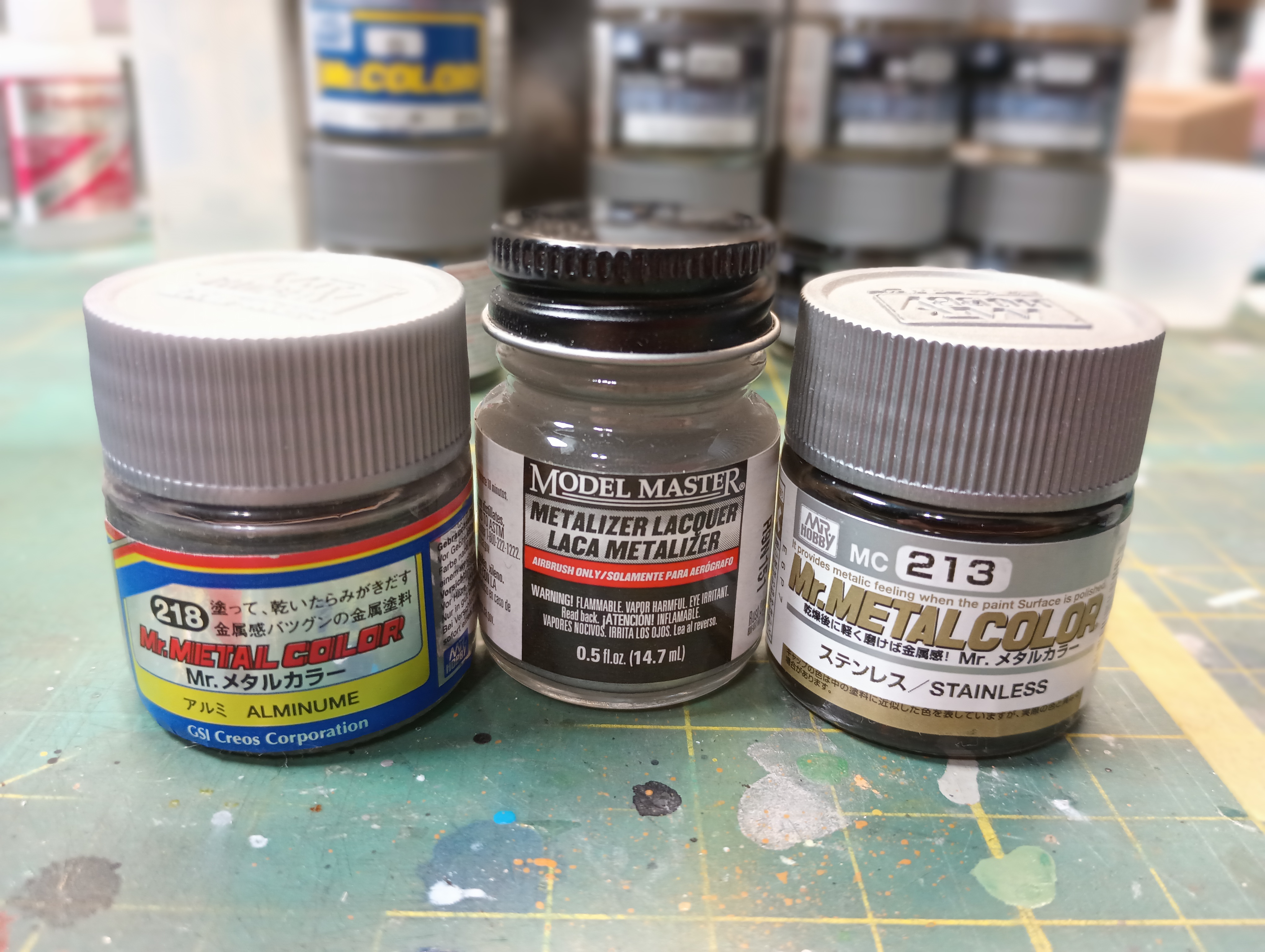

I will use long gone Model Master Aluminum Metalizer and Mr. Metal Colors range of Metalizers.

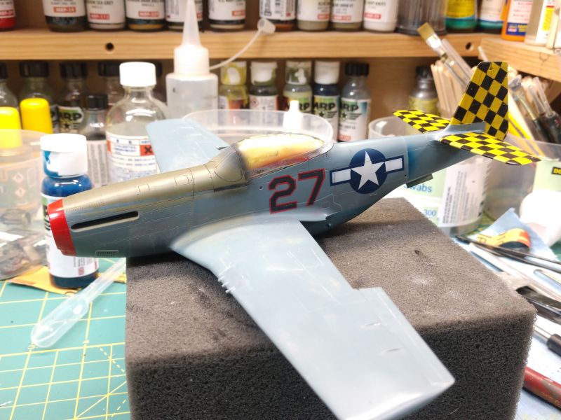

Once my surface is ready I will spray the whole model with Mr. Surfacer 1500 black and this is where is gets complicated. You must do all your primary colors first as they will not stick to the NMF. So I will spray the antiglare panel paint my Star and Bars and and what ever else needs primary paint scheme. Will look something like this.
Revell 1/32nd P-51D
Eduard 1/48th P-51D

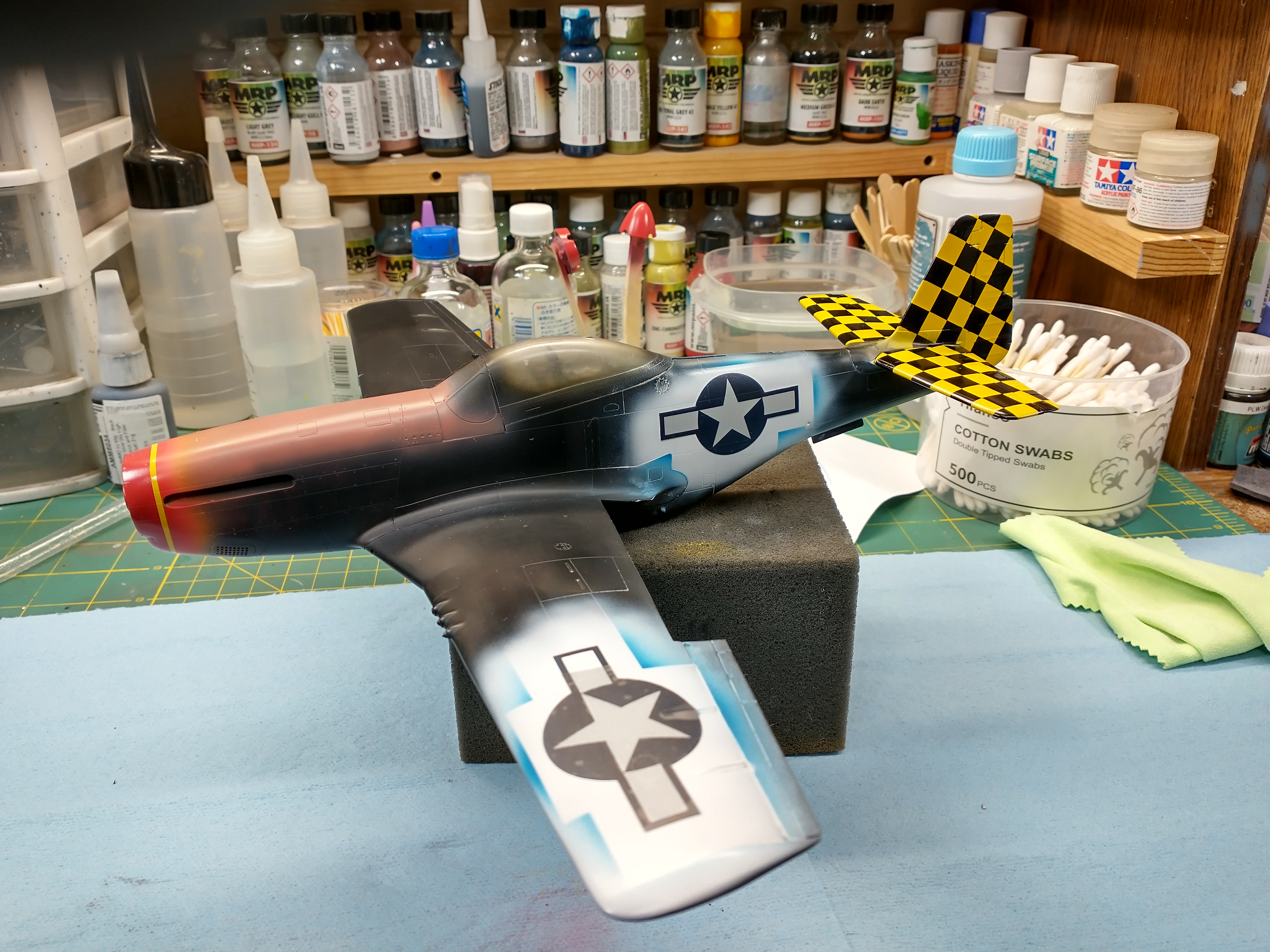

Once done, you will need to mask off everything. Keep in mind that I make my own mask and have the ability to make the covers for all my work. If just using decals, you will still need to paint your primary colors, and mask those, do the NMF and then apply your decals as the last stage.

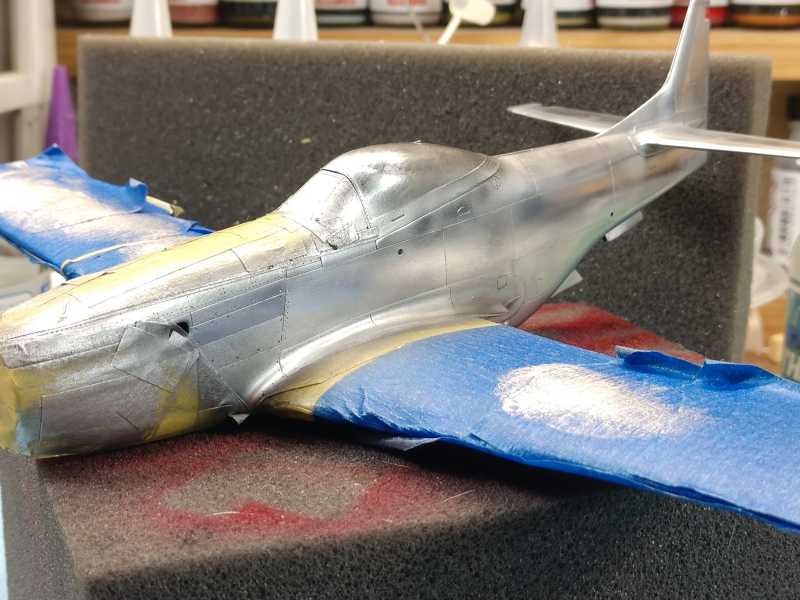

Once all is masked there is where you start your dry brushing of the metalizer. It is a very complicated and tricky process but I find way more rewarding and more authentic look. I will supply a video that may give you a better understanding.

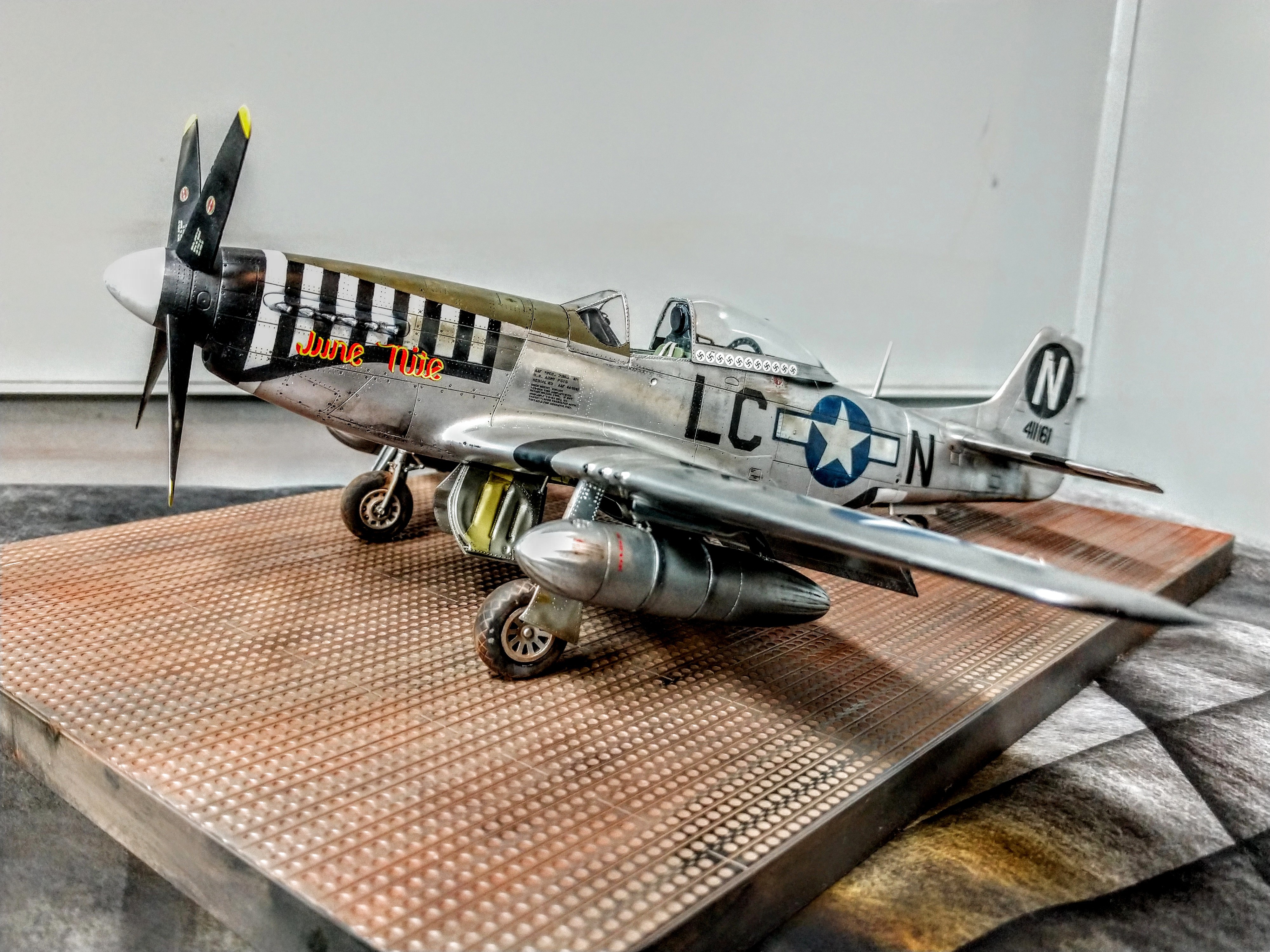

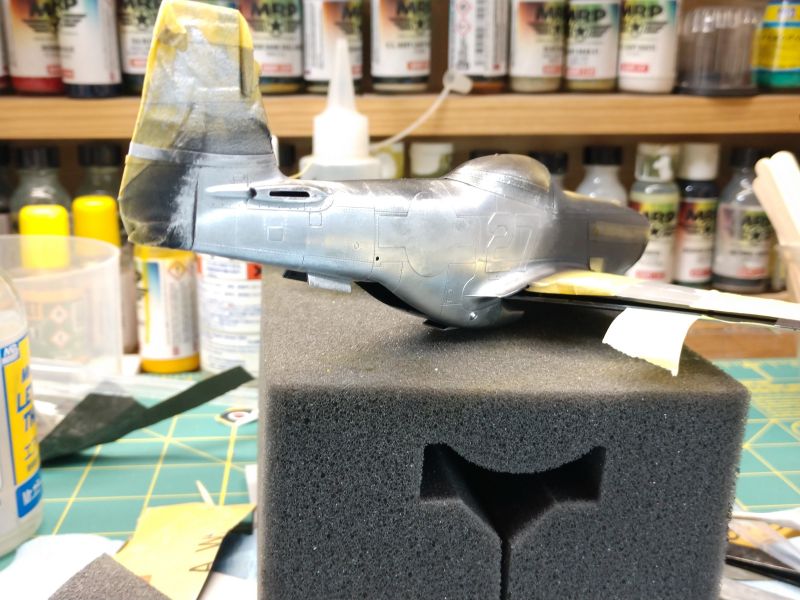

Dry bushing it will look something like this.
And once all masked are pulled when finished.

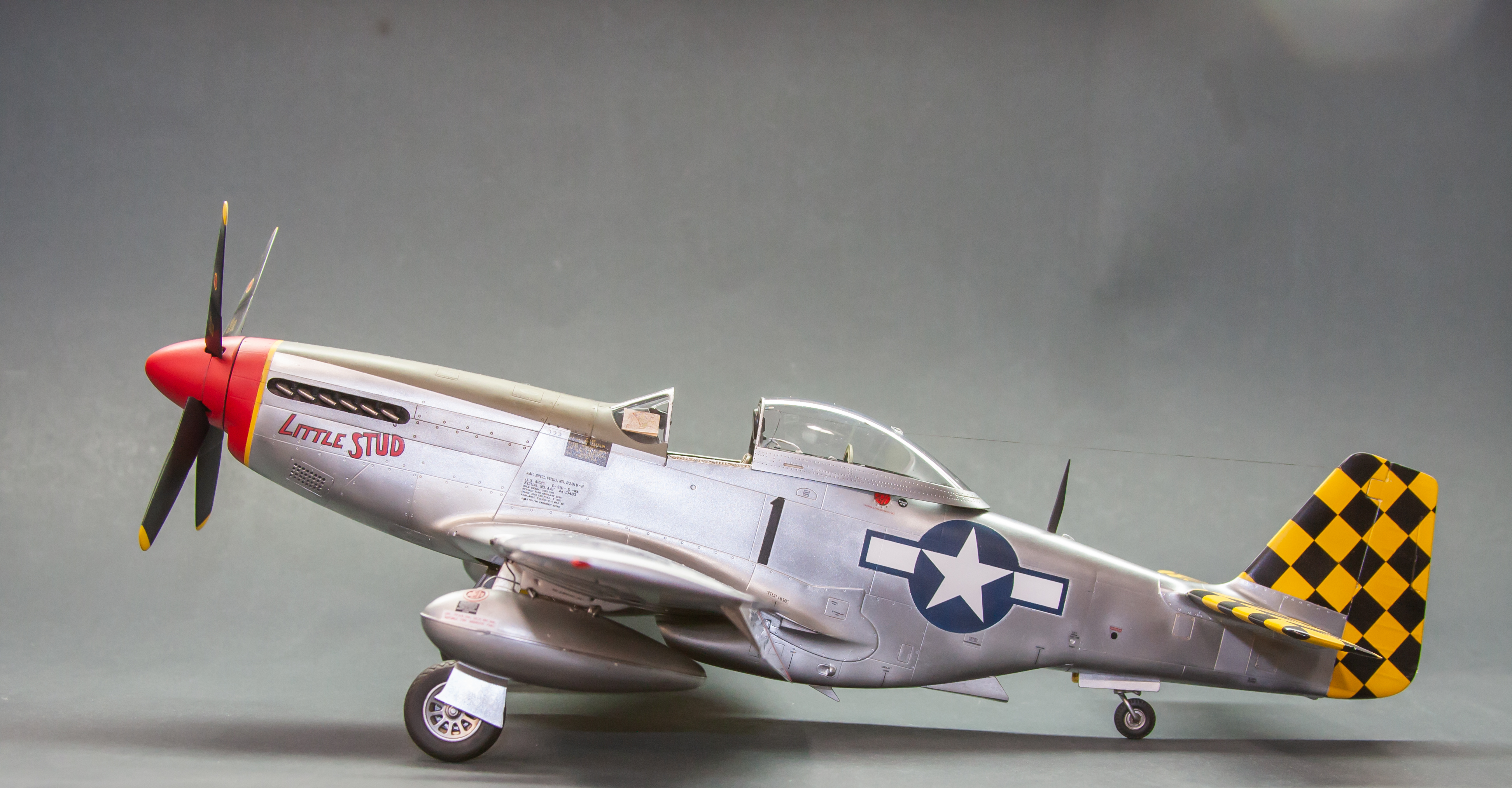

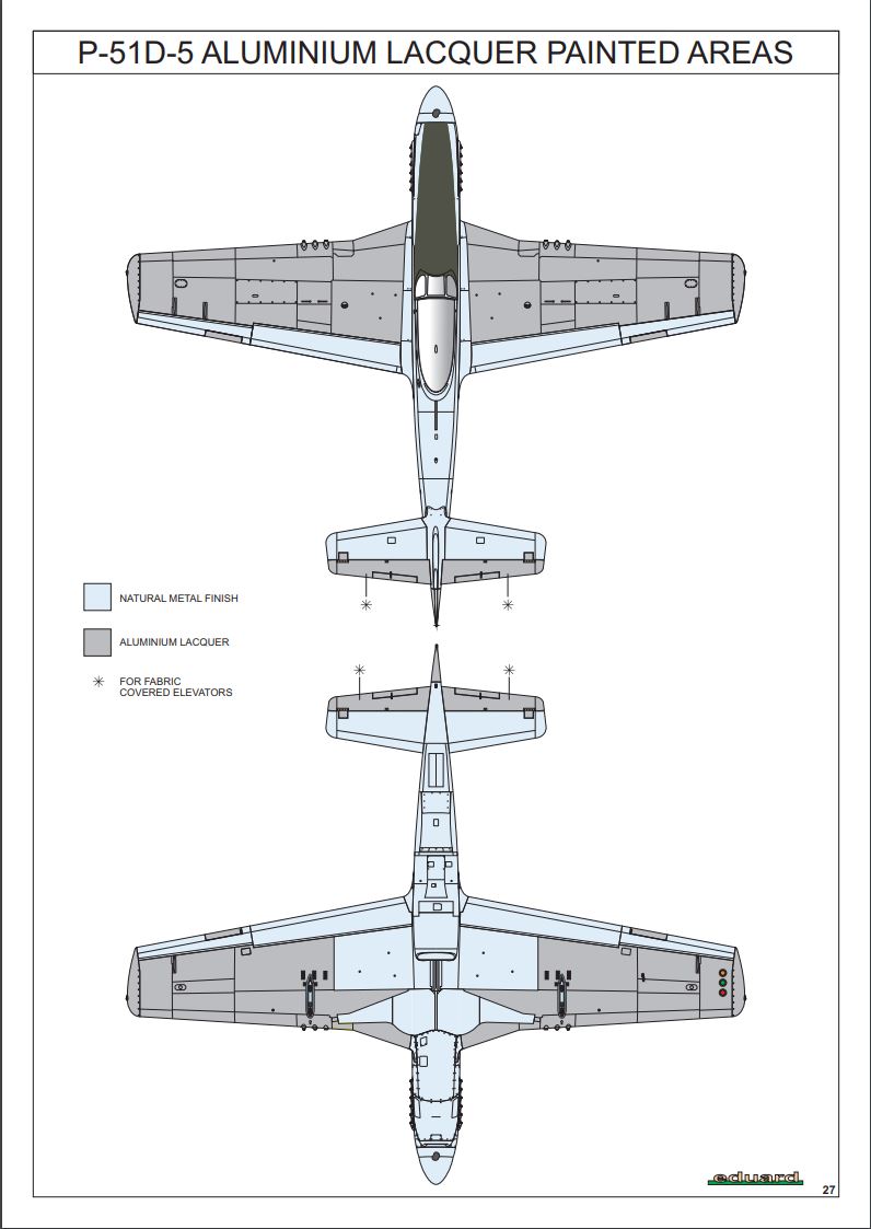

So I will apply the NMF in the arears as shown here by Eduard and the silver lacquered where shown.

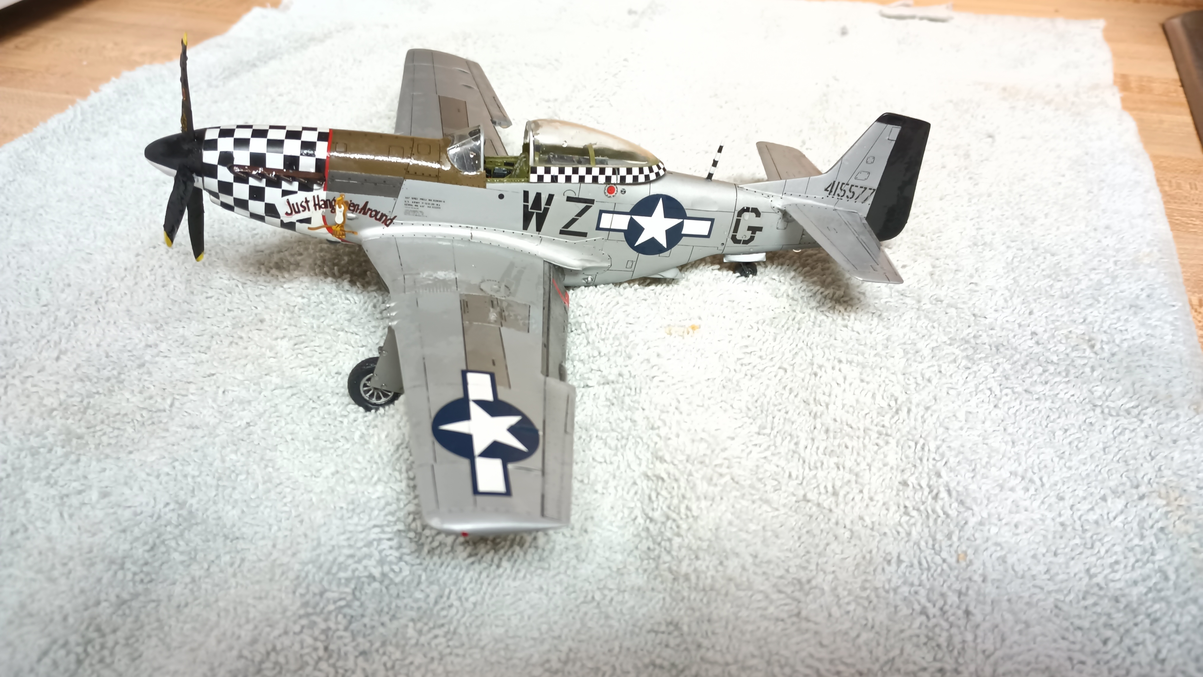

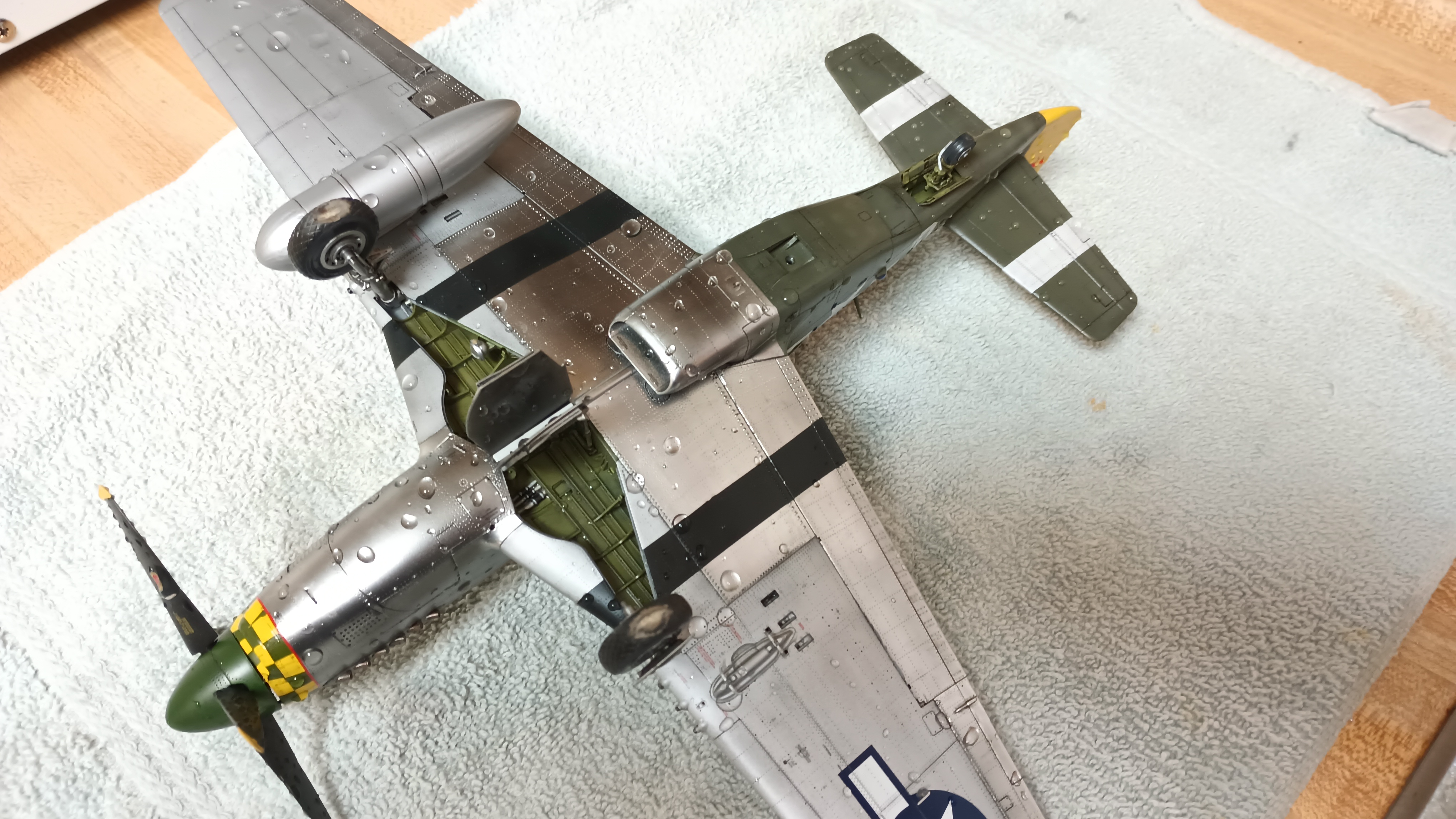

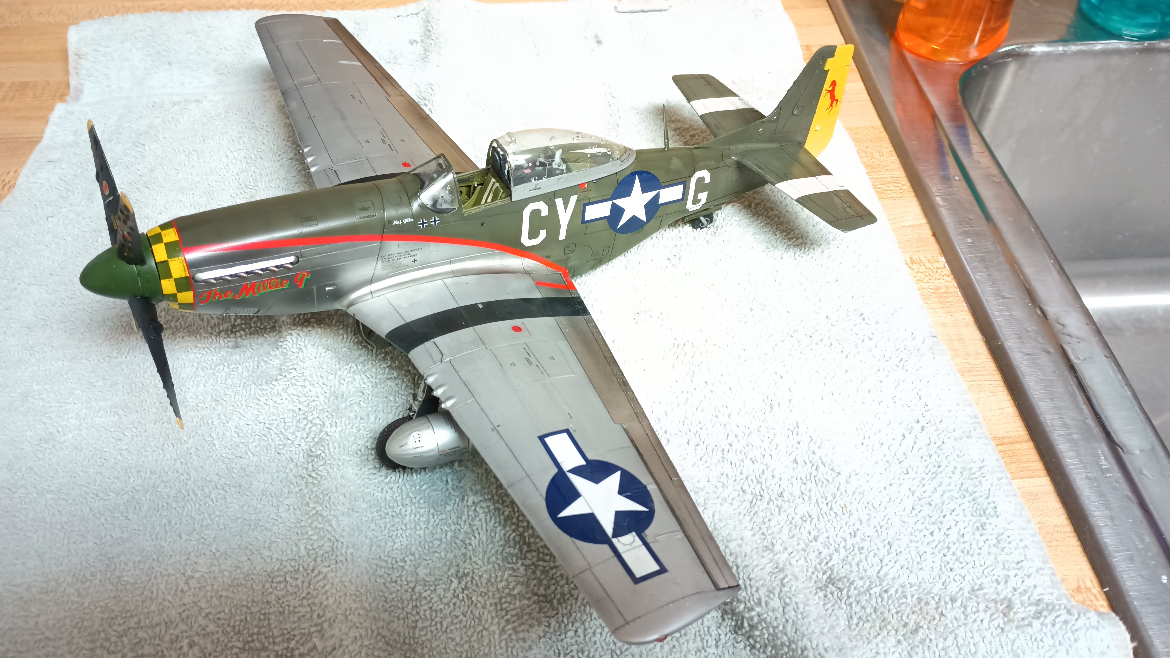

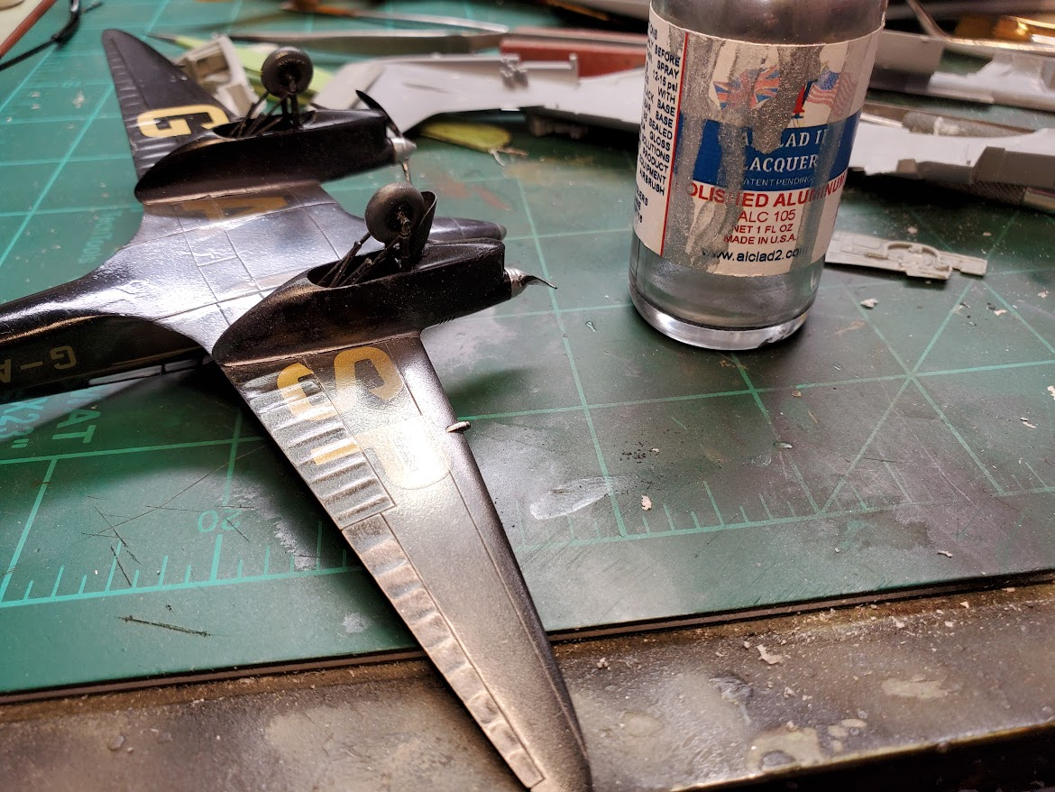

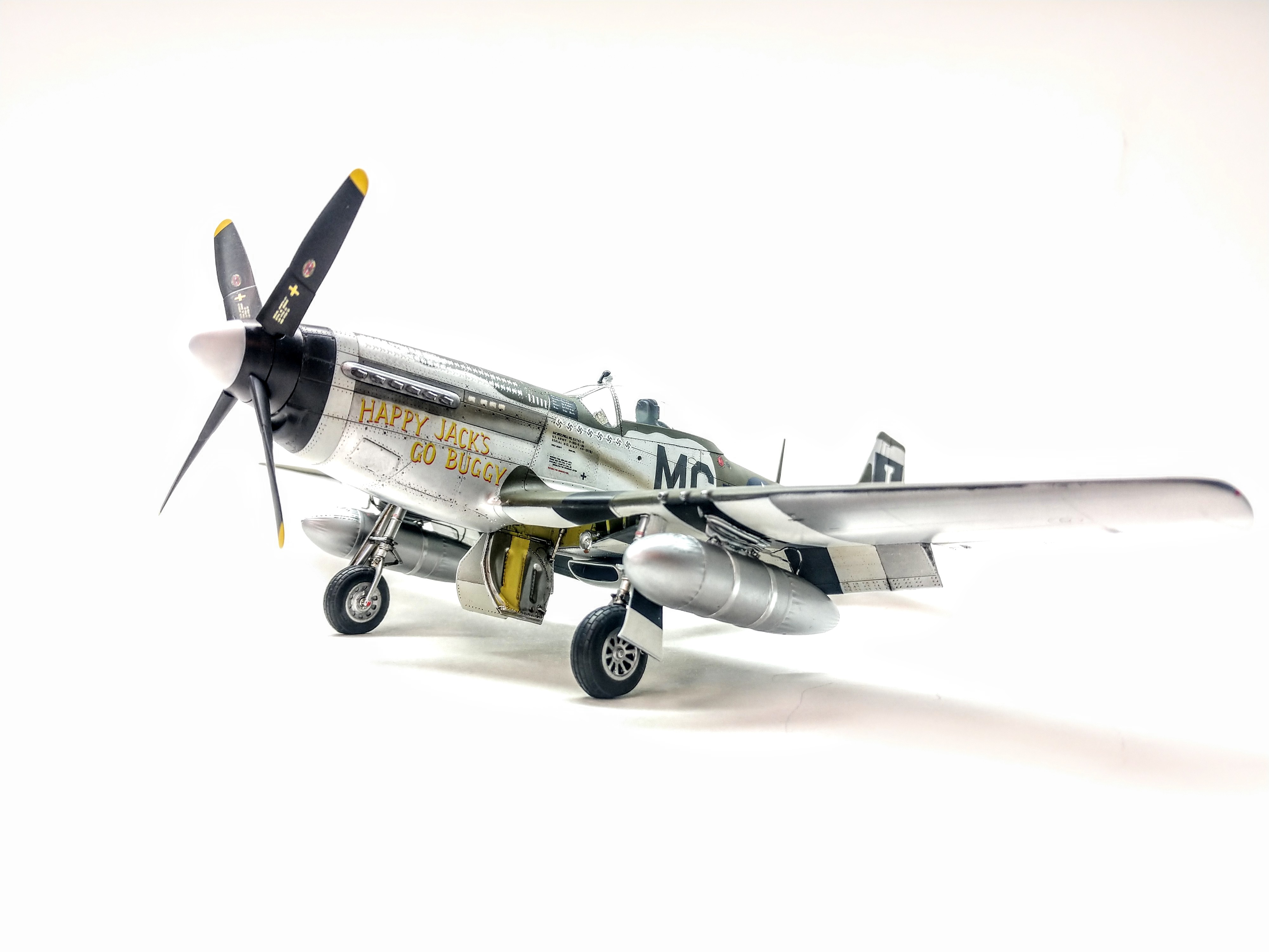

Here are some build I did way back when with Alclad. Sorry for the wetness as I had to rinse them off as they were very dusty.
Both of these were Tamiya 1/32nd P-51D kits.

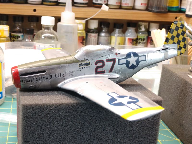

Big Beautiful Doll was done using Alclad Stainless Steel over a gloss black base.
The Millie G was painted using Alclad Airframe Aluminum. Same Gloss black base. Wings I used Mr. Color H8 silver.

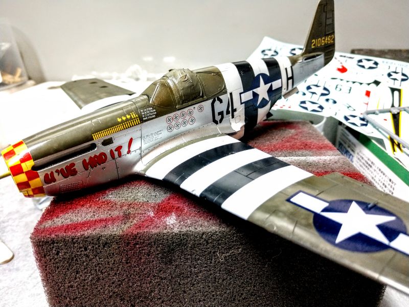

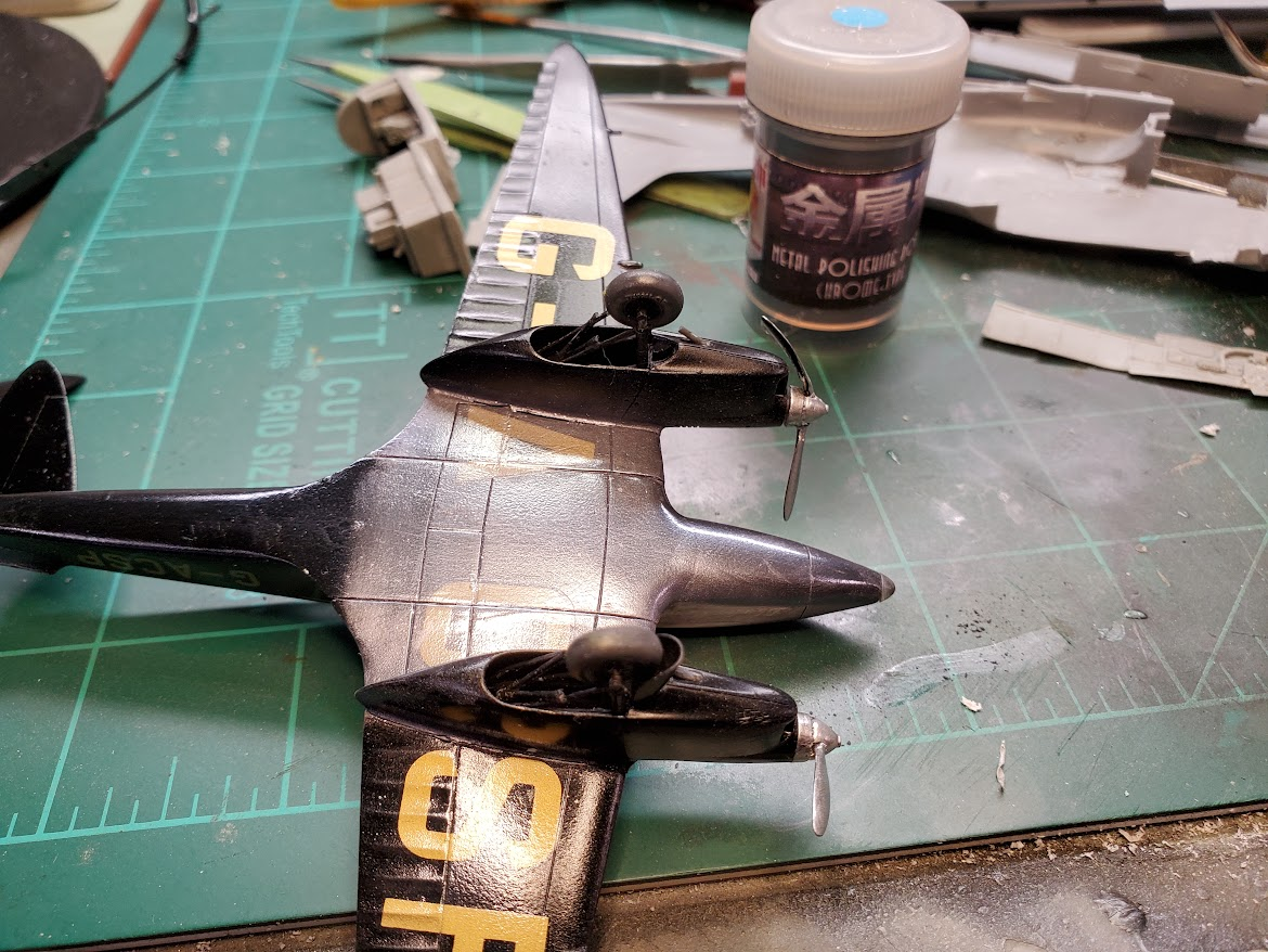

Tamiya 1/48th P-51 B/C. This one was done using Mr. Color Super Metalic Chrome.
This was a Tamiya 1/48th I did long time ago as well before I really did research on the P-51D. I painted the ammo door covers a different color in reality it was all one color. The main fuselage color was Alcade Semi-Matt Aluminum. Gave it a nice different look.

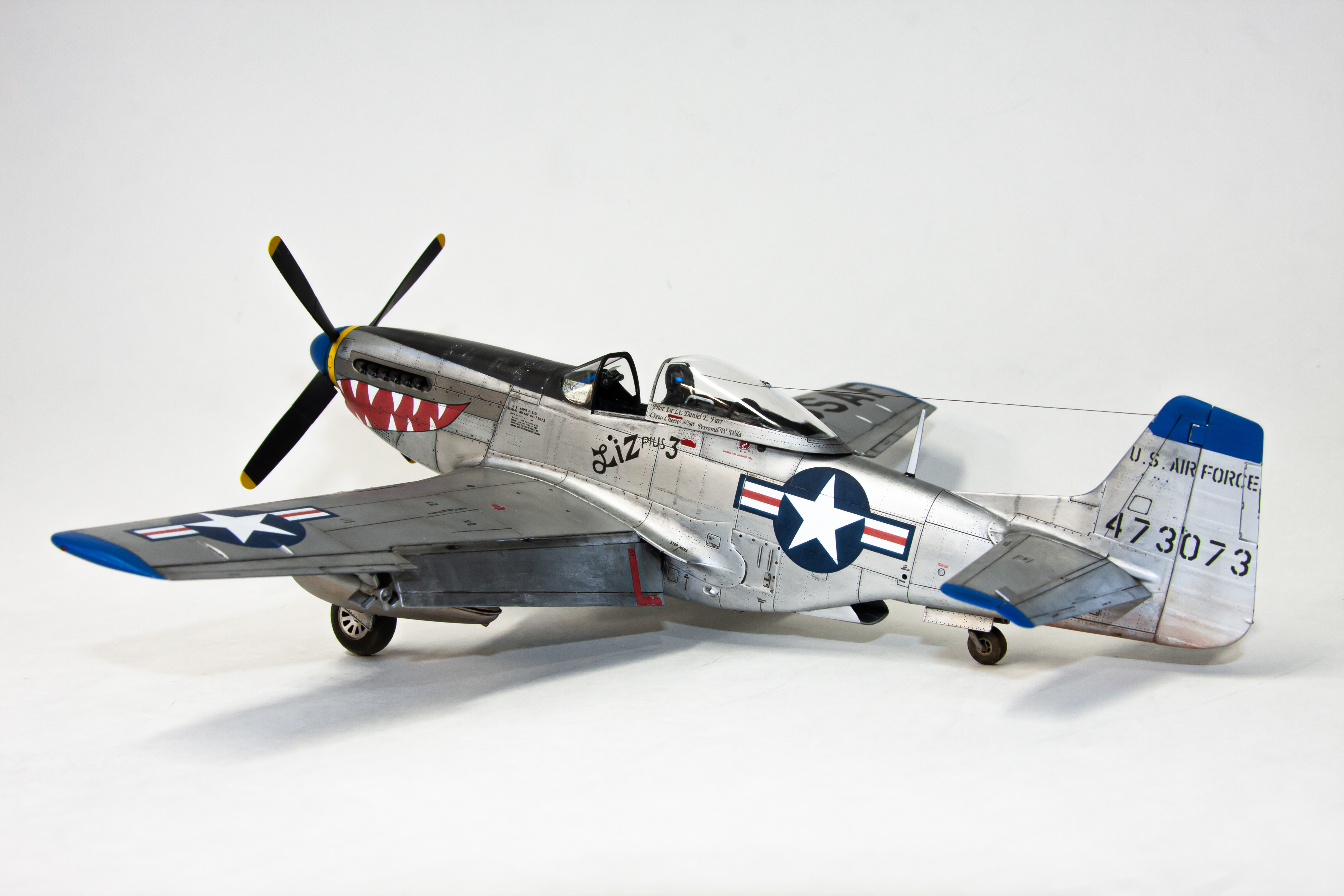

One last product you could use is call RubNBuff and you would get something that may look like this. Airshow quality.
I never did pursue this as it was not the look I was going for at that time. My revisit it at some point.
