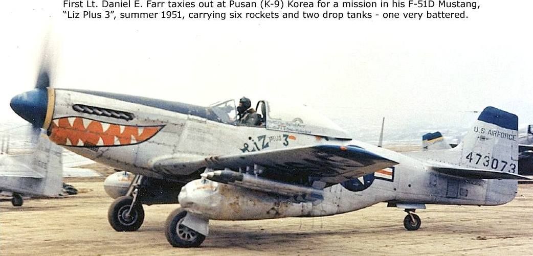

So I would like to try and replicate this photo with the beat up drop tank. Any ideas on making plastic look beat up? I tried submerging the drop tank in boiling water to push the front in but all it did was warp the whole tank.
Thinning from the inside and then a little heat? I've bent up barrels just with grinding but to get dents as deep as on the drop tank you'd have to build up the inside with epoxy first. It seems odd that you can't see the flange as you can on the right side tank.
From experience I can state that you never should use "boiling" water to adjust plastic. It will FUBAR every time. In this case in 1/48th you would have to use a dremel and a small cutter to grind the dents. Then smooth them and give a wash of solvent.
I thought the same thing as well about the flange when I first saw the picture. What do you make of that?
Can't remember which but I did one with dissimilar tanks per the photo I based it on. Too bad there's not another shot of this AC.
