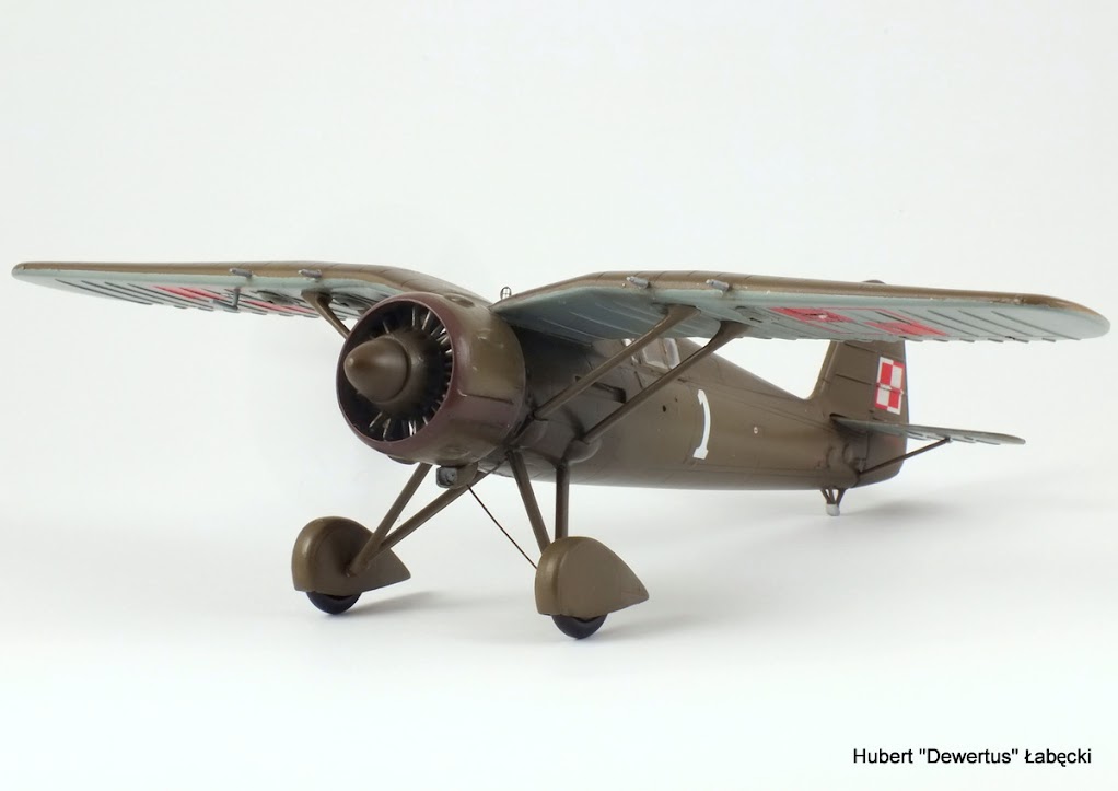

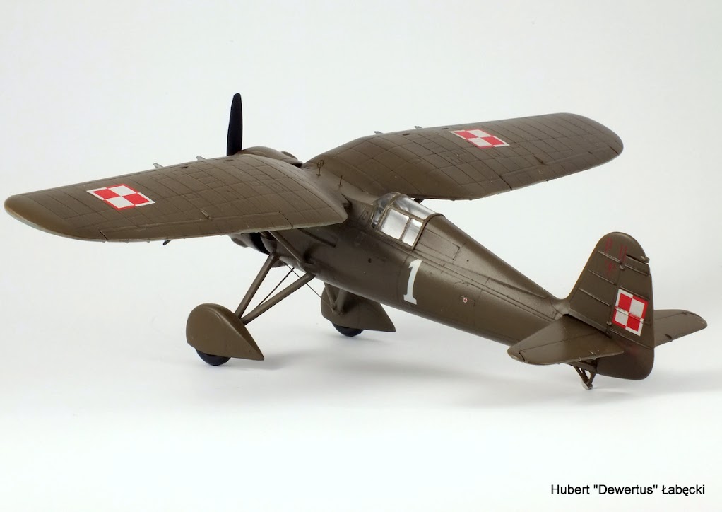

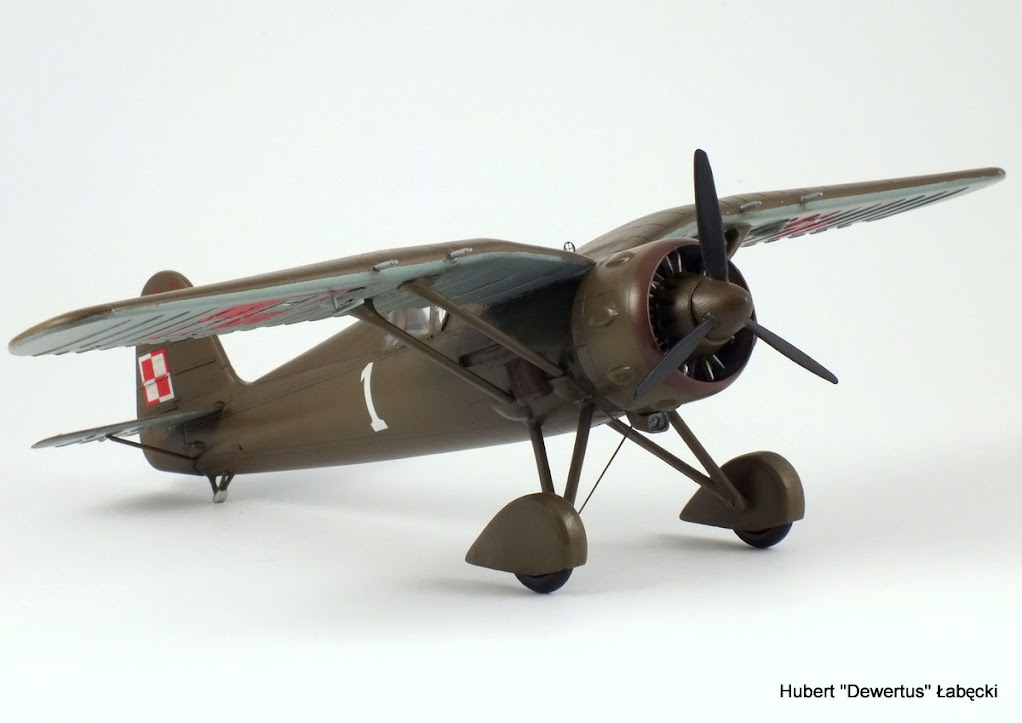

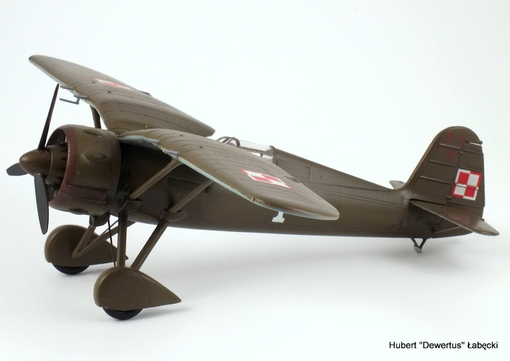

Based on the Mirage 1/48 PZL P.24F I try to build a model of one the least known aircraft that not only actively participated in the fighting, but gained a victory over the Luftwaffe. Only one plane (prototype) of the last version of the famous P.11 took part in the fighting in 1939, and I hope that I can build a model ...
PZL P.11G "Kobuz"
Since last I had a lot of other activities I did not have the opportunity to "tinker" in the model, so, progress is rather unassuming ...

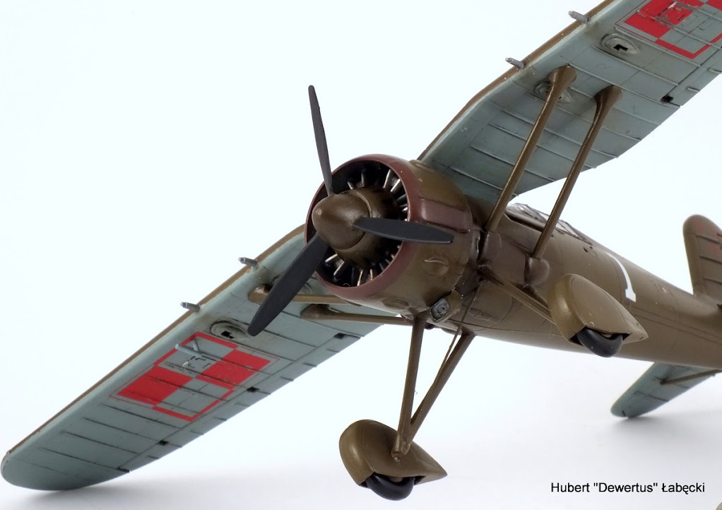

I only cut out in fuselage places for guns to made it similar to the P.11 (P.11g was a mix of P.11c and P.24). I also modify the engine and made the propeller from the remnants of the other models.
PZL P.11G "Kobuz"
It seems that the work "inside" is behind me and I was able to finish modifications of external elements that distinguish P.11G from P.11c and P.24 (propeller, exhaust and engine cover).
PZL P.11G "Kobuz"
"Kobuz" is ready for painting (just in case i secured model using Surfacer 500)

Man that looks great. Nice looking a/c too. I have one question, not knowing thiese a/c, but should the ring and bead sight be the a/c colour or something else? I wonder what ground visabilty was like. Looks like it would be nasty to taxi about.
James
a wonderful project. I still have the one that you sent me last year. I will have to start it some time soon.
I take it that this one didn't have the oil coolers on the side of the fuselage. Sweet build.
Tremendous job! I always thought that plane had some interesting sight-line issues. Still, it was one of the more successful aircraft in the early war years so it definitely was worth producing. I really love the job you did on this model. Well done.
