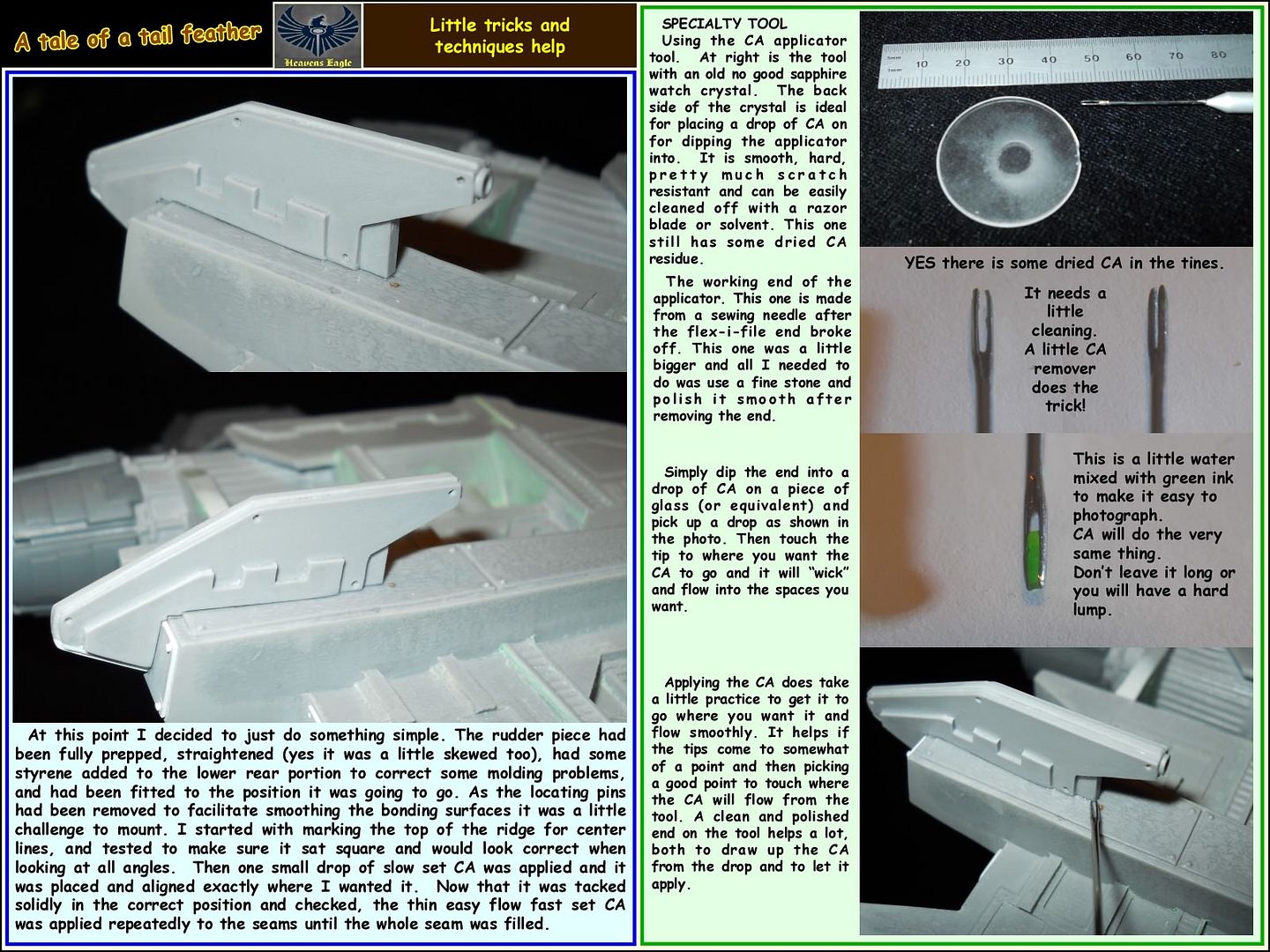

Another option, would be to slowly fill the gap using medium and fast set sperglue. I put a couple of drops on an old watch crystal (glass or sapphire) and using alarge applicator add the superglue to the gap till it fully fills up. Cappillary actio will draw it to the smallest gap first. Keep adding till it is all filled. Then a touch of accelerator to kick it and done. If you have been patient it usually doesn't need any clean up.
Did that a LOT with the Forge World Storm Eagle kit I built on last year.
Oh and the main applicator I use is a sewing needle with the end cut off the eye. Then the tines are smotthed down and polished so that it works like here:
StormEaglePg22.jpg~original
yeah it is the OLD format, but you can d/l it for reference if need be.
