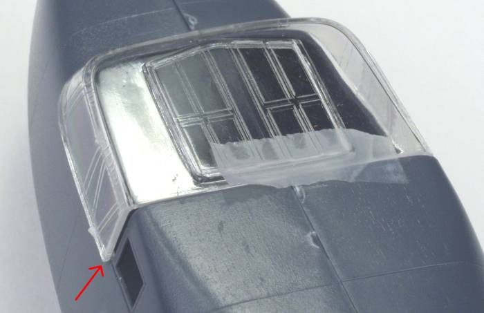

There has been much discussion about what Italeri means by "Improved Moulds". I haven't seen the original release but it is said that the cockpit detail has been improved along with the engines. Some of the panel lines may need a bit extra definition so they don't disappear under the paint. Reviews of the earlier release noted that the canopy is oversized, I haven't done a dry fit on mine yet.

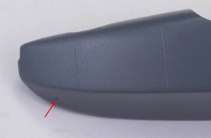

Well I had the Testors release, it had several endearing features I hope yours does not, for one thing the surface looked as if it had been sand blasted
Had major sink marks every where
And yes the canopy was a bit over sized
I do remember getting a Squadron vacuform set to replace it, I don't remember it was the right size or not, I'd need to dig it out and check.
Mine has the same look to the surface. It doesn't feel too rough, hopefully it will disappear under some primer. It now has some raised rivets along most of the panel lines and a raised frame around the lower edge of the canopy opening. There aren't many sink marks either, especially ones as bad as on yours. The width of the canopy hasn't changed.

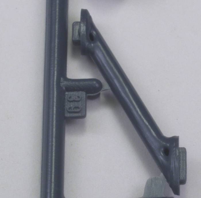

The two fuselage halves. There is a lump on the upper aft fuselage (black marked area) between the mid-upper turret and tail that has to go. On the left fuselage half, the three portholes on the cargo doors (black marks) can be filled in on the version I'm building. According to some reviews, the portholes need to be relocated 2mm higher. I'm not going there.
These show some of the raised rivets that I don't believe were on the original release. A little sanding will make them disappear. Also new, the raised reinforcing frame along the lower canopy opening, again with raised rivets.
